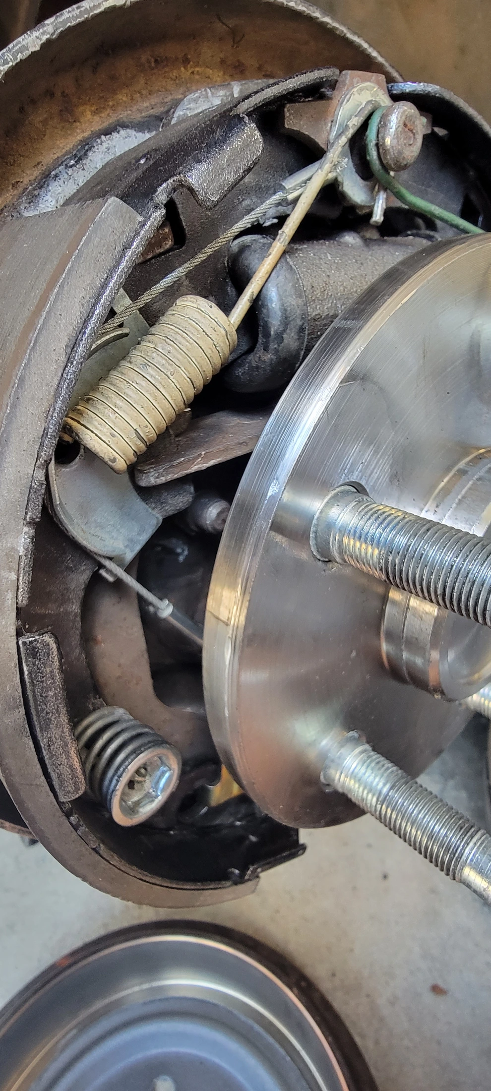

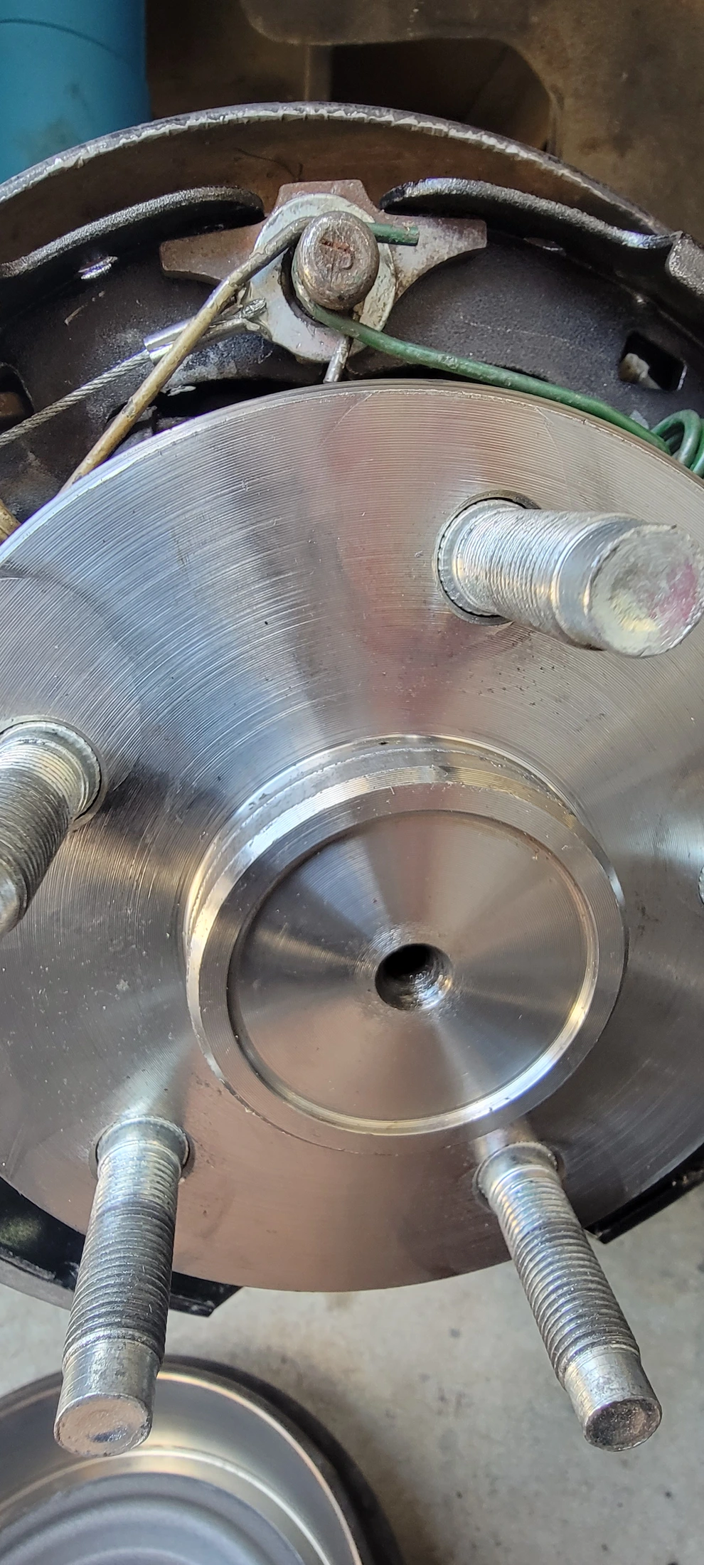

This is concerning too—the hub has some grooves worn into it, and the edges are rounded.

I see nothing amiss in those two pics

That is just normal wear and tear on the backing plate lip. These cars are over 30+ years old now and who knows what exploded inside the brakes at some point. You need to disconnect the e-brake lever from the shoe, remove that, and pull the cable from the backing plate. Zip tie the cables up and out of the way, reassemble the brakes, and adjust the shoes. Does the drum spin with some minimal drag? If yes take it for a drive and if it does it again you have completely eliminated the e-brake system so keep it disconnected until you figure it out. If that fixed the problem then lets move on to getting the e-brake system fixed.
