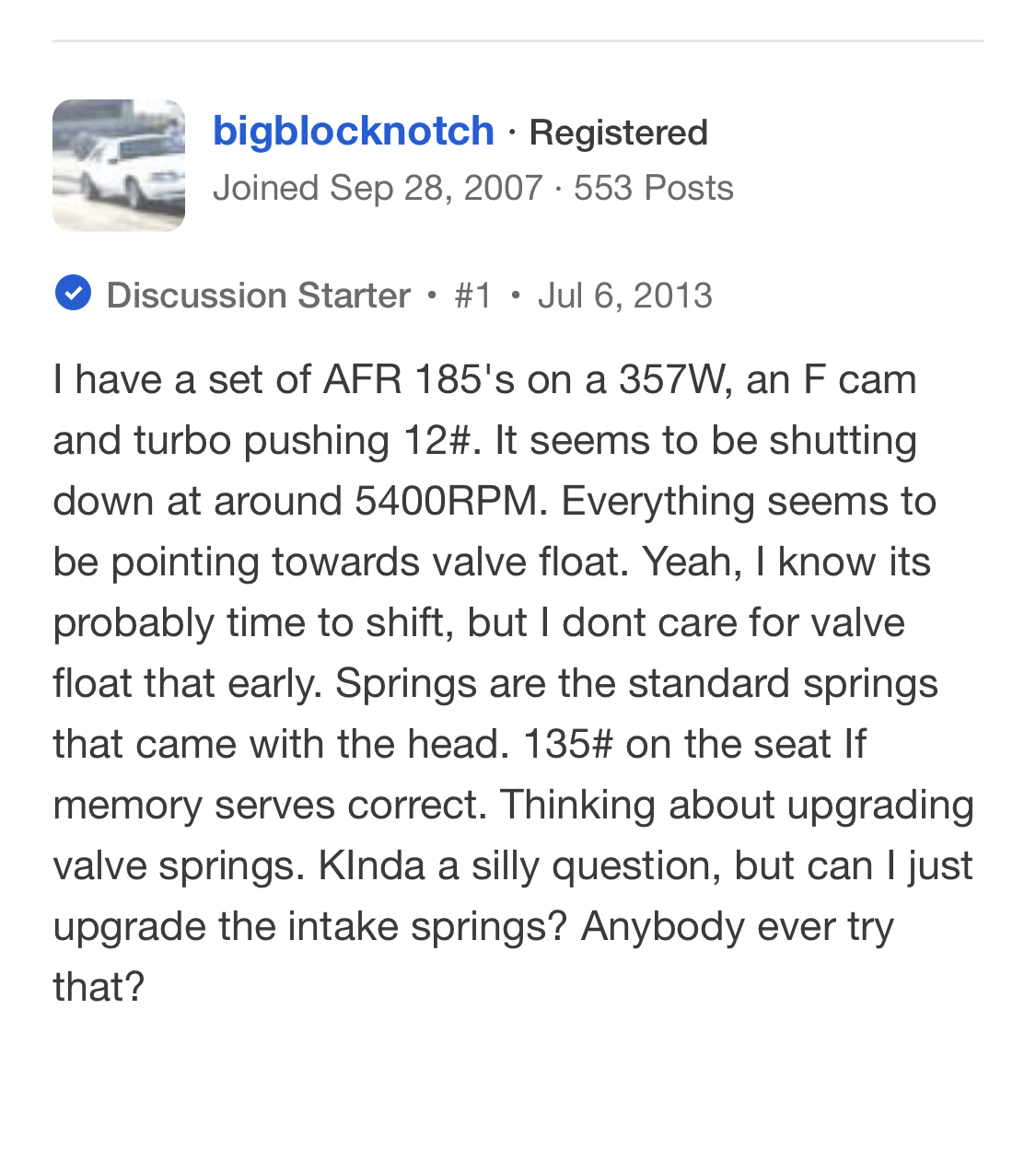

well we're leaning towards valve float causing my issues. Probably some belt slip as well but that's most likely not the issue. I've ordered a set of new springs, I'm kicking myself for not just changing them in the first place cause now I've got to deal with doing them with the heads on. It's not hard to do just a pain leaning over the fender, pressurizing the cylinder with air and compressing the spring to pull the keepers etc...
so if you buy the promaxx heads replace the springs, I'm guessing they're so, so for N/A applications so once boost is add into the equation they just cant keep up
Well if this is damn near the exact issues I’m having! Definitely feeling better about putting in better springs

So I took a spring off these heads and also took a k800 to my neighbors friends head shop. The promaxx springs are supposed to be 145 seat pressure and they were 134 ish! The k800 springs were 195!! He thought those were too heavy for my lifters and I tend to agree so I’m gonna look for around 150-155.
