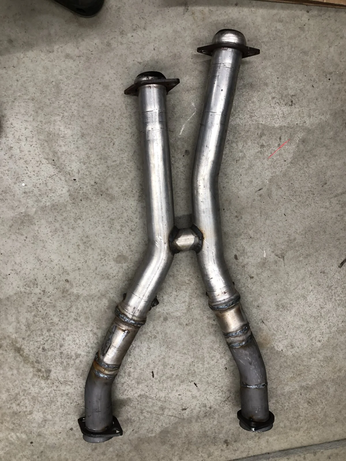

Your plugging the O2 sensor bungs right? If you are planning on using those over the ones in the LT's then they need to be pointing to the sides. The first speed bump you see or even bounce in the road will take the sensors body right off.
Reactions: General karthief
Ha! No those are from the old down pipes i reused from when i had shorty headers. O2 will got in the header. I'm gonna weld up or cut out the old bungs.
  • Winner
Reactions: stanglx2002
Parking brake cables and parking brake handle mod done. Well still need two e clips but that’s it. Welded up my h pipe as well. Will install tomorrow with driveshaft and weld on h pipe hangers. Then back to the engine, cooling system, breather system/catch can, meth, air intake tubing and filter. Oh probably should put oil in the tranny before I forget. New rear sway bar as well. Just chugging along. Really need to put tools away and clean the garage as well.

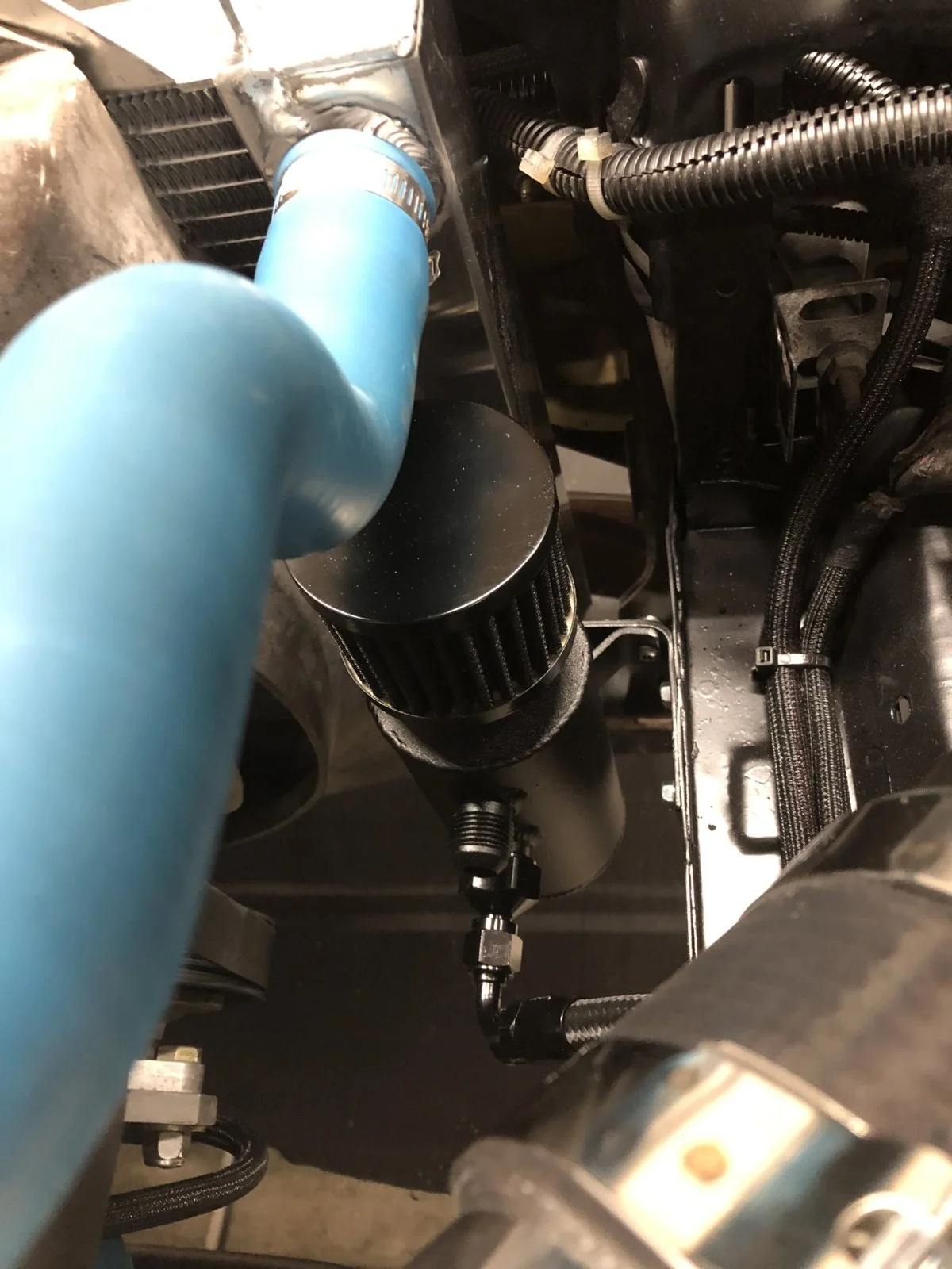

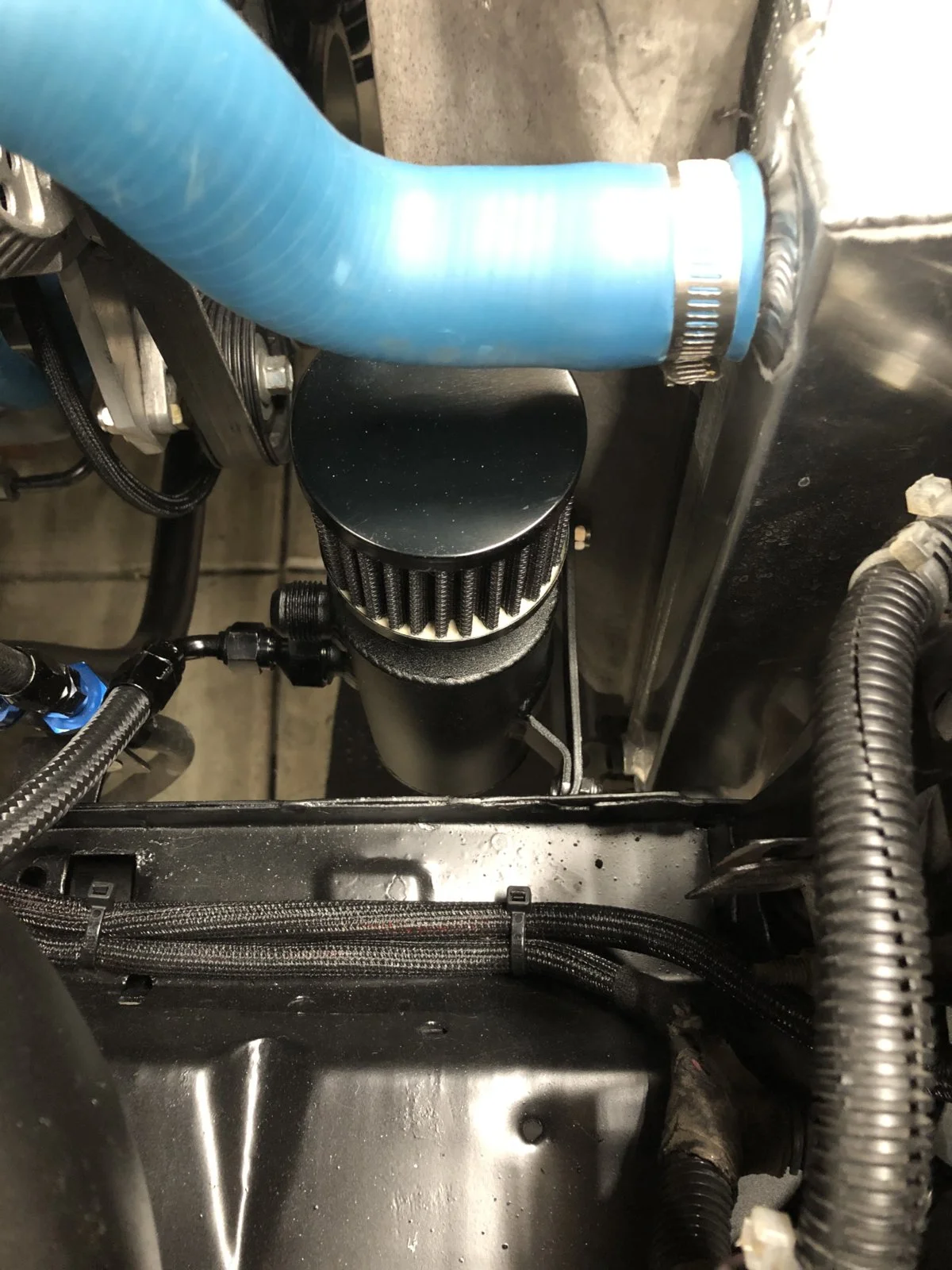

Figured out where to mount my catch can/breather. Of course I was two fittings and a foot short on hose to finish.

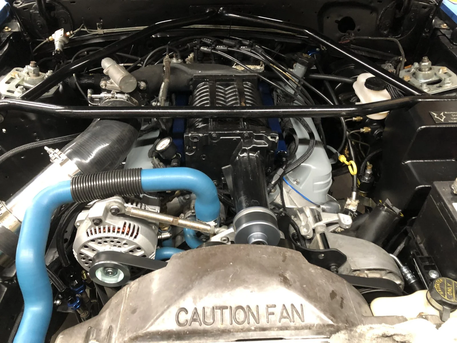

oh yes I do plan to paint the fan shroud if I decide not to go electric. Hmm since I’m running the big pulley on the crank I wonder if I’m exceeding the clutch fans rating if there is one? Well it’ll move more air I suppose lol
You cannot exceed fan speed that way. It's the clutch that makes that decision up to and until it fails. On a side note: I've never seen one fail 'closed'.
In other words: The fan clutch will regulate that for you.
