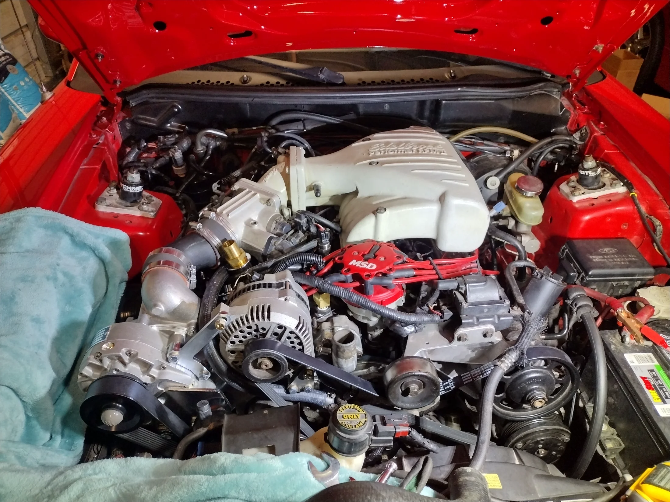

I know that belt's nice and snug and I think the supercharger one is fine as well let me know what you think about this video. It's a little hard to do it with one hand you're pushing down on the tensioner with one hand and locking down the nut with the other hand so it's a little difficult but I think I got it.

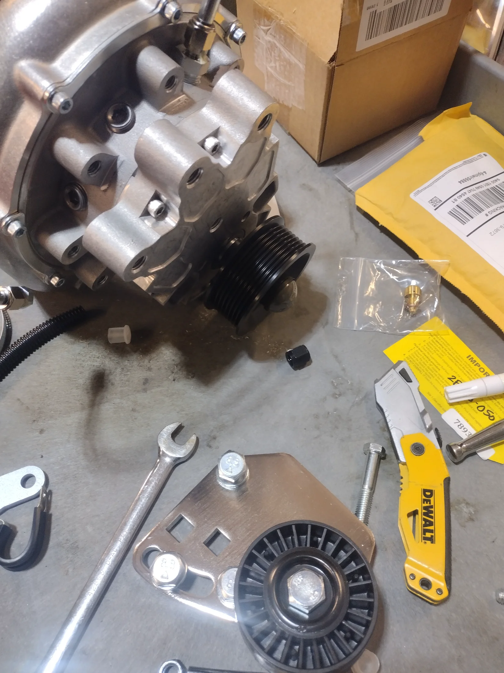

Looks like the vortech tensioner can be adjusted via the square holes in the tensioner so I'll mess with it this evening. Hopefully it ain't too aggravating. I don't really want to buy the aftermarket tension thing necessarily..

You should have no issues with the Vortech belt. Thats the easy one. Stick a 1/2" torque wrench into whichever square hole it will go into (i think i used the bottom hole. The belt might block one of them), set your torque wrench to 55-80ft lbs and crank it down on the belt. While holding the torque wrench at where it beeps/clicks with one hand, with your other free hand, tighten one of the bolts to lock it in place. You only need to tighten one bolt down a little bit and it will hold. Remove the torque wrench and then finish tightening all the Vortech tensioner bolts down. With the brackets and belt and equipment sort of in the way, you just gotta tighten those bolts down like 1/4 turn at a time, switching sides of your wrench each 1/4 turn. Its slow going, but easy.

Good explanation. I was going to use a ratchet to place in the square hole and get it good and tight by muscle and feel but that's better/easier..

Vortech/Paxton (as far as i know) don't provide torque specs for the tensioner. I came up with the 55-80ft lbs just based on internet research and recommendations from other members here. The torque wrench (at least mine, since its a long handled one) worked well if only to give me good leverage. It would be really hard, i think, to use a short ratchet and put all your muscle into it WHILE trying to tighten down the bolts with your other hand.
Also, with the s/c belt in the way, i had to use a 1/2" torque wrench, with a small extension (like 3"). In my case, i used the torque wrench, and 1/2" to 3/4" adapater, then a 3/4" to 1/2" adapter since i don't have any 1/2" extensions. You have to fish all this down through the space between your upper radiator hose/belt and radiator to get it into the square hole.

Ok back here to this thread as google brought me. I now think my squeal at startup only is definitely due to the belt slipping. Yesterday was the first time I turned on the AC and it squealed for about 20 secs ish and the volt gauge was fluctuating from 14 plus to 12 something, car sounded as if it wanted to cut off. I looked at the belt and it definitely appeared to be not like it would just jump right off but noticeable that it would cause the issue of what it was doing.
The belt that is on there is the gates ko60858 and the package says 86 3/8 OC but the overall effective length is 85 7/8. I tried a 85.5 and with the tensionder maxed out it still has another 1/4 inch to get it on. I'm just not sure I can get it on and I will call a few folks tomorrow to see if they have any ideas or tricks to get it on possibly. I think if I get it on it should stop the issue and hopefully it won't be too tight and cause an issue. Research shows that some folks ended up having to use a smog delete pulley and going to finish reading posts here again to see if it answers my question.
