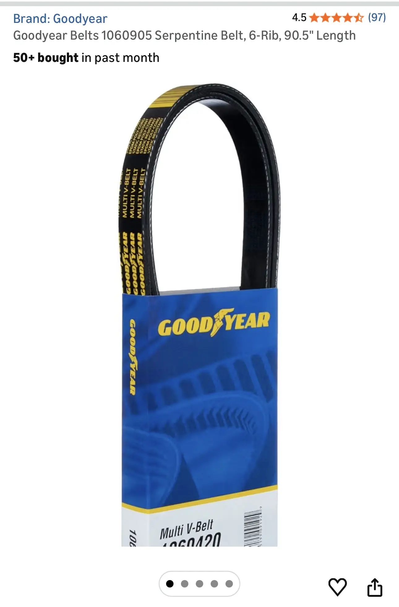

Fwiw -this was the belt I ended up using after weighing my options from everybody in my thread-
I gots no supercharger though :-(
