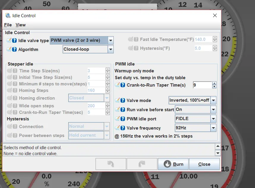

Simple fix, here is a snip of how the valve should be setup in the idle control drop box. on the MS2pnp the idle valve polarity needs to be inverted, as of now your valve is slamming open [on yours the valve sees 10% but opens to 90%] the settings below will fix the issue.
EDIT: leave the car in open loop idle 'warm up for now until you get the basics down'
