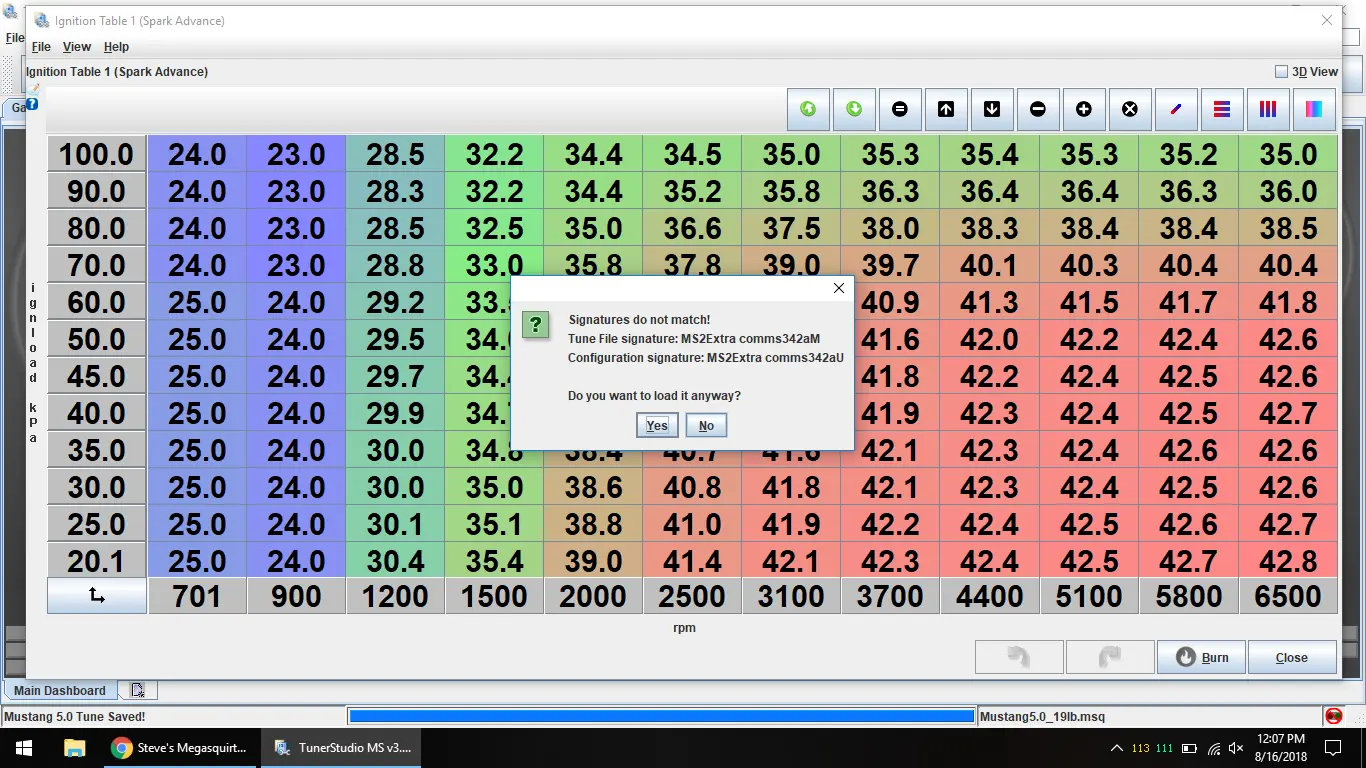

I see one of the culprits being how the ignition table is setup right now, I have an idea of what may help...
The file named Steves ignition Table, load this into your IGN Table 1.

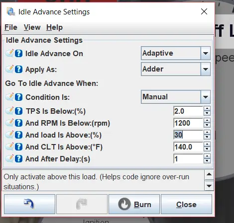

then set the idle advance settings the way i have them in the picture.

Also why does the kPa on the timing tables go to 203kPa?.....my car is NA,

1. I changed the timing table so the ignition table did not 'run away' at idle, ie. the timing went up quickly from 900 to 1300 before now it stays at a relatively the same amount in the entire idle region.
2. I expected exactly what we got, the idle is nice and smooth until the idle goes below 850 rpm at this point i see the idle valve begin to oscillate to hold it at the setpoint. now you need to tweak the idle settings to get the oscillation settled down. the surge is much less drastic.

lower the idle valve gain [slider bar] this is in the closed loop idle settings.

It goes to 203 because that is a table i use when building a base tune.... it covers most* installations it is the same table i am using on my car
