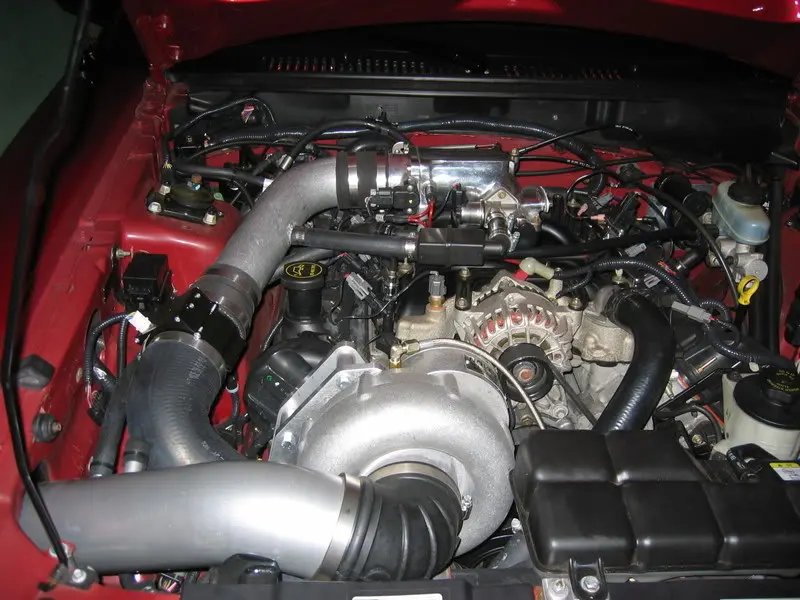

Any pics of the blower setup? I miss my old N2K.

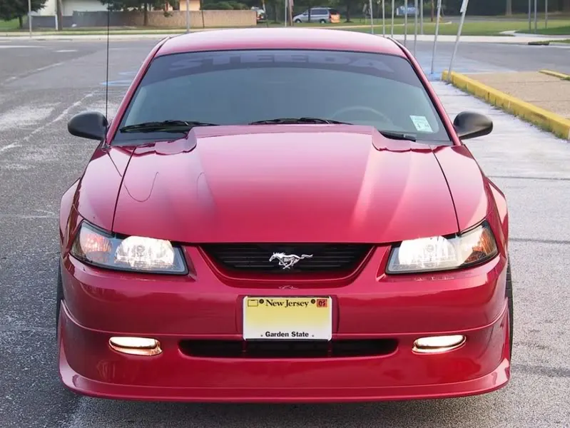

And what brand is your cowl? Have a better picture of that?

steeda hood:

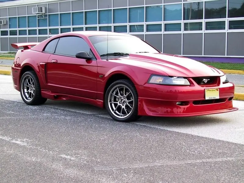

Boy, with a lower profile wing, and lowering the car about 1-1.5", it would look insane. Good looking ride though no doubt. Love that color.

im actually going to remove the wing ans dropping will come as soon as i get all this engine stuff ironed out.
