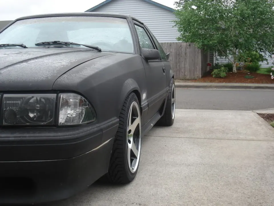

I have 17x8's up front with 235-40 tires and I dont see anything horribly stupid :shrug: I think it actually fits pretty square with the wheel
Dmarstroker, what brand Cobras are those? Are you running any spacers? The setup looks pretty mean. The 235's are right there on the edge but they don't look bad.
The wheels are 03 cobra replicas from afswheels, running no spacers up front because the 96+ spindles pushed them out to the edge. The rears I m running 17x10.5's with a 3/8 spacers on 315 nitto DR

I stand corrected. Allow me to rephrase, the two times I saw 235s on an 8" rim they looked stupid. The above tires look like they fit perfectly, the ones I have seen in the past looked horribly too small. The edge of the tread was inside the lip of the rim, causing the side wall to slope inwards. I don't recall what brand tires they were, but they looked horrible.
Come to think of it, my 245s look exactly like the ones pictured, I can't imagine getting the same tire in a 235 and having it look any where near "normal".
