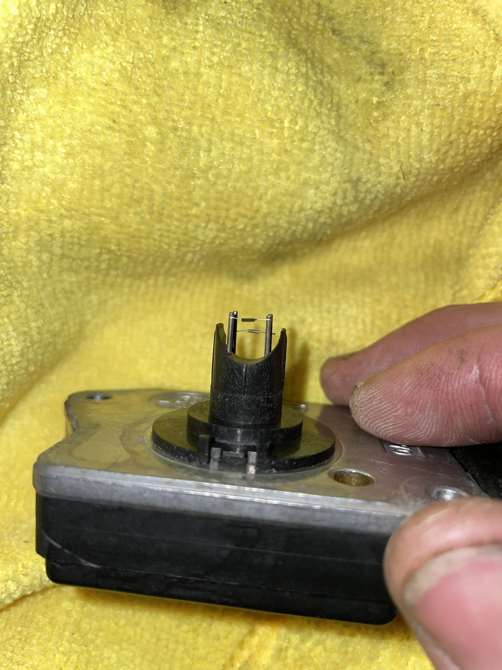

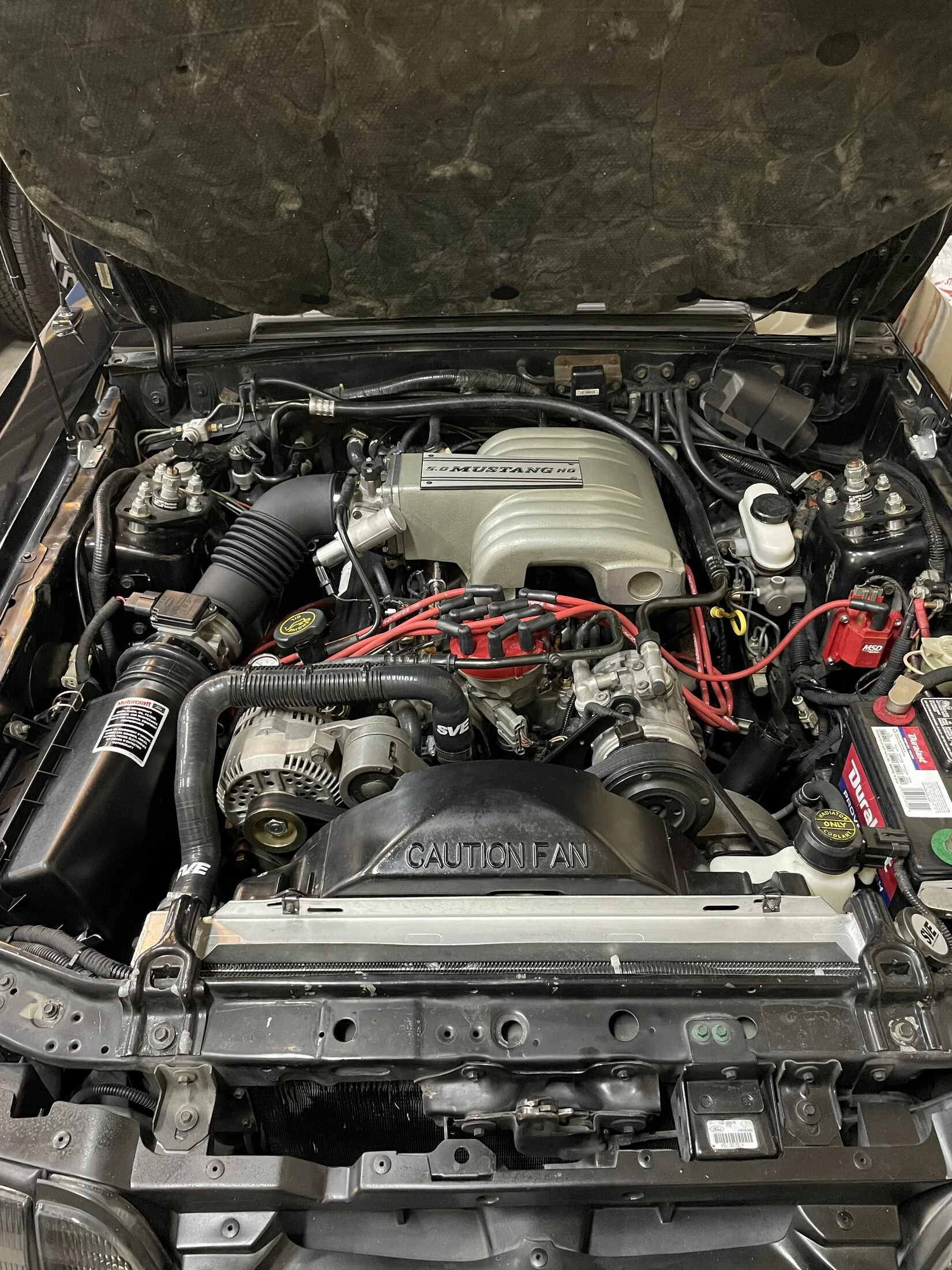

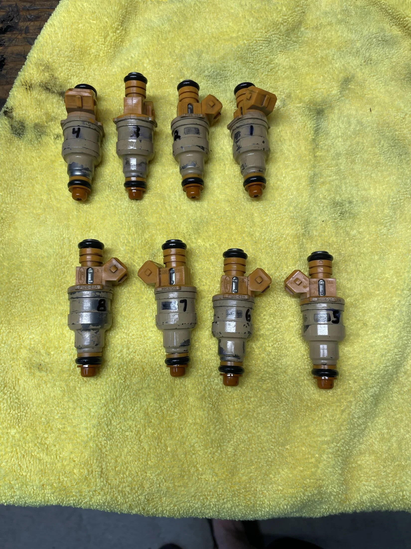

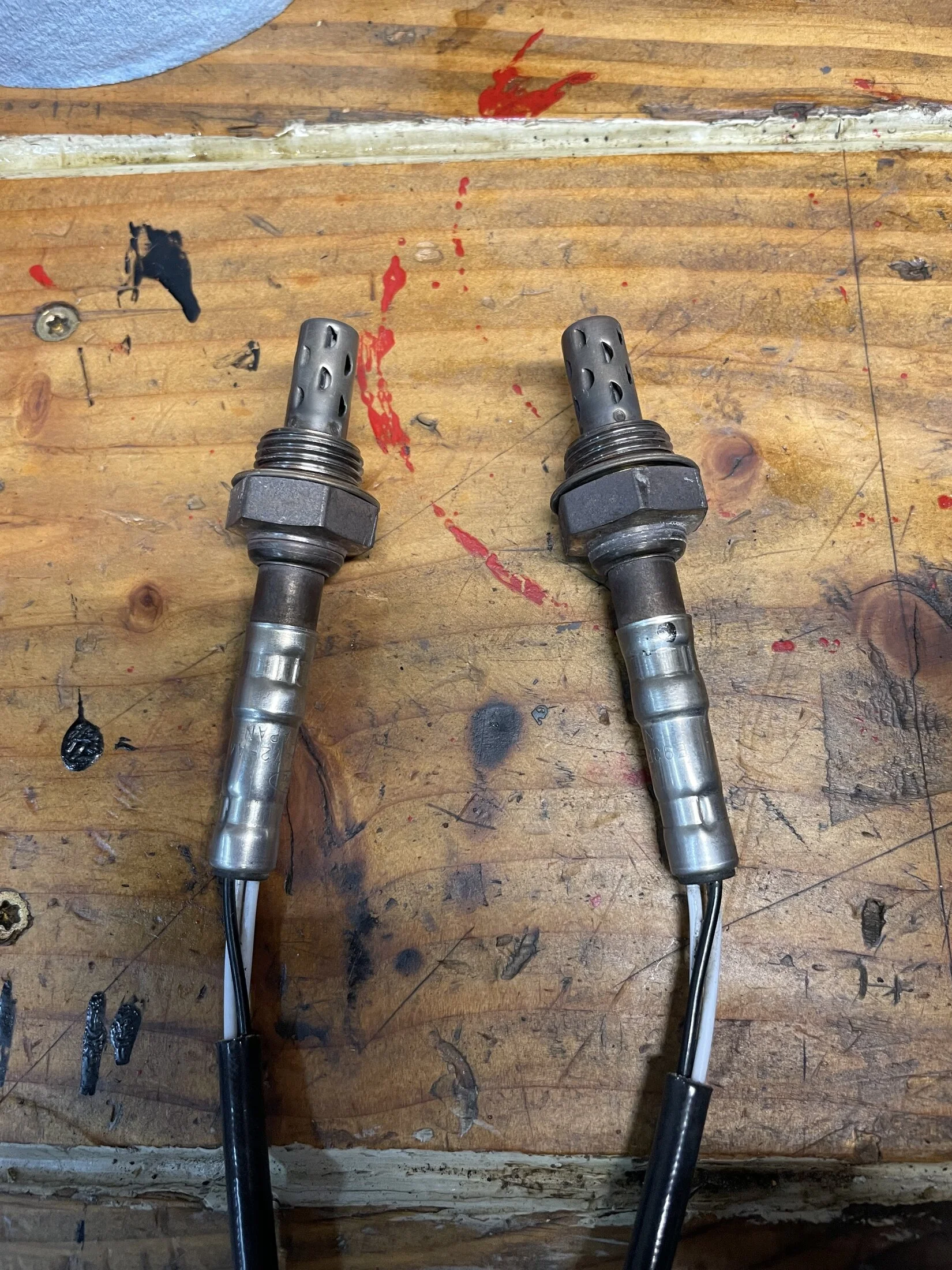

Update:
Injectors and fuel rail cleaned.

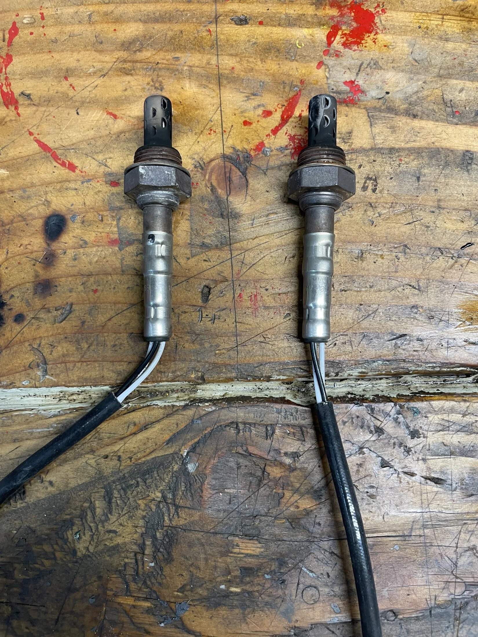

02 sensors cleaned.
MAF cleaned (again).
Stock intake box installed.
Injectors after cleaning
Before and after of O2 sensors
MAF sensor after cleaning. One of the sensors is black on one side. Not sure if that's normal but car doesn't throw codes.
Engine bay with new airbox

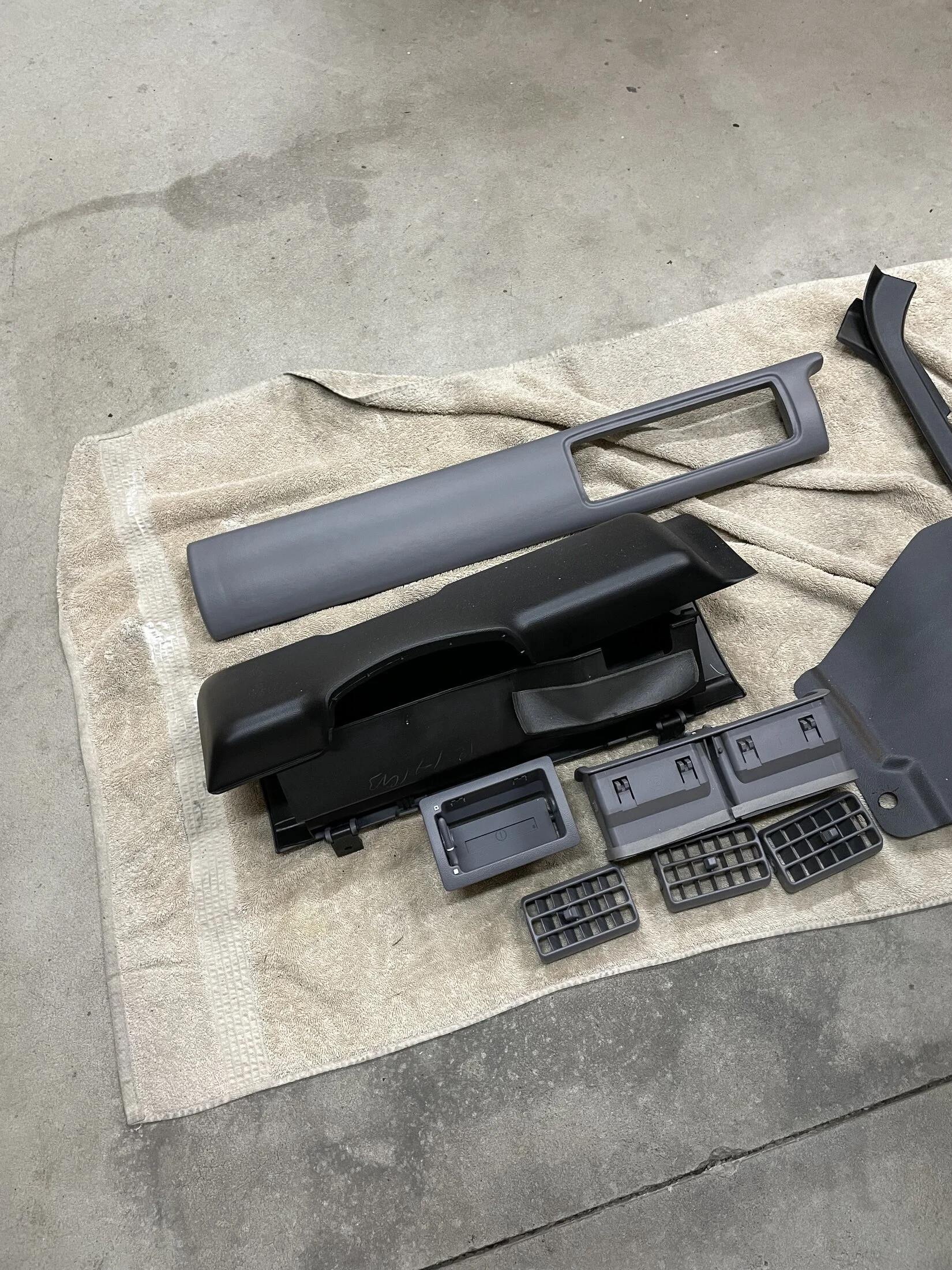

Ran out of time today so I didn't drive it. I'll do that tomorrow. Also get to install more new and dyed interior pieces.
I'll give an update tomorrow. A big thanks to everyone who is helping me troubleshoot.

Took the car for a cruise and it runs great! No more leaning out and sputtering. My guess is the injectors. It idles smoother now too. Went to the gas station and put in some octane boost just for kicks. My first time in a public place and as you know it, conversation starter.

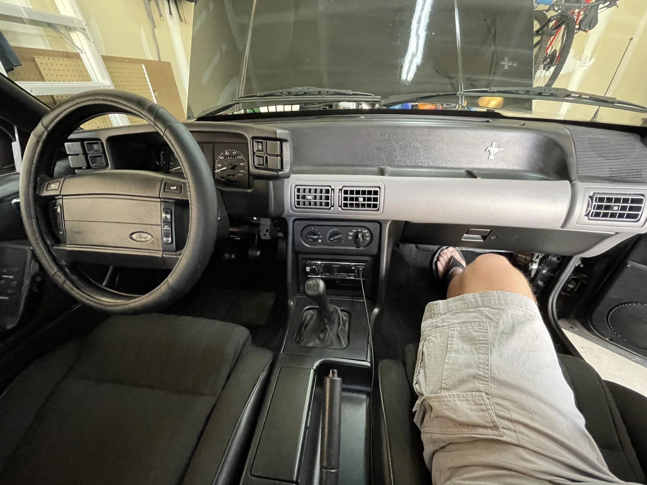

Car is super fun to drive! I'll keep posting progress as I go.
Dash is almost done.

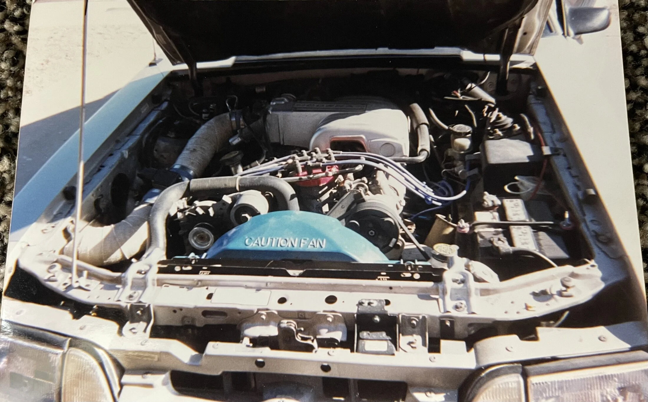

Found this old pic of my buddy in his 90 LX. This was taken in 1999 or 2000. It had 3.73 gears, short throw shifter, under drive pulleys, 1.7 rockers, CAI, and a 150 wet shot. Super fun running the streets with this thing...especially on drag radials. Ah, the good old days.
Back then, you needed 4 extra gauges and a monster tac...lol.

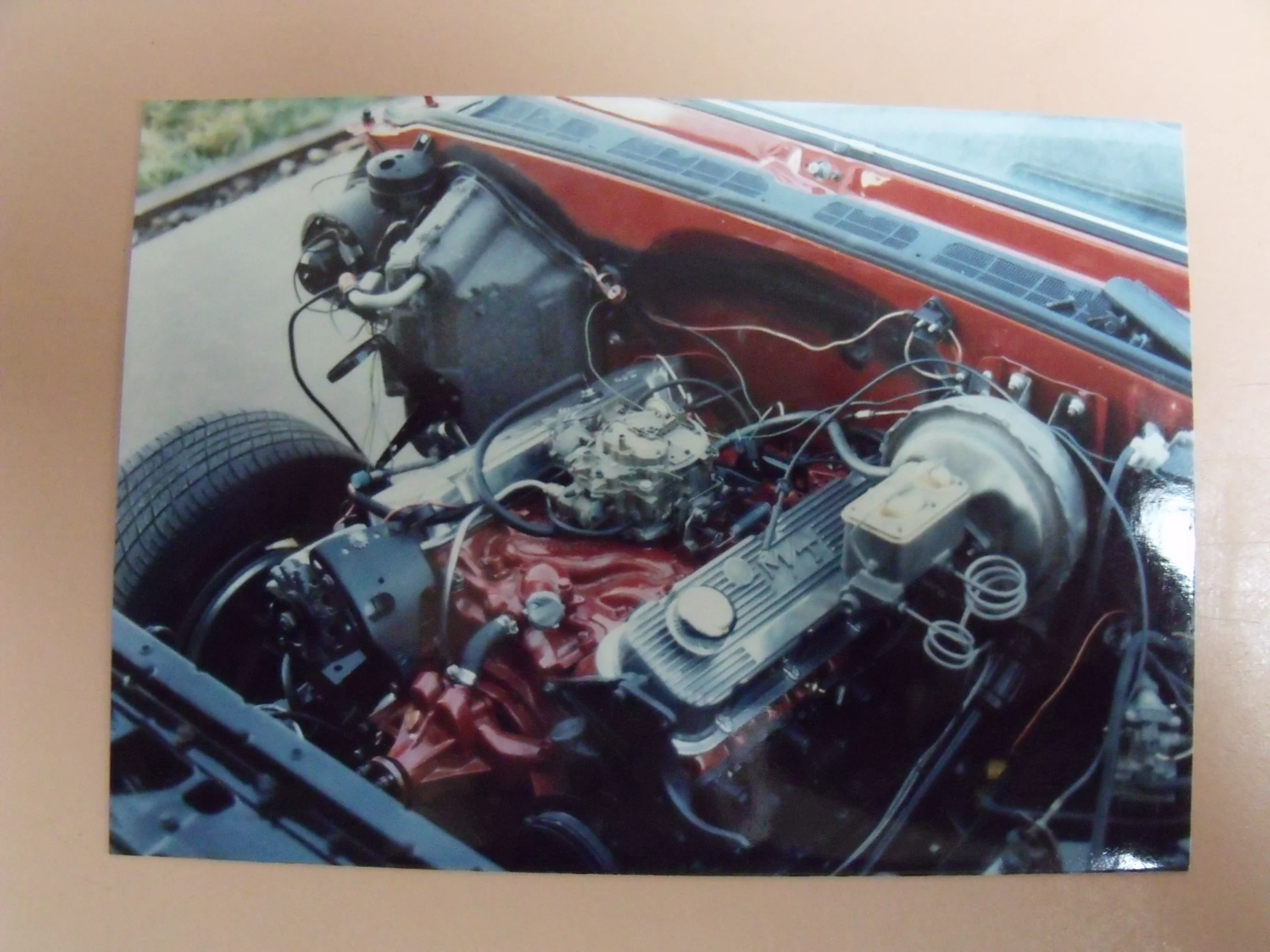

Funny story...my other friend around the corner had an 84 Chevy longbed pickup that he just dropped a new engine in...it was a built 350 with an aggressive cam. Well, he decided to break in the engine/cam at 2 am. Neighbors were not impressed. Man we were dumb asses.
That truck was crazy. High 11's in the 1/4 mile on a 350 small block. 350hp 2-stage shot of nitrous too. It was around 850 HP.
Man we had some good times.

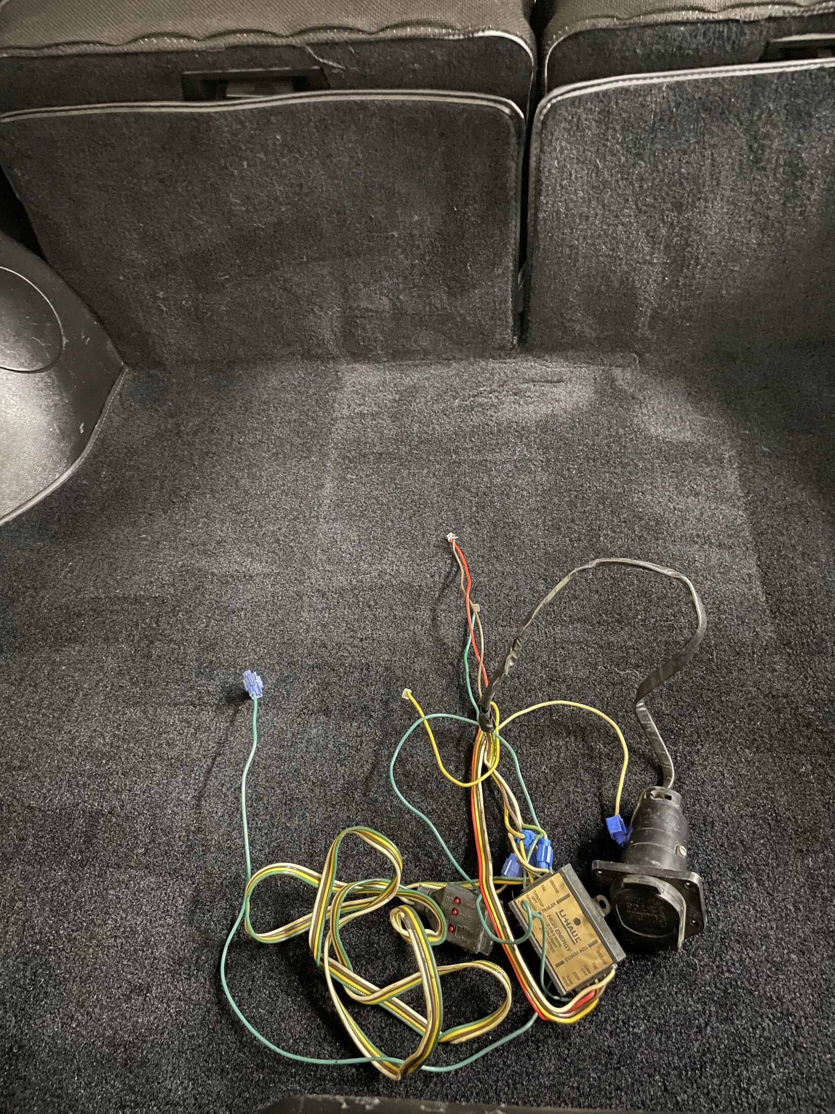

Well, I found a Uhaul 3 pin and 6 pin trailer harness laying in the trunk that was all wired into the tail lights...WTF? Got that removed and am cleaning up the trunk area. Hatch brake lights didn't work (dirty light socket on one and the other had the bulb installed backwards). Also noticed turn signals wouldn't work in ACC ignition mode. Turns out they were all LED. Replaced the rears with incandescent bulbs and flasher now works properly. I'll snap some pics this weekend.

Little more progress today. Pulled trunk panels and got the wiring cleaned up and the rear hatch light working. Here is a pic of that uhaul wire harness. Why the hell would a person have this on a mustang?
#1 answer - They hauled a trailer to the track with tires and tools. Might have even been a U-haul Trailer
You might find evidence of a receiver hitch from a past life if you get it up in the air.

That u haul harness octopus looks like the anti theft octopus I took out of mine lol.
