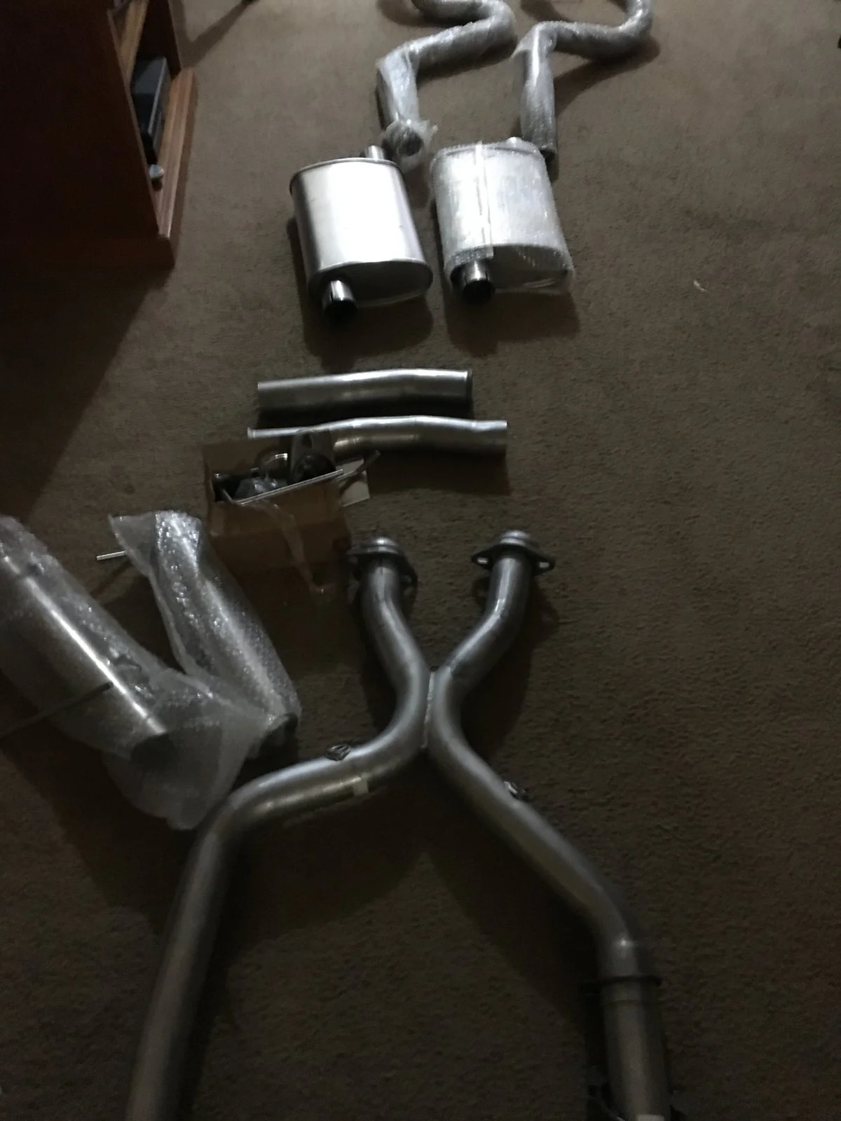

No sound clip since exhaust really isn't exciting

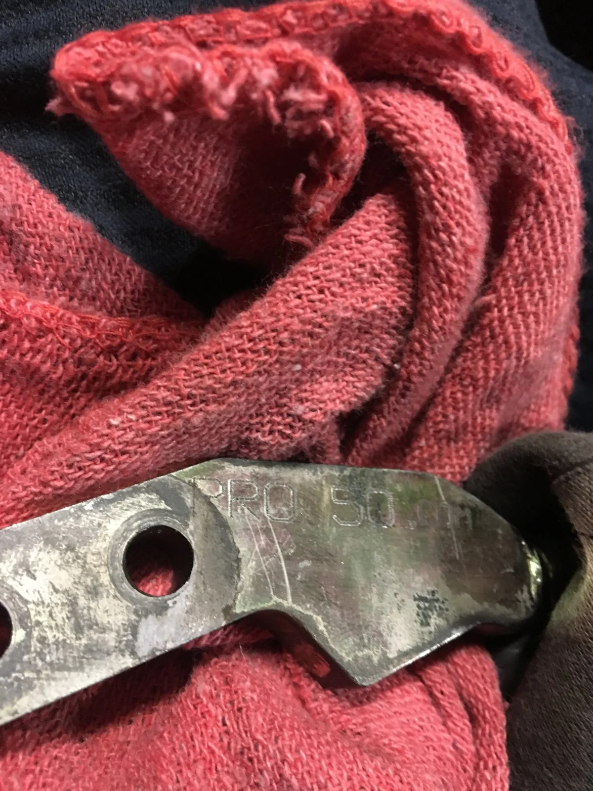

also found out the car has a pro50 tremec shifter

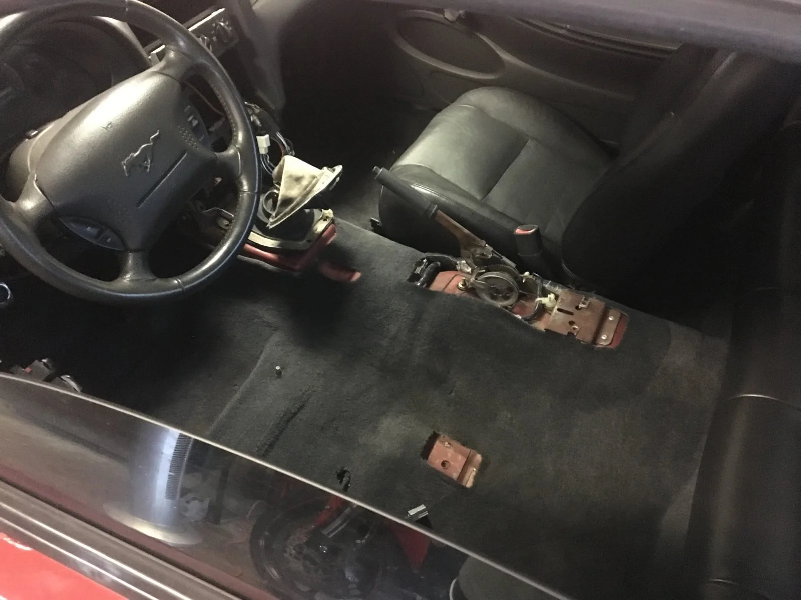

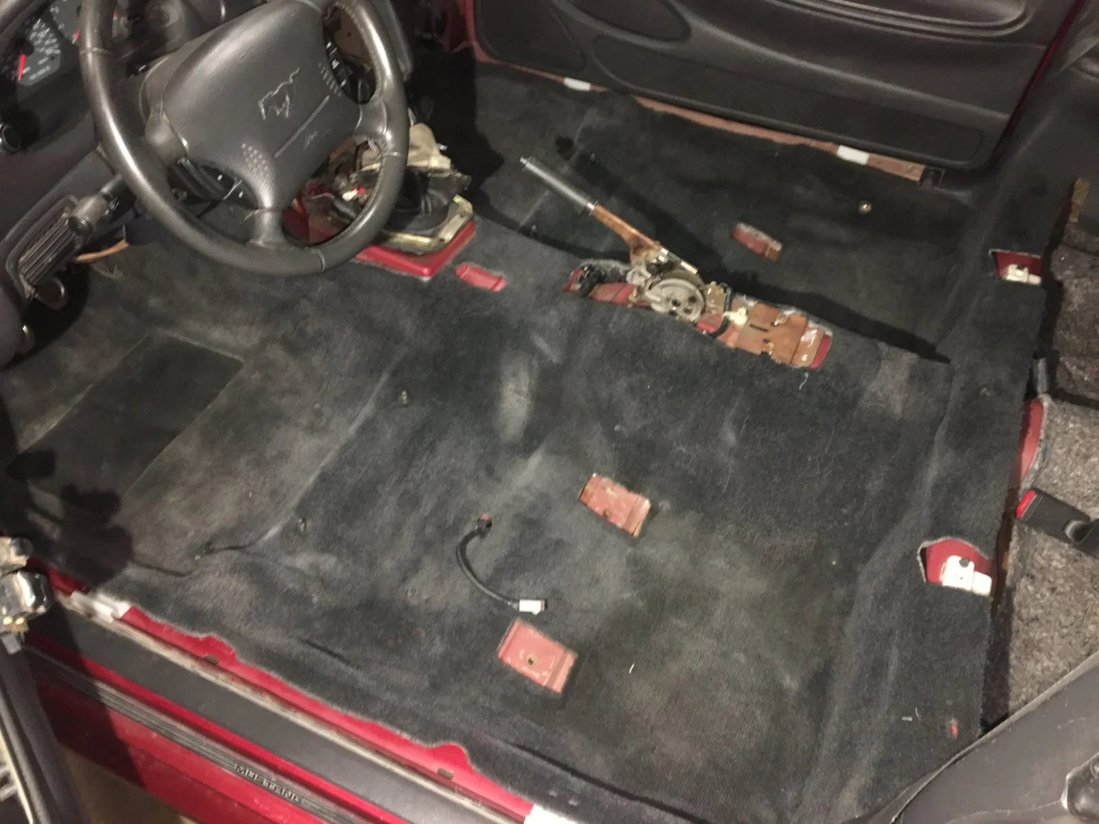

been cleaning the interior as well
cleaned every nook and cranny in the car. from washing the carpet to removing every panel to wipe and clean the area behind.
I am currently re doing the head liner/repairing the board and also painting the center console black

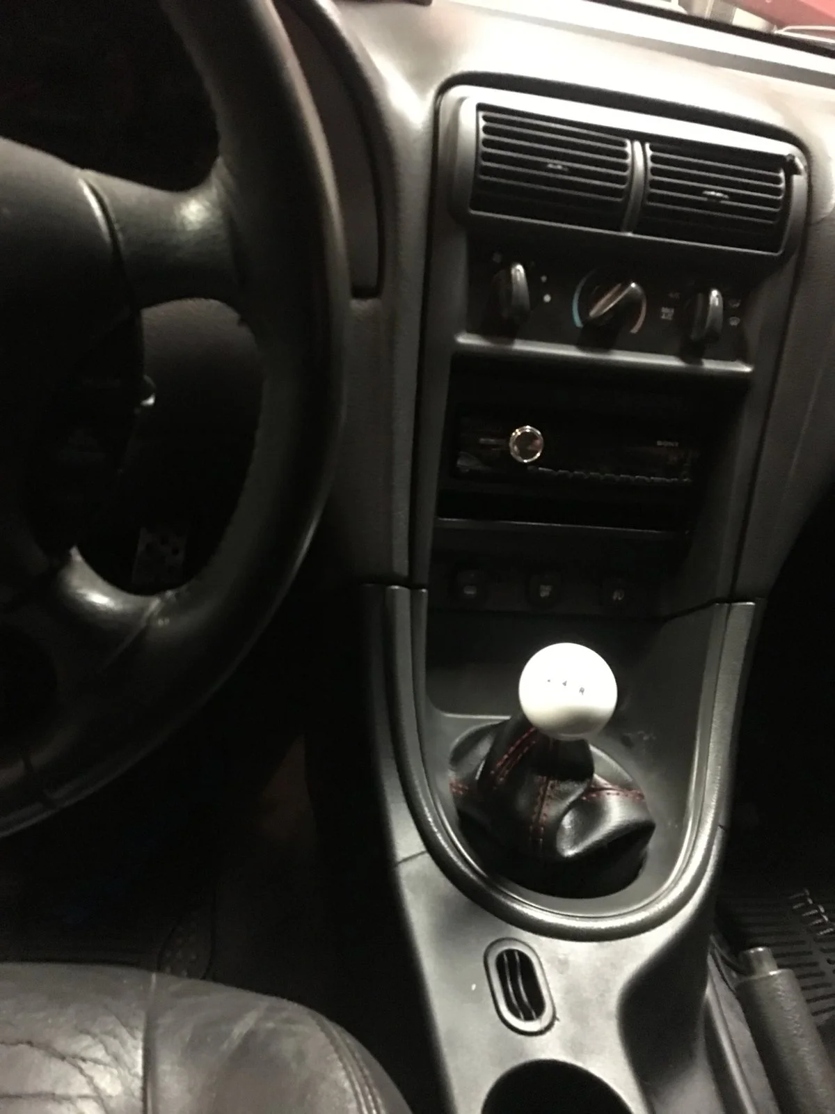

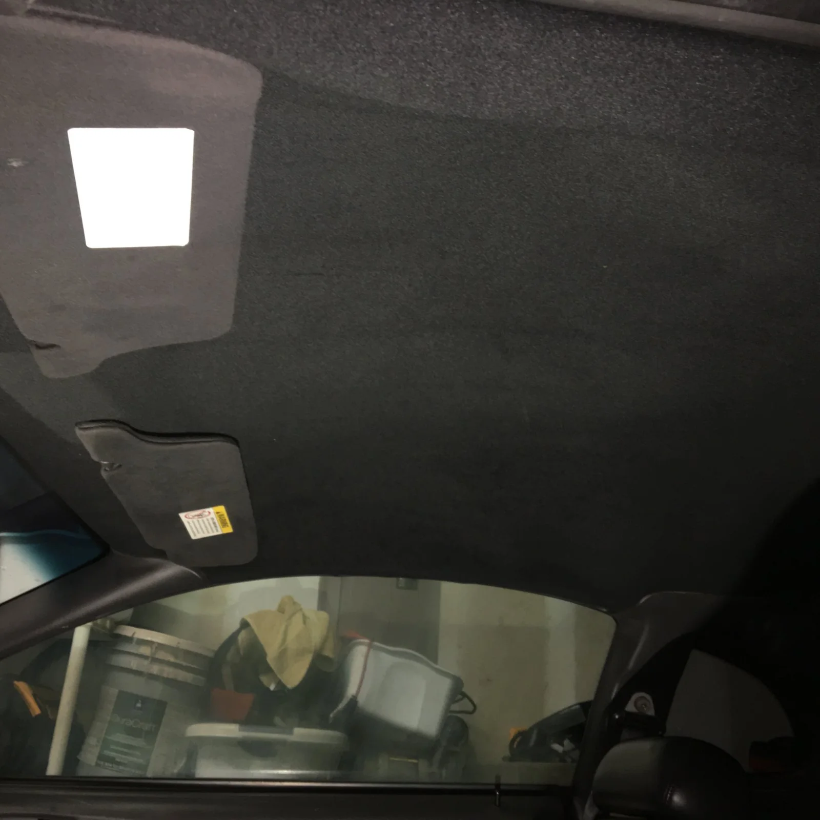

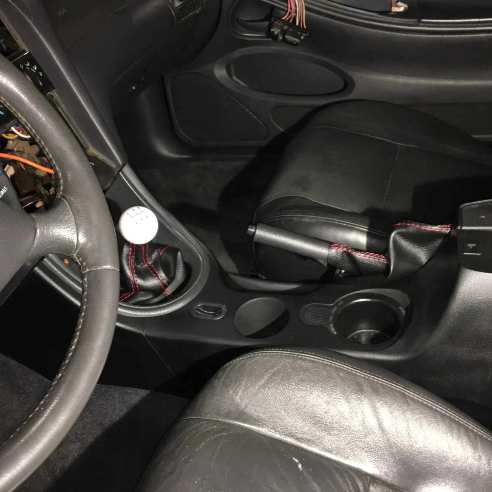

*finished the headliner
*refit the center arm rest piece - painted flat black
*new shifter/ebrake boot - red stitching + leather ( the tremic shifter was installed backwards also - i fixed that )
*removed a gps car tracker + wiring that was installed previous at some point
*cleaned even more ( never ending )

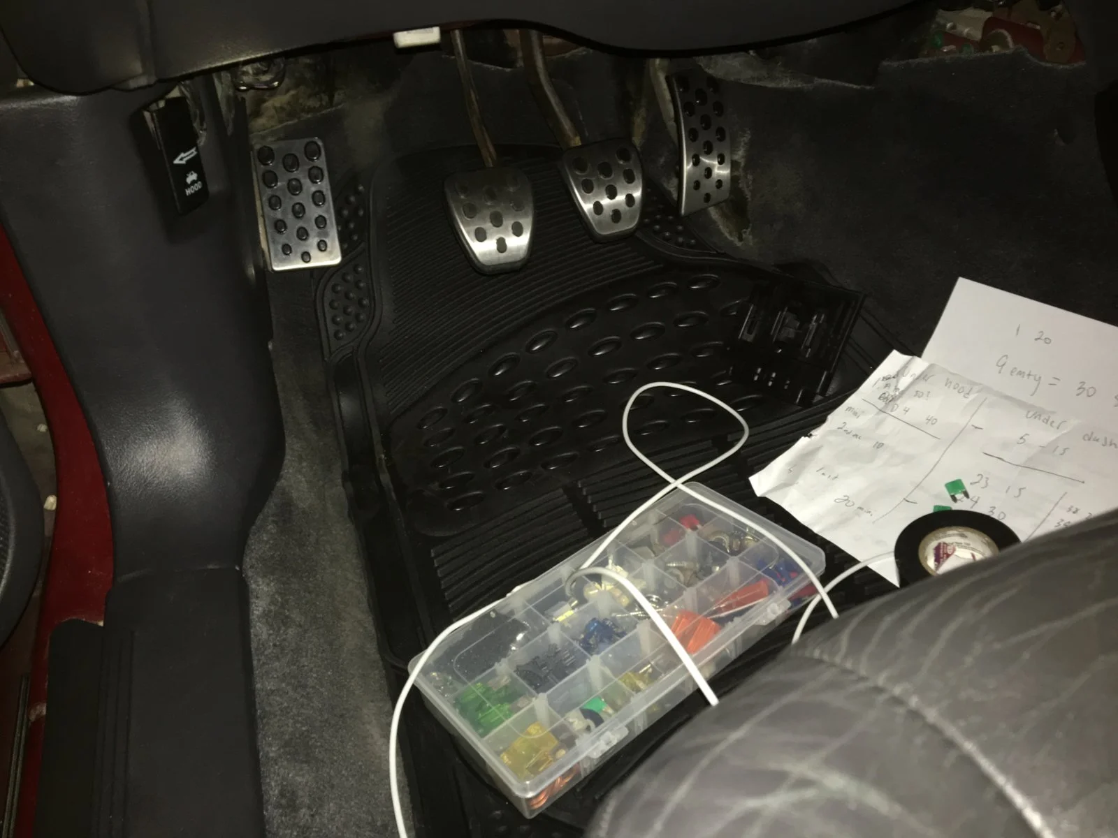

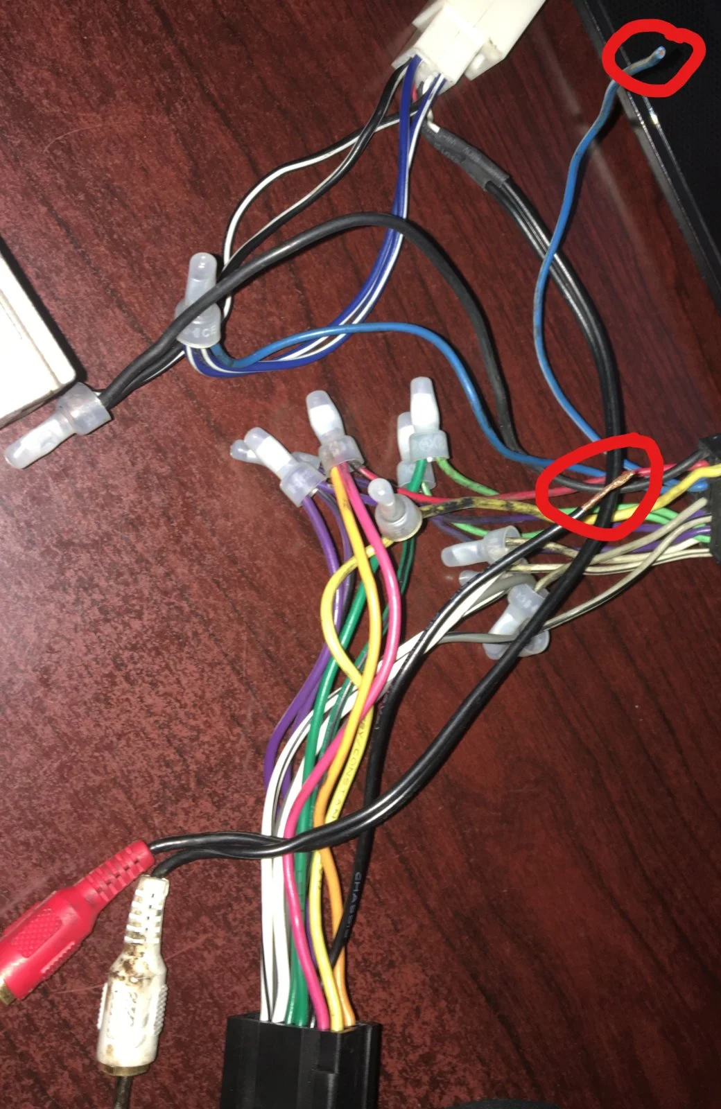

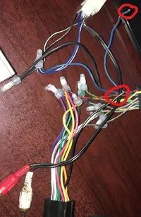

*started the radio wiring harness repair - basically i re did the crimping and I am now trying to figure out if the chassis ground is crimped to the other black cables or grounded to metal. also a mystery blue wire - not sure if its needed ( I circled those in the pictures below )

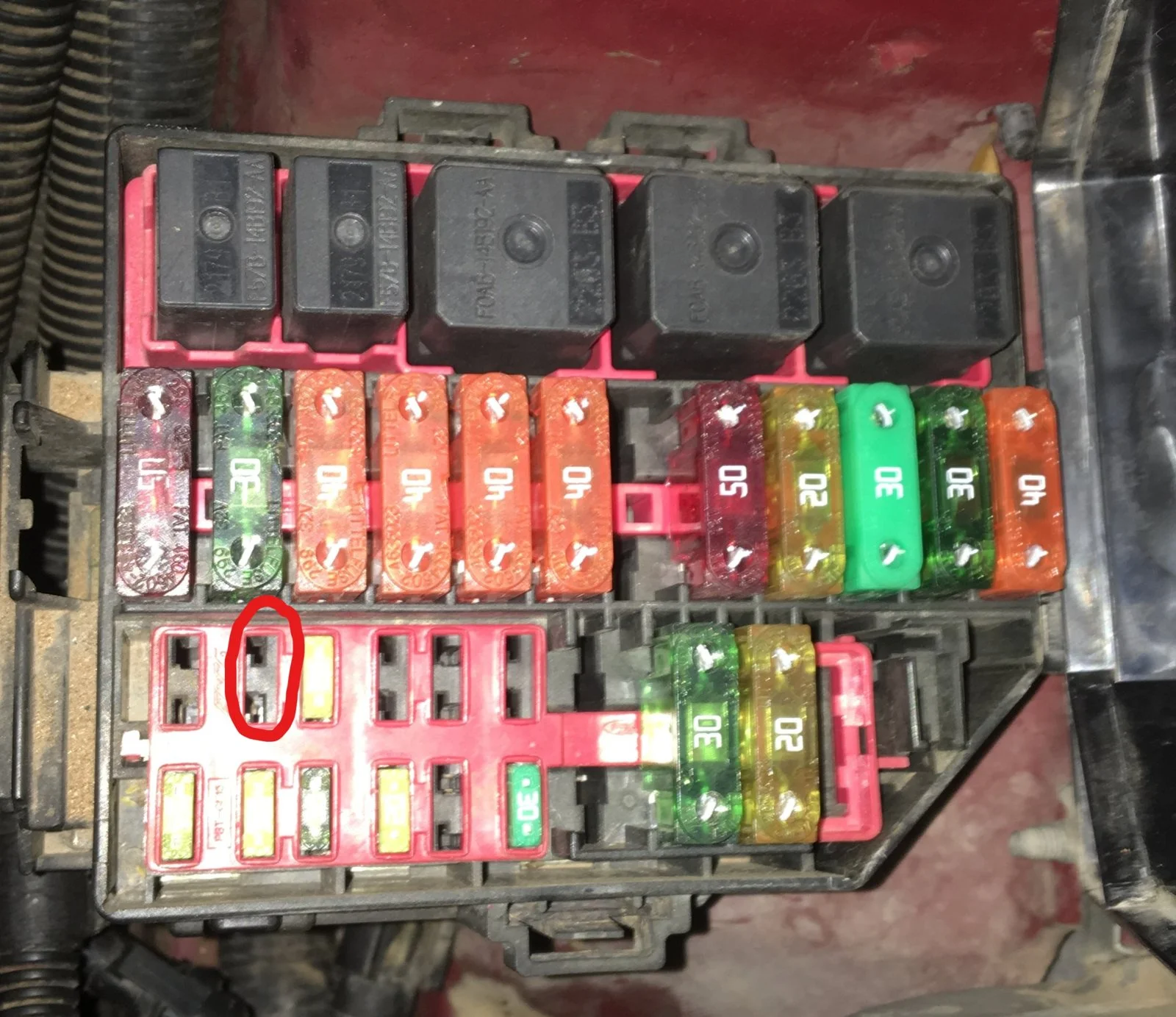

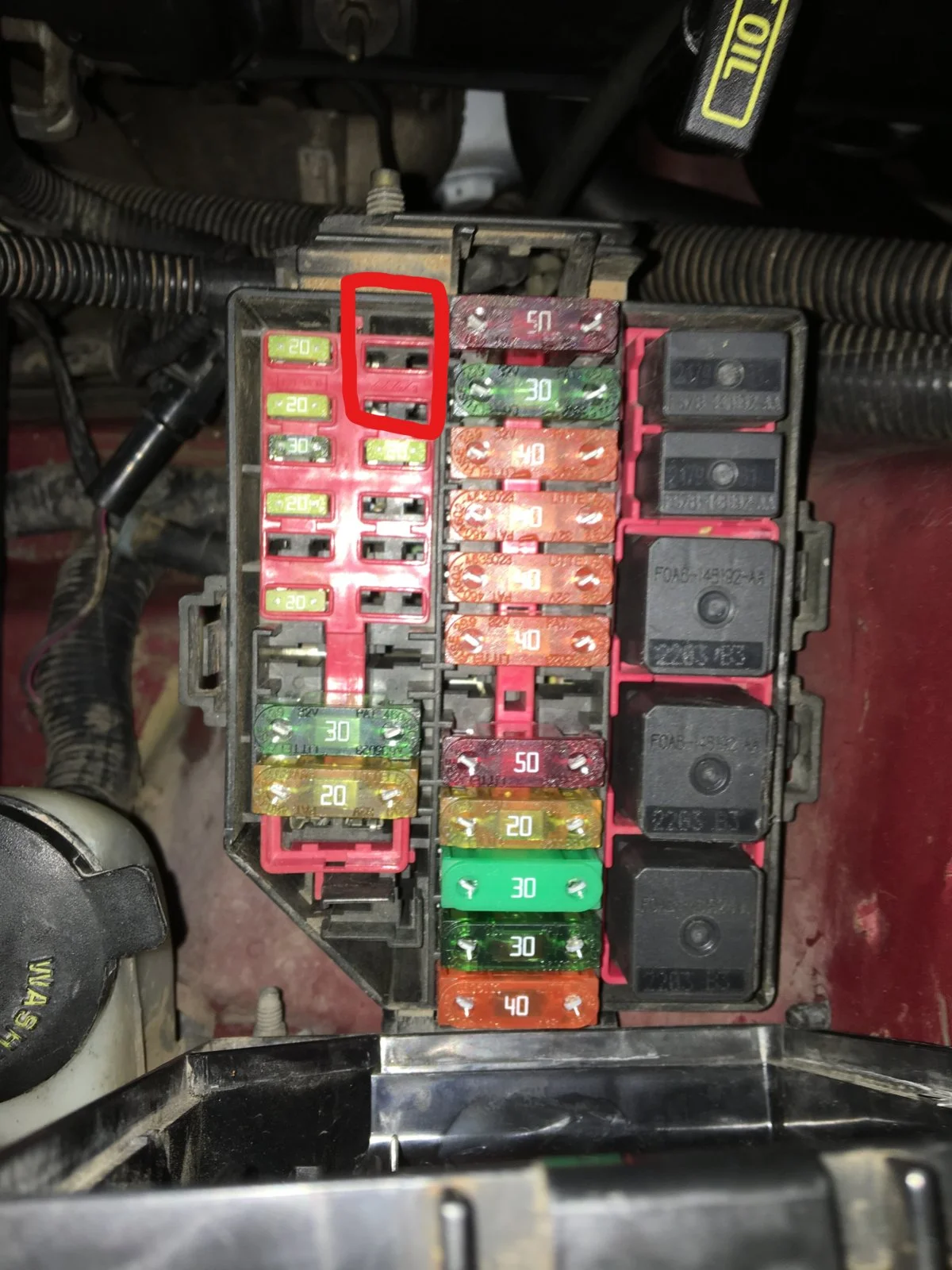

also started on fixing the AC - so far it makes noise when turning on or switching between fan speeds but no air comes out - I am going to check the fuses for the AC system first before diving into it anymore.
I started looking at fuses and one is missing.. looking at a diagram of a v6 mustang I believe its the same for a GT - It shows as "audio" looked a little further and its a 10 amp fuse for the radio.. going to see if I can get one for that. I think that + fixing the wiring should make the radio play music. Hopefully all speakers work, also noticed there are 2 amps in the trunk for the mach system hidden above; they both have 1 connection coming off them -I am assuming they will still work for the interior speakers but to get the most out of them, I should get sub-woofers?
anyways I got some testing to do. OH also my new insurance company wants some papers filed/sent back before I can get this car on the road... bummer.I did take it out and forgot it had no power steering fluid since it sat for a while with the connections off. I bleed the old fluid and replaced it with some new and its back to normal. I will do a complete flush of all fluids down the line though.
Thought I'd pop in real quick -

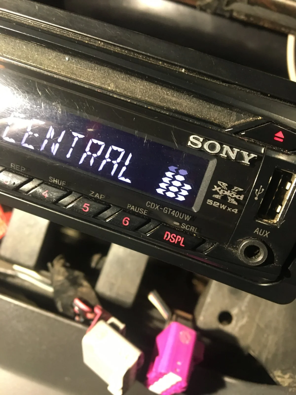

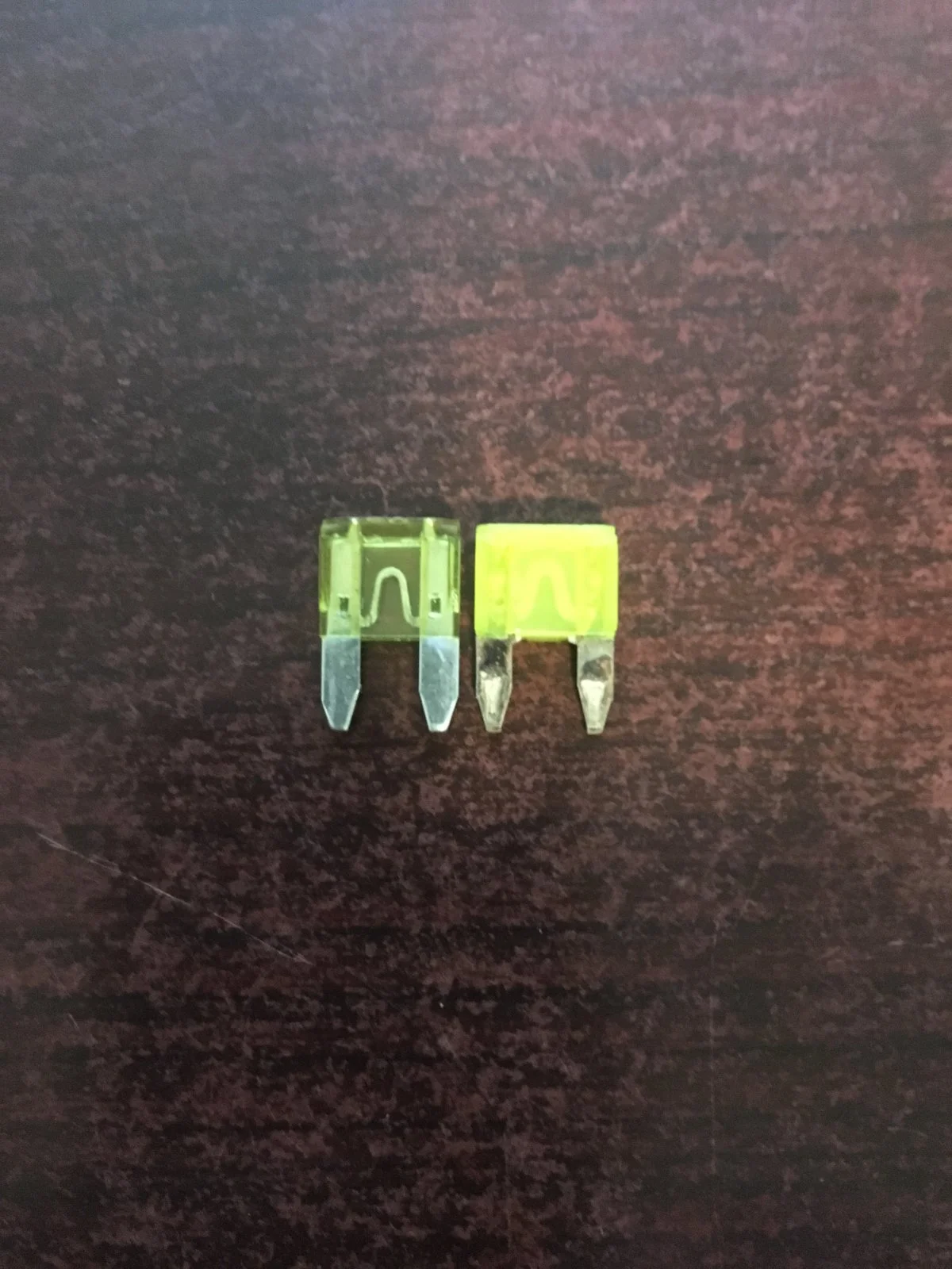

fuses I ordered did not fit. too thin and wouldn't hold tight in the fuse box...but I got the radio to work even without replacing the missing fuse in the fuse box. I am guessing this is because the radio has its own fuse and that is kind of a bypass to it. The ground cables all get put together in case anyone wants to know.
HOWEVER the 2 bottom door speakers aren't working - well they work but I don't know if the radio harness is right that they don't play sound or if they are just super quiet... That ALSO brings up the 2 amps in the trunk. They do not work at all - this could be because the radio harness isn't right and isn't turning them on. I'm not too sure here. I did test them by swapping them around/unplugging them plugging them in and it doesn't change the sound to any speakers that I can tell.
:edit I have been checking with a audio forum to pretty much get a little guidance so that to make sure I atleast don't burn down the car.
* I may just replace the radio since its old anyways and with that a new harness and dash kit and let a pro install it and diagnose the "issues"

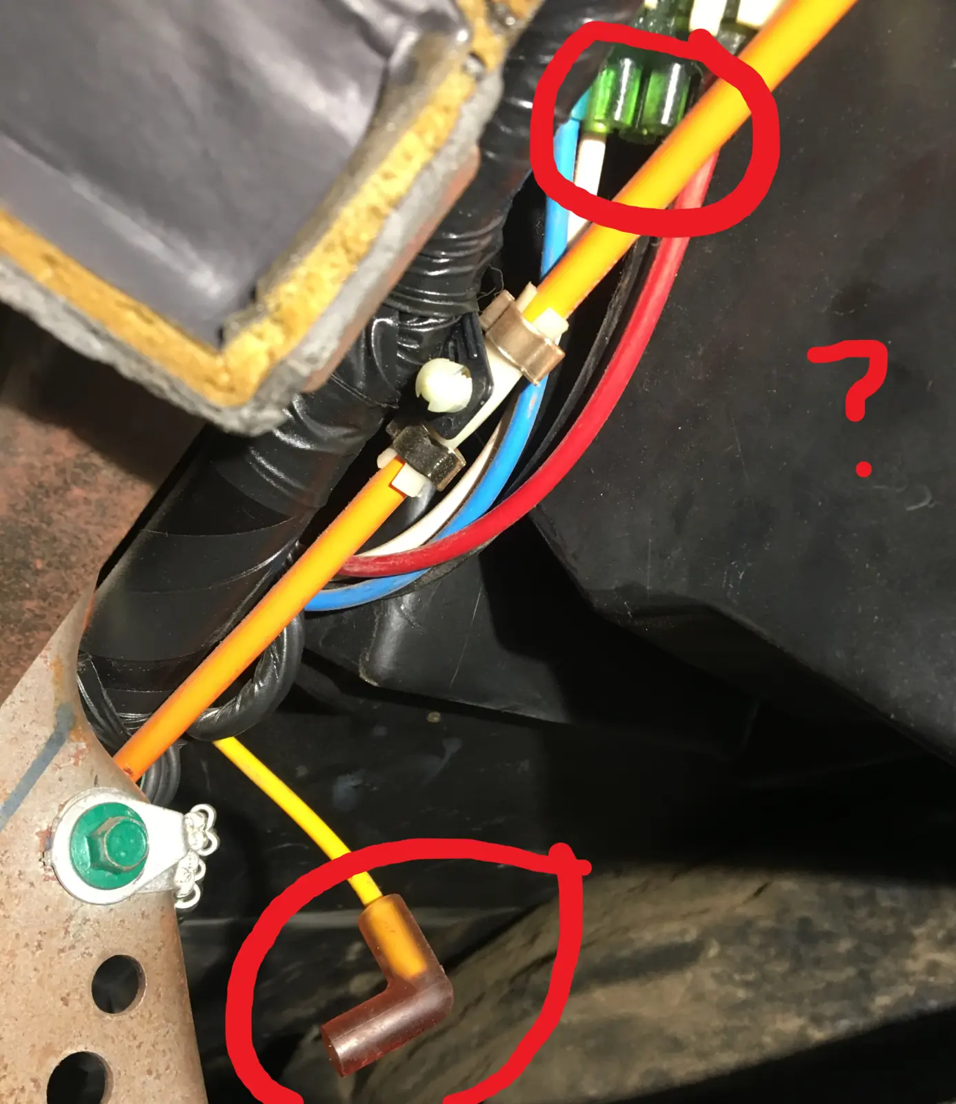

As for the AC system - I didn't do much but research. I still need some fuses to get started here. - I did find a mystery wire - not sure if it is related to the AC system. Maybe someone can help me out here? check picture below.
ordered new stuff - fuses (have to return) I will probably just go with local parts store for fuses even though they are more expensive now.

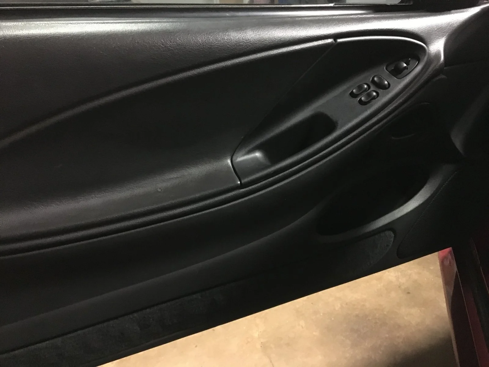

- interior door handles ( painting them did not come out how I wanted so I just replaced them )

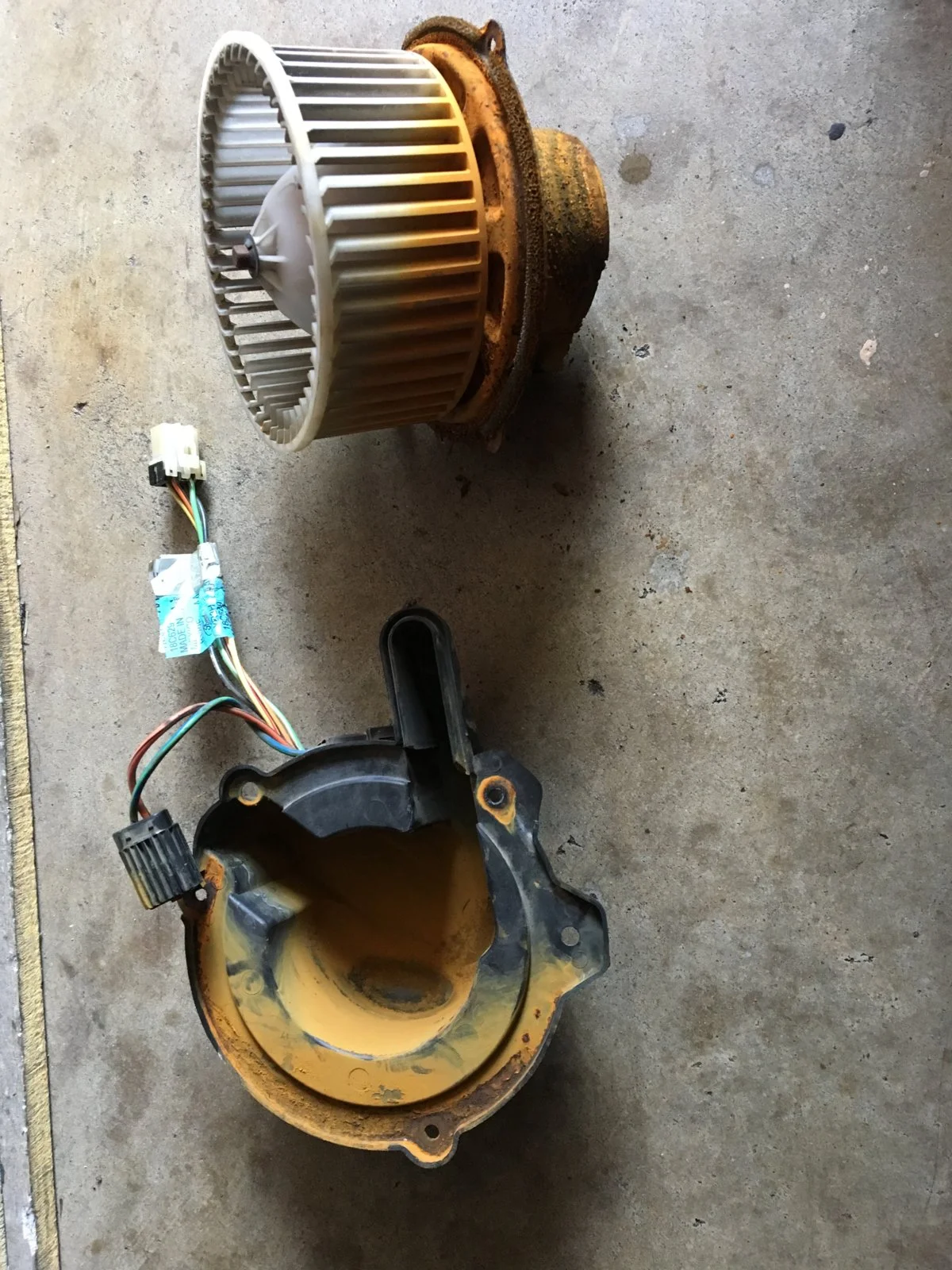

* no air is coming out of any vents - blower fan broken possibly? which is why no air is coming out of vents?
blower motor fan doesn't spin/make any noise - removed it to check it out; re plugged in still nothing
EDIT: radio subs WORKS, all speakers WORK! - double checked fuses - incorrect fuses swapped out ( gt fuse diagram IS different from v6 slightly ) but also not only check if fuses work but check if they are correct amps.. anyways that one thing fixed. HOWEVER radio doesn't save settings - might be because of harness wiring or because I keep disconnecting battery.
*2 fuses ( check pic ) I think are suppose to be 30 amp fuses for the AMPS however the fuses when I put in do not hold and the subs work even without those fuses because of the fuses under the dash I believe. and 1 fuse under the dash for the "positive crankcase ventilation heater" I currently have 5a for it instead of the 2a which I will replace asap.

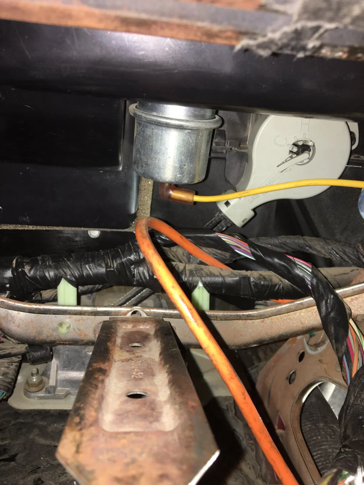

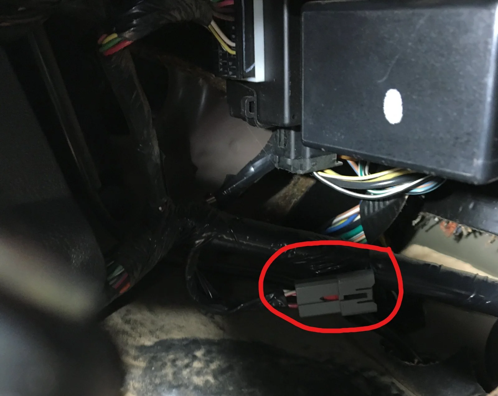

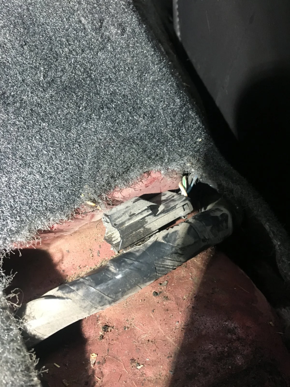

and on a final note: more mystery connections - under steering wheel by foot pedals and one under the center arm rest which I forgot to mention but I don't think its anything important.

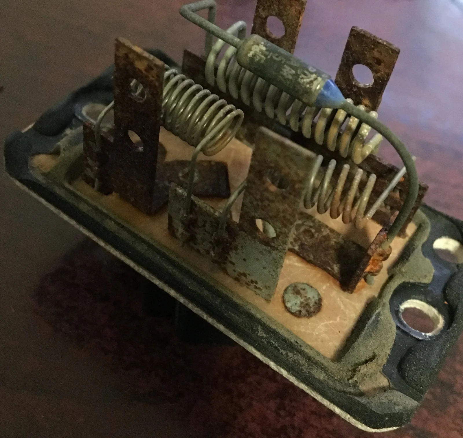

blower motor failed test - ordered a new replacement
blower motor resistor STILL works - ORDERED a new one anyways (too rusty and may as well upgrade with a new blower.

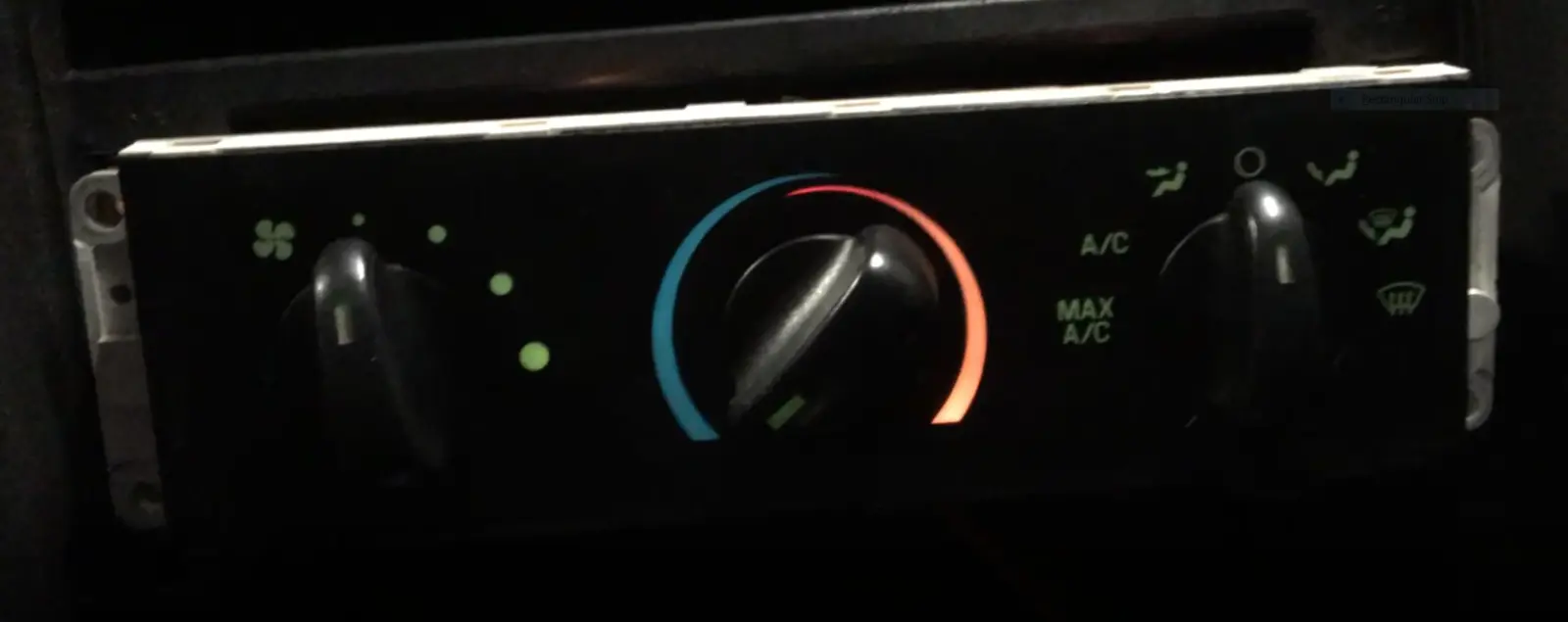

LED lights installed on dash/AC controls - went with white LED to make the stock green brighter. will post pictures next week.
I will be removing headliner to inspect and install a dome light.

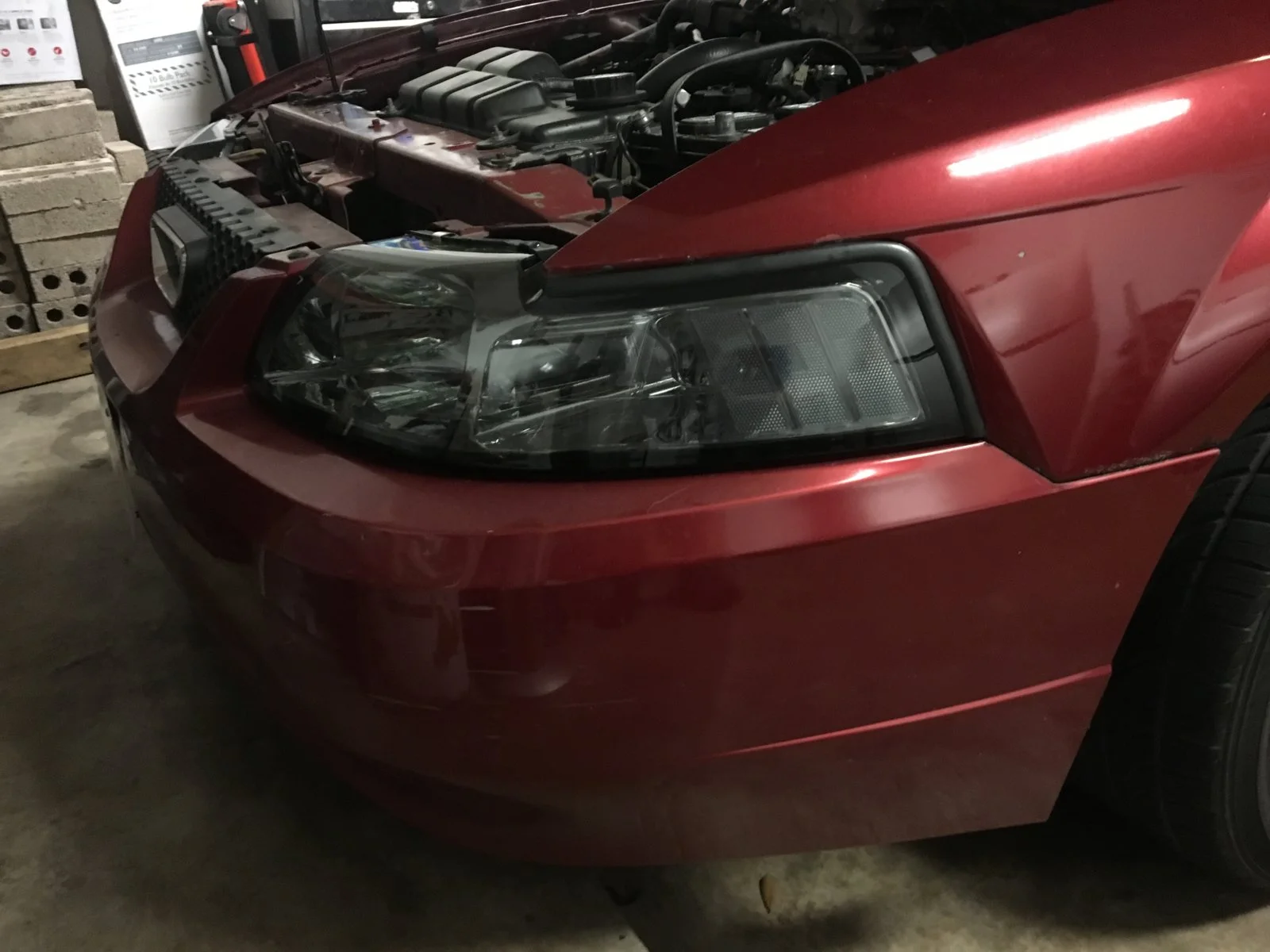

installed -
dash leds
"new" bumper and grill

***Installed new blower motor/resistor and the AC system is complete... IT WORKS! I also have some refrigerant that I will add to the system if it is low later but it did feel cool.

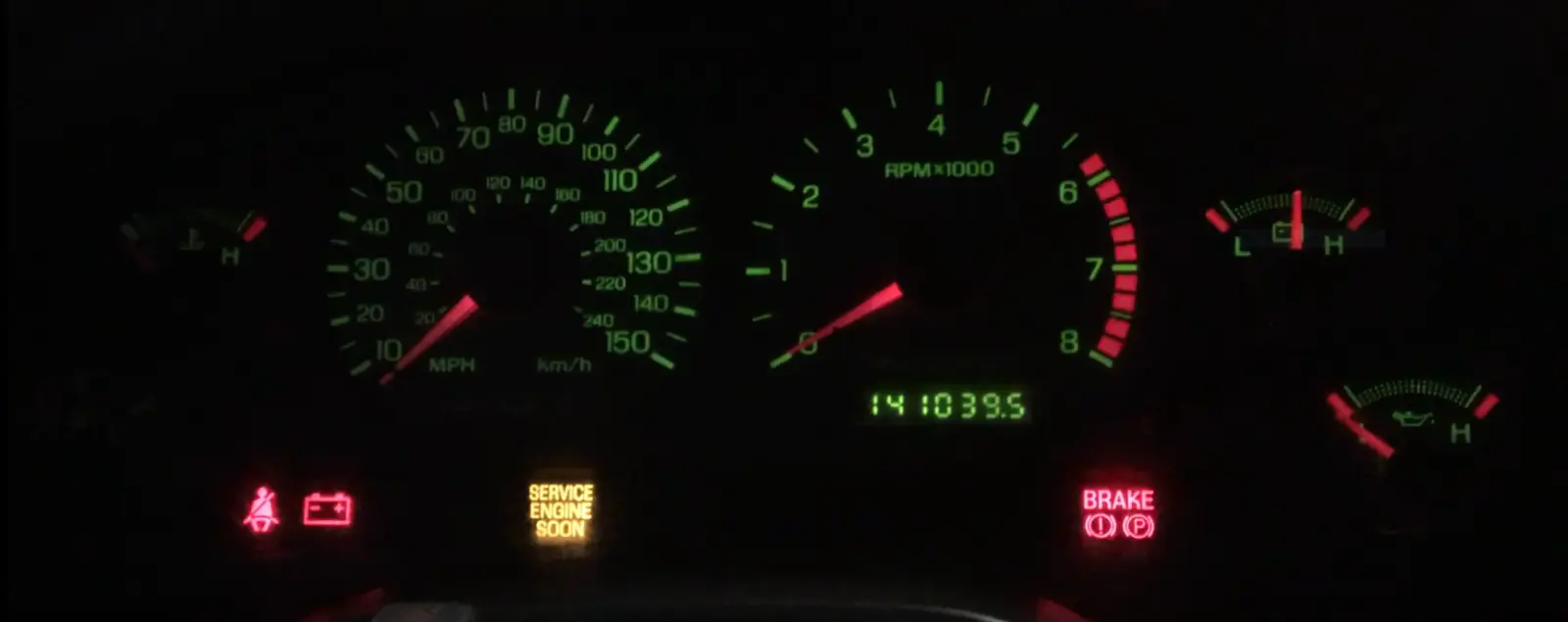

BOOM - p1130/p1131/p1132/p1150/p1152 CODES (codes did not all pop up at the same time)
