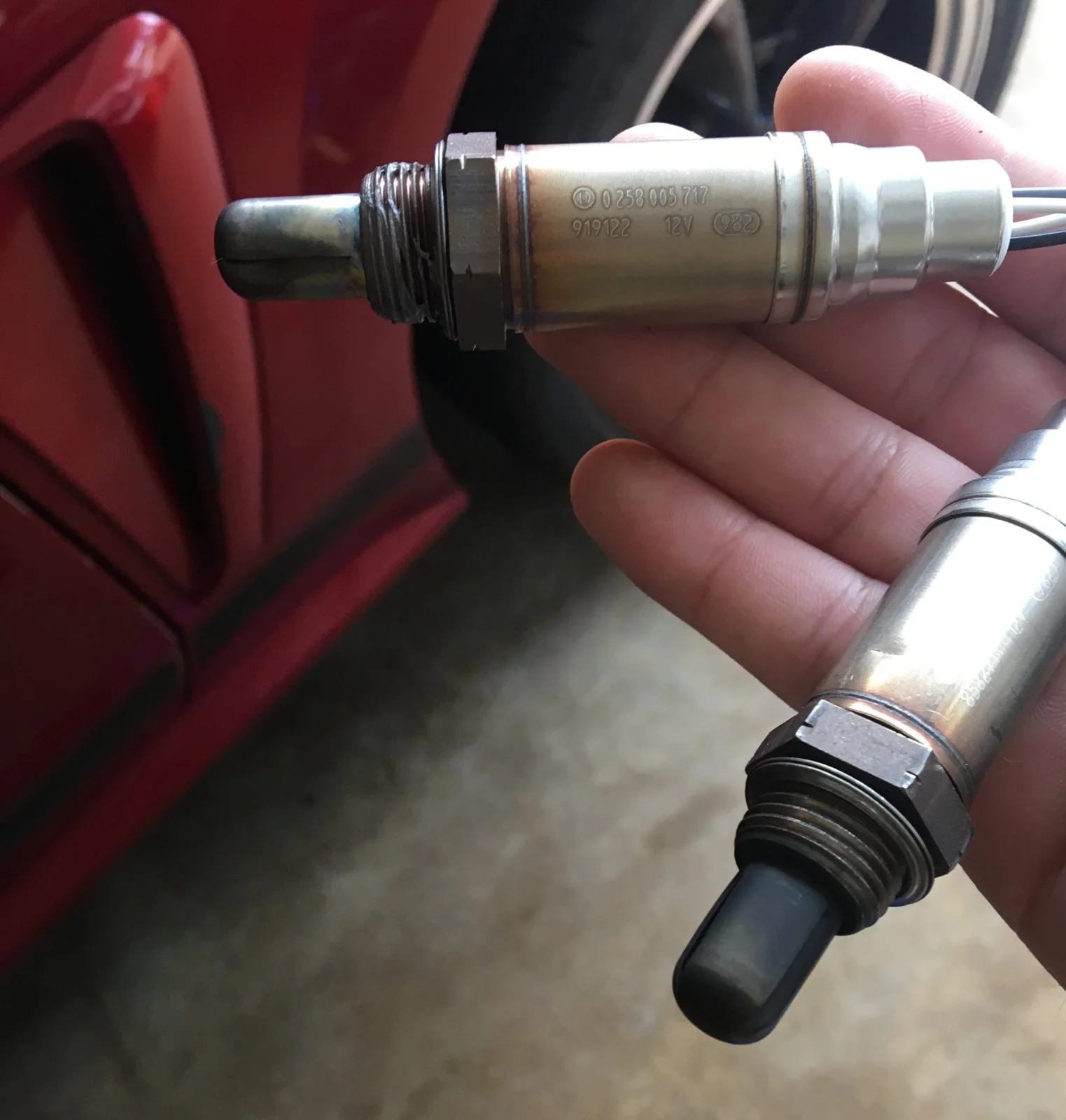

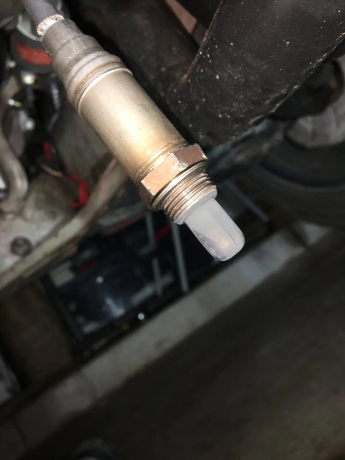

removed the o2 sensors on the headers - take a look at the pictures
0 258 005 717 858271/858261 bosch sensor I believe - had black soot on it, no water contents, cleaned it by wiping with a shop towel and its pretty black compared to the new rear o2 sensors that aren''t even covered in any sort of soot.
changed the f2 8 fuse again just for good measure

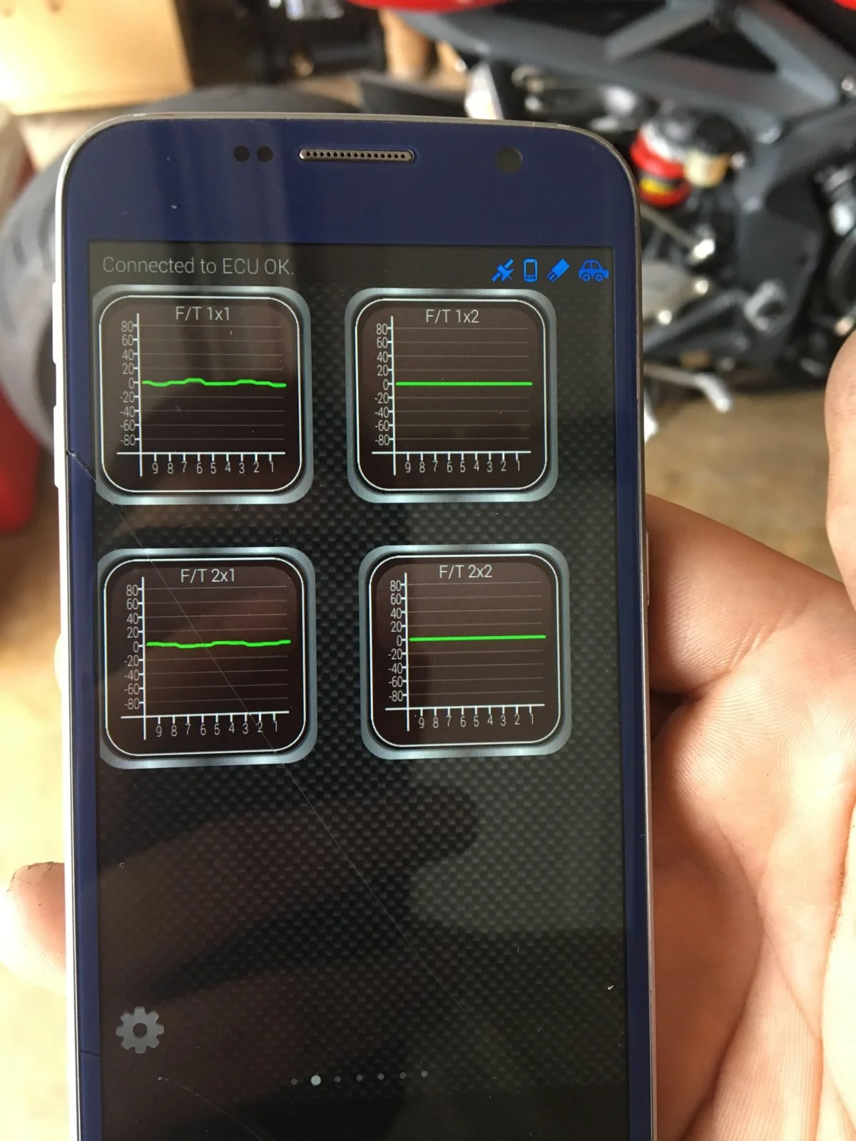

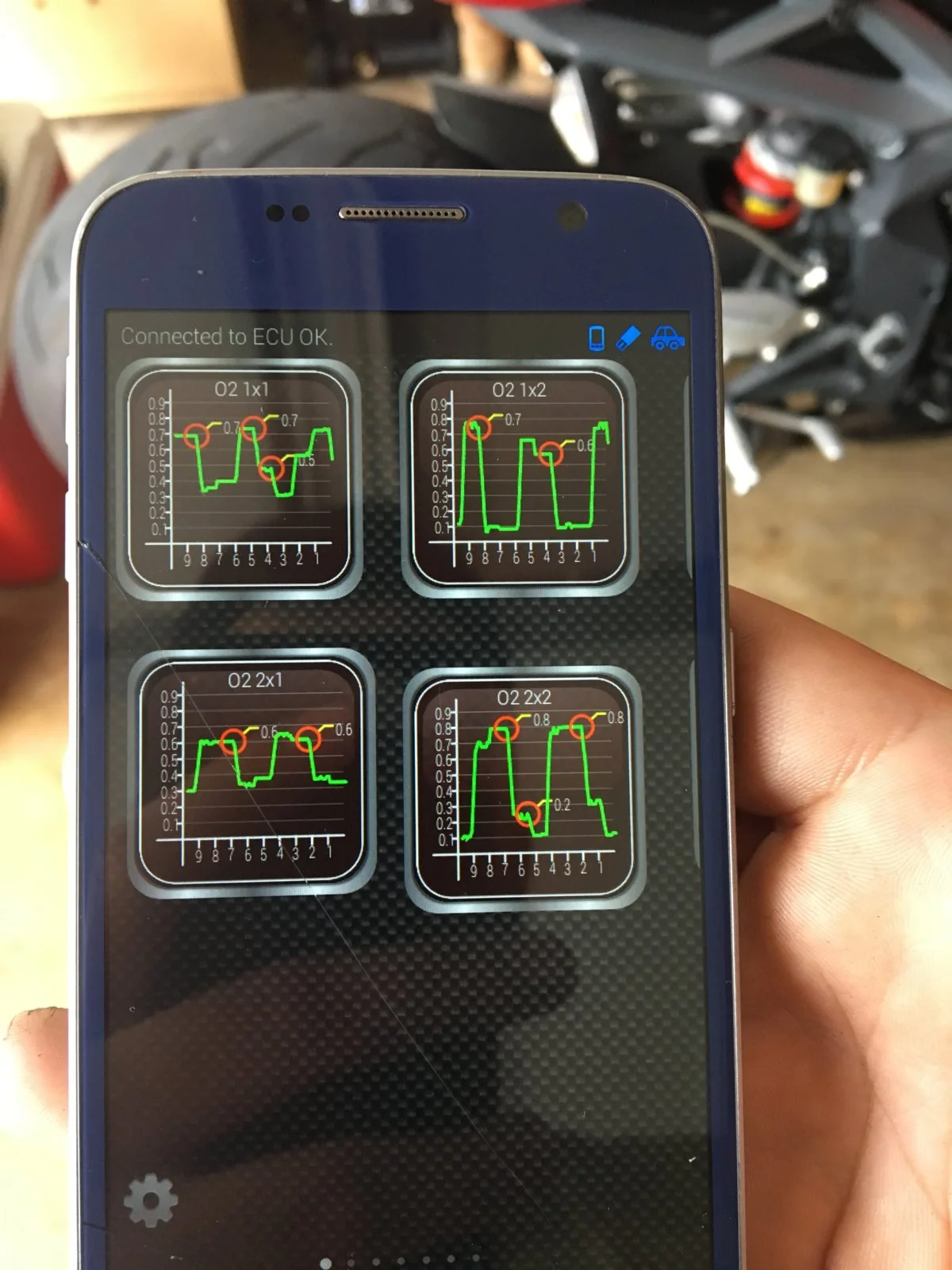

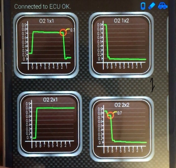

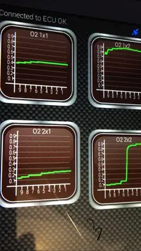

codes returned - p1130 p1131 p1150 p1151
obd 2 scan voltage results

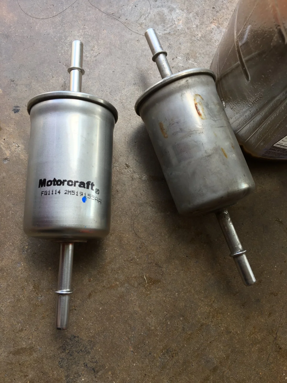

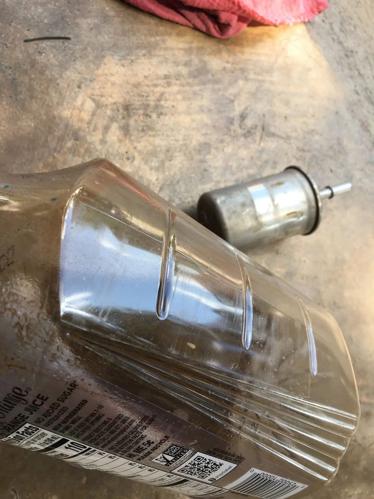

replaced fuel filter, it didn't feel clogged but still had nasty residue on the inside.

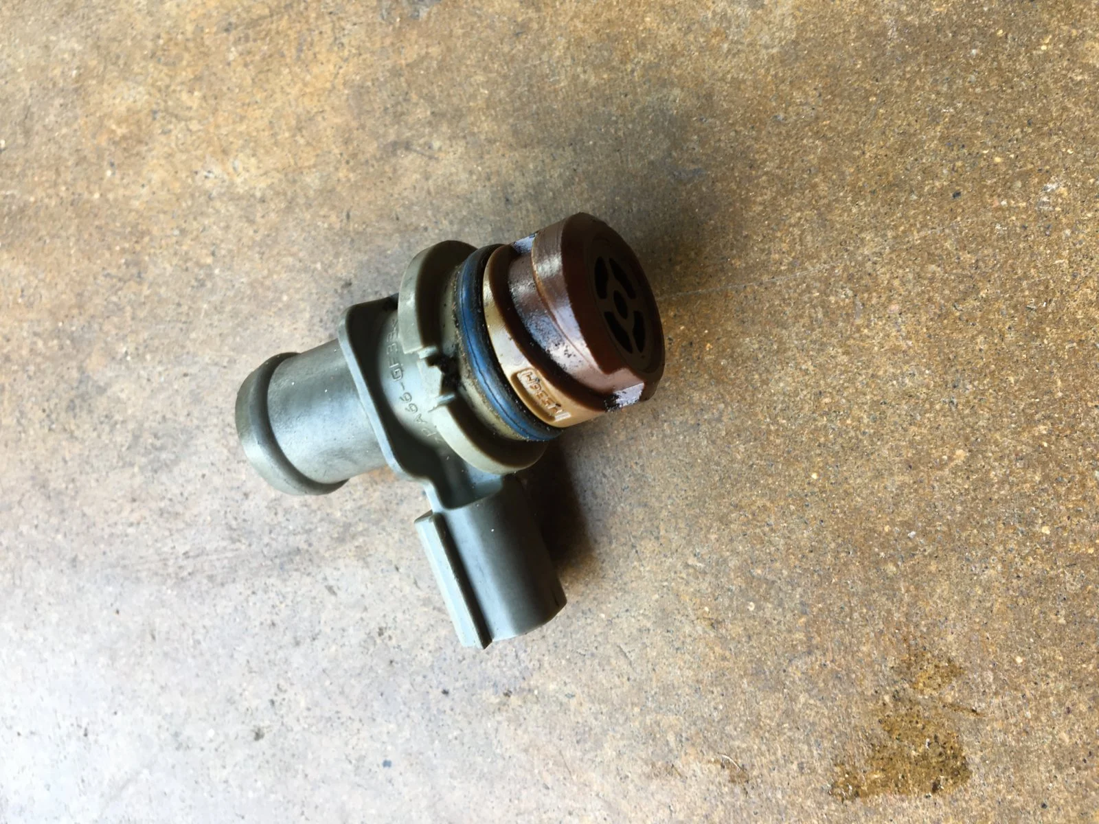

also here is the old pcv valve

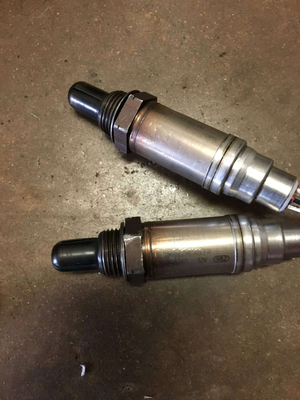

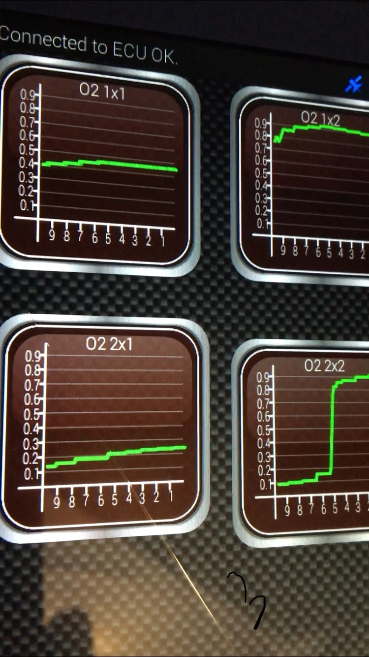

installed new o2 sensors
p1151 is the only code left
I revved the car once or twice very little after a couple of mins of warming up and engine turned off
I have a 5qt oil pan, is 5.5q too much? I am guessing at this point - oil overfill is the only thing I can think of besides the EGR.. I don't know.
bad cylinder/fuel injectors would be my second guess..I think It has to be something I changed or done. hmm. I'll remove .5 of a quart tonight or tomorrow morning.

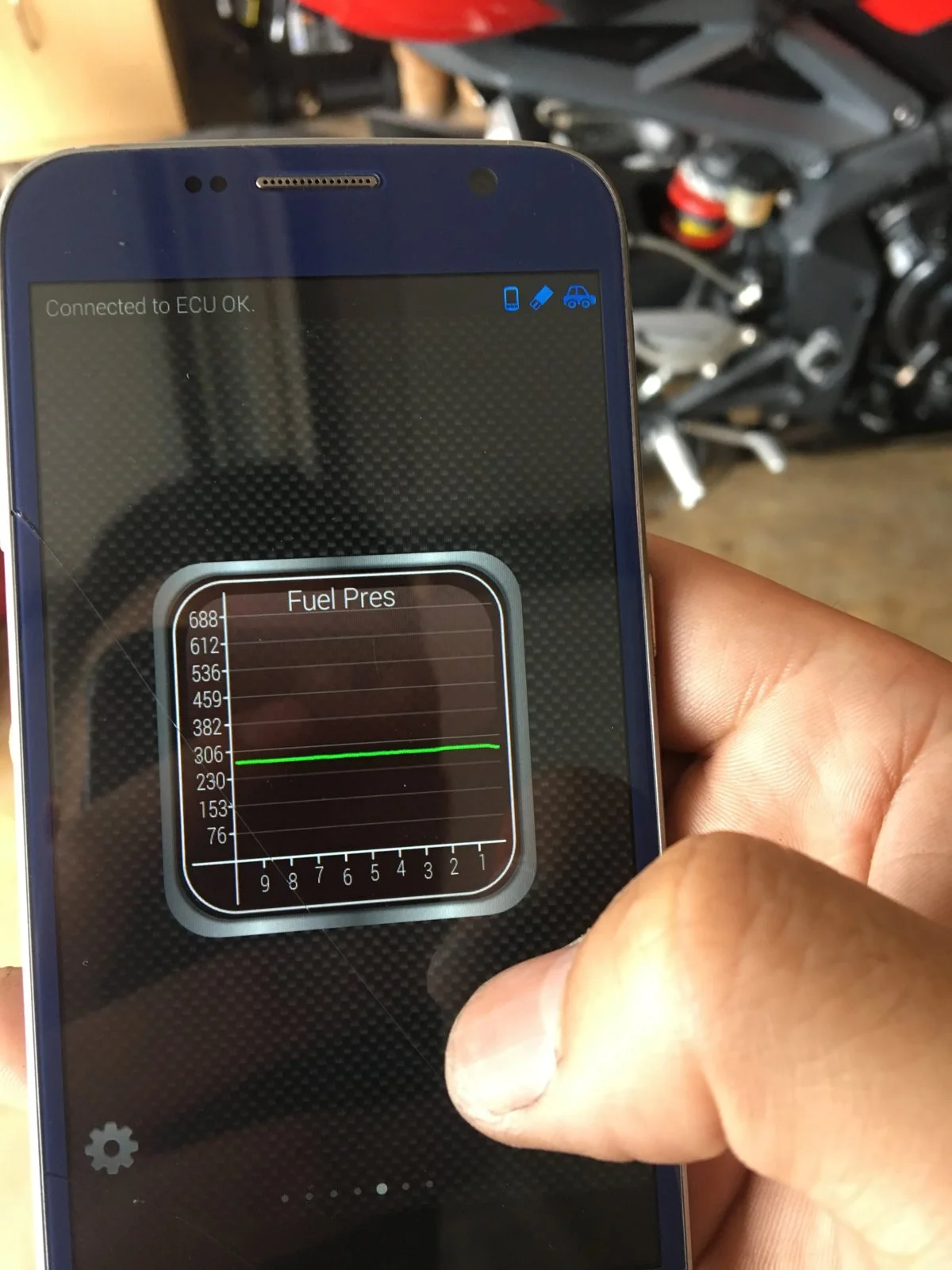

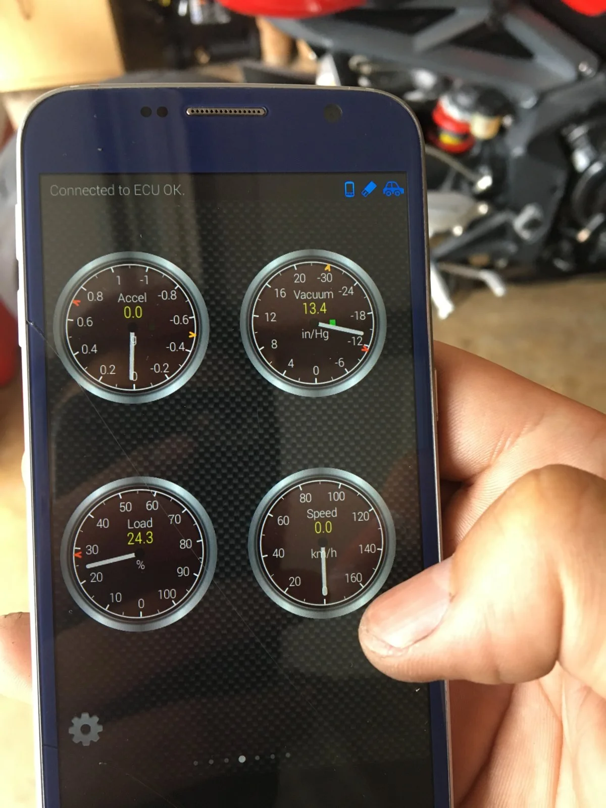

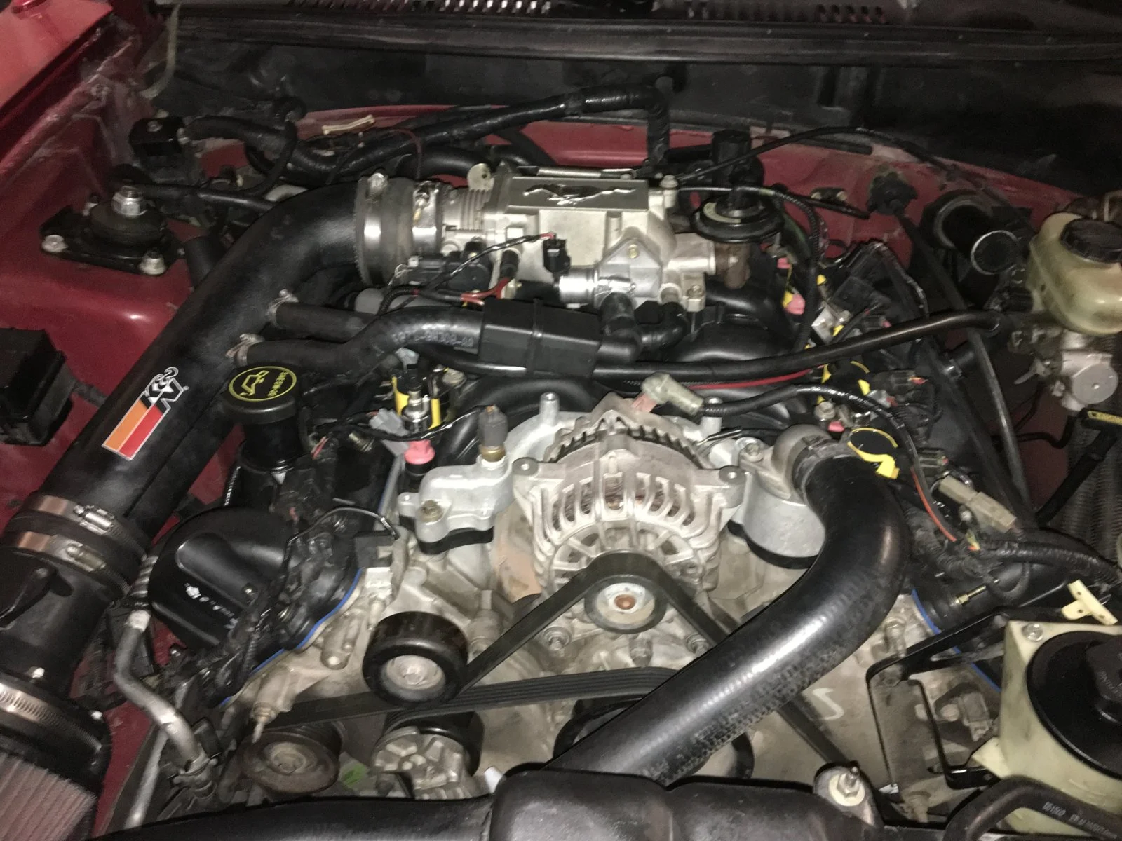

well short break ended sooner then I thought.
What I did in this short amount of time:

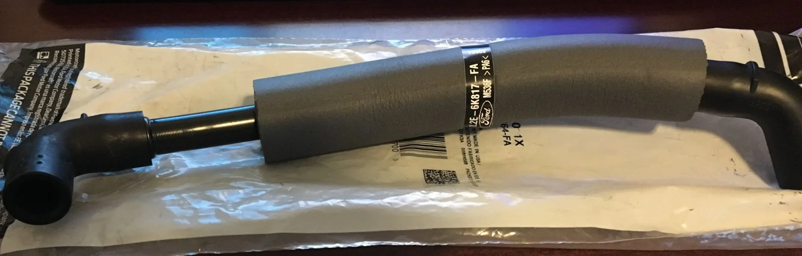

Ordered and installed a new OEM PCV valve hose
Ordered and used EVAP smoke machine

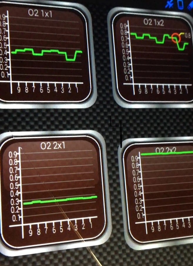

Checked the MAF readings carefully on OBD2 Scanner tool

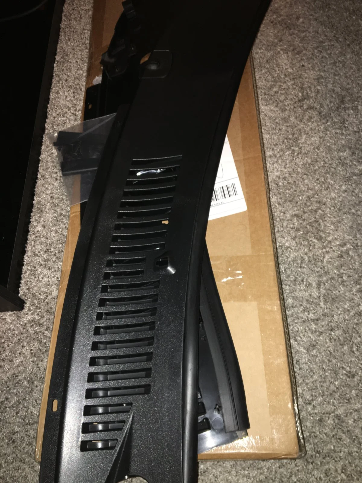

installed new windshield cowl ( not important )
Smoke test - didn't find any leaks and plugging up some hoses with aluminum tape didn't help either. However I noticed a little bit of smoke and I mean A LITTLE coming from the top of the EGR valve.
Removed the EGR Valve and inspected it. Gasket is shredded however no leaks from that.. I think. I noticed that the metal line going from the EGR to the header was loose - like I removed it with my hand. hmm..
Cleaned it with carb/choke cleaner
Reinstalled and made sure to snug everything back up.
Ran the car for 6-7mins (recorded this)
IDLE is at 1000RPM
Reving the car brings it down to 750-1K area and stabilizes like it should again. This is great! It isn't dying like before or engine shaking.
P1151 Code is still active - I didn't delete it or take off battery so that's normal.
I am letting the car cool down right now before I reset the code and run it again and hopefully the code doesn't come back immediately.
Lastly - I have a friend who works at a dealership. He gave me permission to access his network. The biggest thing with P1151 code is that the MAF sensor went bad and sometimes the PCV valve is bad too. As for vacuum leaks - not so much. So lastly I kept a good eye on the MAF sensor reading on my OBD2 scanner. As I rev the car up the number increases and as the engine decelerates it goes back down. So It is working correctly. (I think) :)
Pictures are of changes and current amount of smoke from exhaust (thin and very little amount) (laughable amount but it is there) before it would be a lot more almost like being next to someone smoking a cigarette. I can guess maybe the fumes from the valve covers weren't being removed fast enough? or maybe the egr has something to do with that? I don't know.
The smoke is something I will keep a eye on - coolant levels/oil levels - it could be oil or coolant being burnt or dripped into the cylinders. I still haven't looked at the spark plugs. I am hoping to get this code cleared and removed for good before doing that if possible.
Later this afternoon I will find out if the code is gone for good or if I have a bigger battle awaiting me still.

MAF sits at 4.9 - 5.0 g.s at idle

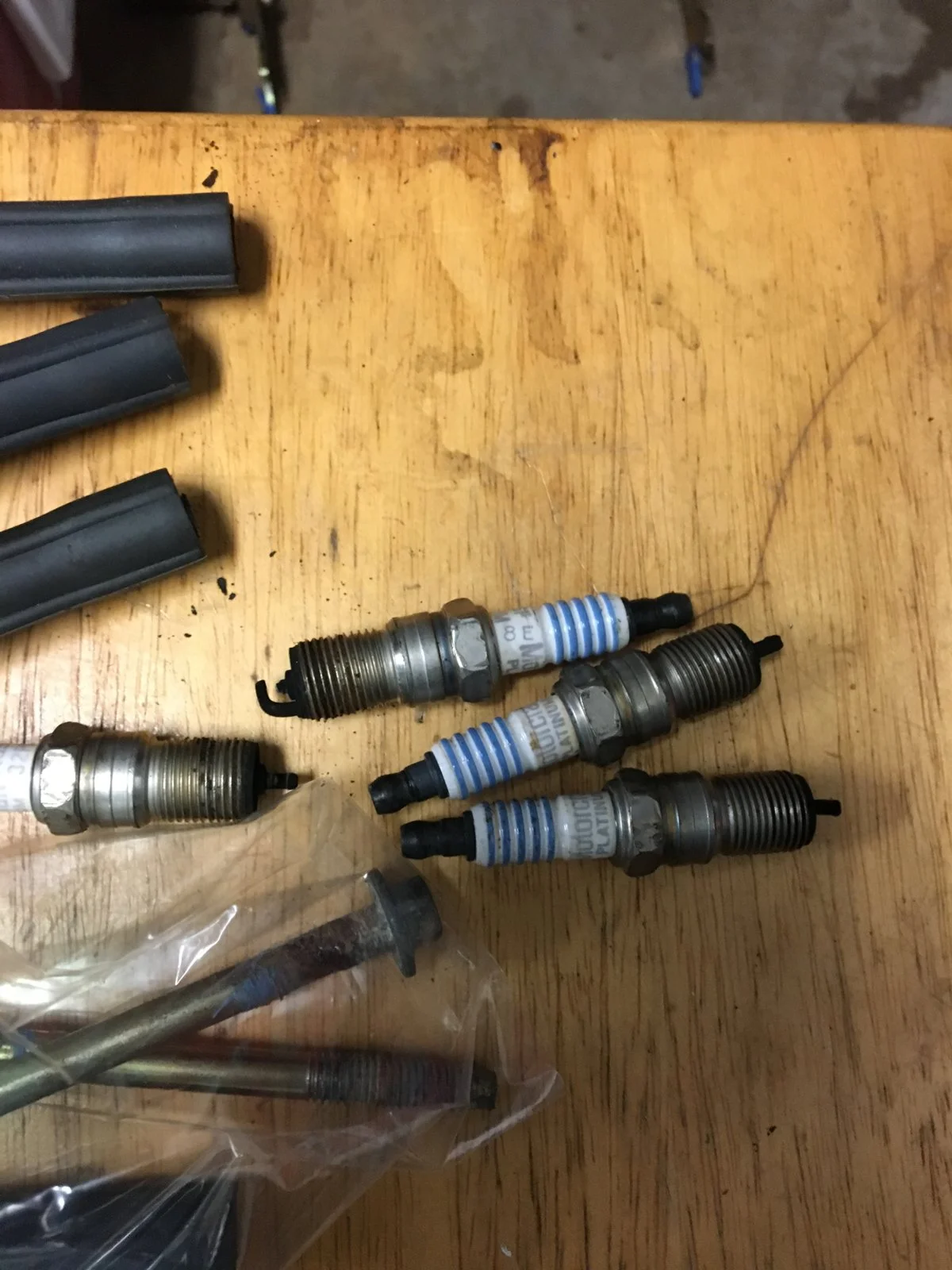

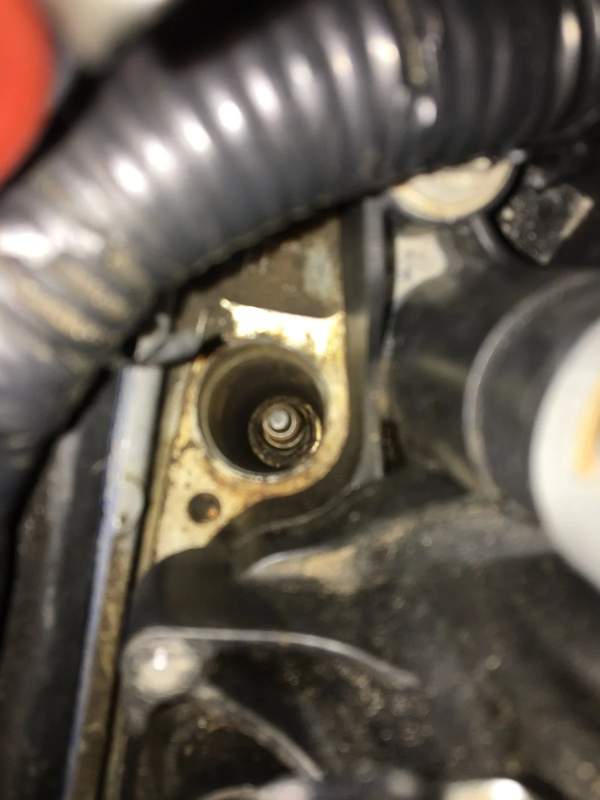

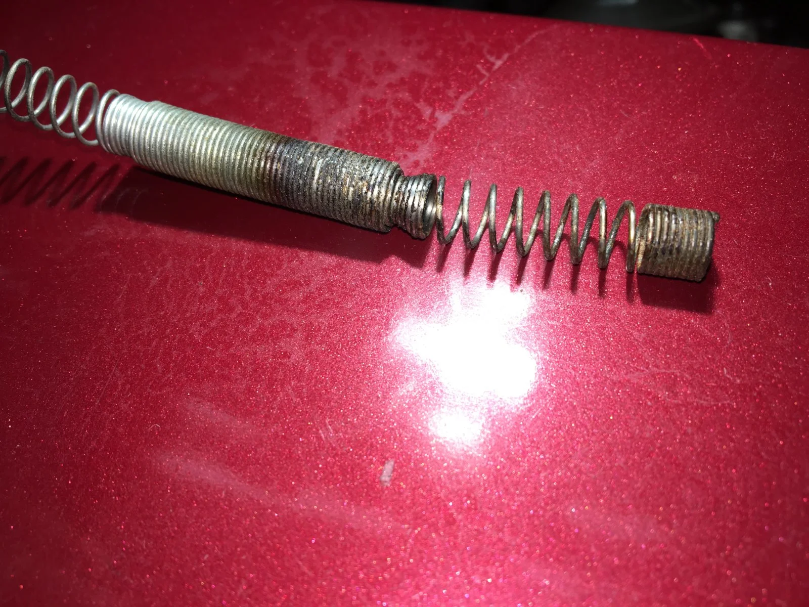

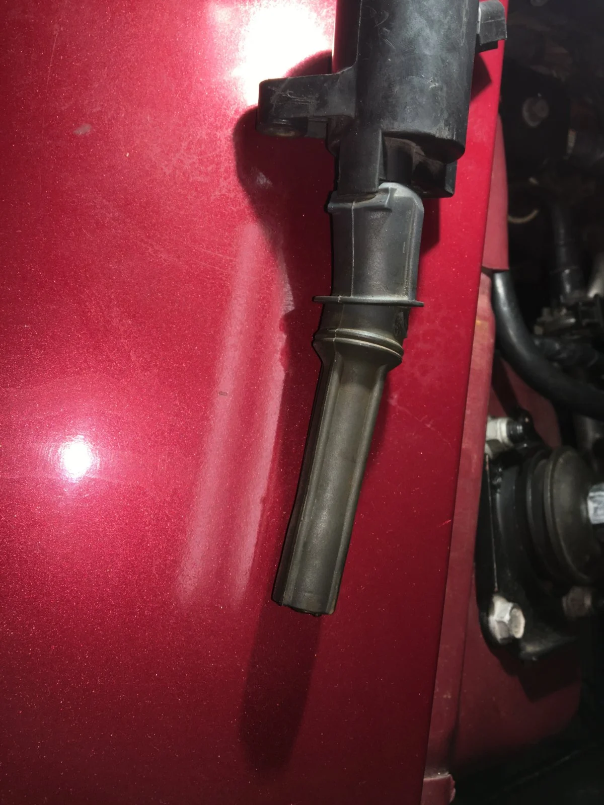

I am checking the spark plugs and I notice how dirty the inside of the spark plug well is, dirt and small residue but no coolant or oil. I haven't removed them as I will try to clean as much as possible to keep things clean.
The coil plugs or whatever they are called - some are rusty/corroded/burnt looking?
Maybe my obd2 sucks and isn't detecting a misfire which then adds more fuel and thus thinking it is running lean I don't know but by the looks of the spark plug area I am going to just take a wild guess and say the injectors are probably bad too and or need a good cleaning.
I am going to get my compressor and get a towel and clean a little bit more before removing the spark plugs. I will probably remove the injectors and get the intake manifold off as well to inspect before sunset.

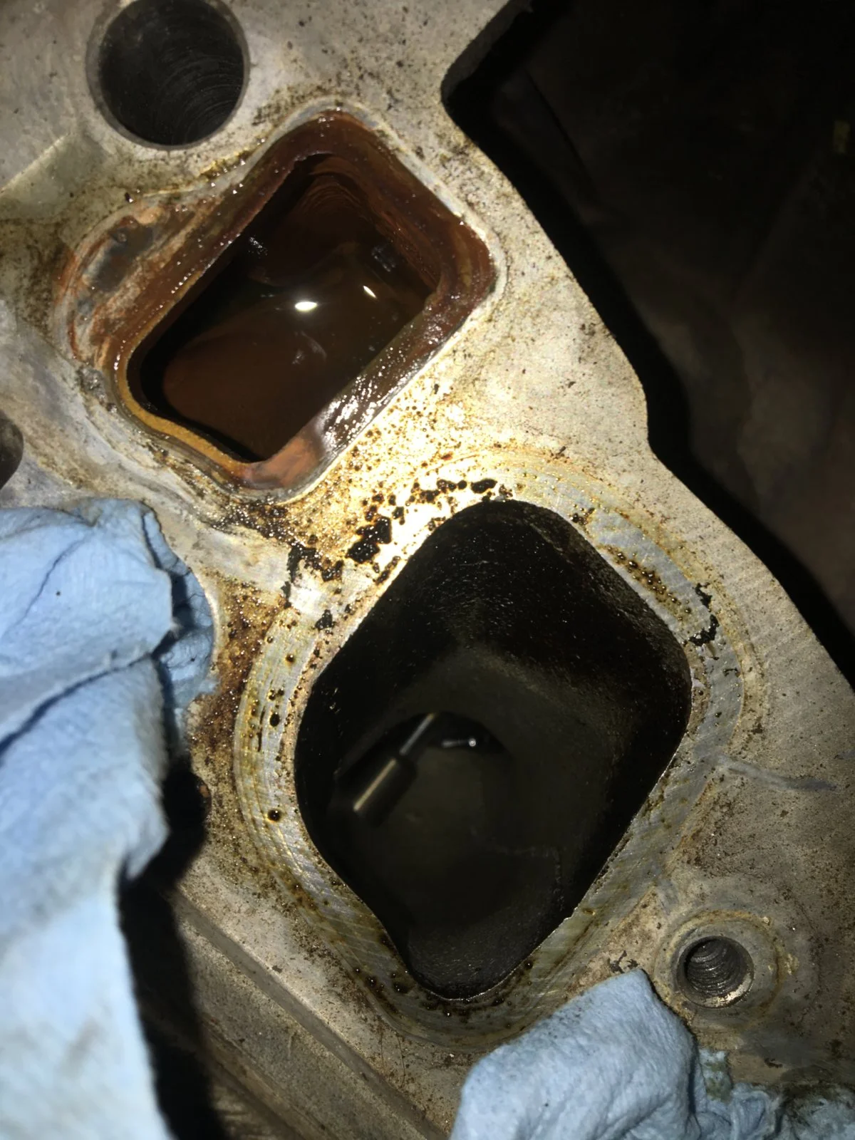

There is no coolant leaking into any of the ports/spark plug holes
Spark plugs are not wet but are super black - Carbon deposit? - ??

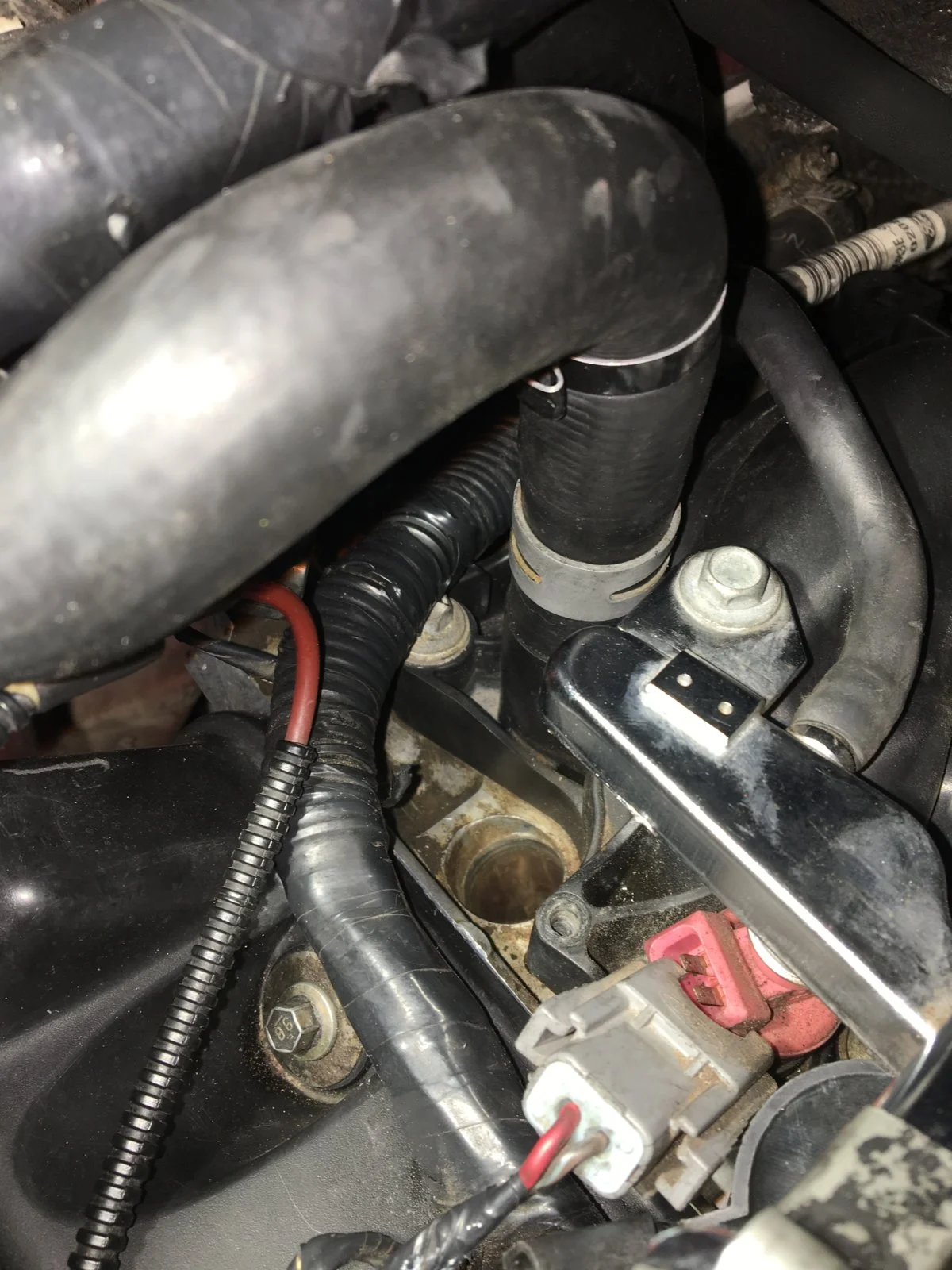

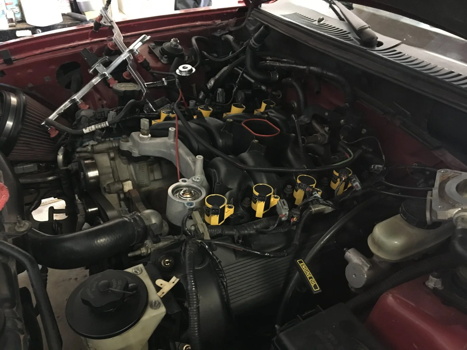

So picture this, standing in front of the front bumper and removing the passenger side fuel rail. The far back injector (4) closest to fire fall comes out. Gushing fuel out. I clean it as best as I can and put a rag under to get as much fuel.
Injector fell out. It was loose considering I removed the driver side and no injector fell out. Maybe it just happens.

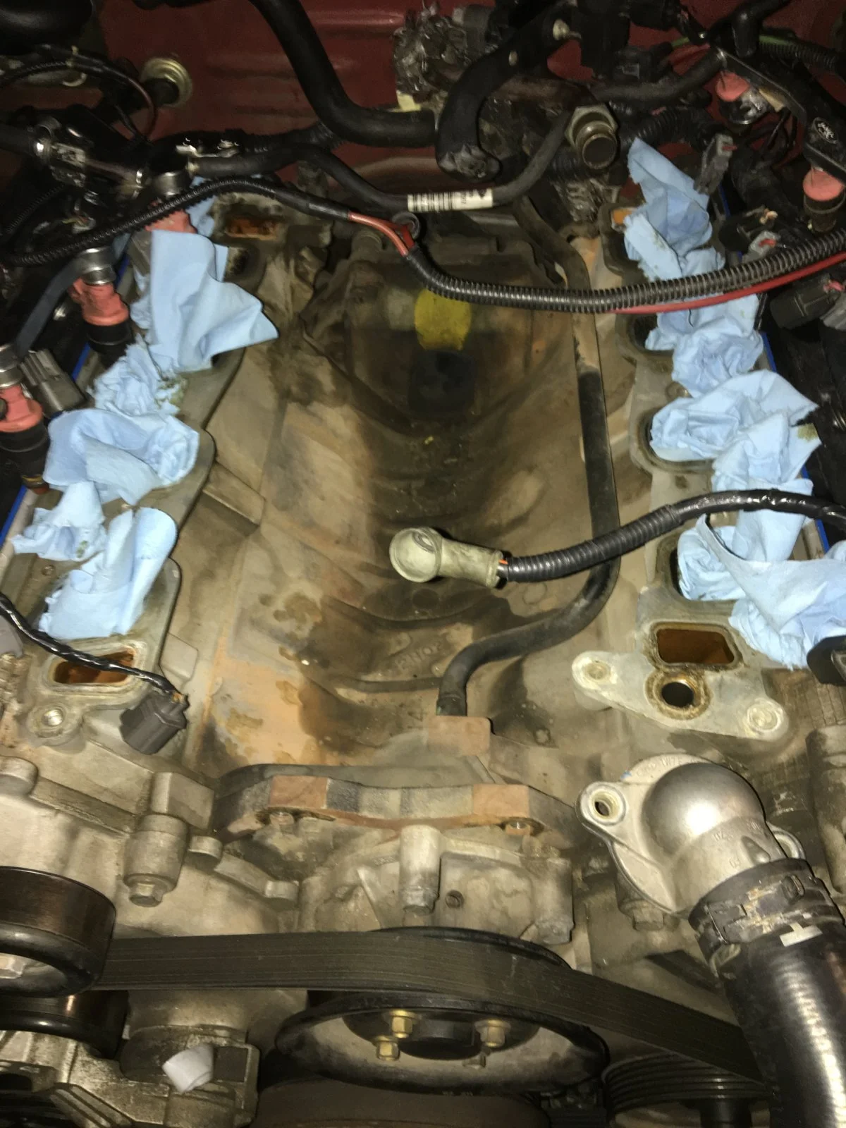

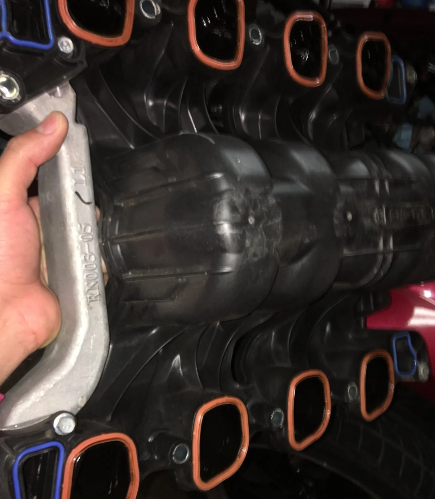

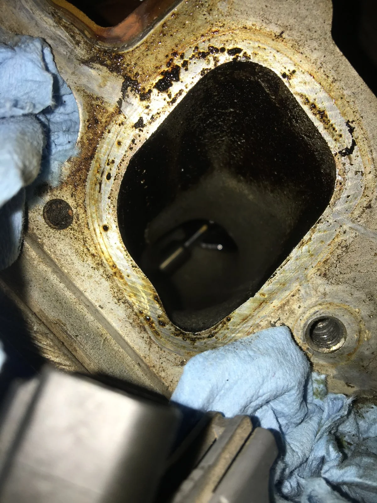

Moving along - Intake manifold gets removed - so again picture this in the same way - the passenger side intake manifold gasket farthest from you (closest to fire wall) comes out but no other gasket is moved from its position. Loose gasket? Maybe or again just a coincidence.
Not sure where to move from here since I expected to find coolant everywhere lol.
Don't know if this is good or bad.
I will order new spark plugs, coils and gaskets.I will consider changing the thermostat and water pump too. I will also have to flush the system and get new coolant.
The injectors are dirty externally, nothing blocking the little holes though that I can see. I think I should get them tested and cleaned if still usable.
Anyone out there know whats up?

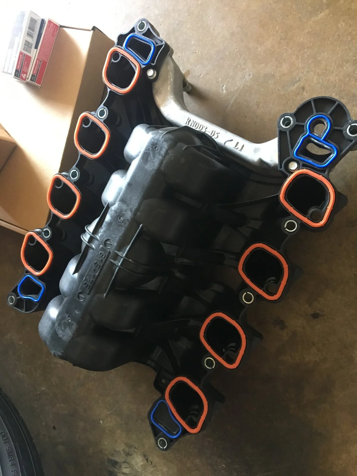

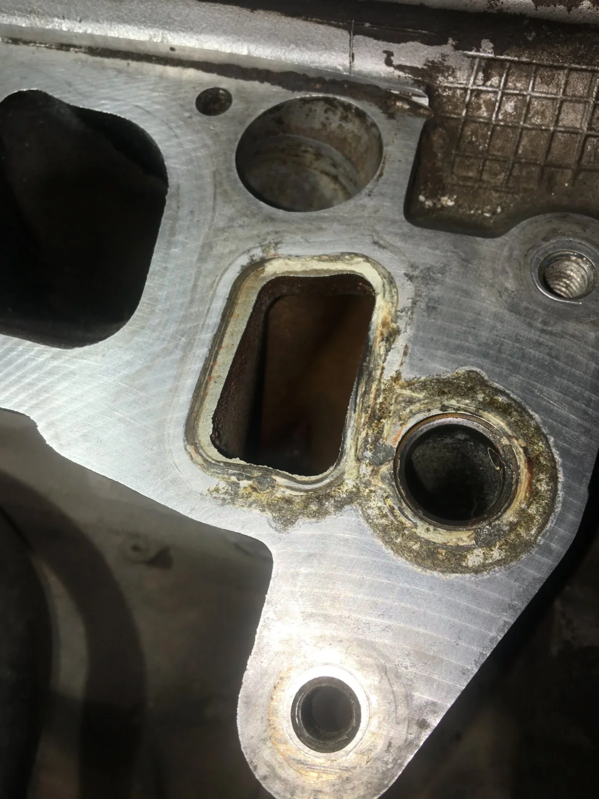

615 - 175g gasket is the one I need from the info on the intake, however I have to order from a website I am not familiar with. Anyone know if 615 - 175 GA is the replacement gasket for the 615 - 175g?
pictures below of gasket, no gasket on the engine side though. I guess that is how it is though.

cleaned intake manifold
cleaned mating surface
cleaned injectors - externally (tested with flat head - do tick consistently)
new intake manifold gaskets
new thermostat o ring seal - clean surface on hose side
new coil packs and spark plugs
coolant res. cleaned
cleaned maf
cleaned tb

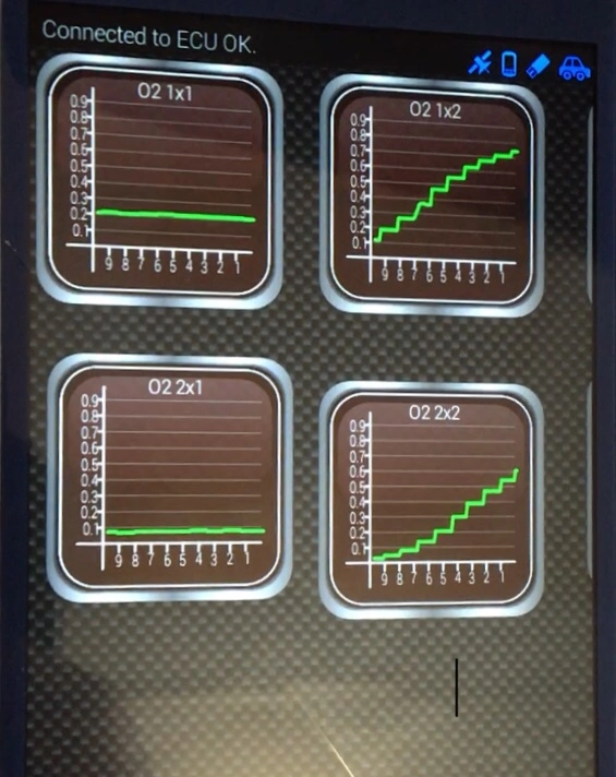

added about 1-2 gallons of distilled water and let engine warm up - car had noticeable amount of less "smoke" out of exhaust at idle.
Idle is now under 1K but higher then 750RPM for sure.
P1150, P1151, P1152 active.
revving produces the smoke from exhaust (not thick cloudy white) and doesn't stabilize like it should after the rev.

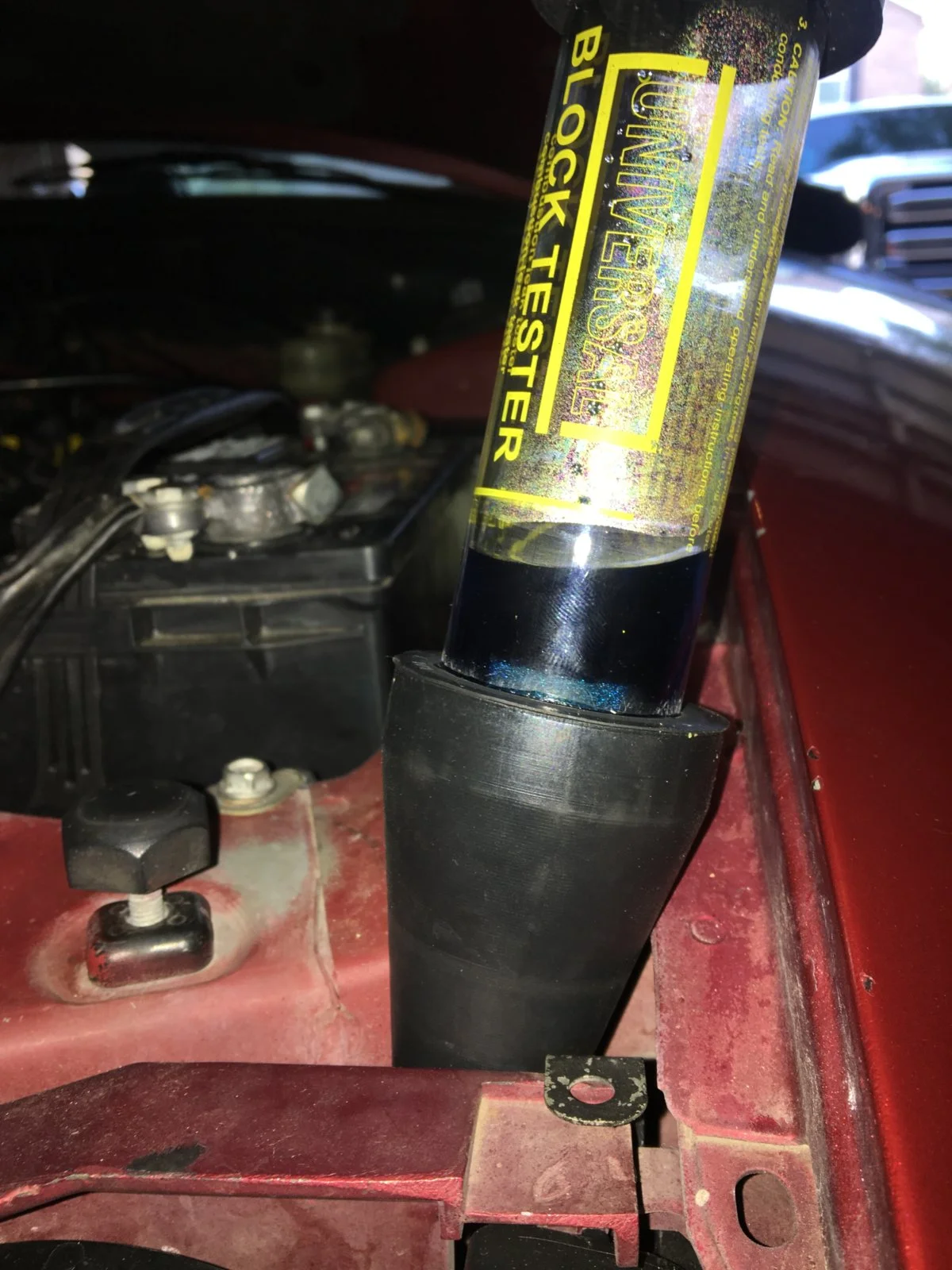

- Going to perform a head gasket leak test and another smoke test this Thursday afternoon

Result : Passed
I did another combustion test and still nothing.
I did a fuel pressure test at the fuel rail and the results are
: steady 29-30PSI at start
revving pushes it to 40 and drops to 20-25 area and then comes back to 29-30 when idle is found.
turned off car and held 28-30 psi for over 5mins
revving the car dropped the psi way too low and shows that the car is having a fueling issue. The PSI should be holding at 28+
