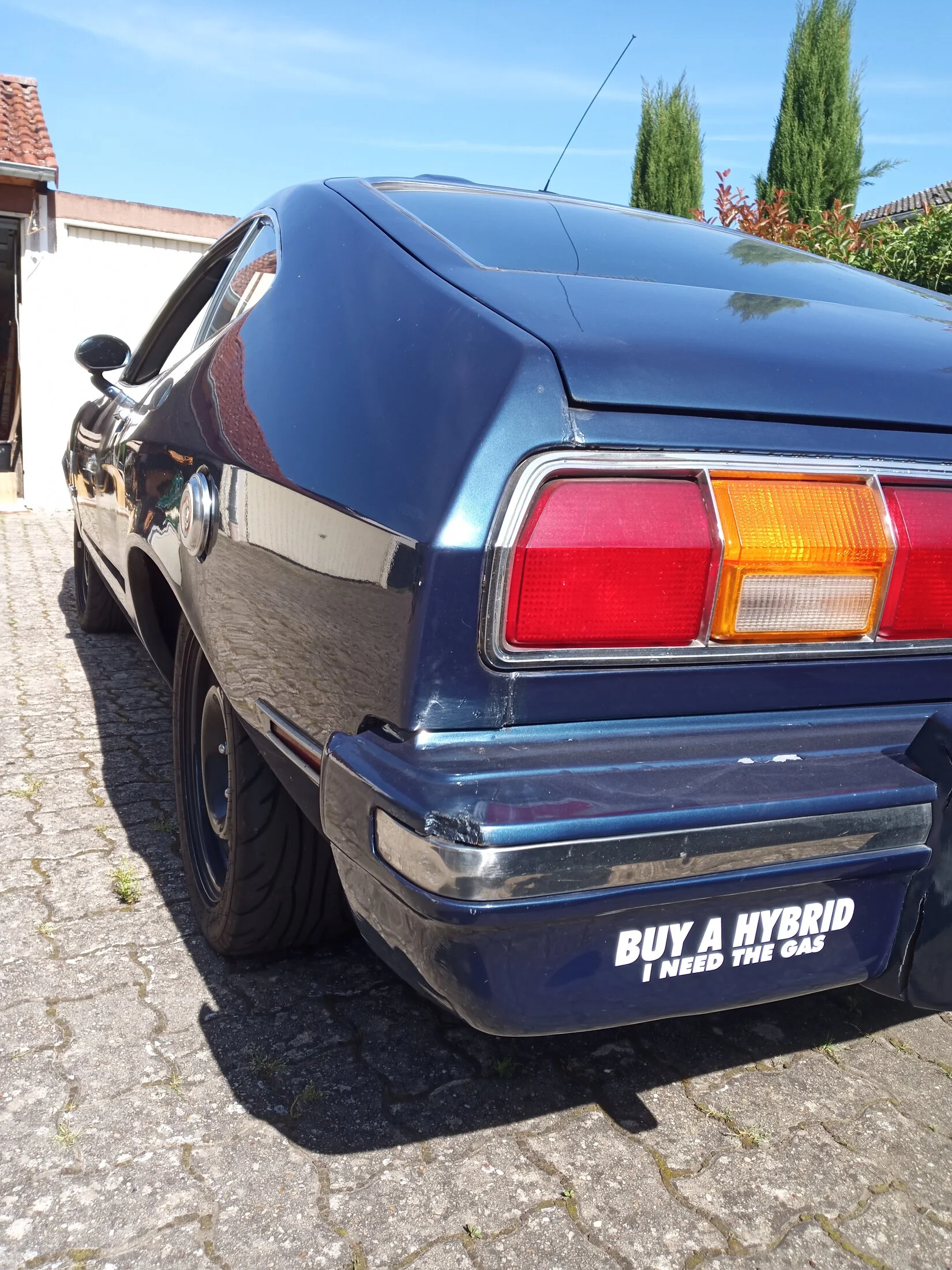

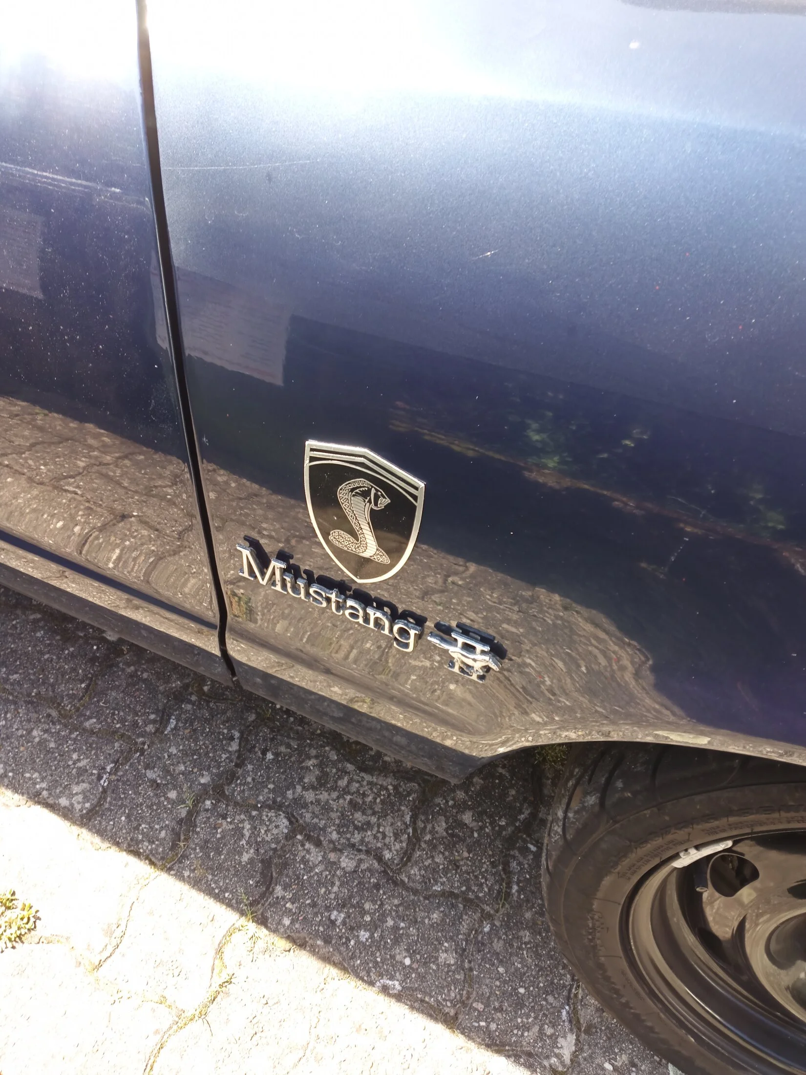

Still I have not much time for the Mustang II... Got a funny/provoking sticker and cobra signs on the fenders. Car is registered since two years and it now needs the biannual safety/TÜV inspection.
Beside small issues that where fixed fast (loose grant steering wheel adapter, loose connection at the reverse light switch) car is running just fine.
