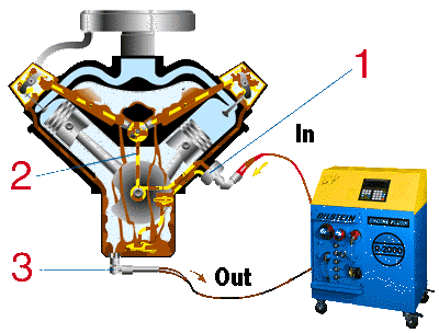

Is there a facility anywhere near you that has an engine flush machine and service?
Thanks for support everyone. Really!
@Noobz347 unfortunately not that I know, but a principle looks great!!!
When looking at it, it crossed in my mind about giving some diesel/wd40 spray/flush thru all drain holes of lower intake and valve gallery just minutes before letting old oil cold without cranking out the engine......then pouring oil on top after few hours of drain.
Call me stupid, but that would actually make me less scared than putting engine cleaner in 32 yo virgin crankcase, probbably full of sludge as upper part. Even if it does sound 'bad' or creepy at least.

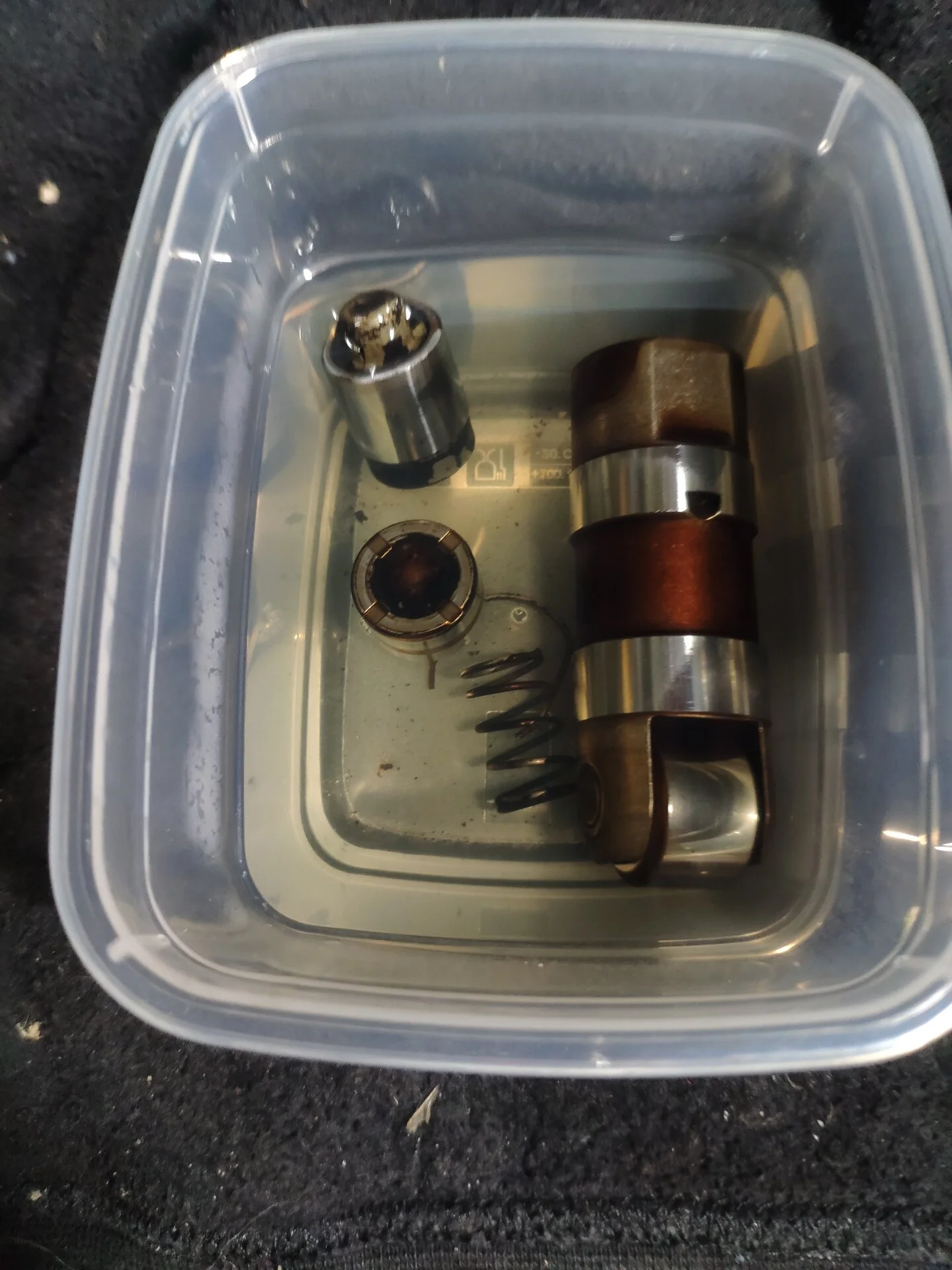

Okay guys, all 16 lifters soaking in petrol!
They were full of crud at the bottom piece in front of spring, ball valve bearly visible.
Picture of half washed during teardown... I hope that I wont get tractor diesel sound as an award for doing this nasty job :-(

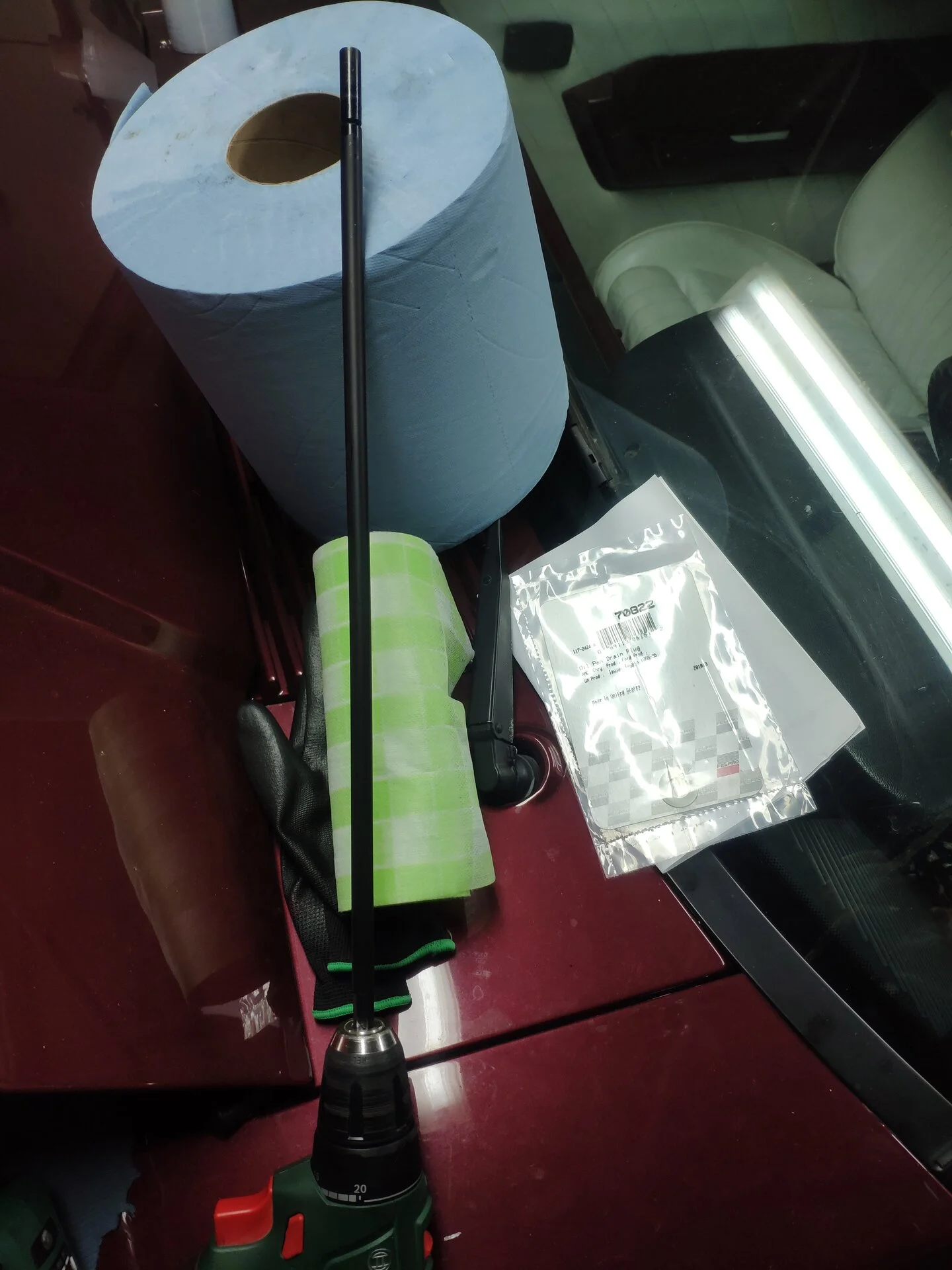

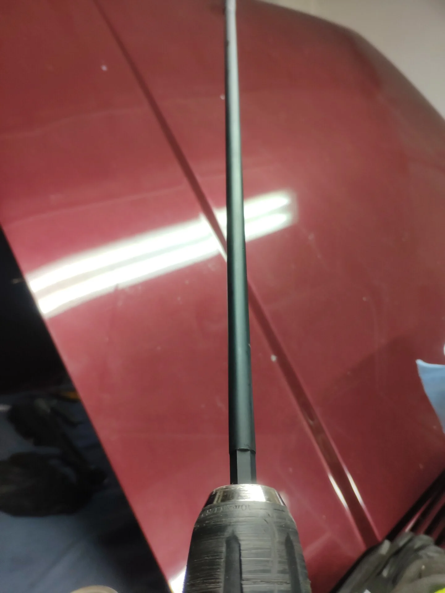

BUT, I have trouble finding proper priming tool to reach shaft, and there is fear of wrench extensions falling in, no matter how good I duct tape....
Get a tool to do it, some pull the plugs and crank the engine to prime it but I don't recommend that for a new build.
Uff, done for 2nd and 3rd time...thank You for suggestions @General karthief !

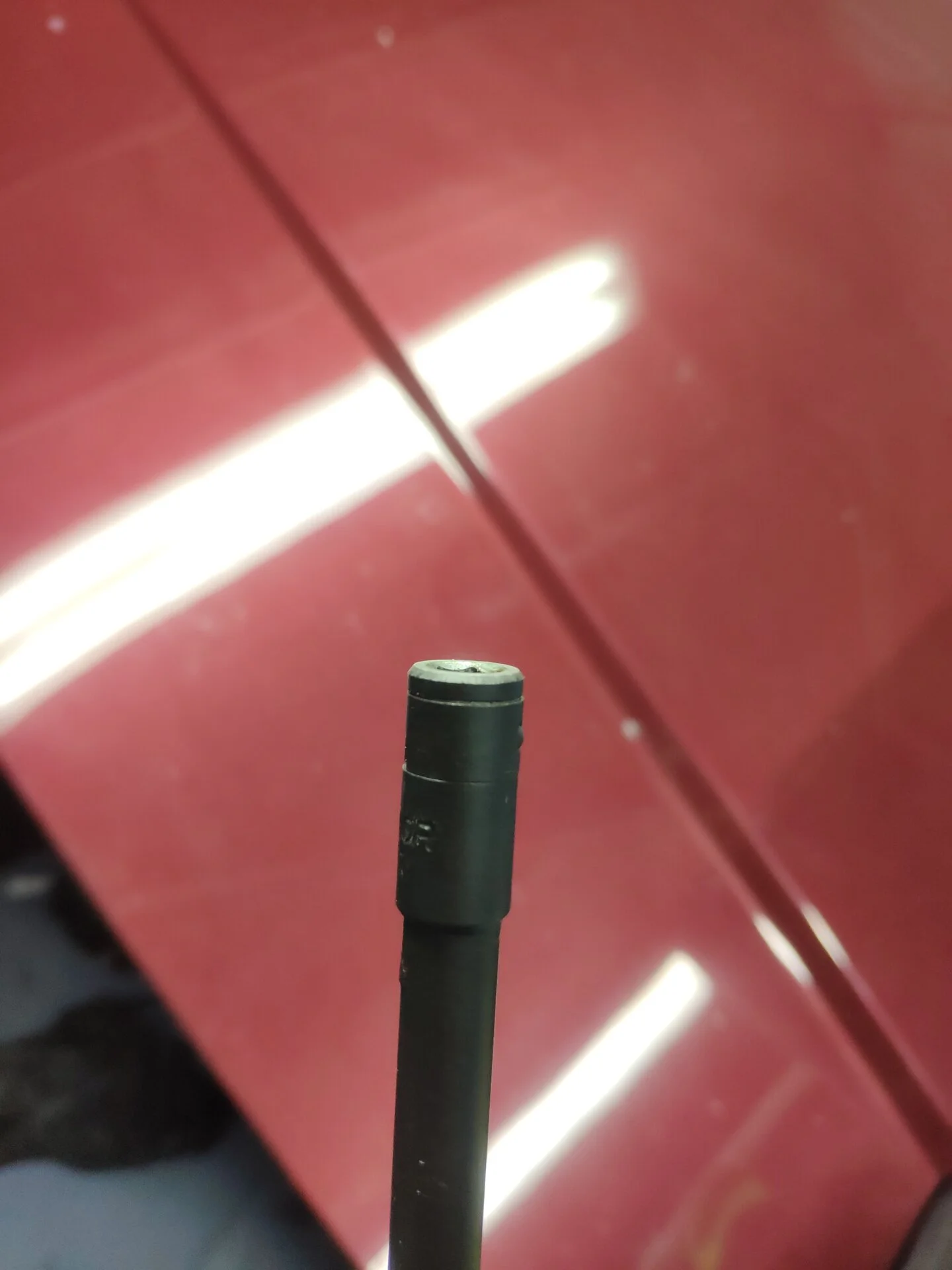

I work in cutting tool production company, so I got steel rod 18" and we used induction brazing to weld 1/4 to hex adapter with silver wire. Sandblasted, painted, pro work... but when I came home... damn adapter OD is too wide to fit in bottom hole. Ouch :-(.
Will grind it for future needs... BTW See pictures of sharp looking unfunctional tool :-)

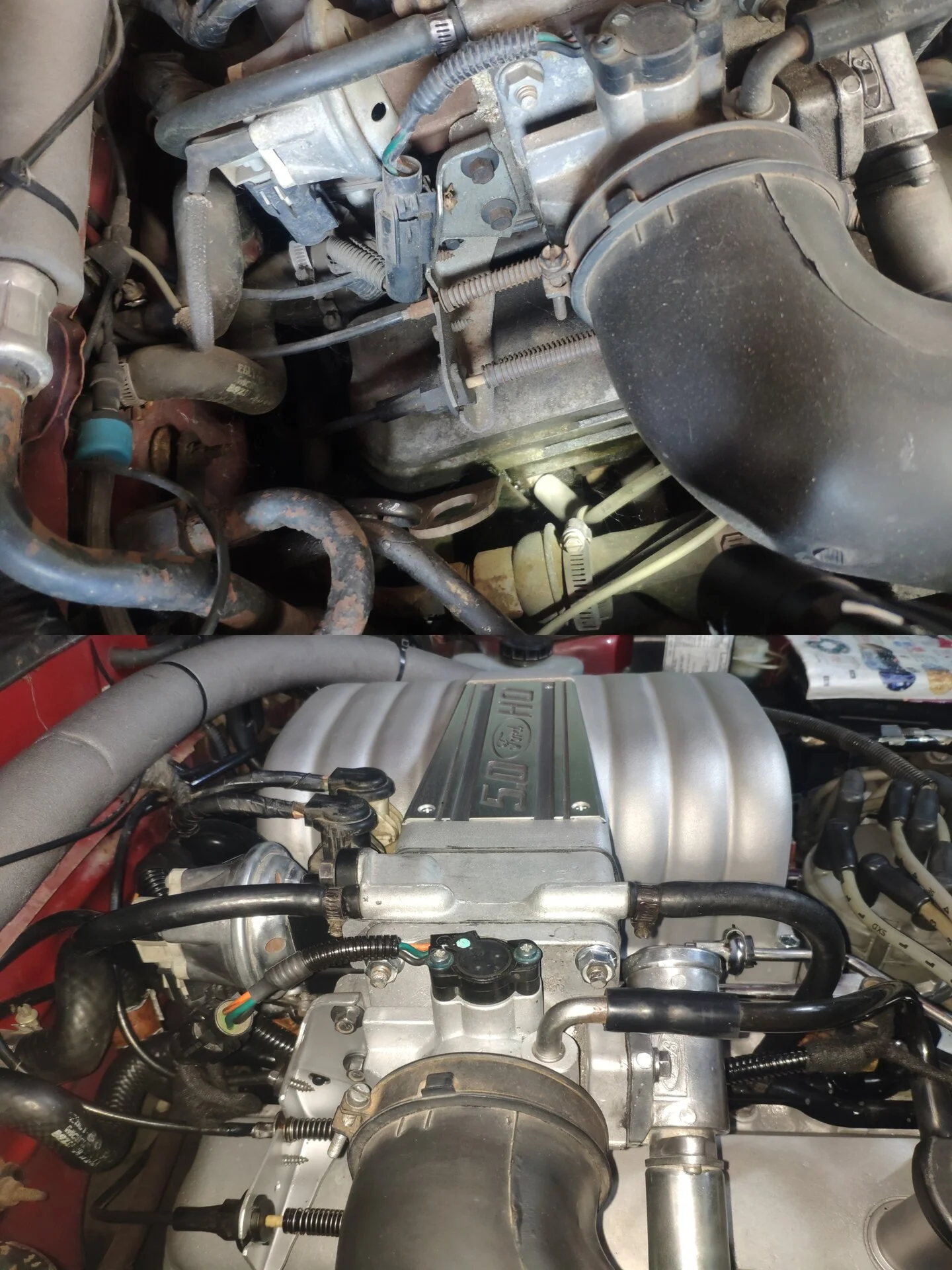

A little bit work on looks in progress...

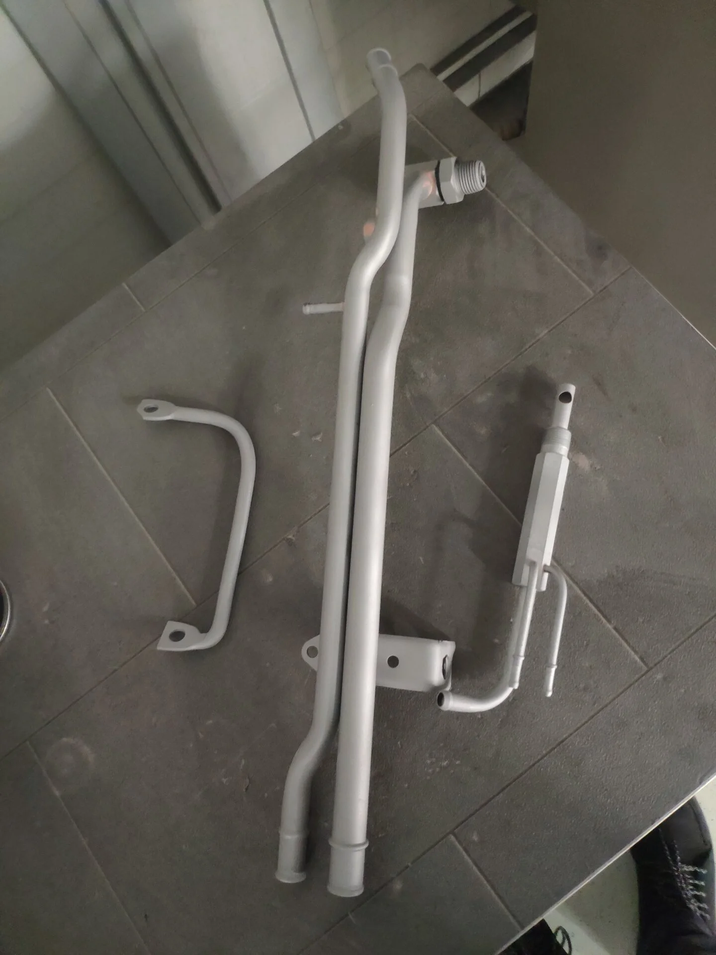

Sandblasted water pipes and vacuum splitter, got a nice 500°C matt coat...

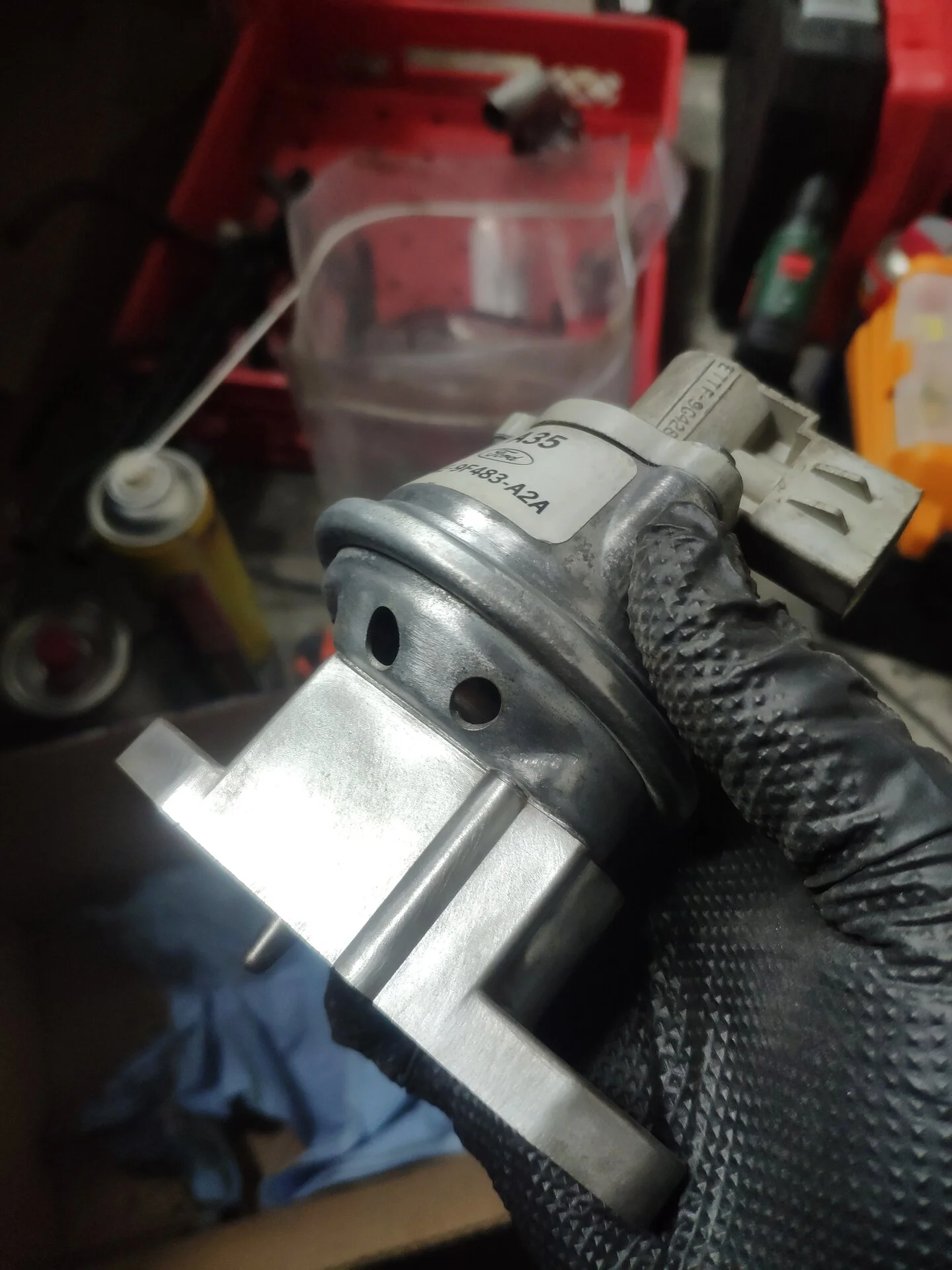

What You guys use on things like egr, iab, fpr to stay shiny? I am just polishing for now...

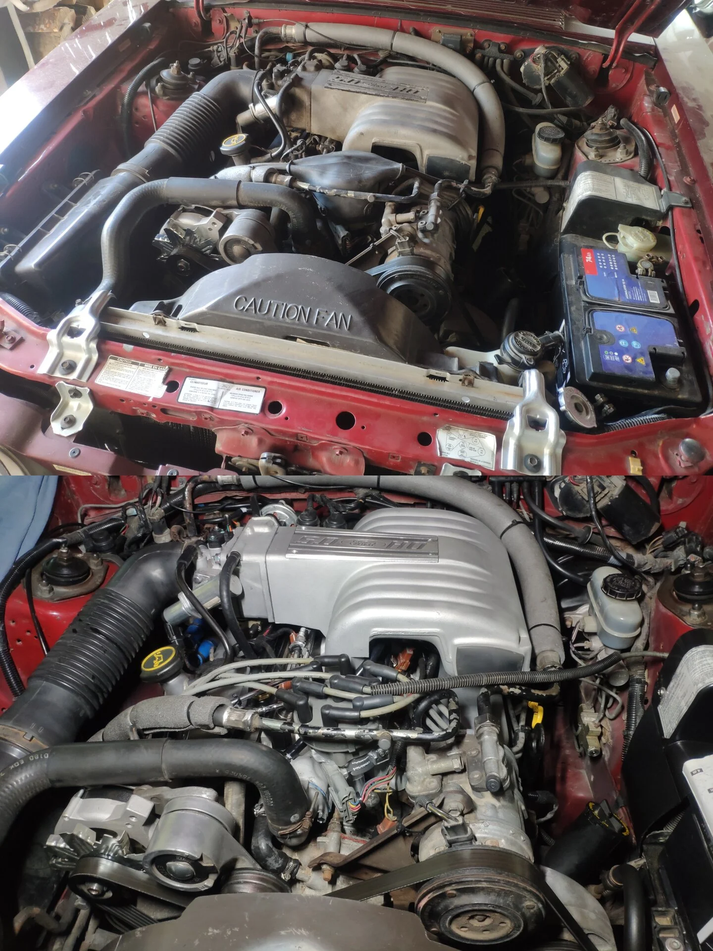

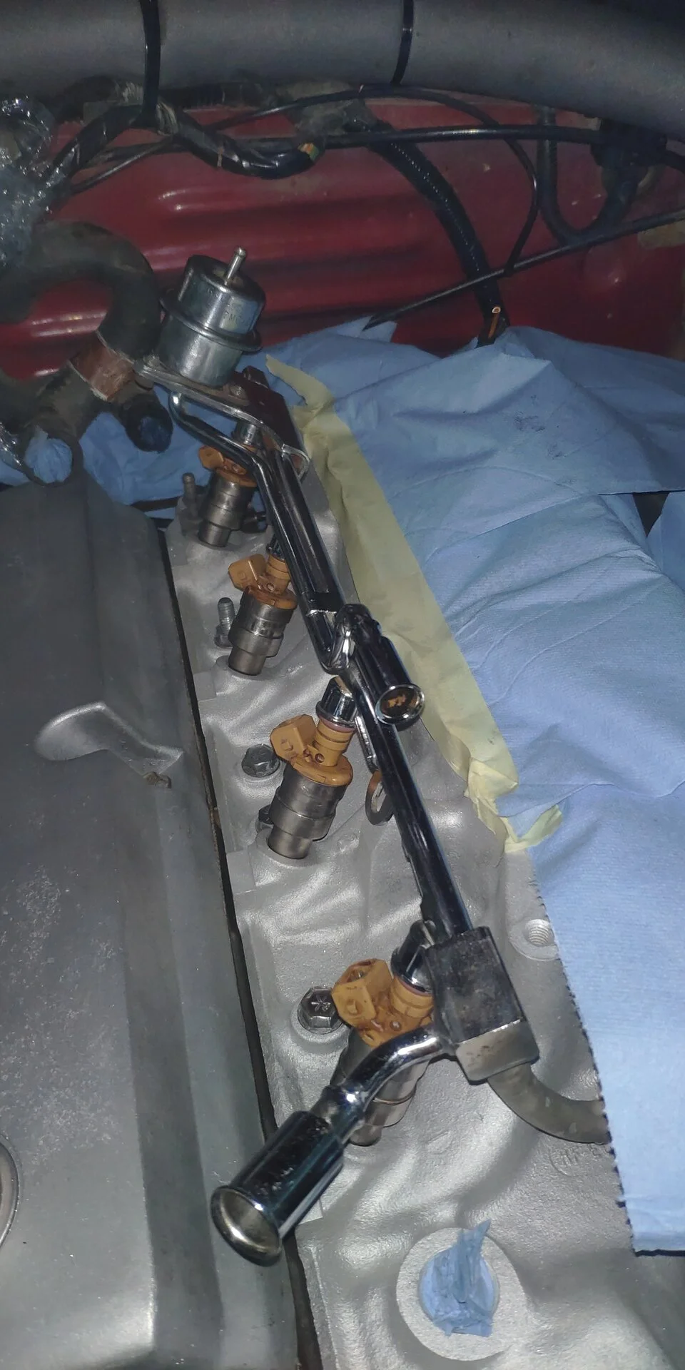

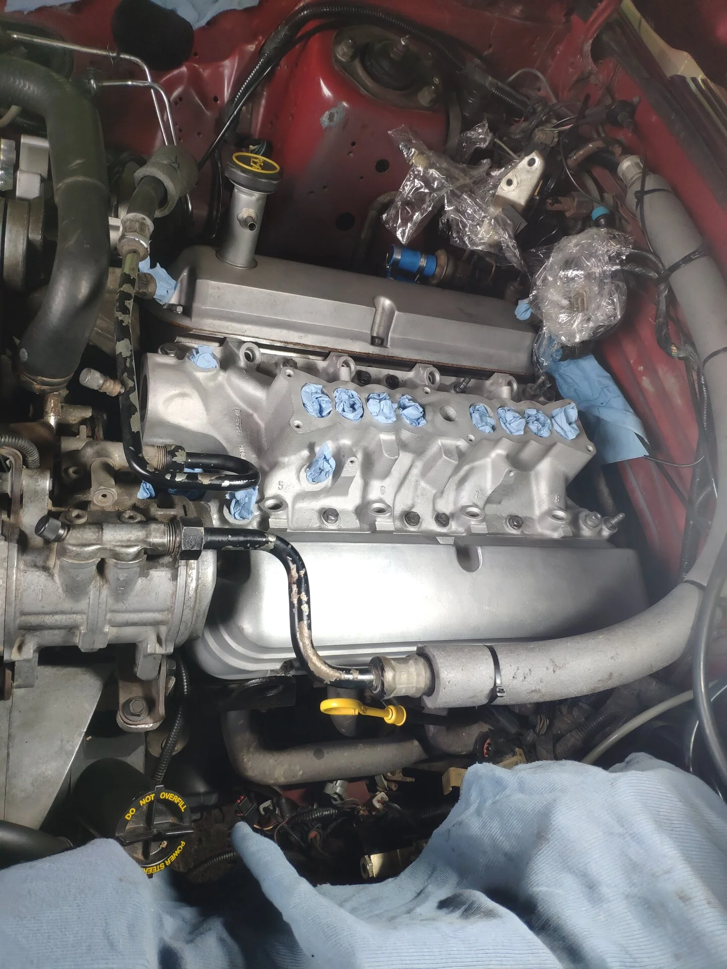

Update. Working on small things taking alotta time...
Fuel rails polished, injector harness re-wrapped (plastic and tesa tape combo), painted ugly dizzy body, prepared upper intake silver bolts to be zinc galvanized, etc...
Upper engine should look like from factory. I just hope it will run :-/

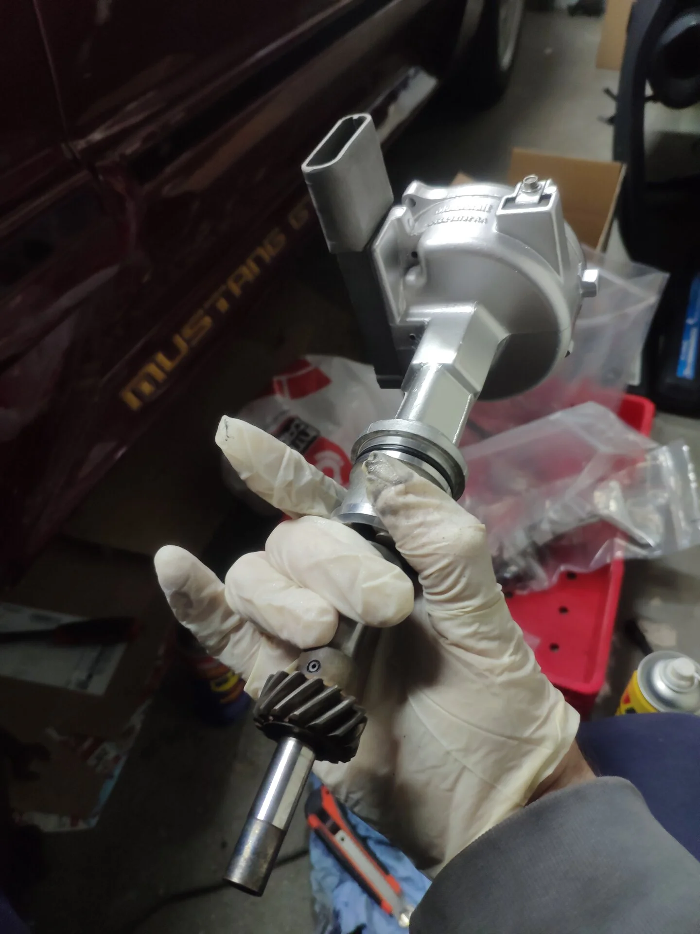

How are you at stabbing the dizzy. Ha ha.thats all that matters
At #1 compression strike felt on finger, with plastic straw set to TDC. Locked on 0 on balancer (good setup PO or factory). Waiting to be stabbed :-)

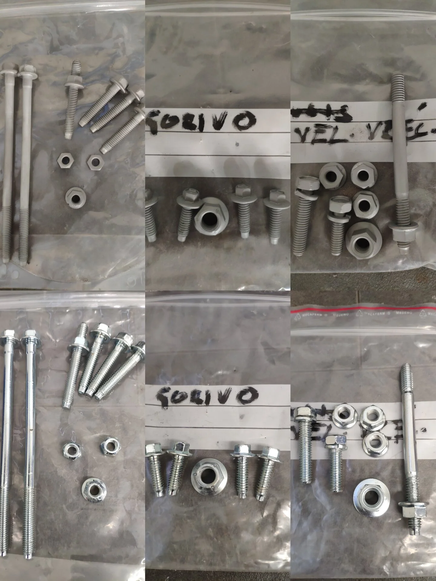

Few pics of upper screws and bolts lightly sandblasted and galvanized. Inch bolts are hard to get here....(as metric in US) so I have additional work :-/

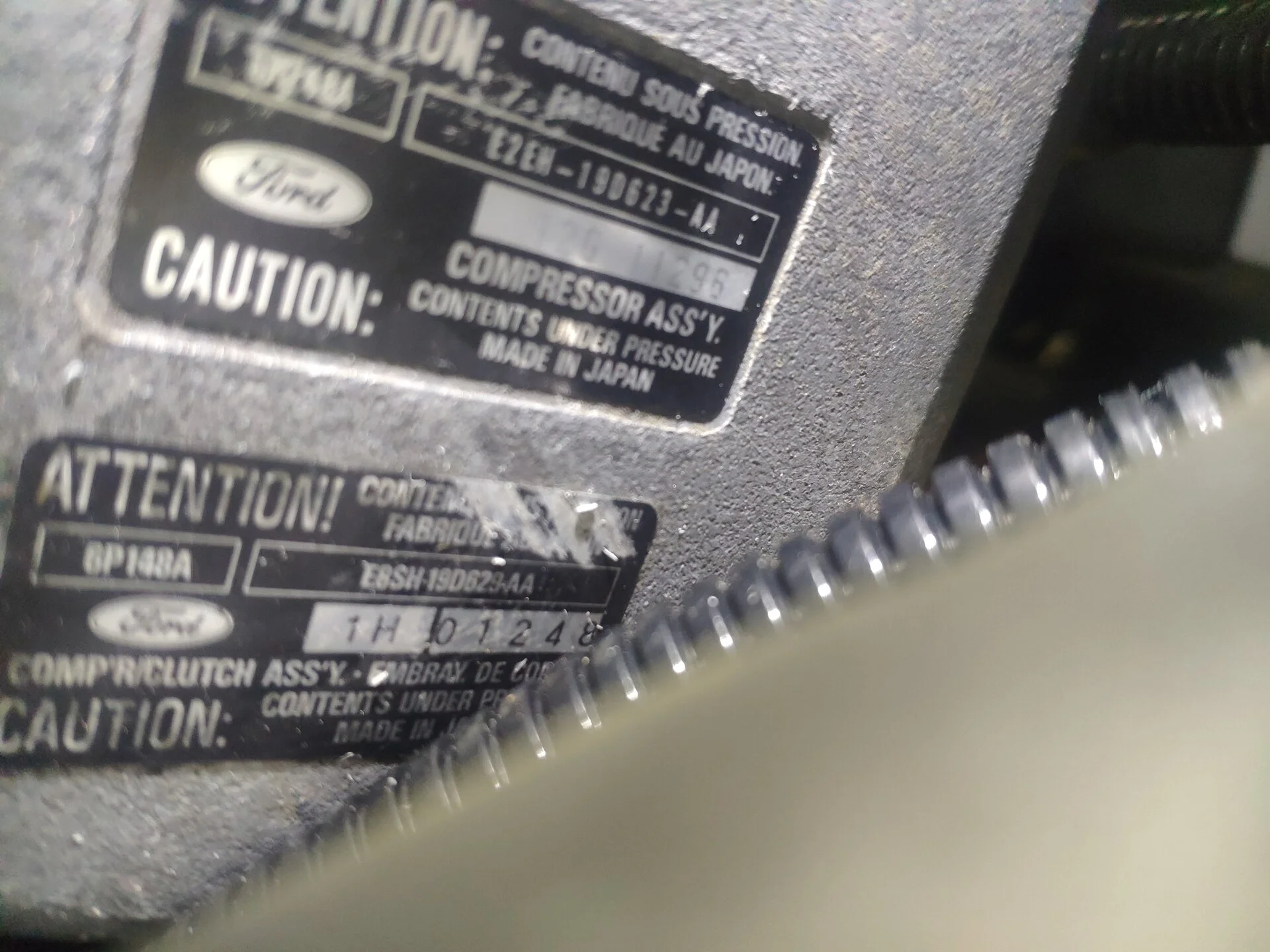

AC clutch is not awfully grinding (yet), but with belt off You can hear trouble developing inside when You spin it. If You bring Your ear closer when belt on You will hear it. Few feets away it blends with engine/exhaust noise... I suppose it will get only worse.
I attached picture: It should be a 6P148A if I'm correct and I should get 5001KFF or SKF AC2 (Rockauto)?

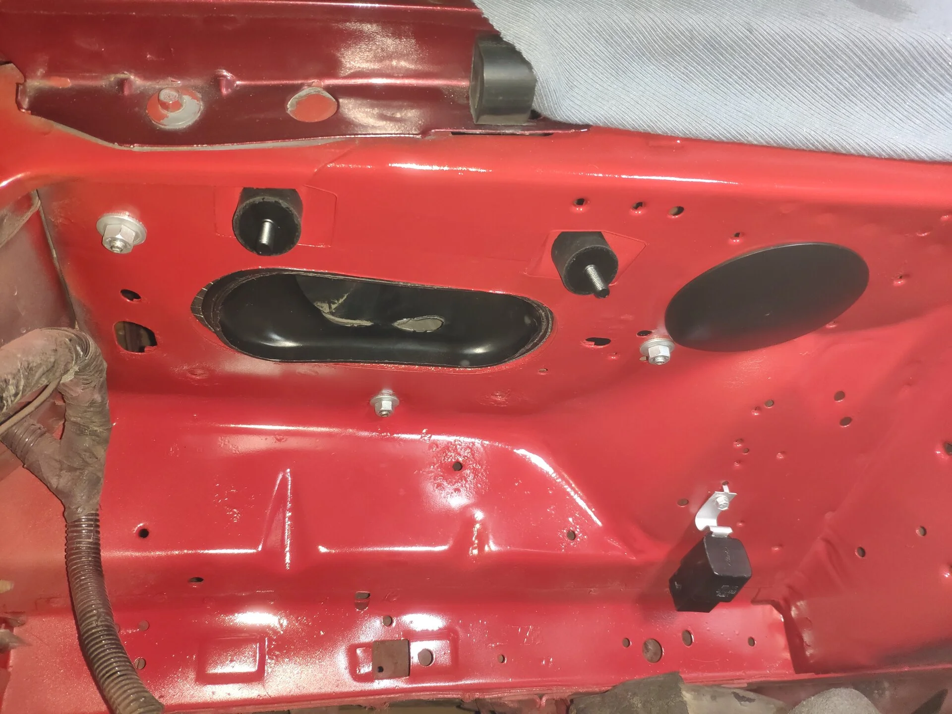

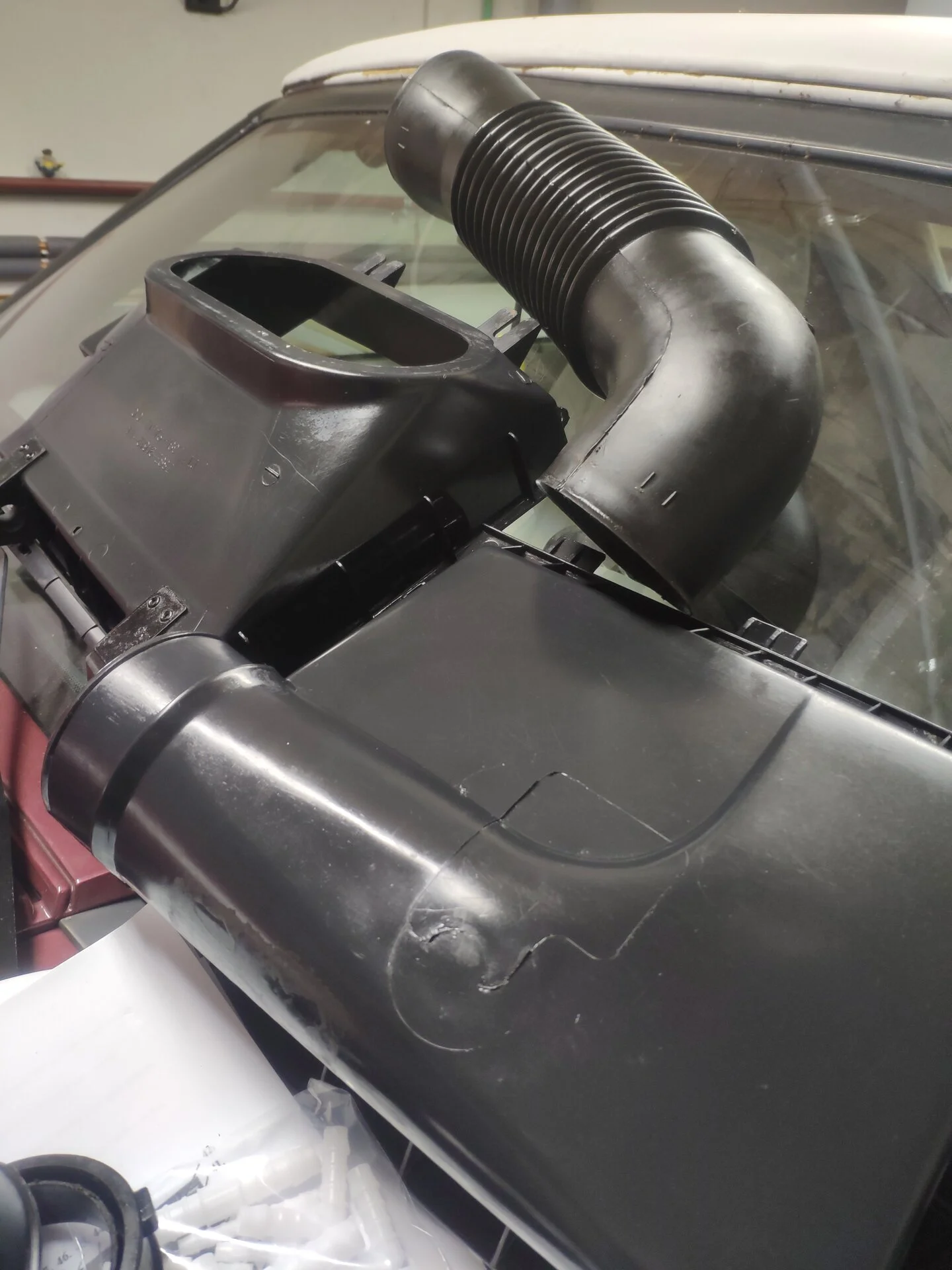

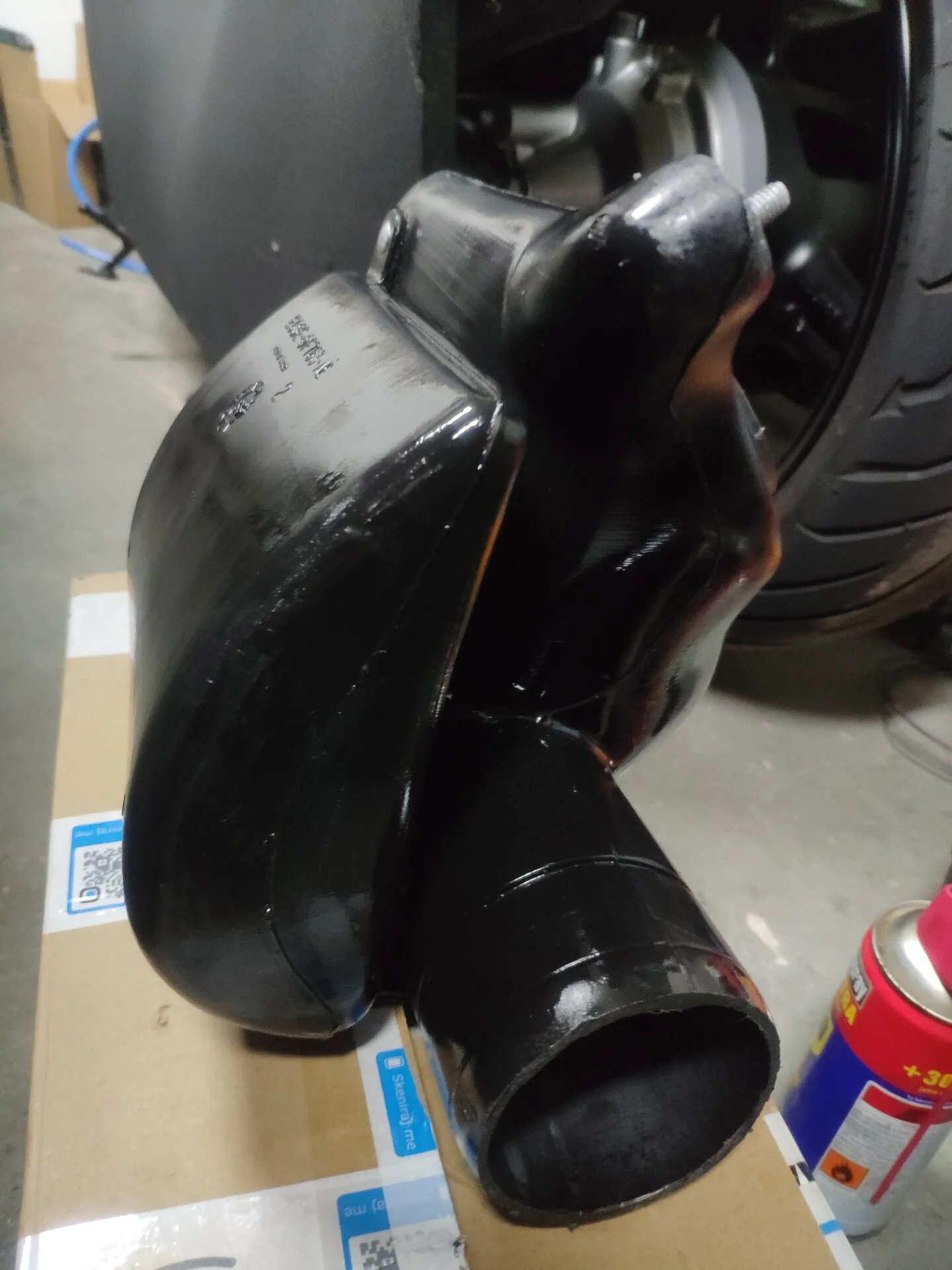

I repaired (as a temporary seal) some surface rust around airbox. Anticorrosion acid, then cans as follow: prime, paint (not mixed, ral3003) and clear coat. I hope it wont flank, thoose can/spray paints are always a gamble.
Restored some parts in the way (Ac wot relay, airboxes, seals, airtube).

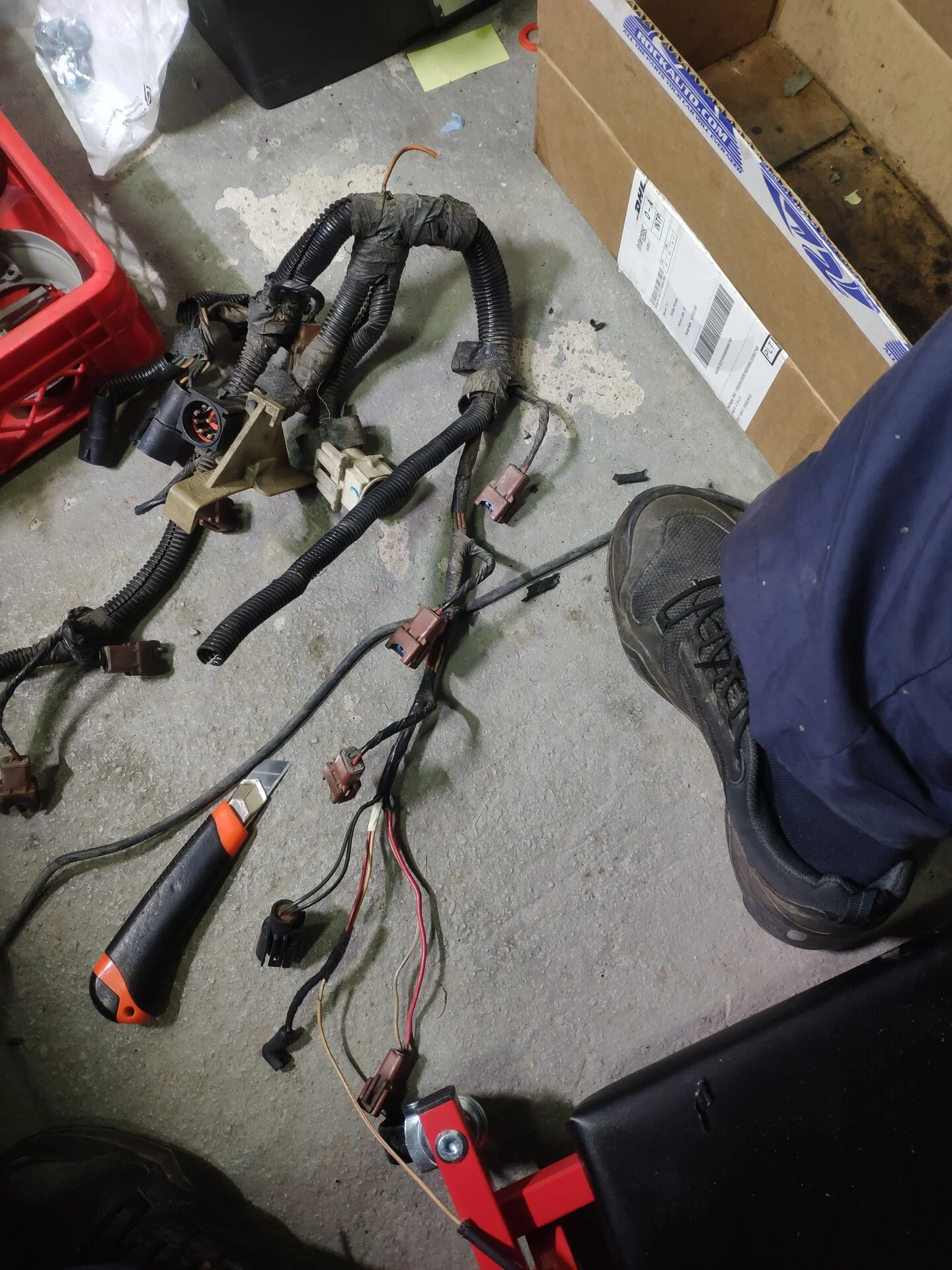

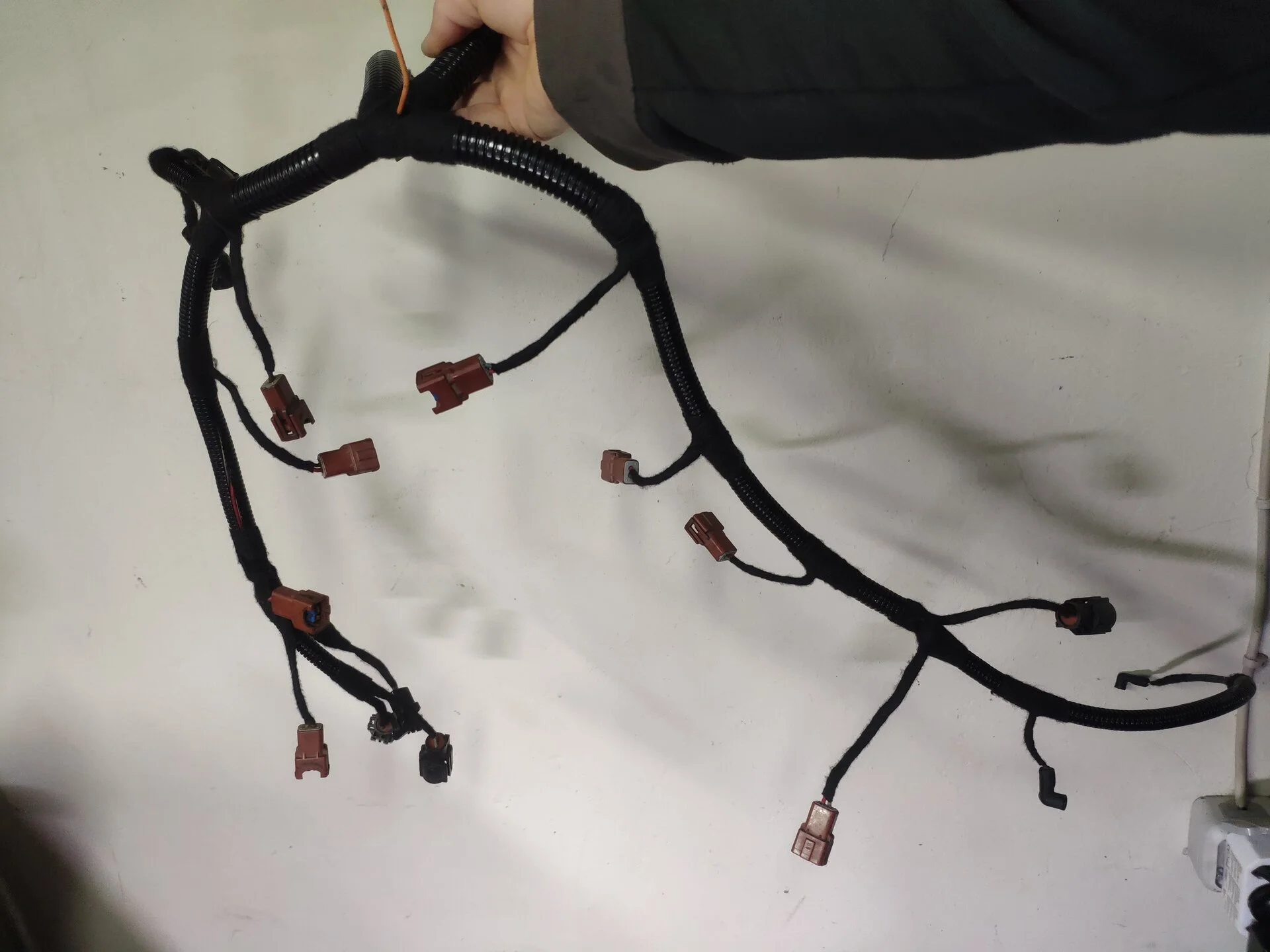

Currently I am removing main wire harness to renew sleeves/tubes. Its all hard and cracking. Injector harness was sucessful project, so I am processing main also.
