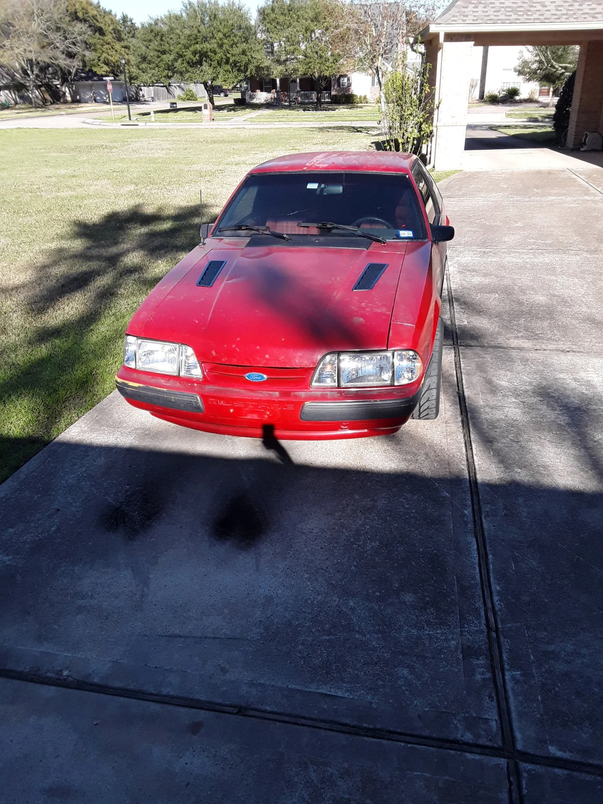

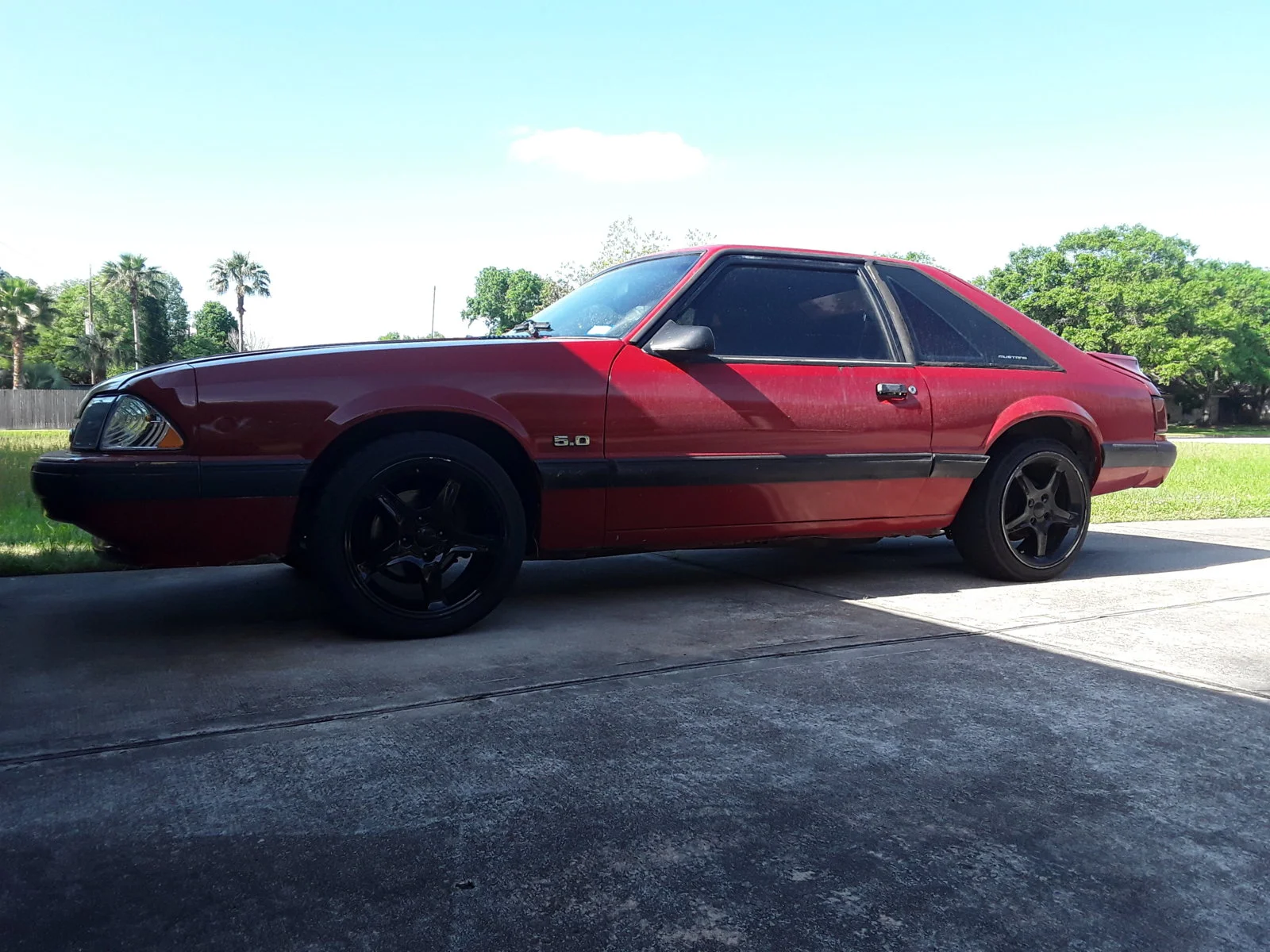

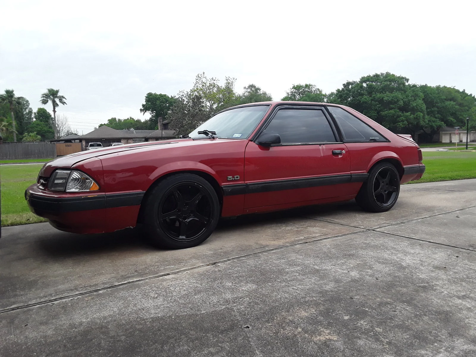

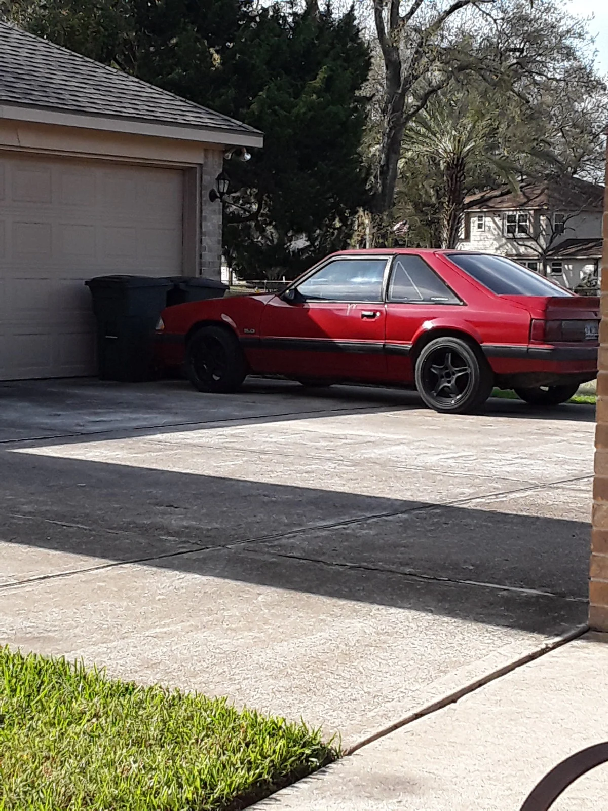

Installed some eibach sportlines. Rides pretty :poo:ty on stock shock/struts but not terrible. Looks so much better and ppl say the rears are soft but they feel firmer to me, slides easier for sure, less rear body roll. Handles a lot better no doubt.
Before and after:

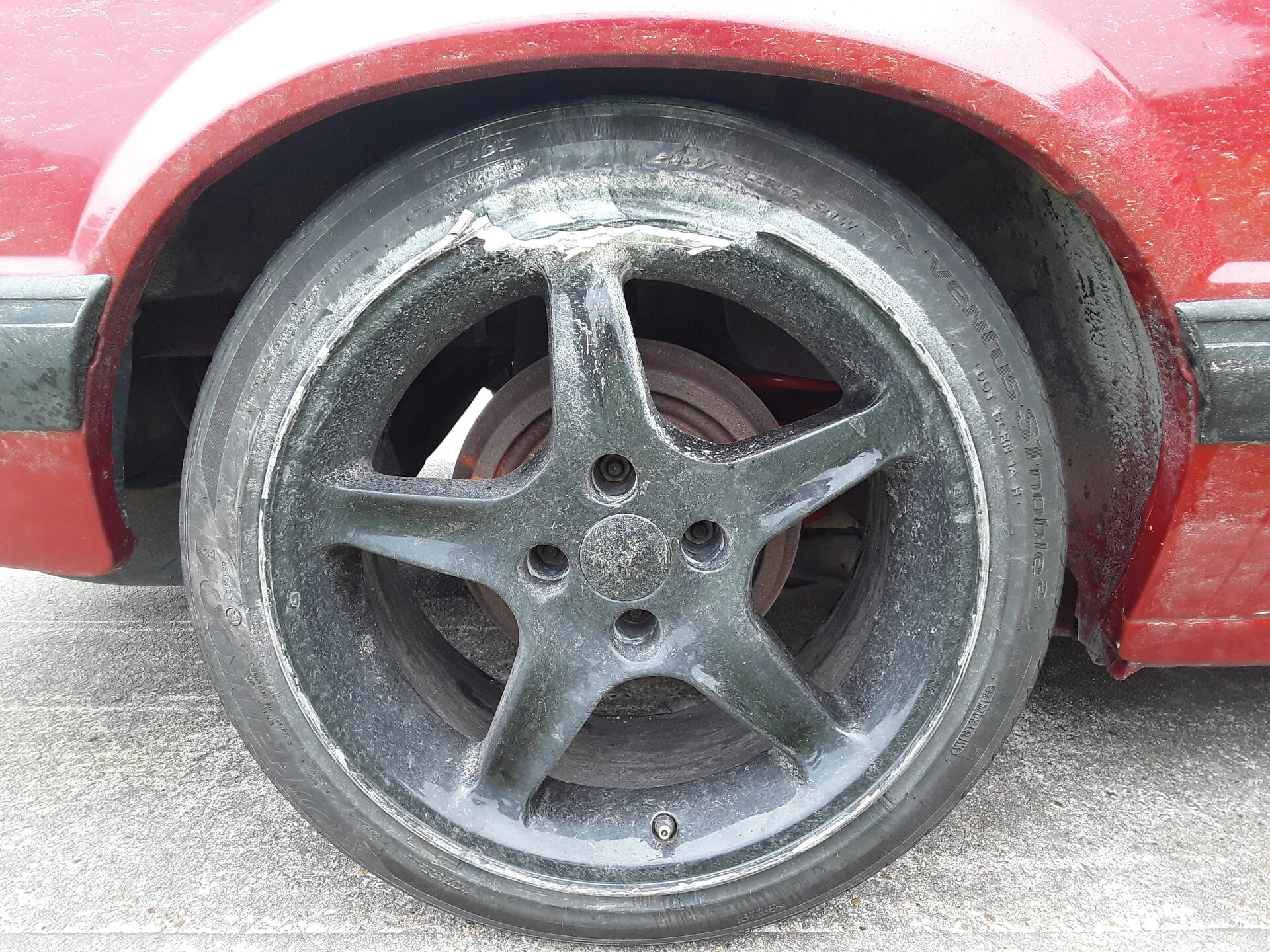

Front isolators top and bottom. Rear no isolators for now. If it settles lower will add rear uppers. Edit: I gotta add, those small 215/45 rears look terrible lol. Just burners i got for cheap.

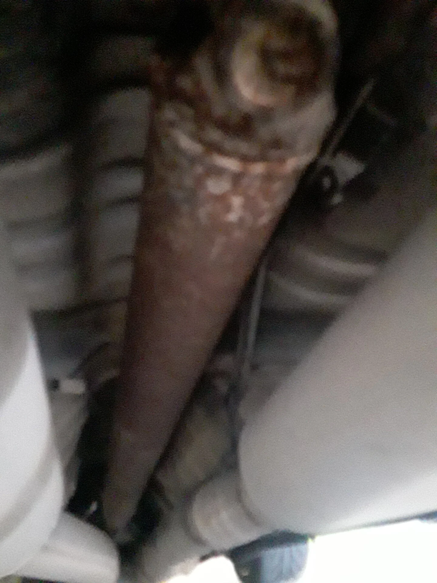

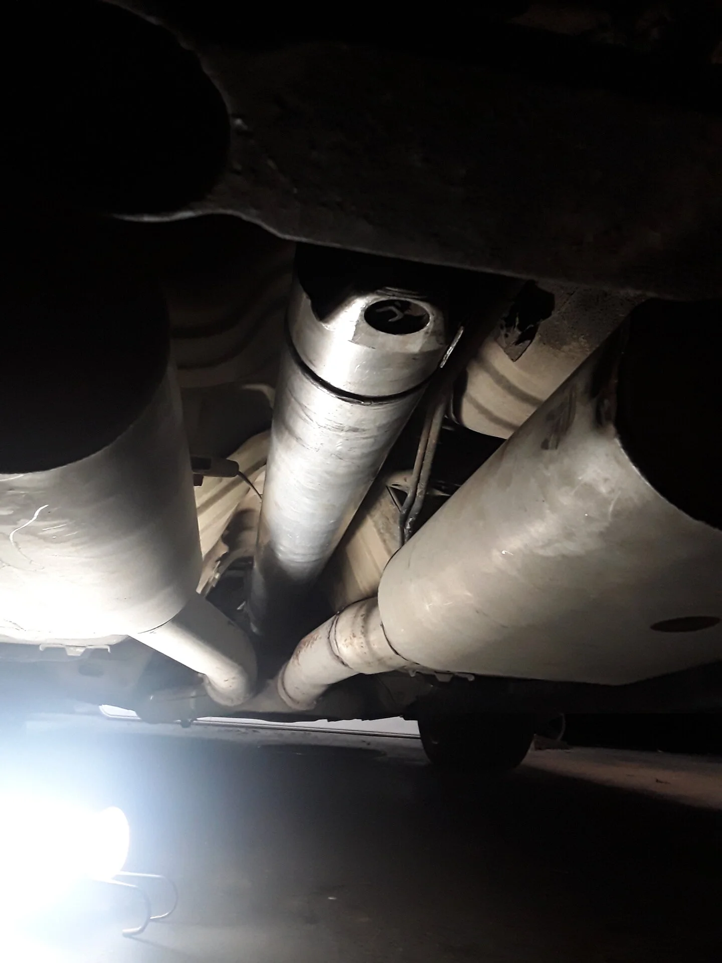

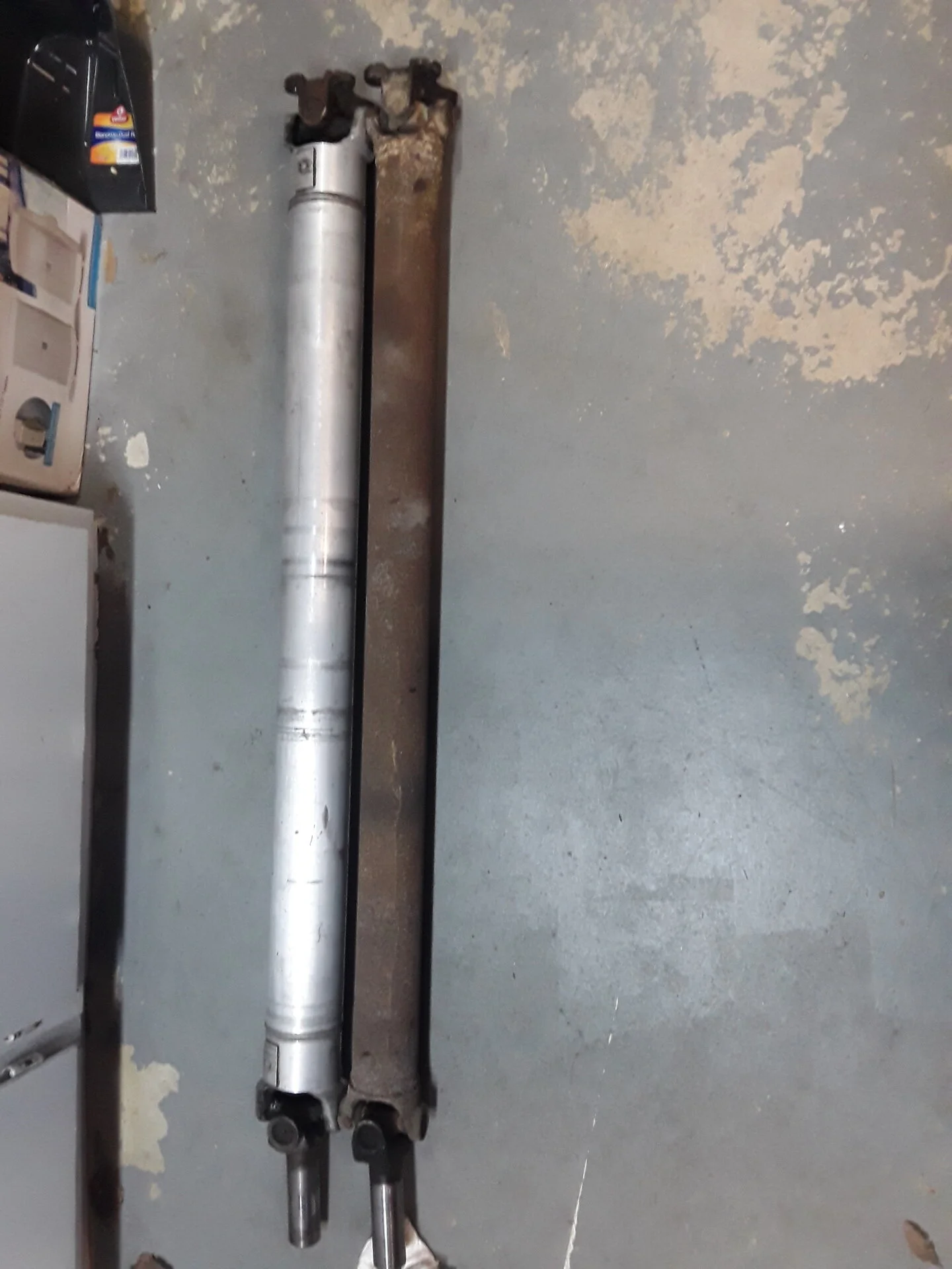

New mod went in: aluminum driveshaft.
Scooped it used for $160.
Performance: id say i def. Felt it pull better 2-5k rpm. I aint got much hp, so i think id feel it more than someone with 400+hp. Felt super smooth at high speed 80-100. Subframes did the samething there. Stoked on it.
Wrenching:
Lucky me, my driveshaft bolts were already on the loose side. Lolol. They took 15lbft vs 30-50 expected. They were all the way in, just came loose pretty easy. Pulled it out, greased the alum. one, threw it in, eazy peezy. I guess i chose the other bolt pattern (of course) and the bolts got way to tight to fast, so had to pull em and got a closer look, chose where i thought it was supposed to be, + a squirt of starett M1, then they all went in by hand. Tightened. Done.

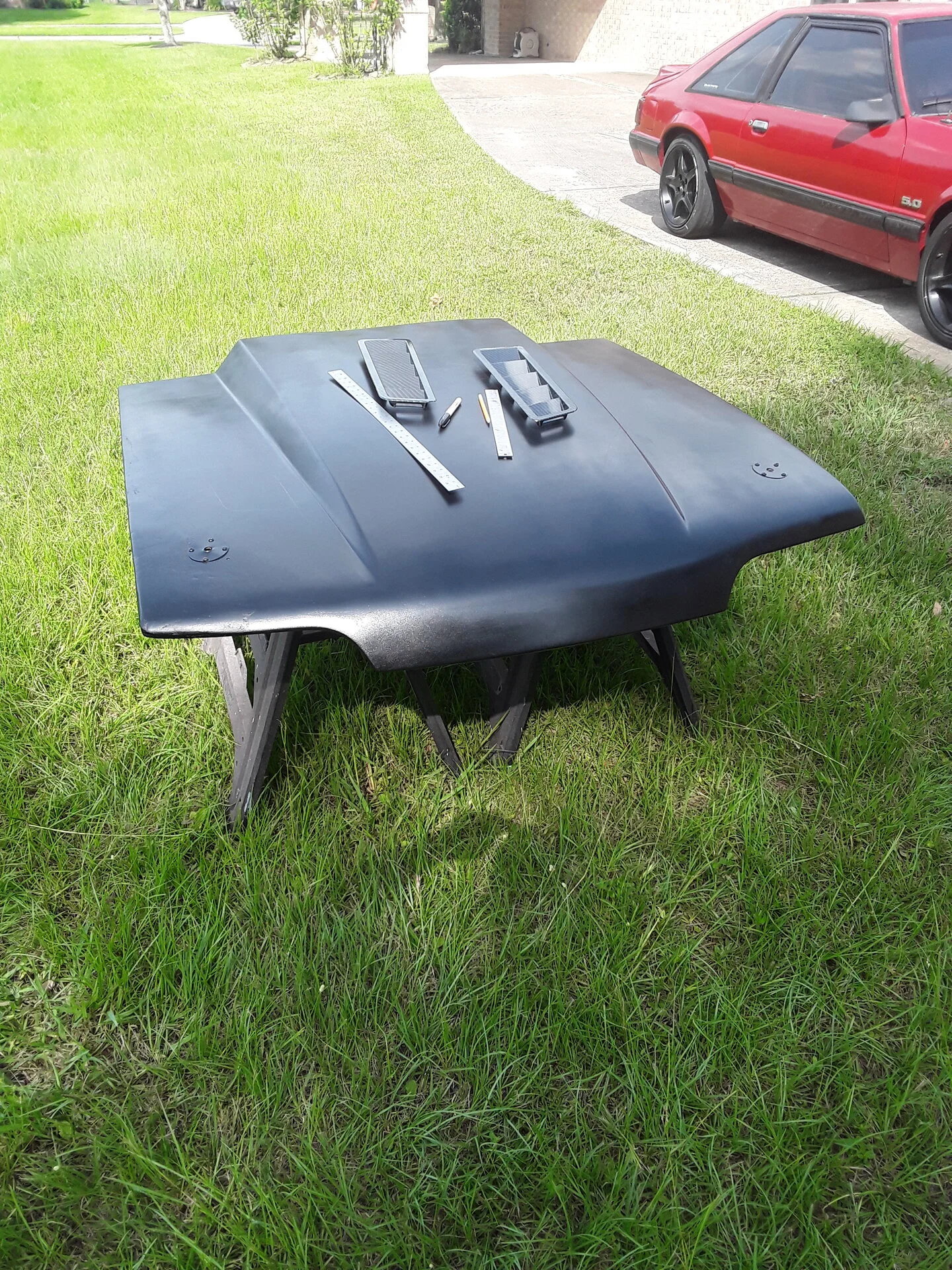

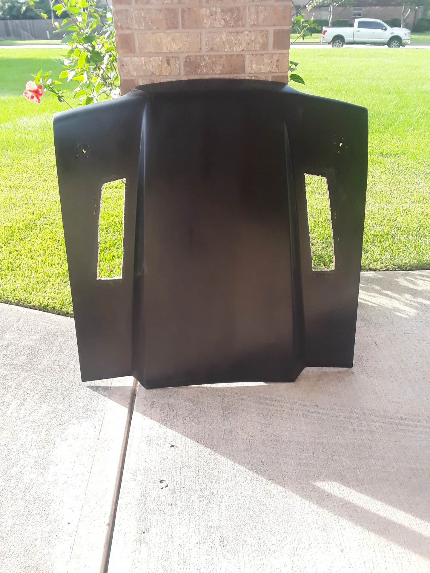

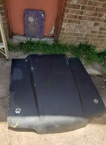

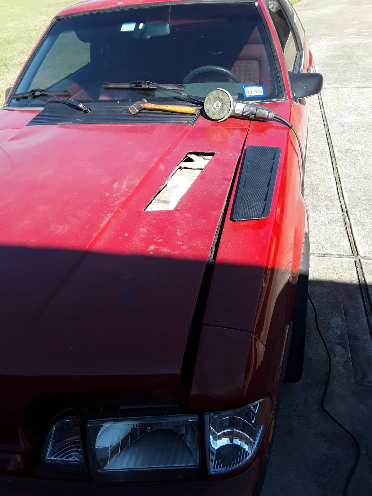

Hood project. Scooped it for $50. +60 into it all said and done. I want to add 2 more vents on the cowl tho. +20 more if i do that. Its going to get carbon wrapped. Wrap should be here next week.
The corner was pretty messed up. I used bondo glass and my fingers to apply it. Then a lot of sanding. About 5hrs in now where it sits.
Painted it to help the wrap stick to it.
EDit: forgot to take pic before paint after bondo and sand.

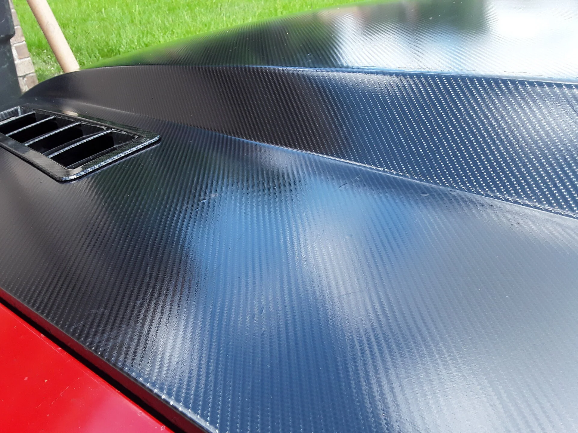

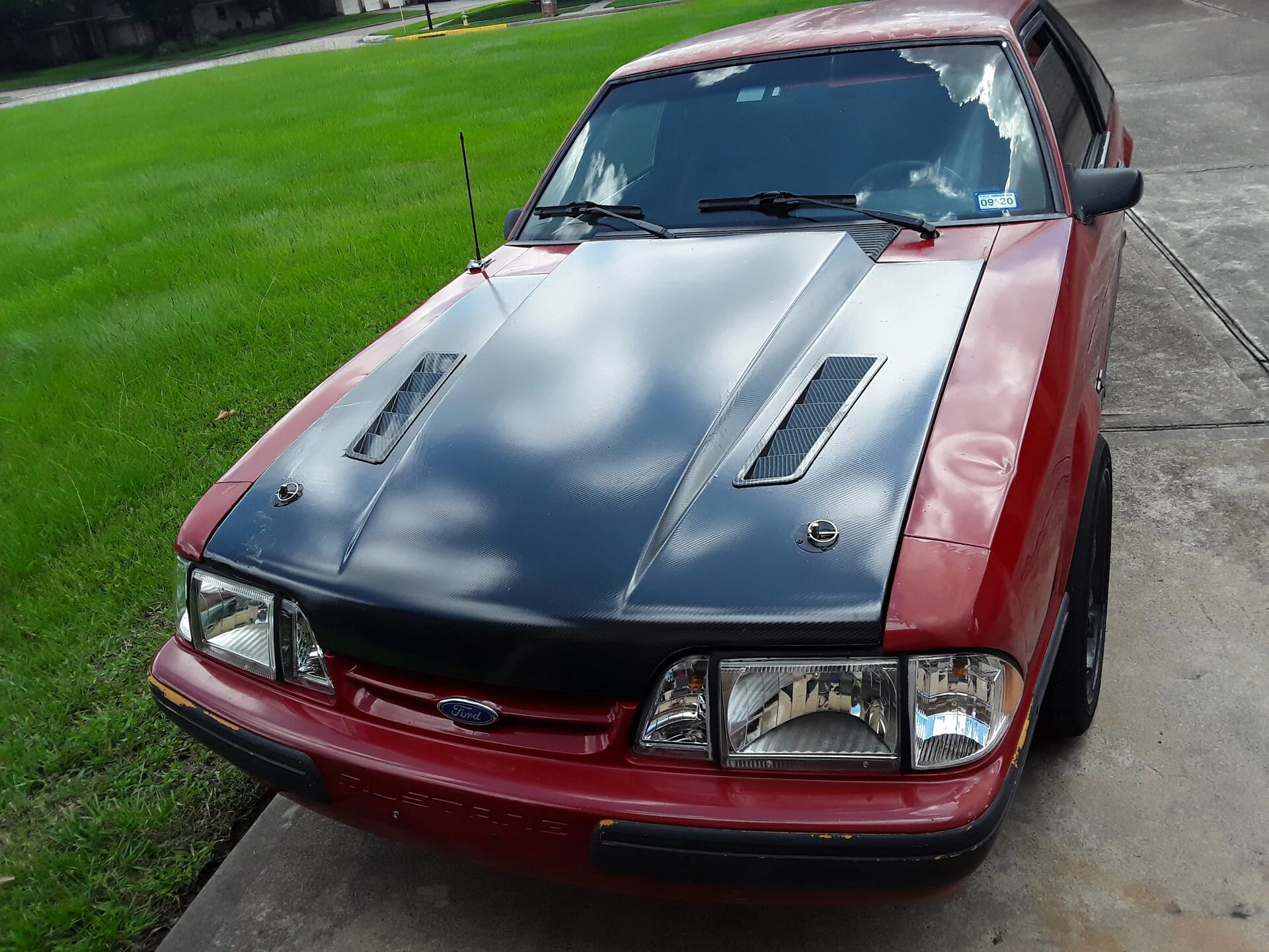

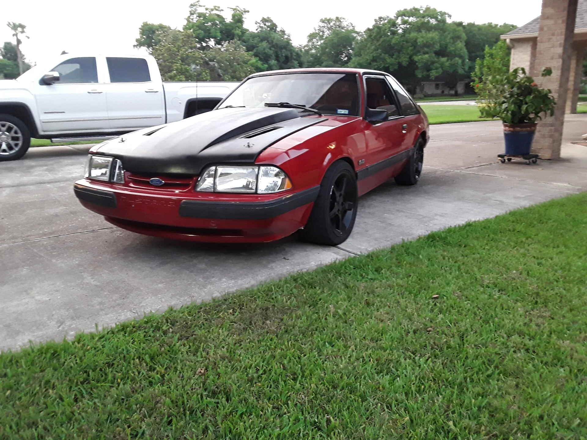

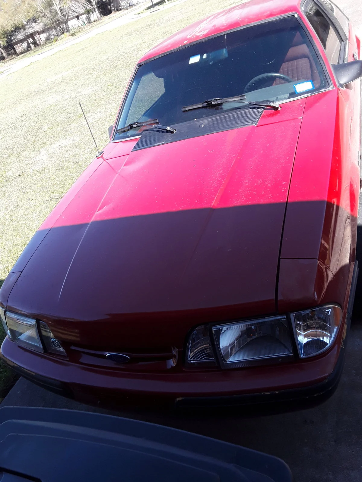

El finito for the hood. Stoked on it. A few more little bubbles i need to get out. But it'll work for me for $110 said and done. Cant see much carbon in the pic, but looks mostly legit, i think. Ill have to co.pare it against someones carbon hood when i see one. Need.to paint the pins also yet.
Dent in fender is from me punching it few days ago. Damn thing dents so easy smh. Got a terrible mental/anger issue thats spiraled out of control recently. Lol.
That line to the left middle of the passenger vent is a seem. Was last spot i was finishing and just wasnt gonna go away so had to cut and overlap. Can bearly see it. Doesnt even catch my eye when i look at hood, so not too bad.
Took about 5 hrs and was a royal PITA also. Lol. I thought it was gonna be easy. Ha. Had to learn the technique, heat a wee bit and pull hard helped a lot. Still super challenging. Was hot af and humid as hell. Rollin sweat. So was very enjoyable. Pfftt. Lol.
