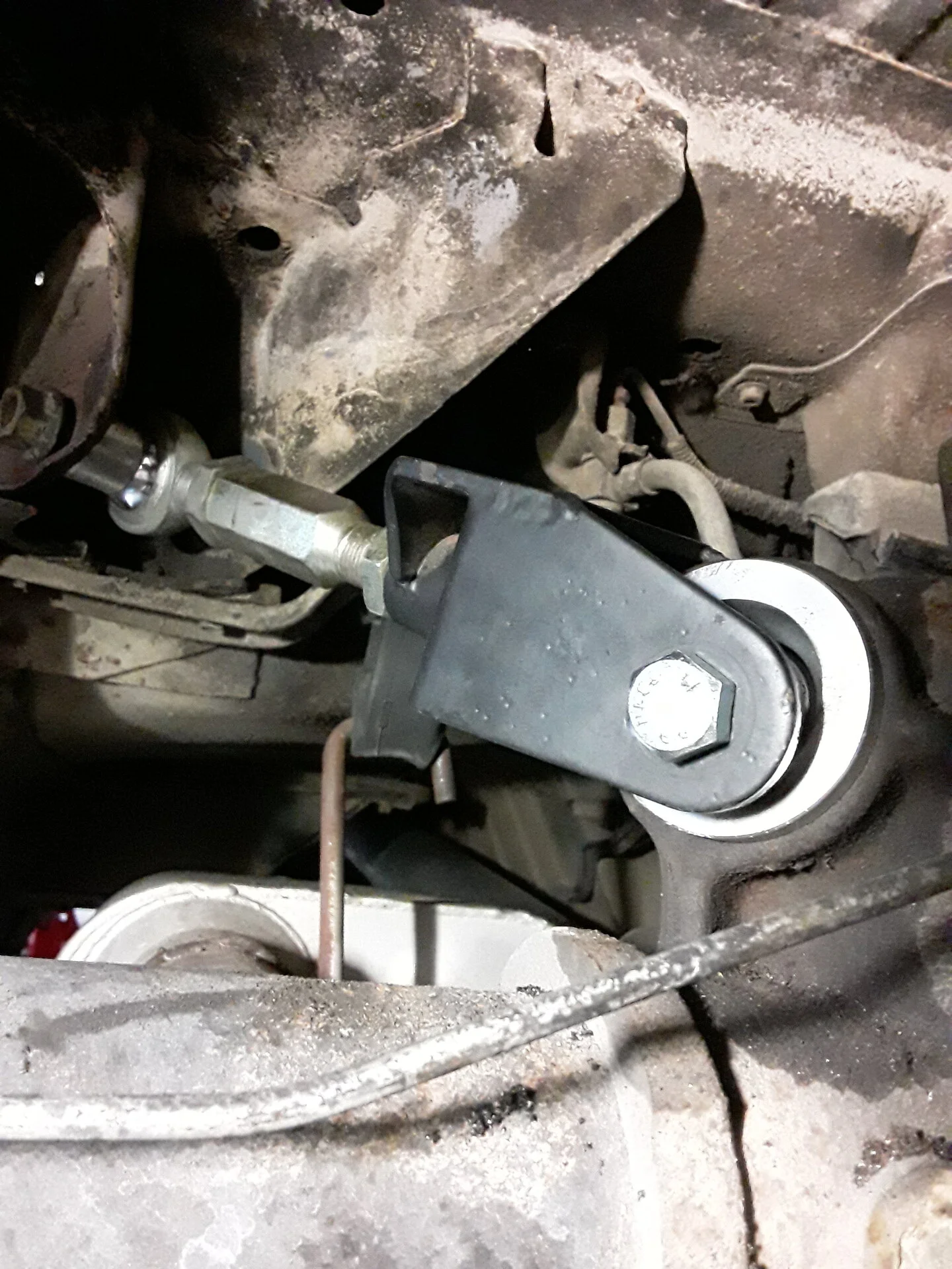

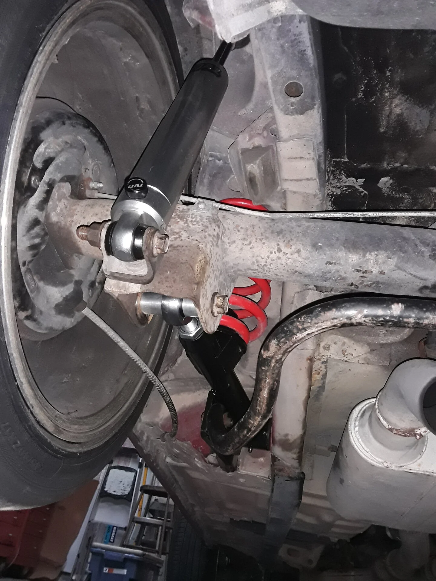

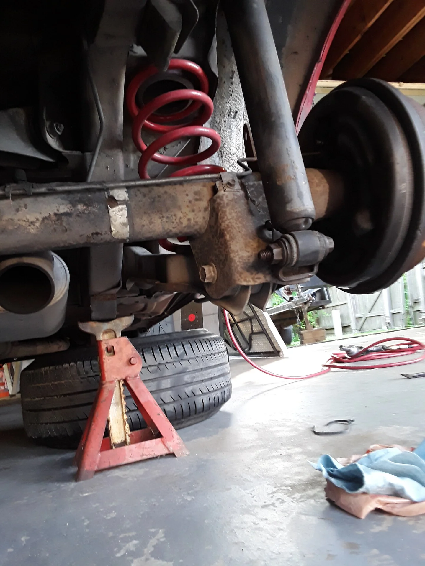

Put in some ebay single adj. control arms w/ sphericals bushings on the rear end side. They were brand new but scored them for $50. Think 110 on ebay. QA1's were $30 for both. Got a smokn deal on those! A while.back.

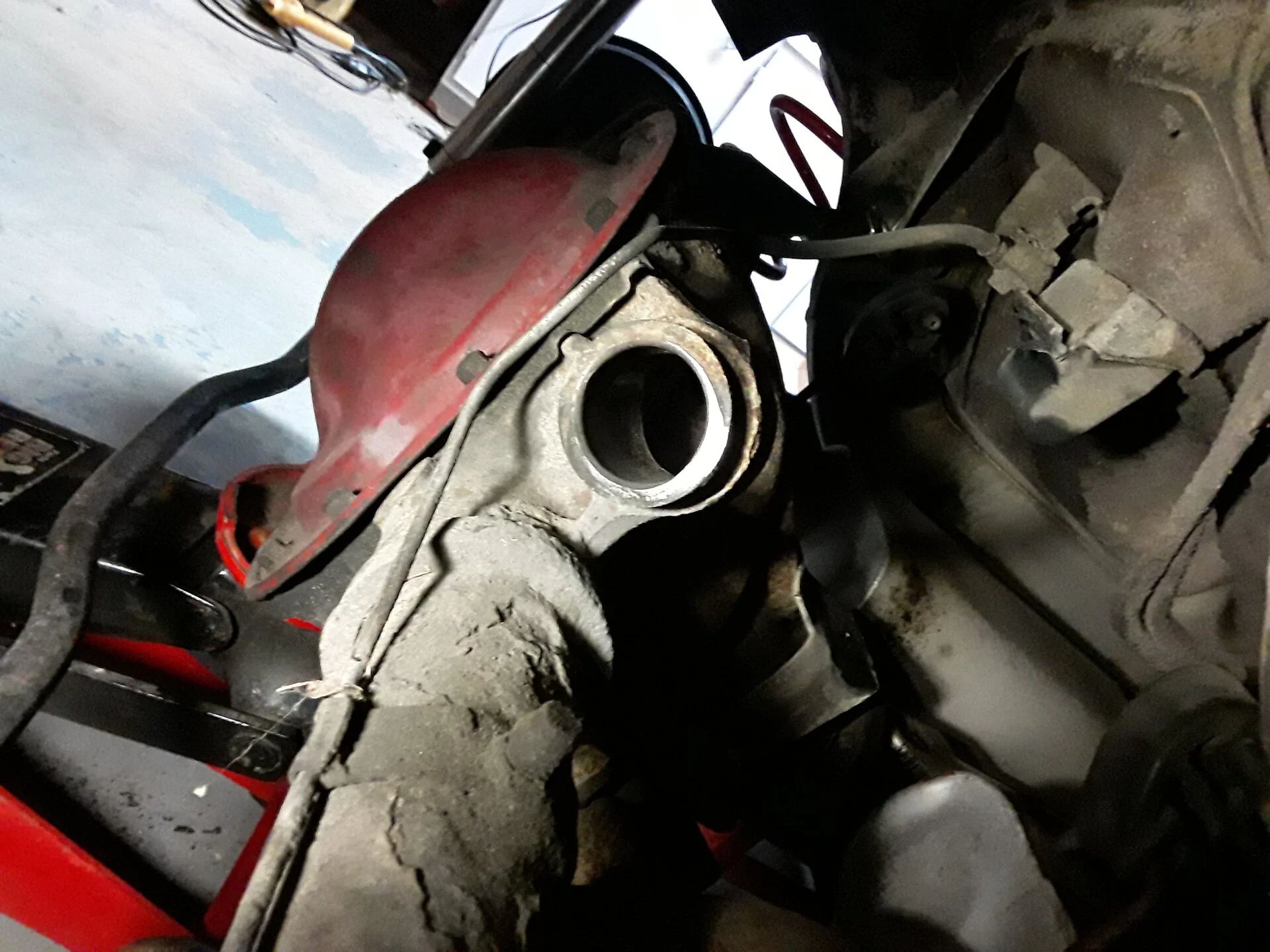

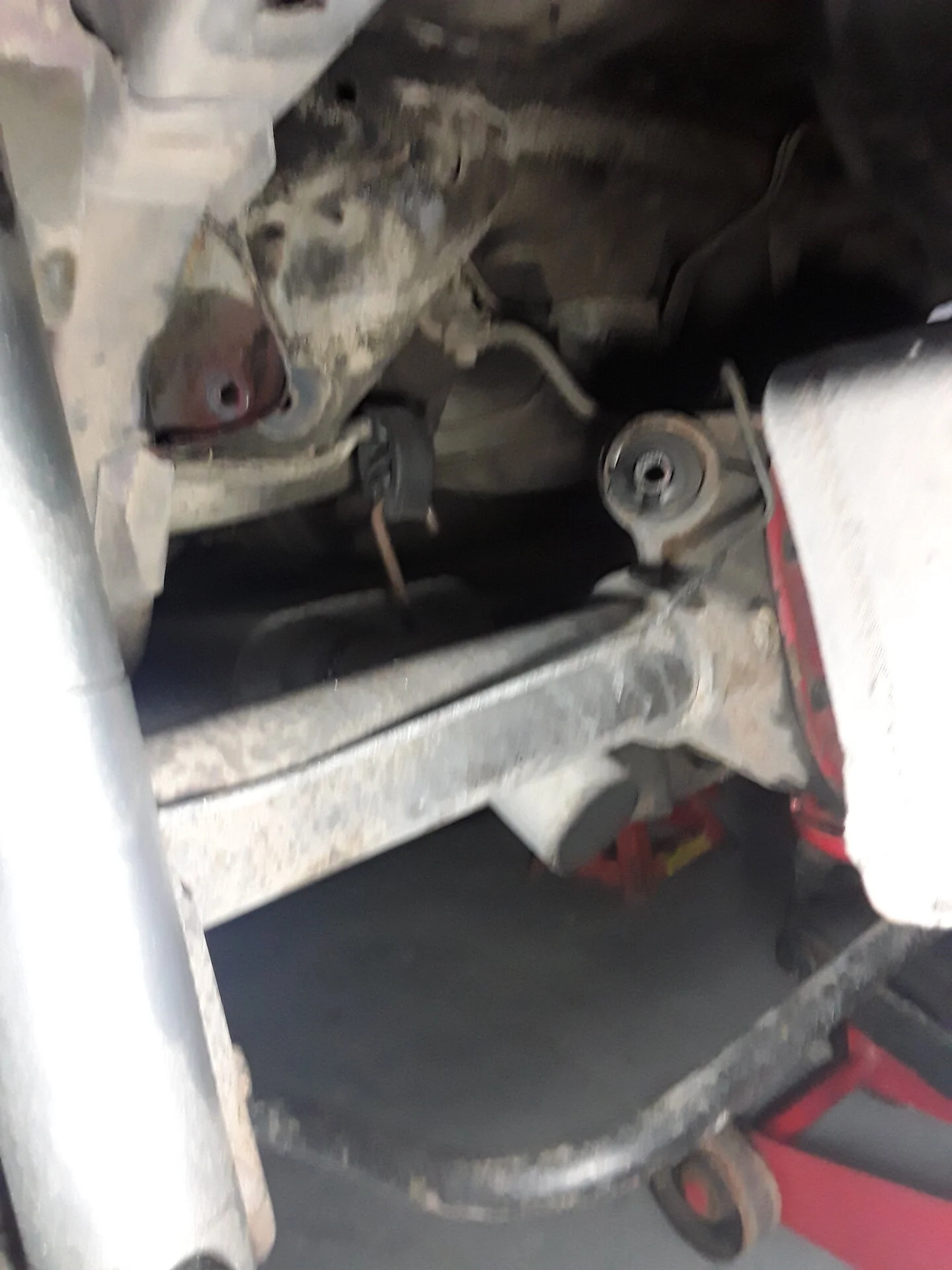

So im workong on the passenger side, tye side i hit the curb on, and i go to check the upper control arm, move it up and down an inch. LOL. Im like wow. There is no bushing in that side and the upper control arm not connected to anything. Bolt still there, but the control arm is seperated from bushing or whatever. And just moves all around lol. So ill be doing upper spherical mounts and upper control arms sooner than planned.

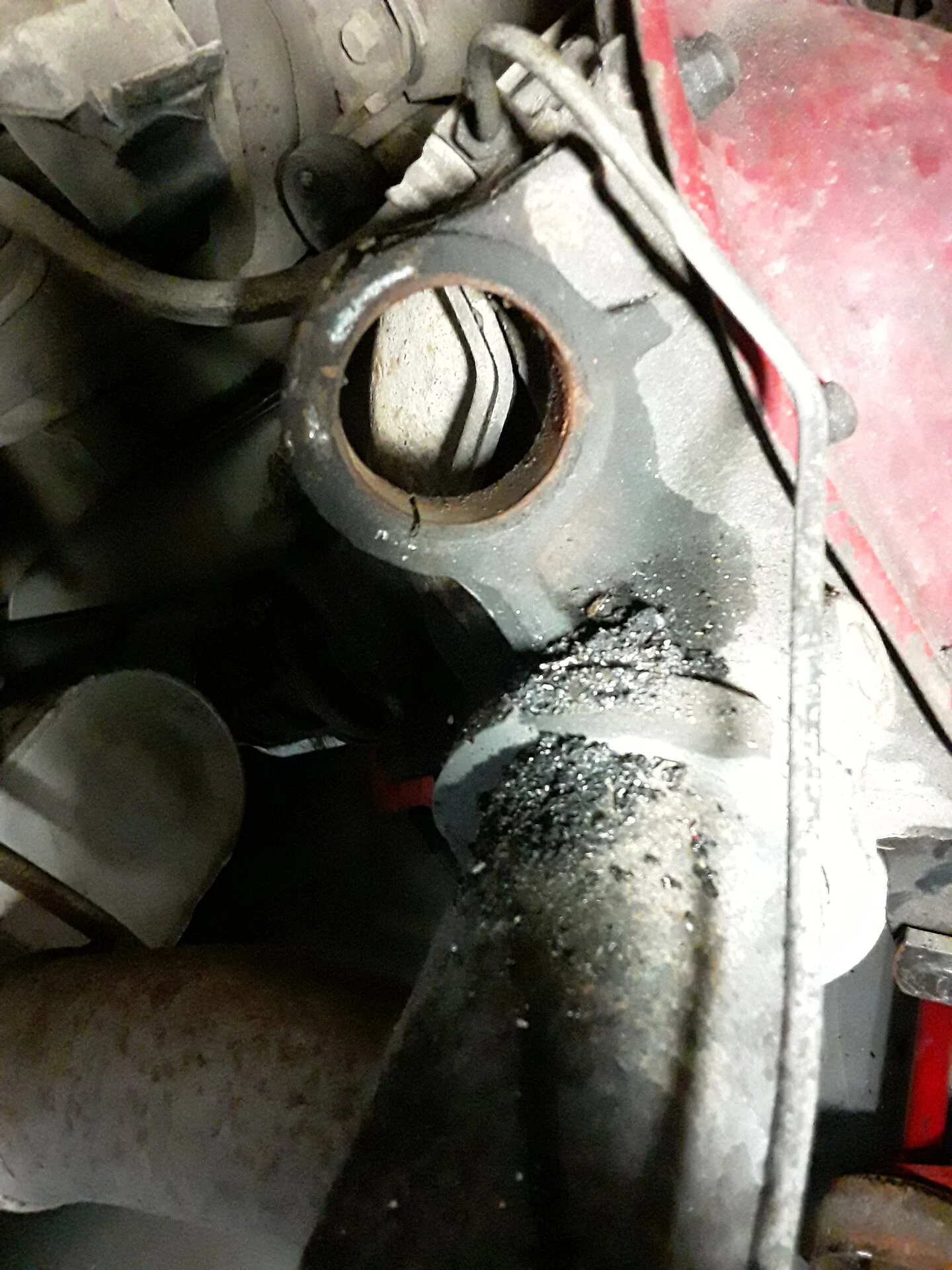

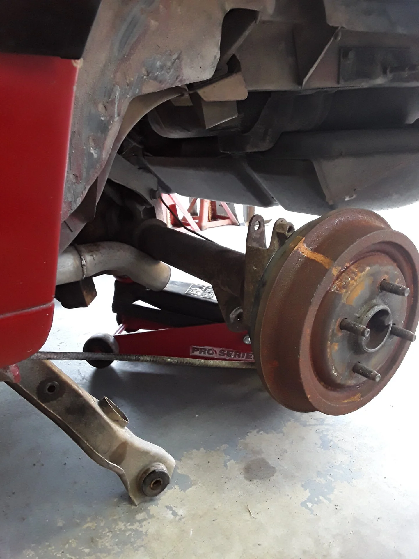

Dont mind that 1/8in. Cut into the housing. Lolol. Wow. Went a bit too far. Its prob only .060-.0780 really. No biggie imo. None the less did it on both sides. 2nd side a little less. But ya. Coulda gone a little sliwer and safer but i wasnt worried about it. Then i smushed the bushing with big channellocks and my strength and alide it out. Im weak, took all i had to smush the bushing on 2nd side and got it out easy peezy vs. 1st side i hammered out. And used the big channellocks. Breaker bar on control arm bolts. Eazy peezy as well. Went good.
Reactions: 90sickfox
Not a breaker bar, but a socket wrench and cheater bar i mean.
^^^ this was the other side as i found it. Minus the metal sleeve over the bolt still. But 0, zero rubber bushing left. Lol. From that curb check guess it split it and threw it out. So if i hit a curb now with these solid bushings, it aint gonna be oretty i assume. I will def. Make sure i stay away, but :poo: happens when ur pushing it....
On the bushings, i had froze em for 8 hours. They slid mostly right in, and just finished em off with a BFH direct on the bushing aluminim. Both went in flush and nice. 2nd side was a little tighter and had to hit it more, but got it no prob. Thankfully.
