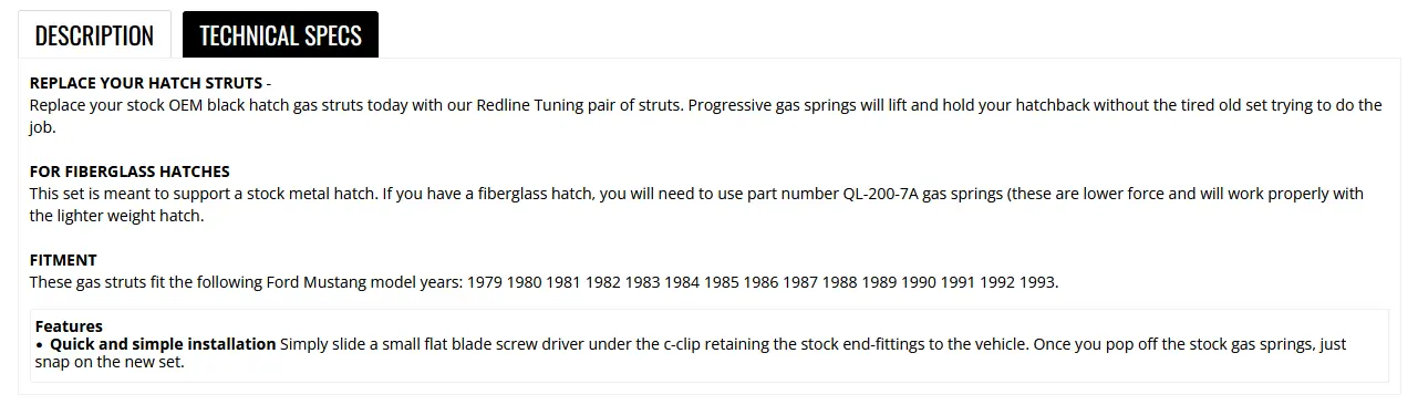

The OEM, I believe, is 14 lbs. For fiberglass, I imagine you'd need something in the 5 lb range.
The other relevant features are:
  • Extended Length: 29.06 Inch
  • Compressed Length: 20.47 Inch
  • Stroke Length: 8.58 Inch
  • Shaft Connection(mm): 10mm
  • Body Connection(mm): 10mm
You might have to fish around to find just the right one.
Just found the strut that Redline currently carries, Ill talk to a rep tomorrow when their open to get more information.
