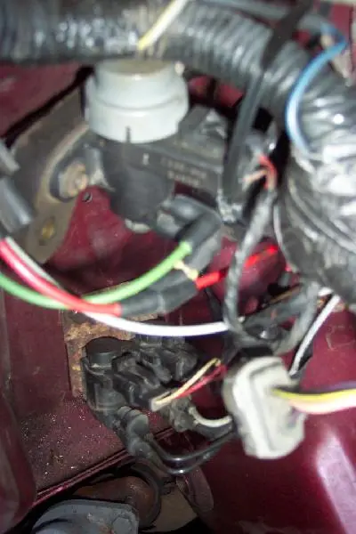

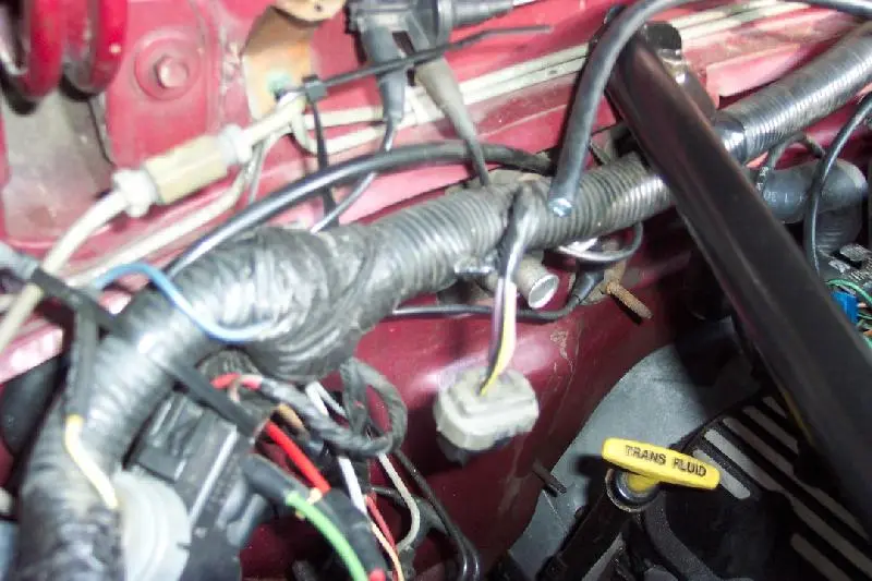

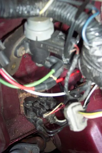

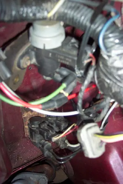

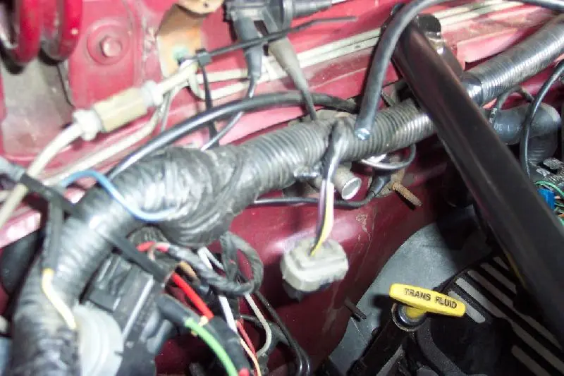

so; I found the EVR and it has a rubber vacume piece w/ one not being used, and two valcume lines going to similar canister like vacume things, and then from there it goes to the in the fender vacume ball, and then to the 3 tier vacume piece, and then to the vacume tree which is then hooked up to the intake.
so; should there be a vacume line where there's a blank vacume part here not be used, and go to the EGR?

On your picture of the EVR, the red vacuum line should connect to manifold vacuum. The green vacuum line should conncet to the EGR valve.
On my car, there is a 4 way rubber splice connector. The red line connects to a black vacuum line that goes to the manifold vacuum. The green line connects to a white line that goes to the EGR valve. You car is a conversion, so the splice may not be present.
