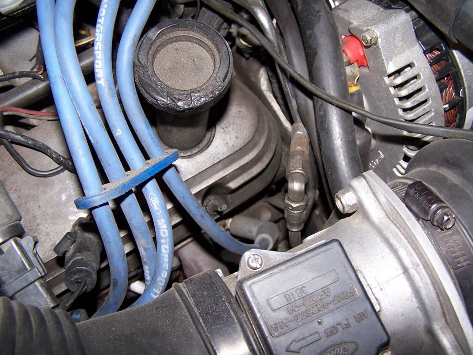

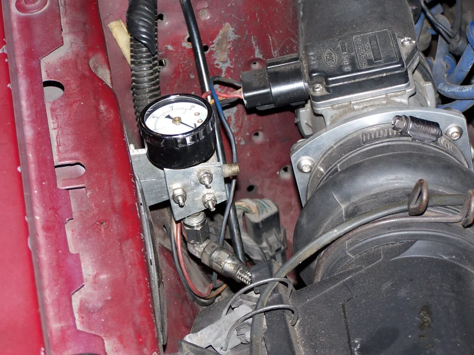

Fuel pressure test port connection- behind the alternator... The one in the picture below has a hose connected to it instead of the Schrader valve
What's the hose for?
Fuel pressure test gauge of course!

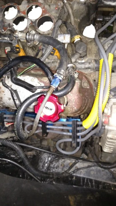

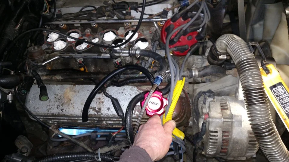

Ok, it appears I don't have that connection..
Lol I'm trying to un f+@k the previous owners messy build..lol
What's my next option?

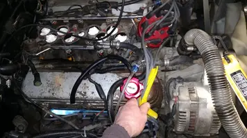

It looks like he put a newish fuel line on, whats my best option? Or am I screwed..lol
Is the upper (steelbraded) line the main feed? There's another line underneath the steelbraded one. Sry I dont know, but am willing and able to try anything with the help of you fine folks.
Thanks..

You really have a mess with those fuel lines! LoL! I hate telling you to spend more money, but either get some stock lines to replace those. Or get the braided kit from Late Model Resto.
Reactions: 88droptop5.0

What do the lines look like at the other end down by the frame rail?

The one steelbraded line goes all the way back, the other goes from the fuel rail (picture above) to a soft line, then to what looks like a factory hard line on the frame rail.

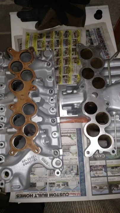

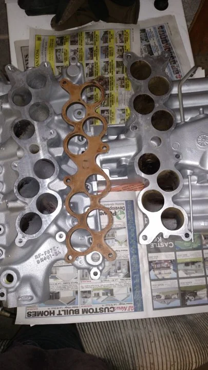

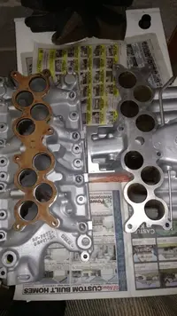

I have another quick question for you. when I took off my upper manifold it had a spacer on it. that spacer blocks a hole in the middle of the upper and lower intake manifold, does it matter that the small center hole is blocked off with the spacer? Or should I ditch the spacer all together? I'll attach a picture of it, thanks guys thanks a million. I should have my new map sensor tomorrow morning, who is to have that going for me..lolol.

liljoe07
5 Year Member
Feb 18, 2009
1,622
363
124
Cartersville,Ga
Mar 9, 2015
#69
  • Mar 9, 2015
  • #69
Spacer is not really hurting anything. Lots of guys use them. That being said, you can remove it. But.... Your intake bolts may be to long then. Just keep the swap simple and install the intake like you received it.

So the small center hole being blocked is no concern?

The center hole is part of the EGR system. Being blocked off won't hurt anything. Just don't expect to use the EGR. Pressure should bleed off over time naturally. But you can loosen the clamps on the fuel line to relieve pressure and catch the excess gas in the lines with a rag. But let the car sit for a while beforehand.

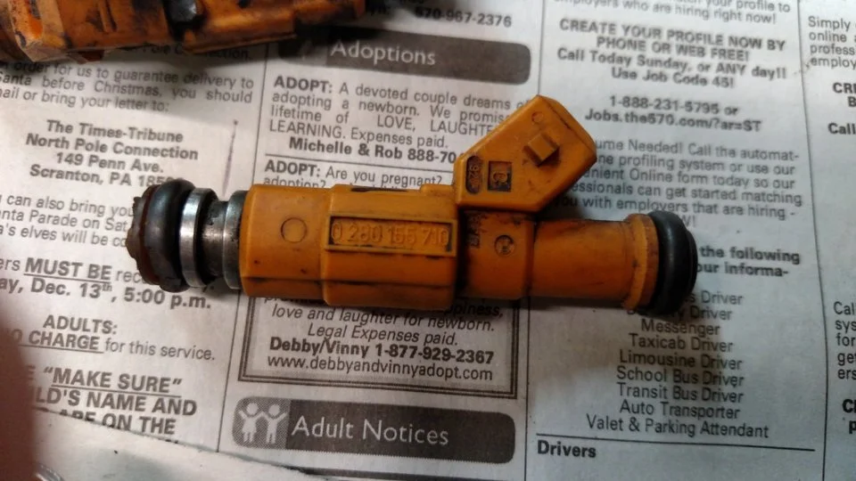

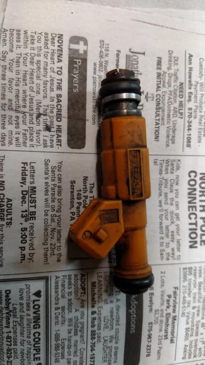

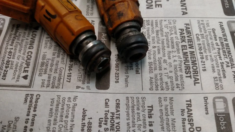

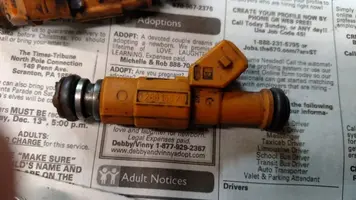

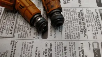

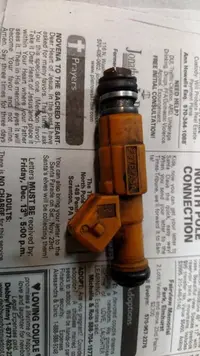

Ok, I got fuel rail and injectors out today. I don't think there stock mustang injectors, I think Explore injectors. they have four holes on the inside of them I'll attach a picture. I got a new O ring set for all the injectors but I need to know where to get the little plastic hat or whatever there called at the bottom.
I also ordered a new fuel line liljoe07..

liljoe07
5 Year Member
Feb 18, 2009
1,622
363
124
Cartersville,Ga
Mar 10, 2015
#80
  • Mar 10, 2015
  • #80
Great! That old fuel line seemed like a fire just waiting to happen!
