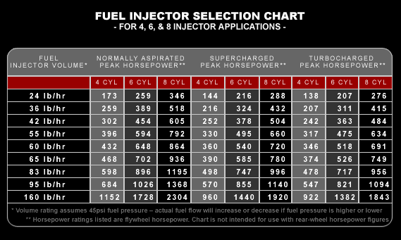

Decent chart and good rule of thumb for fuel injectors.
Note: These ratings are for stock fuel pressures and do not indicate max HP potential at elevated fuel pressures (like what you'd get with an FMU).
These are not for stock fuel pressure ratings. 45 psi is considerably more fuel pressure. Also, can anyone please explain why a turbocharger would need more fuel injector than a blower? I've seen that before, but I don't believe it.
Equal pressure from both sources (turbo or SC), I don't either. It's not a bible... just a chart.
