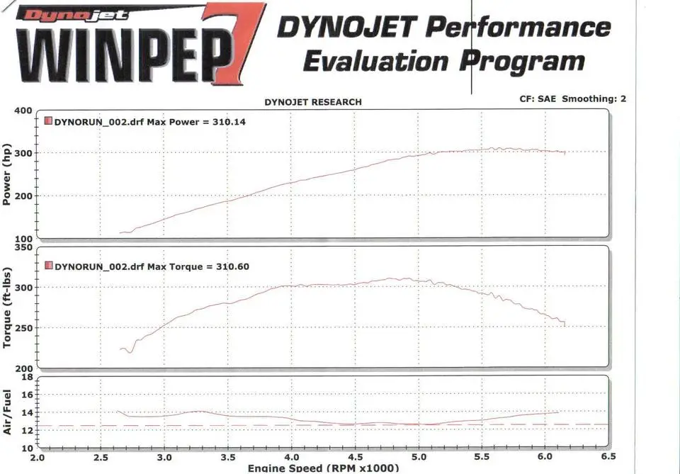

well as most of you know my car just put down 310rwhp on the base tune, and my tuner told me that the 19lb injectors are prolly going to be maxed out, he told me to get 30's and a lighting MAF? befor i go back to him, i dont think i realy need 30's, wont 24's be more then enough with the stock MAF?
The 24 lb injectors should be good till about 330 hp and that is estimated at 85% duty cycle. The 30 lb injectors will be good till 410 on the came scale. Bigger is not always better because you will have some loss of tune ability with the 30 lb around idle because your pulse width will have to be decreased a little more than a third. Just some things to think about. If you are not planning on going much over 330 hp the 24 lb injectors will be nuts on for you.

Im surprised you're not leaning out a bunch up top. I peak at 92/93% duty on my 19's. What's you A/F again?
Edit: I just looked at your graph, it looks like it is leaning out. I see it reaching 14 almost. Most N/A guys shoot for 12.9-13.1, with heavy mods closer to 12.8. But with your compression and cams you're going to want to be closer to 12.4-12.6. going towards 14 at those rpms is no bueno.
it does start to lean out after 5k, almost to a 14.0 AFR, look at the dyno graph, and i dont know what % duty cycle there at, but im sure there up there in the 90's
you mean 330rwhp right?, im not sure how much is still in it, but i dont think i will be over 330, how are 24s only good to 330rwhp, when my 19s are making 310rwhp?
Calculating with an 85% duty cycle 330 is right for 24lbers with your dyno graph it looks like you are over the 85% DC. 85%DC is a good safety factor for sizing your injectors but its not a set in stone number. Depending on what type of fuel injector you buy there is a limit on the amount of duty cycle you can run and keep your injectors at a linear rate. At the extreme bottom and the tippy top, injector flow is non linear hence the 85% factor.
