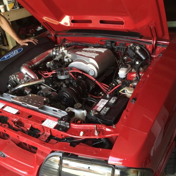

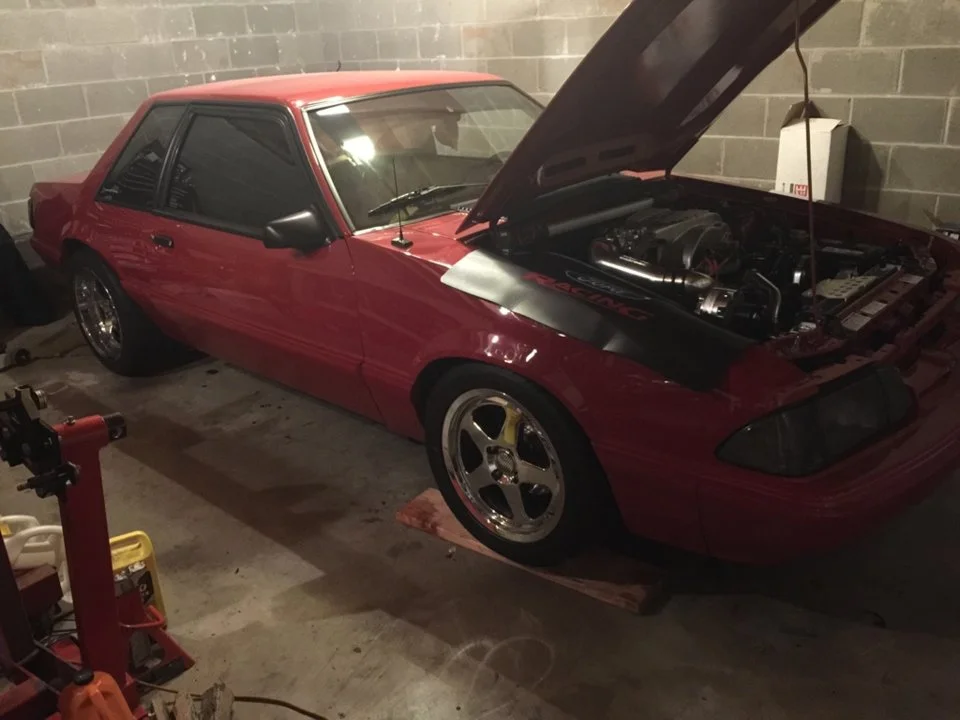

Well it does run sounds great oil pressure is mint but I have a fuel leak aero motives 45 fittings are junk . So I am gonna change that .
The big issue is there is a coolant leak most likely from a. Freeze plug on the back of the block . . Intake manifold is bone dry but I am getting a nice drip right from bell housing and the plate

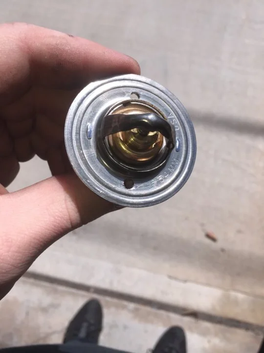

And for anyone wondering well how the. Hell is the coolant getting past the t stat if it never opened yet
I didnt have 200 miles on my fresh built stroker motor when dam therm put me on a flatbed the worst part it popped the chrome pipe off at therm connection and dumped coolant all over my powercoated chrome manifold and on lots of other billet and chrome parts. It was a summer night on rt 18 out in the boonies, when it popped i thought the motor went, anyhow i took the mr gasket high flow therm out and boiled it and the beotch still didnt open then it finally did with a hammer. So i ended up putting in a stant and drilled a couple holes in flang no problems since. The only funny part of that deal was i pulled all my clothes except underwear to clean the fn coolant off motor before it could dry so there i am standing in my boxers when a car pulls to the shoulder behind me to help a no bs it was a nice foxbody mustang he went and got water for me nice guy but it didnt help cause after a couple miles it started getting hot and thats where she went on a flatbed.
