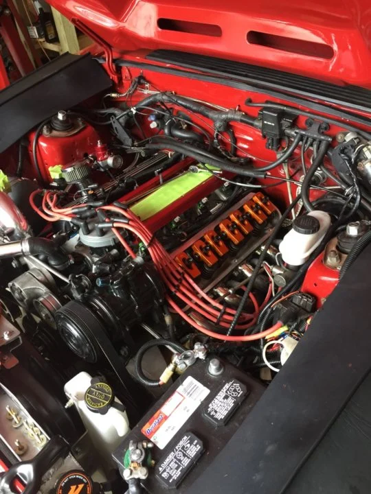

Jun 20, 2015
#2,445
  • Jun 20, 2015
  • #2,445
Reactions: stangboy and smkshw

So the other day I never mentioned cuz I wanted to check it out I heard a tapping . Sure enough I had a rocker back off . Re adjusted it today . Then adressed my belt that I tore a rib off of . After that was done I Re torqued heads per nicks recommendation . Drained oil . Put in the brad penn. fired the bitch up and no more tap ! So if the weather clears up I may try and put some miles on it . Few small things like a vac hose to replace . An inner tie rod and that's prob it . Then tune time

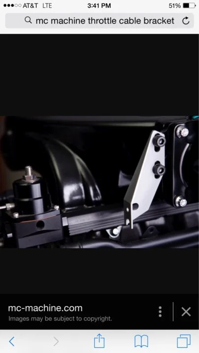

Did you have any clearance problems with those Ford racing valve covers? I bought some Panhandle Performance valve covers from someone on a Facebook page and they clear the rockers but they're too tall and I'd need an inch or inch and a quarter spacer, but I'd rather just get valve covers that fit right lol.
TOOLOW91
20+ Year Stangneter
8,501
8,763
S.I.NY
Jun 29, 2015
#2,455
  • Jun 29, 2015
  • #2,455
I had the intake on the car with those with no spacer and it just rested on the driver side but fit . Now it has a 3/8 spacer and fits no issue. I also have the mc machine throttle cable bracket which I highly recommend

Does the mc machine throttle cable bracket have a lower profile? Thats where the issue was on mine.

Yes it does . Before my stock one I had hacked up to fit

Awesome, I'll look into that then. Thanks

I just ordered one. I don't have tall valve covers but it looks cool so I gotta have it.

MUCH cleaner .
