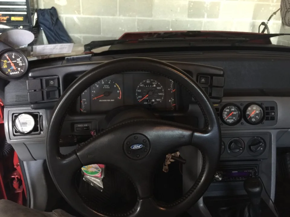

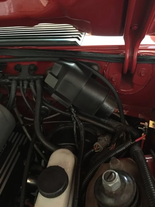

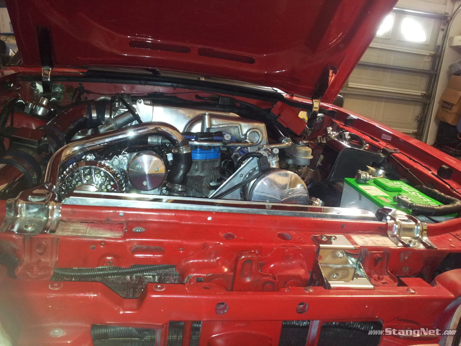

Got the 93 wiper motor cover on and the gauges in
Nice Jeff!!! That car is going to rip! I have one of those covers as well from a junkyard for $2. Didn't know how hard they are to come by.
You'd cringe knowing I paid almost 30 for that one but it looks brand new . Has one little blem on it . It deff made a difference over the nasty motor being all exposed

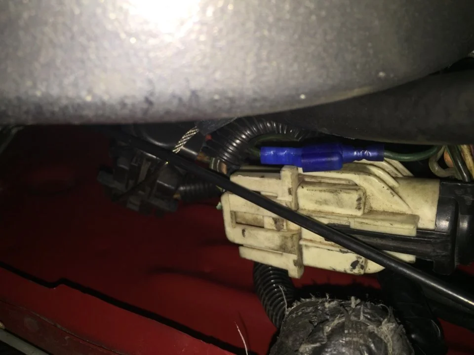

So I'm battling this tps thing still . Poor Nick @84Ttop hasn't heard the end of it . The plan is gonna be to go through the salt and pepper shakers and maybe change them to. A weather pack or a twist lock deutse connector . If not I may order the fast over the winter but nick stopped me yesterday lol. It never ends .

UPDATE . After work I went to the garage to play the whole tps dropping out deal . After looking at the circuit that was given to me in my tech thread . What I see is that the 5v ref and the ground supplied by the computer feed all the sensors . my only issue is with this sensor so leads me to believe that the return signal wire is the one affected . So what I did was cut that wire out of the harness and bypass . Well see hopefully that cures it .
