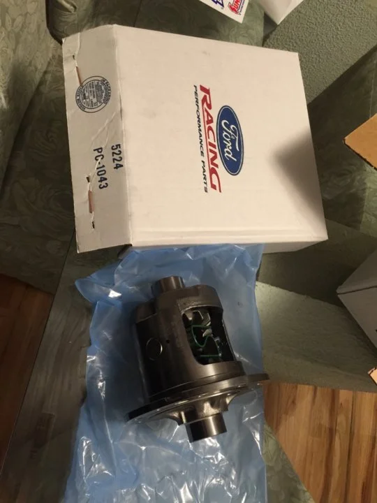

I need to be able to get a passenger in the car when it's quiet out at night to take some vid obviously I can't get to wild video and driving but @84Ttop can tell you how wild the car is when you get in it . Anyways i also had this waiting for me when I got home today

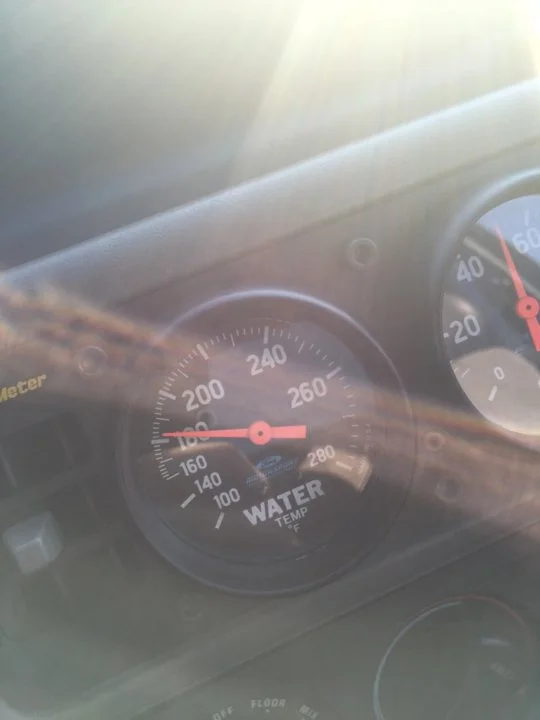

Temp is awesome esp on the highway for these nice crisp days
Reactions: 84Ttop and stangboy

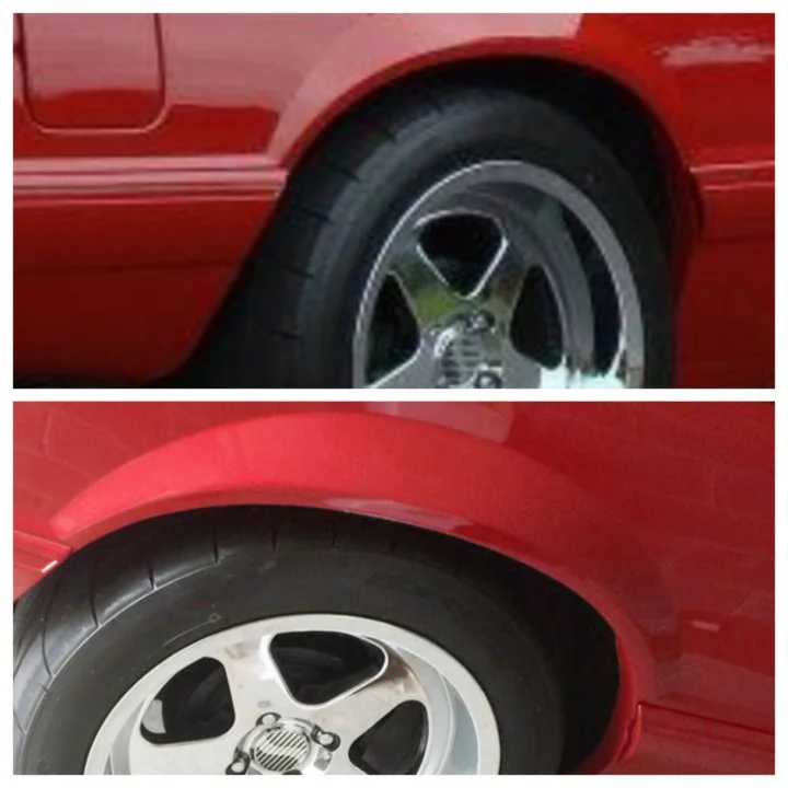

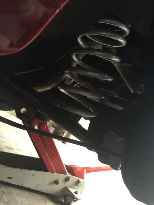

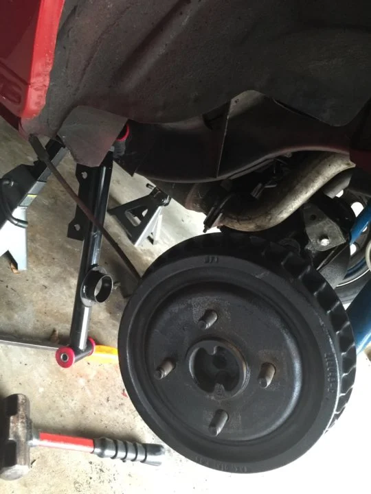

Installed the team z single adjustable street beast lowers to replace my megabite juniors and team z rear drag spring to not only improve the stance in the rear but also help it transfer some weight a bit . They haven't fully settled but both sides in the rear now sit even at 25 3/4 . And the angle on the lower arm is minimal where as before it was really pointed upward with those relocated style that the megabite are .
Comparison of the pass side rear which always sat higher with the old setup.
