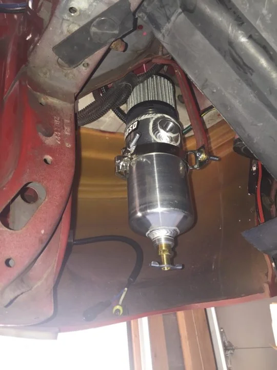

Got the catch can in. A spot where it's not in everyone's face . Easy to drain . And going through Scott's thread with his smoke issues through his this should allow me to over exaggerate the runs the lines need to make so the oil will get every bit of chance to vaporize.
I can't tell from the pic where you mounted it??
Lol I guess I did good then . Behind the front bumper between the radiator support and pass fender

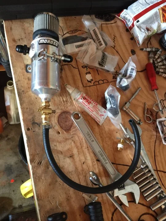

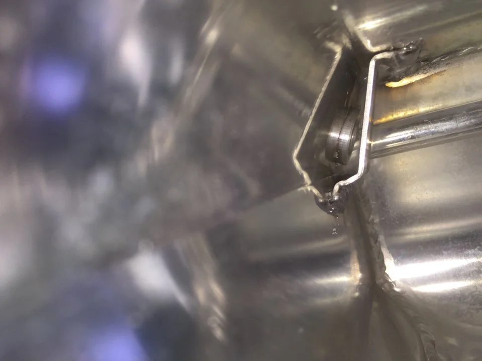

Made this drain up at work - figure that where the location is don't want the chance of oil leaking from the drain so the hose will be up at all times unless after a run and I need to drain it .

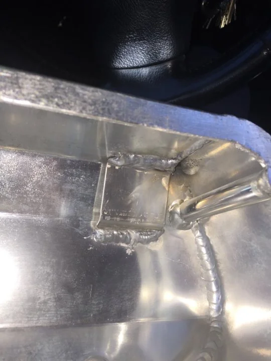

Valve covers aren't in place but the line for pass Side is made and . Ran out of hose to do the driver side so I just ordered some more will finish that up when it comes . Also gonna try to have some baffles welded under the fitting holes just to minimize oil splashing up through the cover .

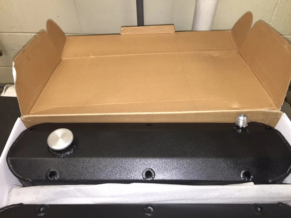

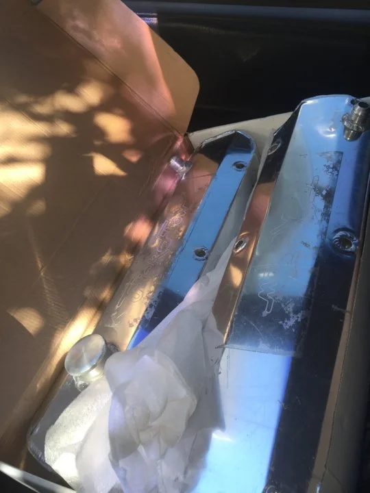

Spoke to local guy who does chassis stuff and welds . He's gonna whip up the baffles for me tomorrow on the valve covers . I'm gonna then test fit them . And prob shoot them crinkle black until winter then have them powder coated
Edit -Covers getting done as we speak pick up at lunch time tomorrow

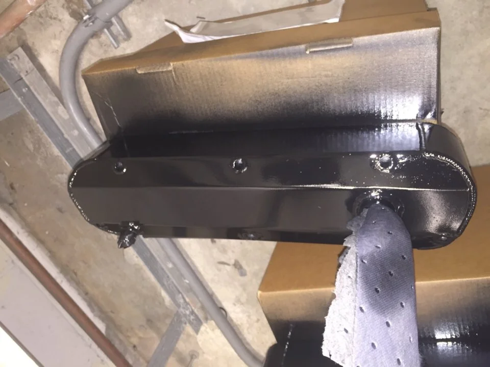

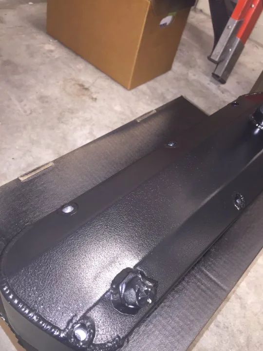

Covers with stickers removed . They are getting sprayed tonight . Big thanks to nick again for these

Got the baller crinkle black in full effect . I'm happy with it until I coat them they look awesome . Some minor imperfections but that's in the metal . The powder should fill them in .

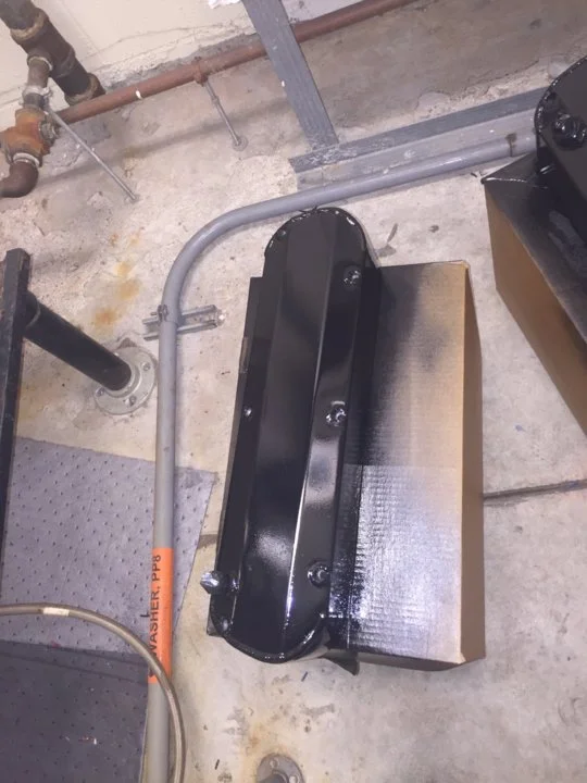

Crinkling right along here

DUDE!! They turned out awesome!
They look pretty slick now that they have actually cured ! That paint is awesome . I am actually re considering coating and seeing how they hold up and doing the intake too .
