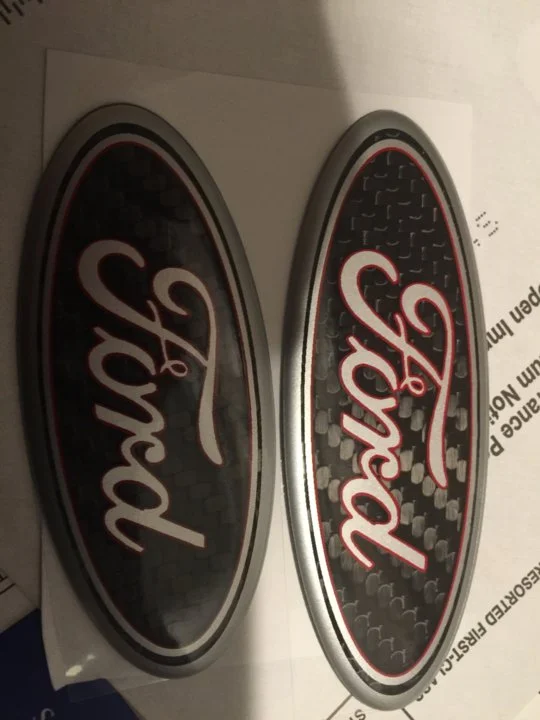

Where did you get those? Ive been searching for black one with no luck. Im trying not to put blue emblems back on my car.
Are you on Instagram by any chance ? I had them made and the person who made them basically does it though Instagram . They were not cheap either but deff would be worth it for a car with killer paint like yours
Send me the guys Instagram info. I'll join just soni can get the emblems. LoL! Are they overlays or what? Kind of hard to tell in the picture.
Over lays . Very very high quality
His name on Instagram is rebadgedesign
Reactions: 84Ttop and liljoe07

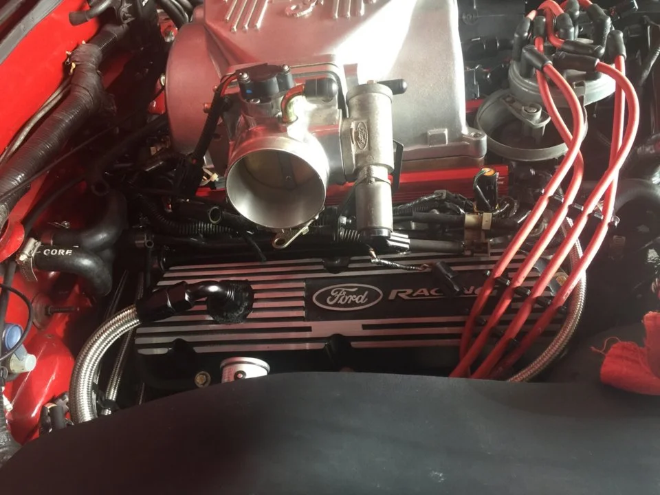

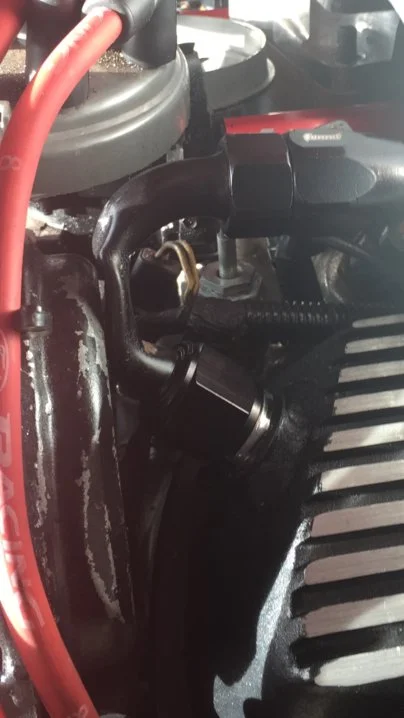

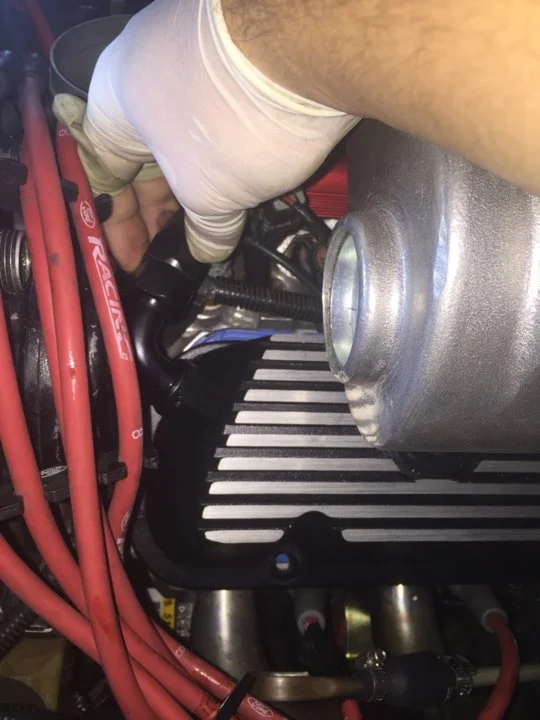

So today's fun goes something like this . I got the covers all ready to go on extra line and fittings . Fiddle with the drivers side after getting it down move over to pass side and bang doesn't clear the power pipe .
Now I love these damn covers . But honestly I am just so tired of going nuts modifying that I'm not ready to cut them up and make it work .
So my new plan goes as follows . Shorten up pass side line to meet where the breather hole is and have a 10an fitting welded in it . Then use my old efi cover with no hole and weld a bung out of the front cuz the breather hole will not clear the intake if a fitting was welded in on the driver side cause of my intake .

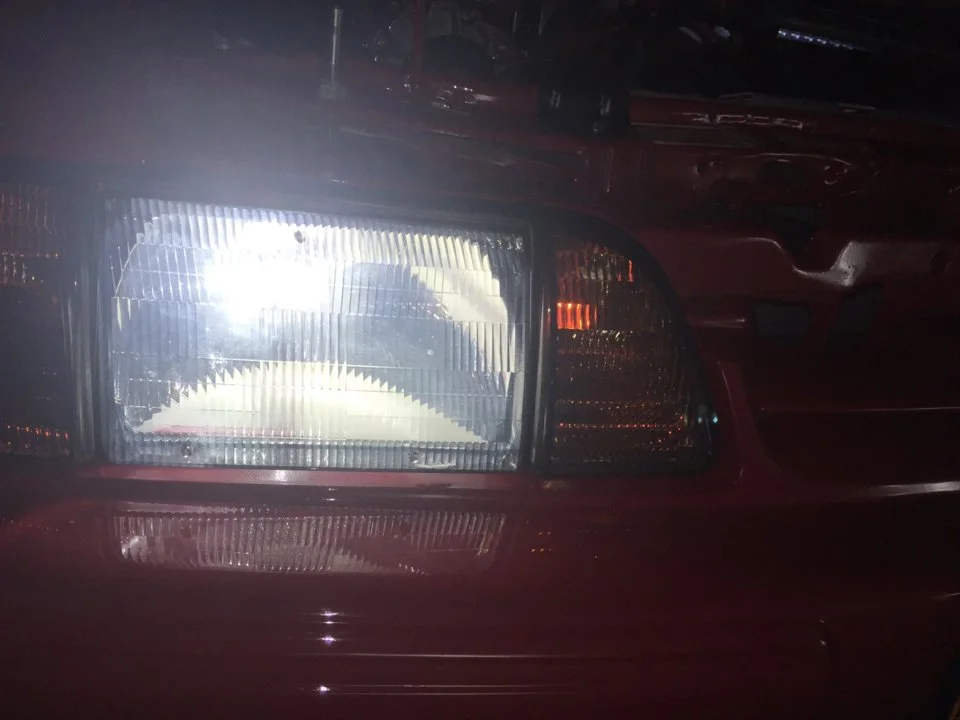

Also replaced my bluish 6k headlights for 5k after the pass side ballast took a. Dump I bought another kit and took car of the that .

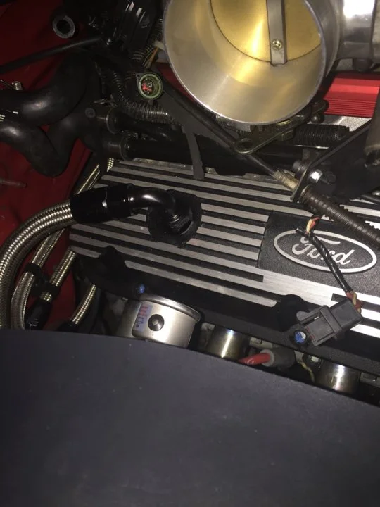

New fitting will go as follows with a 180 degree fitting in it .
Other side will use the carb style and fitting will go where the round breather hole is

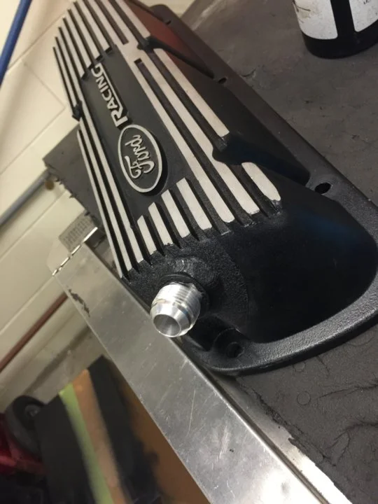

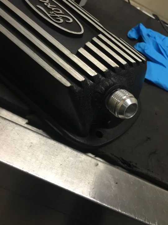

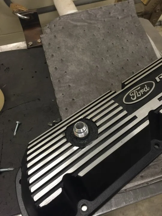

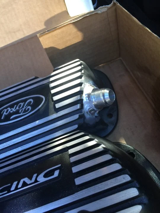

Lines already trimmed for this setup . Other line for d/s is cut and ready to go just waiting on the 180 fitting . And 2 alum fitting so we can weld this stuff in

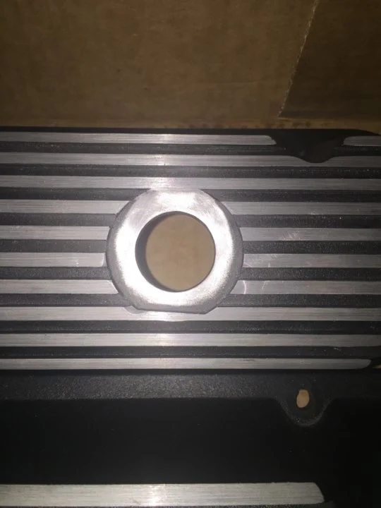

Semi prepped for the welder . Let him drille the hole on the driver side one I just took the paint off for him to weld on it .
Reactions: stangboy

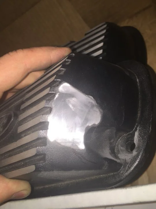

Figure I'll mask just the area where he welds on the d/s one and crinkle it . And call it a day . Won't be able to notice esp that it is behind the ac compressor

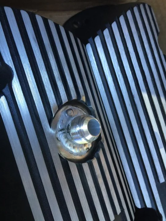

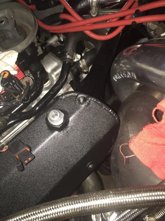

One side easy as pie . The other not so much . Right now there's a few options . Problem is when it was welded he went to the inner most part of where I took the paint off .
In hindsight I should've went on the back of this one but its to late at this point . I ordered a hard 90 and a hard 45 adapter for that side . Also a few fittings . If that idea don't work I ordered a ac delete pulley . If and when I get a round to re installing it id deal with it then .
I crushed the fitting in my vice just to see how much it would take to make it fit . Massaging would've been ok with me but this is too much .
