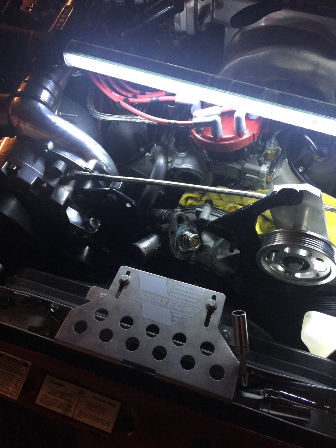

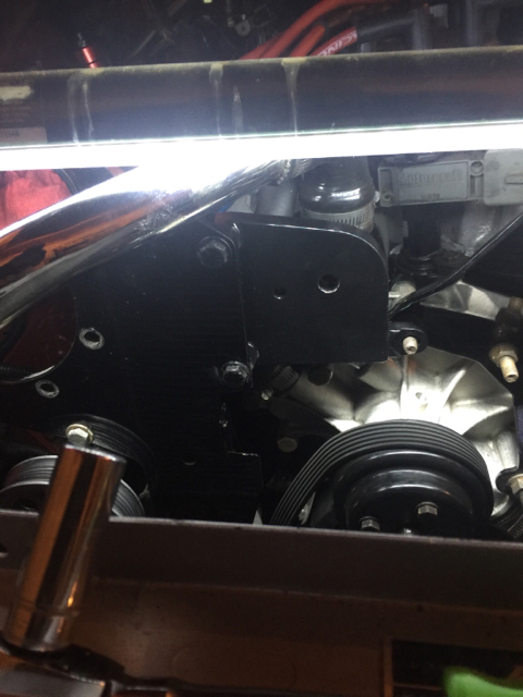

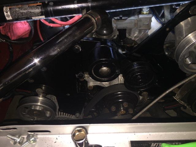

Amazing what a little paint did for that belt tensioner bracket .

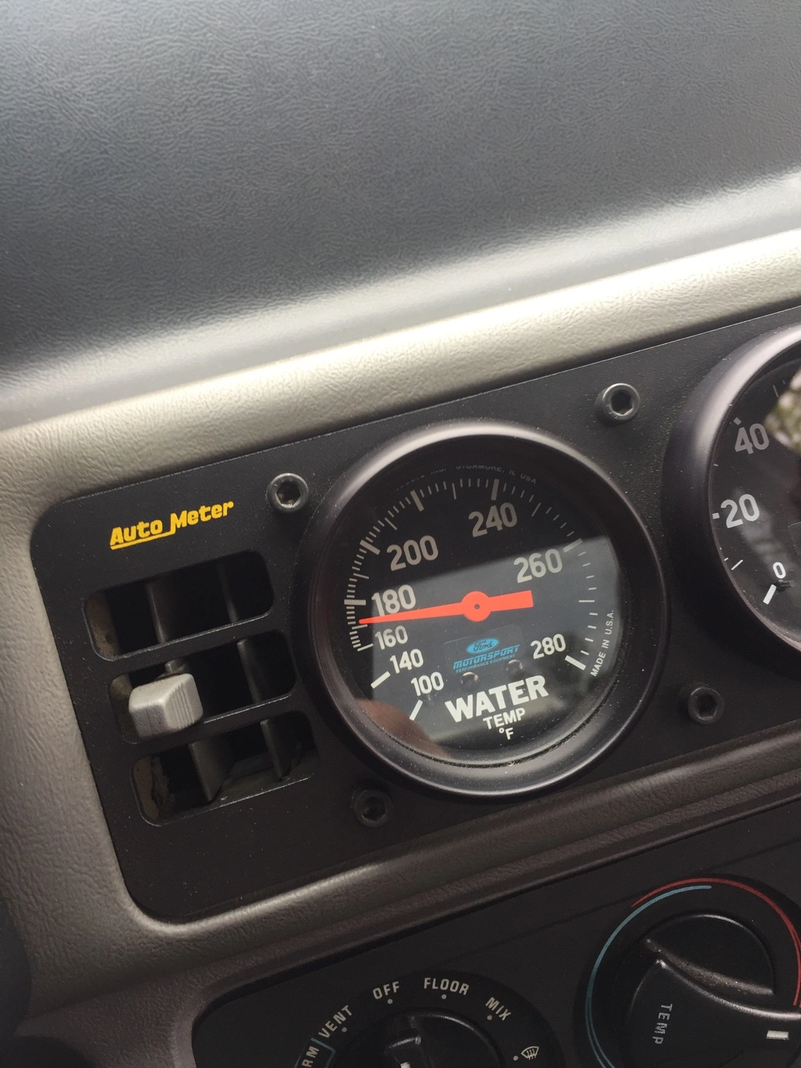

I had posted a thread about a lazy t stat . Well I took the advice from noobz I re bled the coolant system and drove it Sunday and still no change. Checked over some stuff today and drove it and nada . Car is acting like the t stat starts to close or gets stuck half shut then re opens .
Did some reading and come to find out the stants have been known to have the issue . Ordered a new motorcraft 180 t stat . Drilled some relief holes like I did the last time to make it easy to bleed the system and always have some bypass flow . Just finished up and got home after working tonight . Will fill and burp tomorrow .
