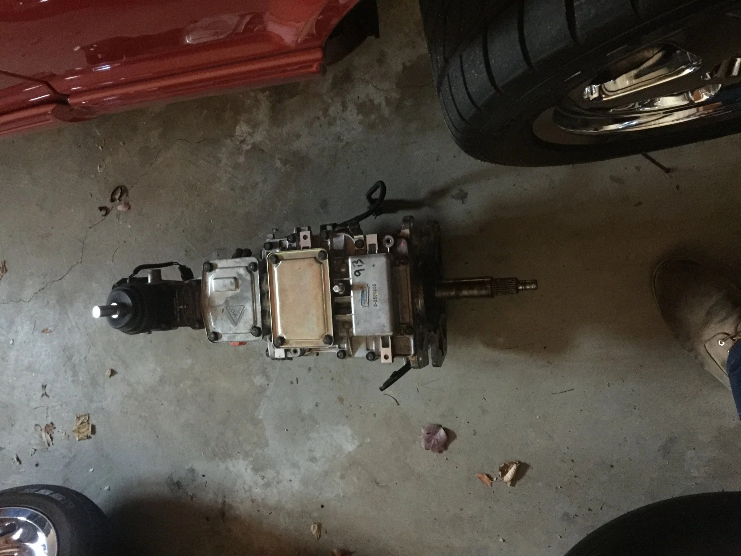

So it seems when I had the single disc in the car that was slipping I may have nipped a 4th gear syncro I had an intermittent grind ever since the car went back together with the twin disc.
I just pulled the trans - Monday it goes to rockland standard gear to have the high rpm upgrades done . Carbon fiber syncros, blocked rings , bronze shift fork pads and the rail upgrade to help the high rpm shifts.
I also plan on welding the 3 inch ends on the exhaust now that I have it all out .
I plan on the YSI still with my Pms . 5 Lug swap will prob start once the trans and exhaust are back in . I leave for Georgia next week for the lights out 8 small tire race so that leaves me a week of nothing . But the trans will be dropped off Monday so that will be taken care of while. I'm gone
That's the upgrade I had done to mine when i ordered it from American Powertrain. I hope it works.

Car was originally built around wanting this blower . @Boosted92LX I don't have it yet , vortech is building it .
Dropped trans off today for all the upgrades . Was gonna do it myself but the parts are like 550-600 . For a little more they do it and blue print it .
