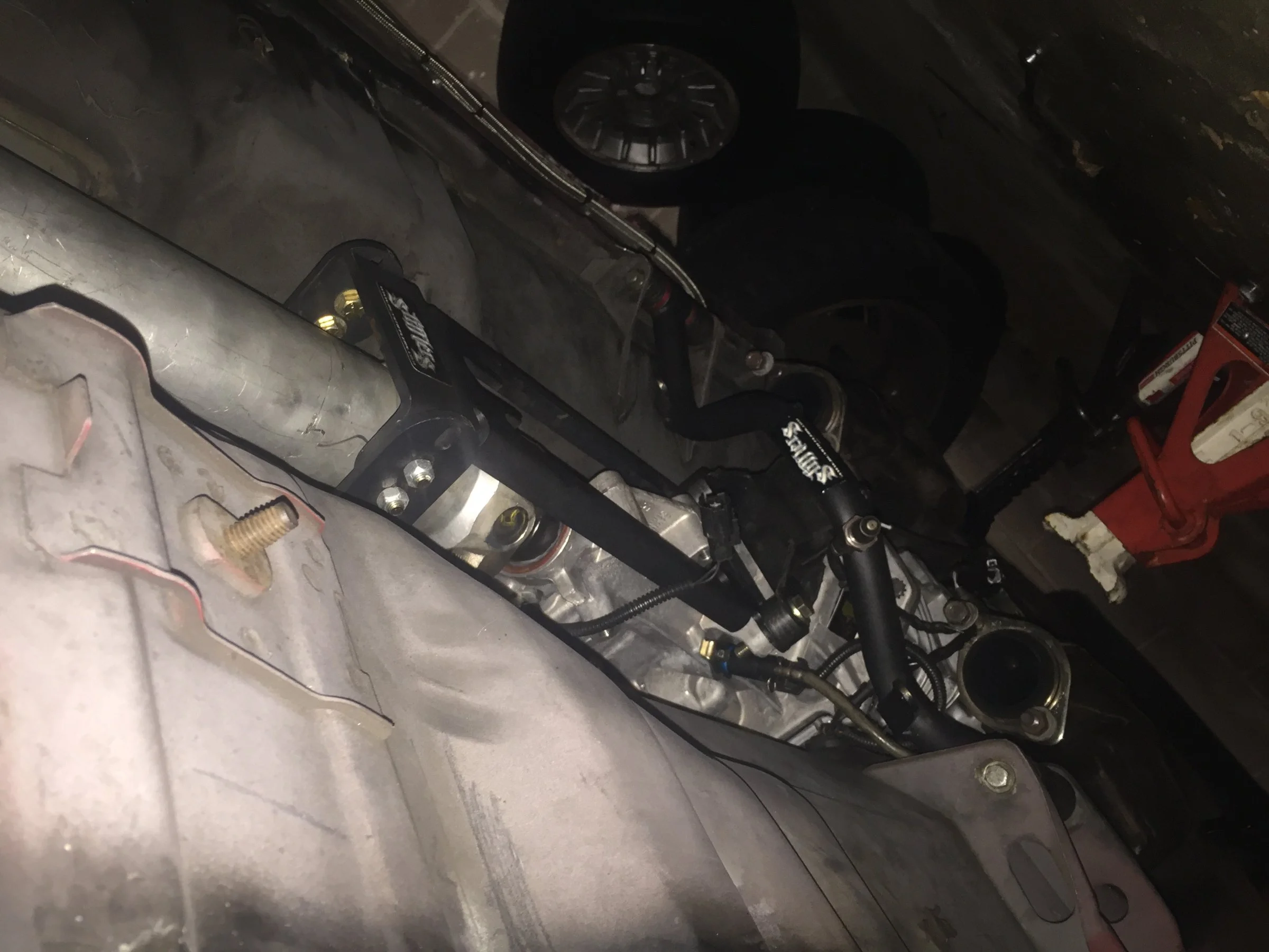

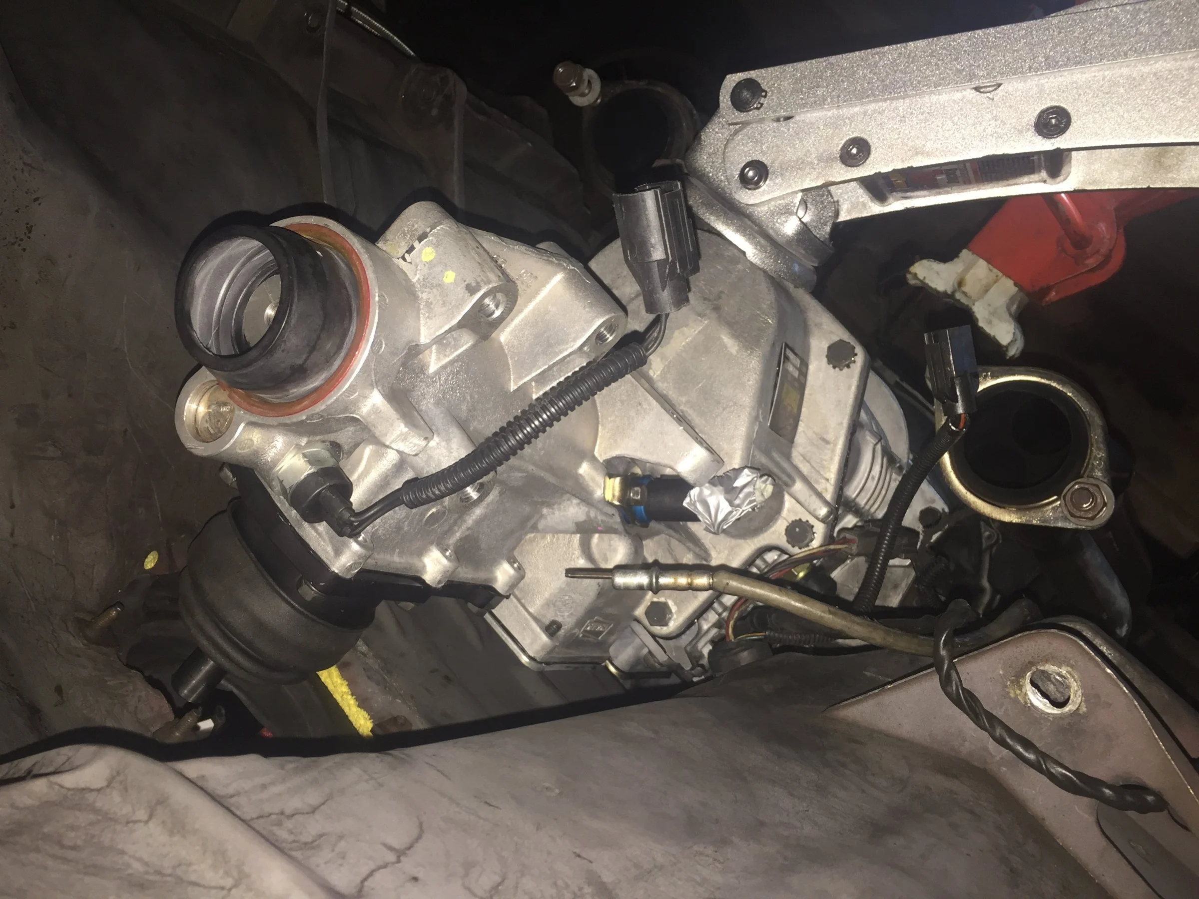

So it seems when I had the single disc in the car that was slipping I may have nipped a 4th gear syncro I had an intermittent grind ever since the car went back together with the twin disc.
I just pulled the trans - Monday it goes to rockland standard gear to have the high rpm upgrades done . Carbon fiber syncros, blocked rings , bronze shift fork pads and the rail upgrade to help the high rpm shifts.

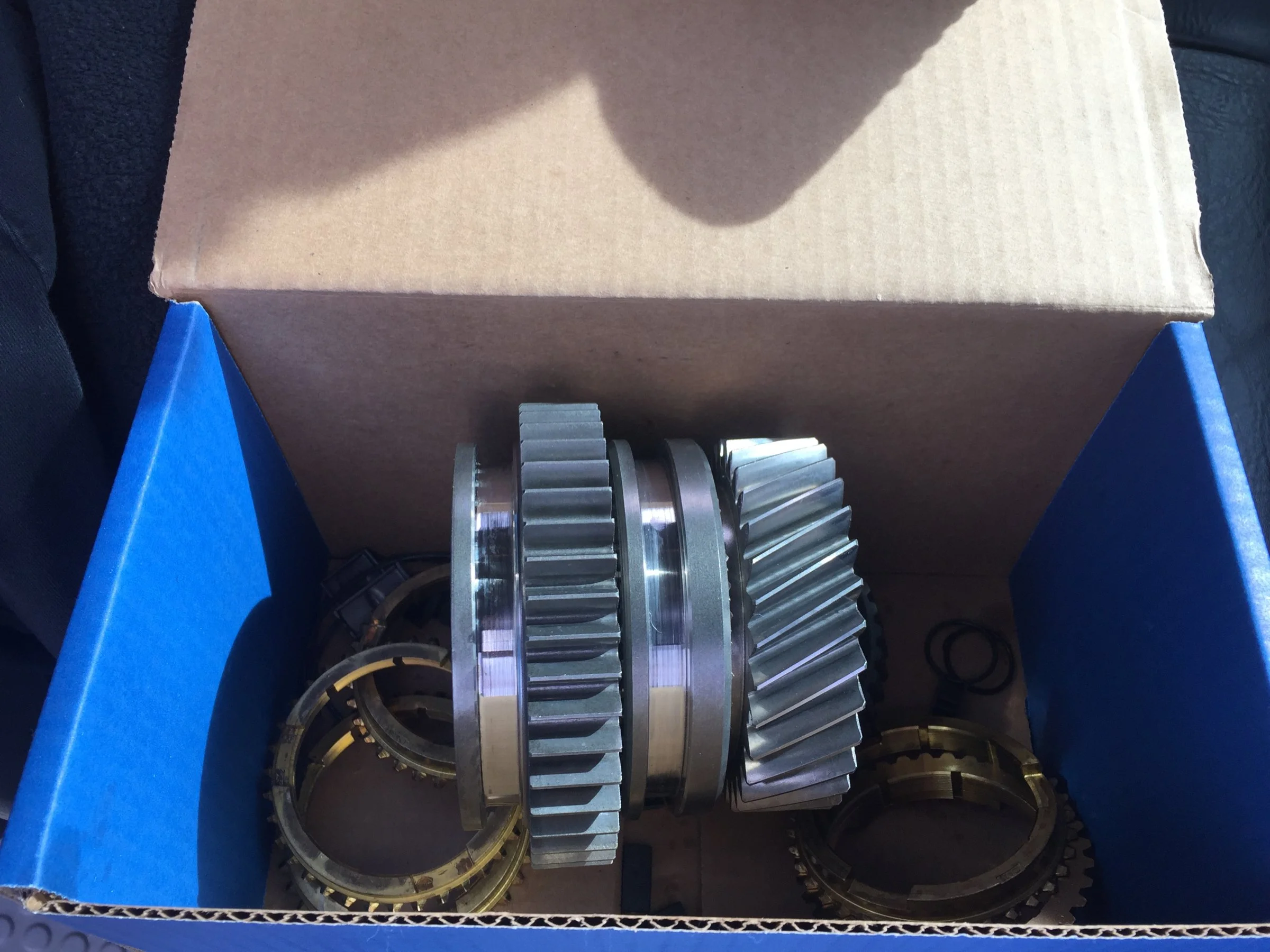

Picked it up this morning along with the box of carnage and old syncros . 2-3 assy was messed up as well as 4th gear cone . Women on the phone asked how hard do you shift second ? I said idk around 63-6800 without lifting off the throttle . She goes yeah we can tell you did a number on second gear ...
