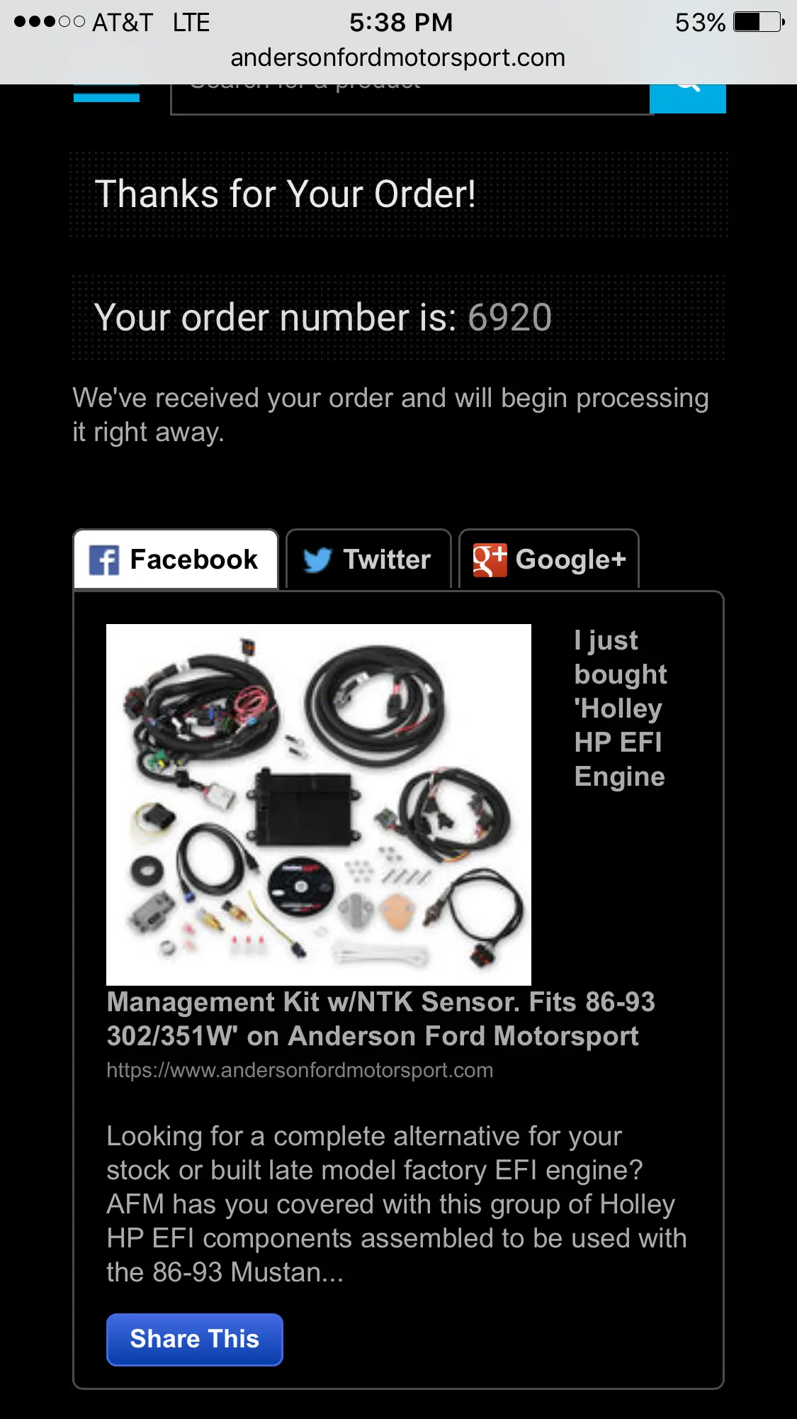

TOOLOW91 said:
I did a thing .
TOOLOW91 said:
Full standalone . Best way to go . It will run anything from a bone stock car to the baddest of the bad . Can data log with a laptop . They also make a screen for the dash with all different gauge configurations in it that's extra
TOOLOW91 said:
Comes with everything . Replaces stock engine harness . Full standalone
TOOLOW91 said:
1890 to my door with the wide band sensor included .
...and then the crying began.
Seriously... I want to see if this is plug-n-play or plug-n-pray. Good luck (for real).
