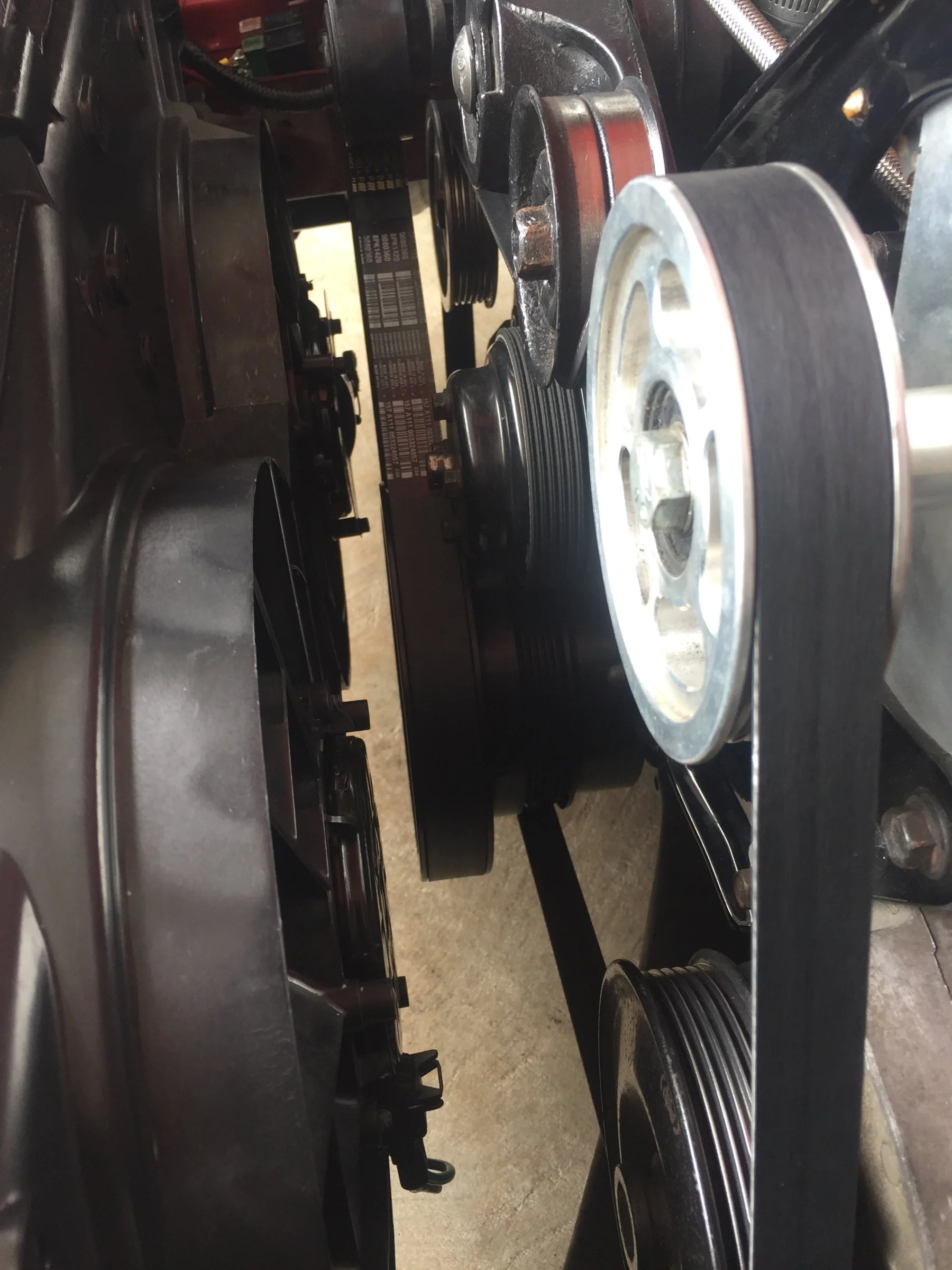

They are but the renegade pulley only comes from them with an undriven crank acc belt . Kris recommended having asp make the 8 inch blower pulley with the standard acc belt pulley size on it.

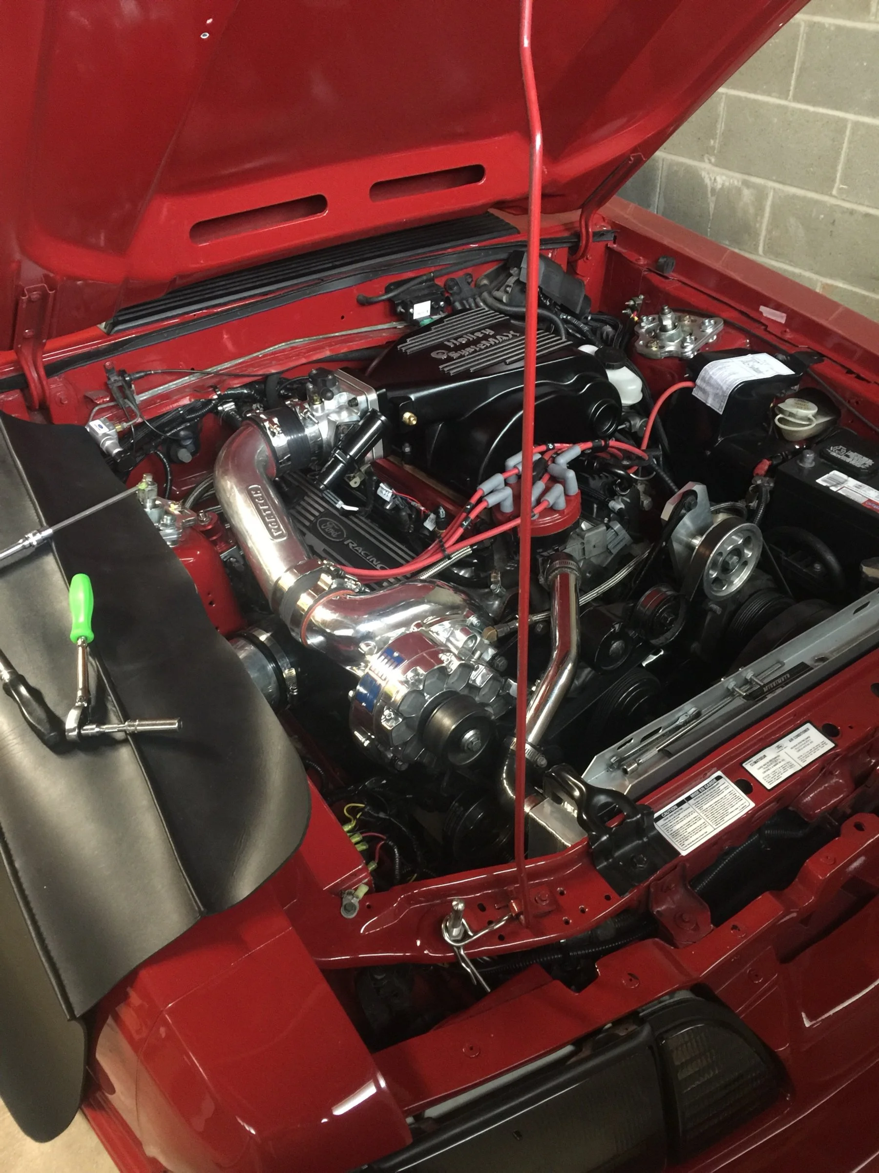

Well its been hectic but i managed to work overtime today and get the car completely back together and running. All ineed to do tomorrow is swap the crank pulley, Run a wire from the cluster to the msd for a tach lead.
Tuesday kris is supposed to get it on the rollers. I tried to tuck the harness down and keep it as neat as i could. Ill post some vids in a few.
Reactions: A5literMan

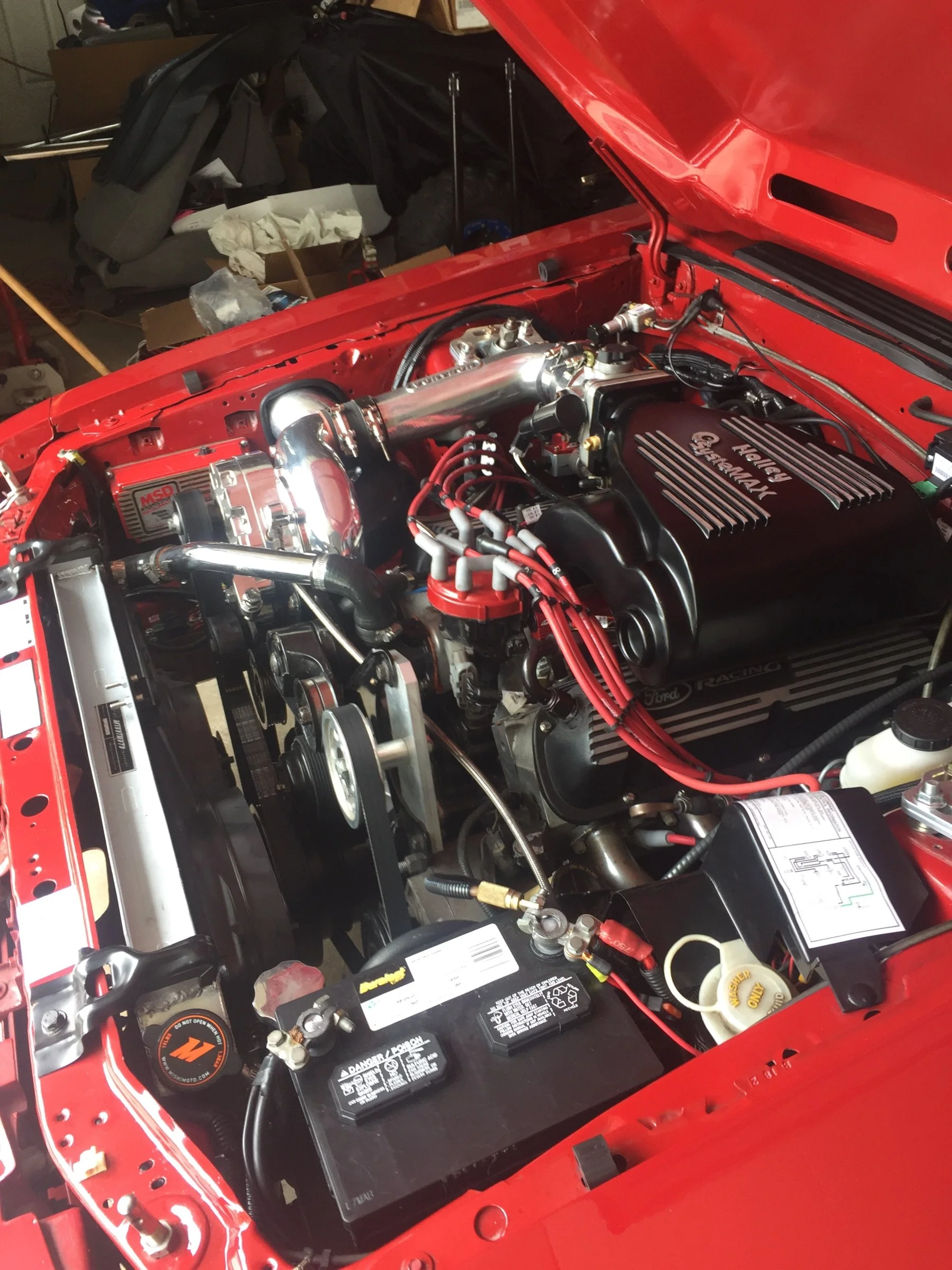

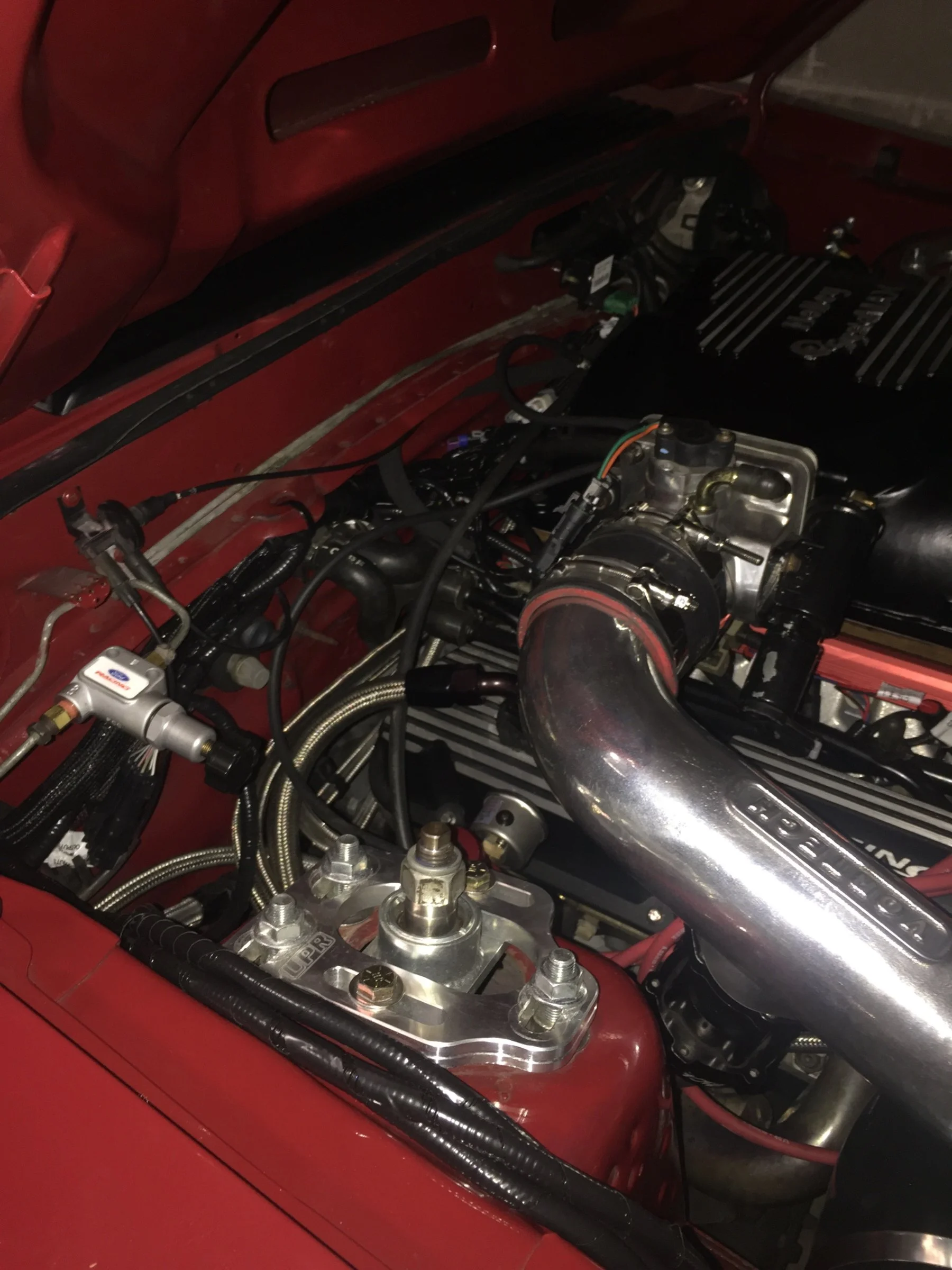

Here's some pics . Everything needs a good bath and to be polished up

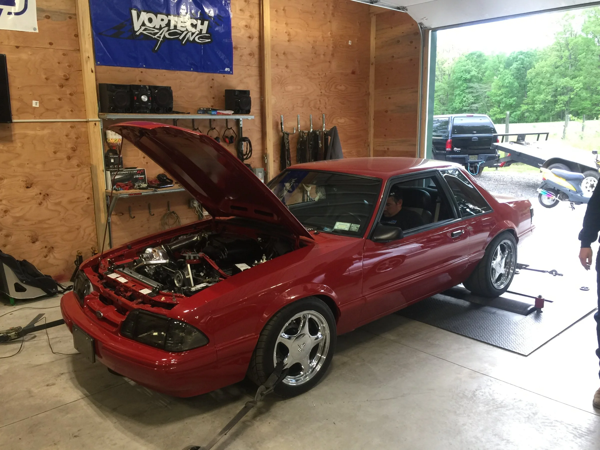

We got it all ironed out took it for a ride worked on some stuff a bit with drivability .
Made a full pull and saw 705 at the tire on straight 93 pump gas . Plugs looked good but we all agreed to dial it back a bit seeing 17psi . Played with it and got it down to a safe 639/662 at the tire .
We then spiked the fuel with 5 gall of MS109 .
The car made 740/730 at the tire.
It's wicked .
