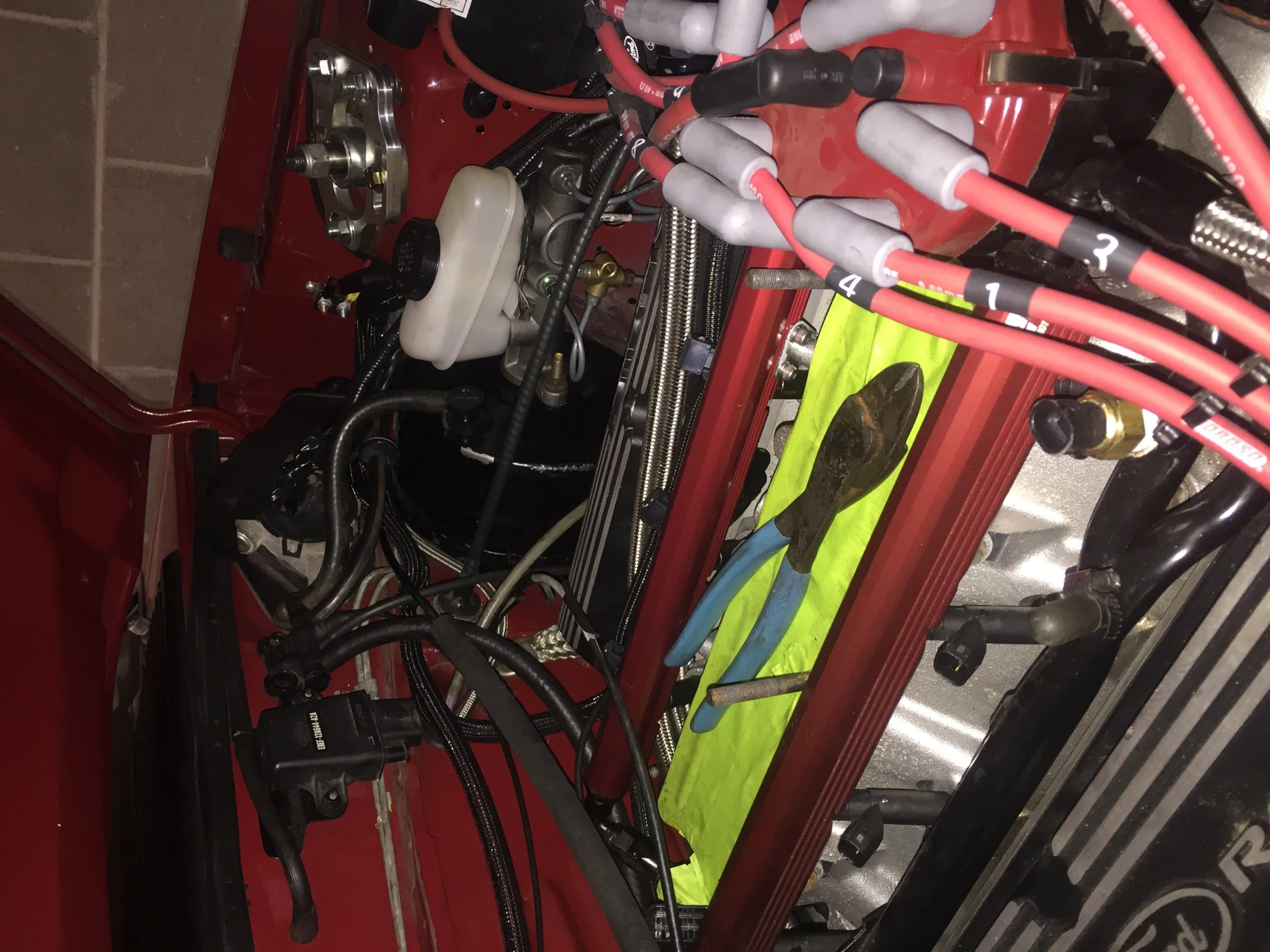

Tonight consisted of
- Tying in msd points wire to the Holley dist harness and looming it . Giving the msd a key on ref being that it no longer comes from the eec.
- running Holley ecu power and ground harness through fire wall and hooking to direct battery power .
- removing mass air meter

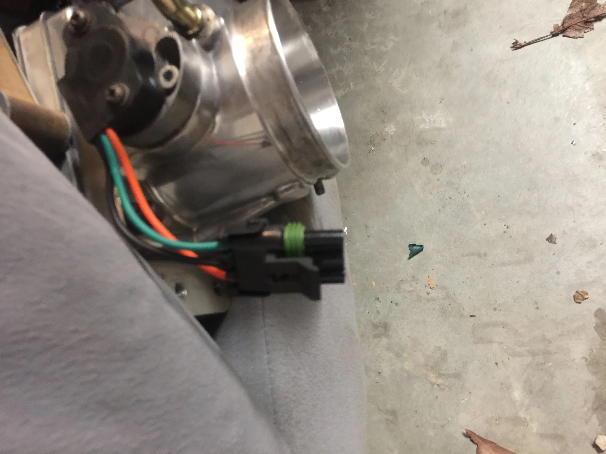

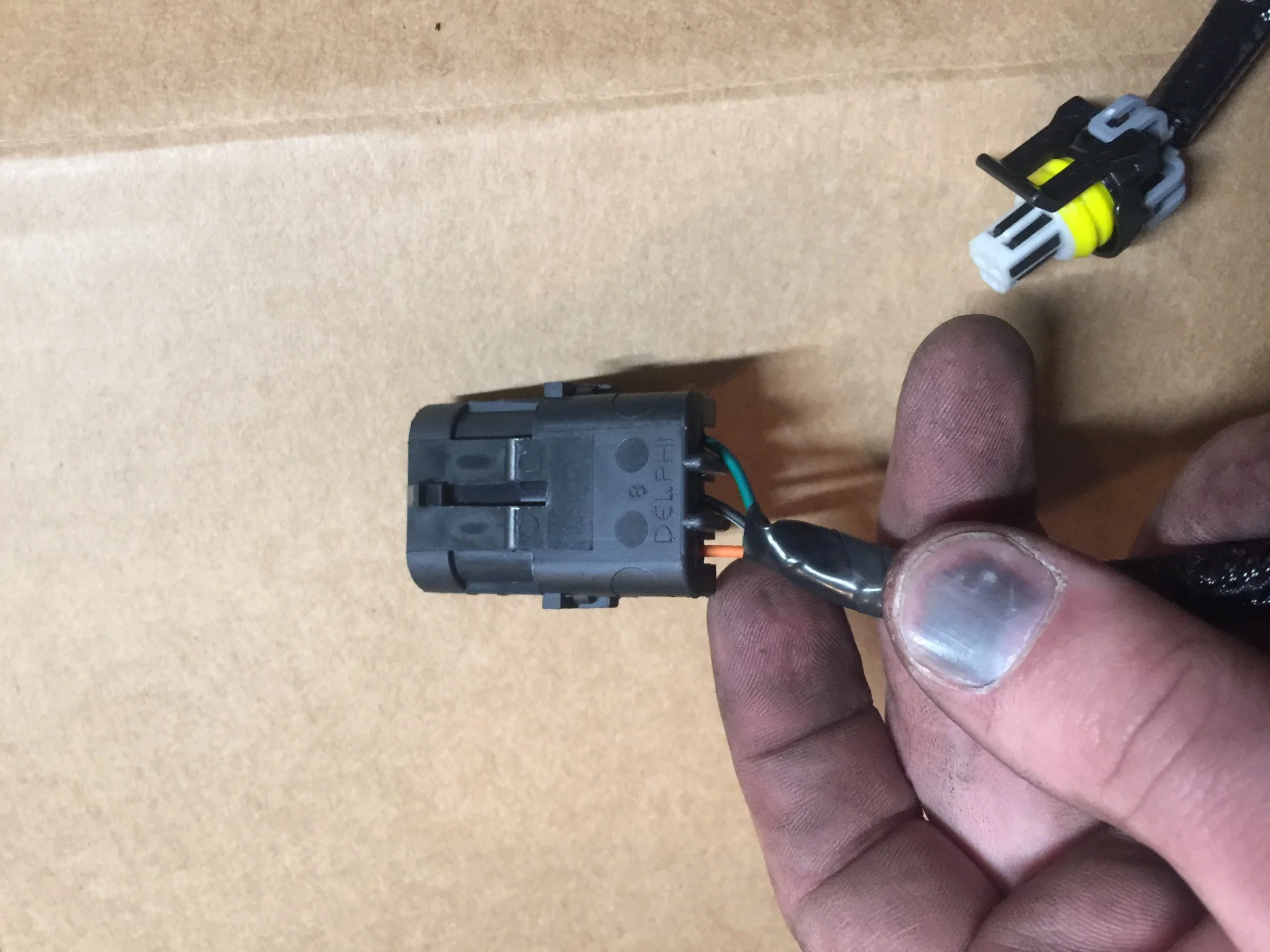

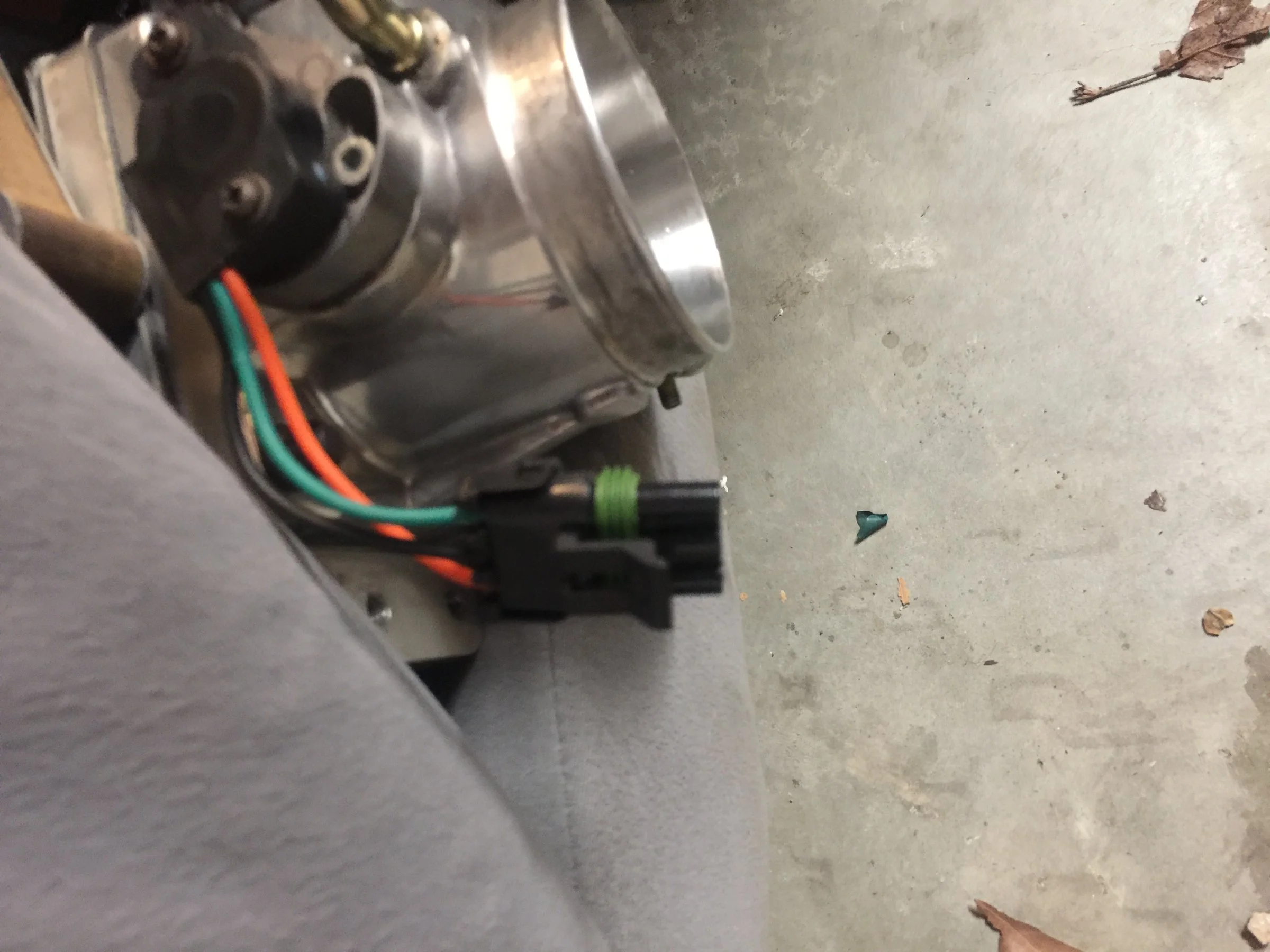

-re pinning tps for 3 pin gm weather pack.
- took elbow off the power pipe for the recirc valve since it's getting a BOV
- swapped out ECT and IAT sensors

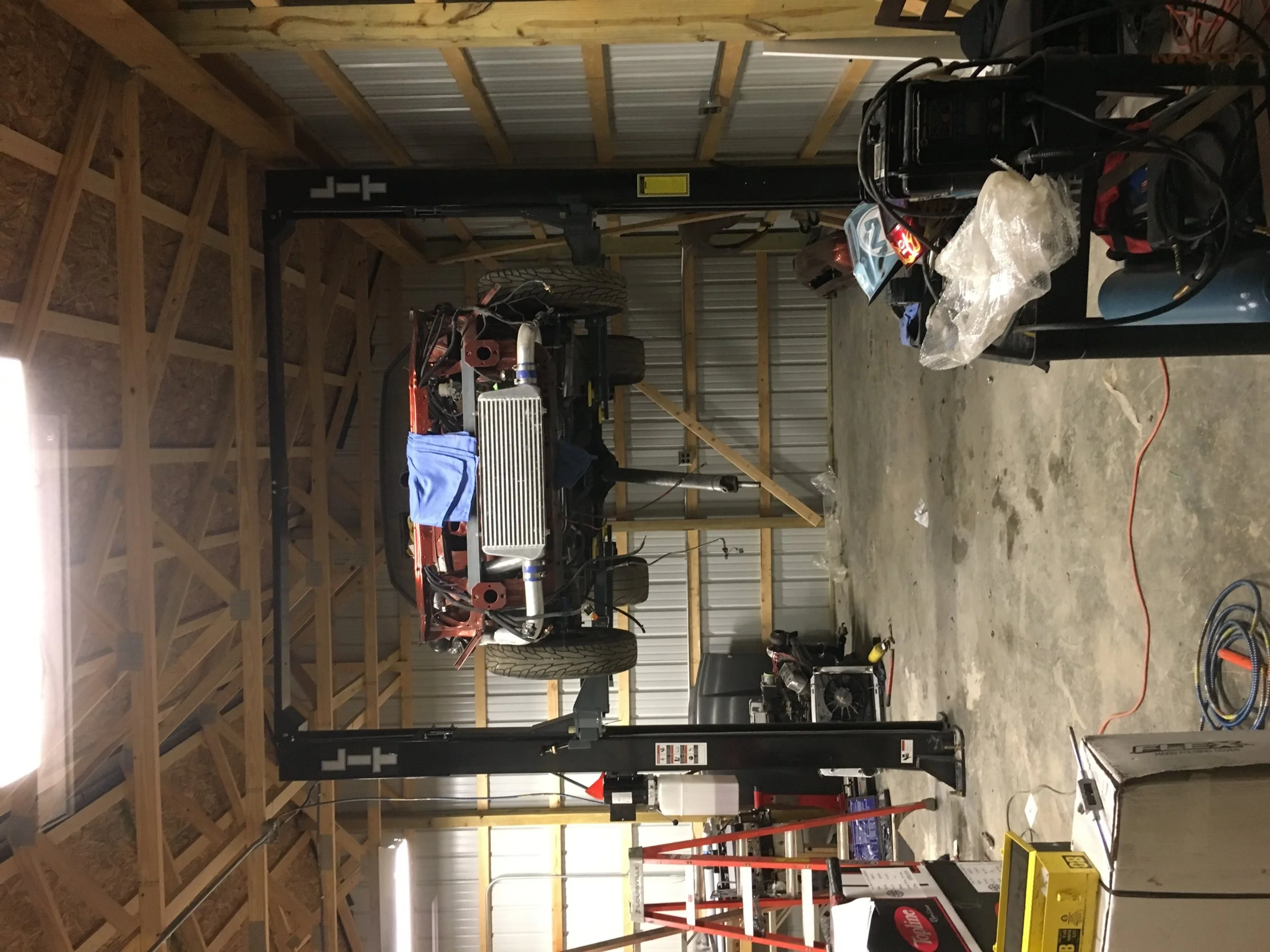

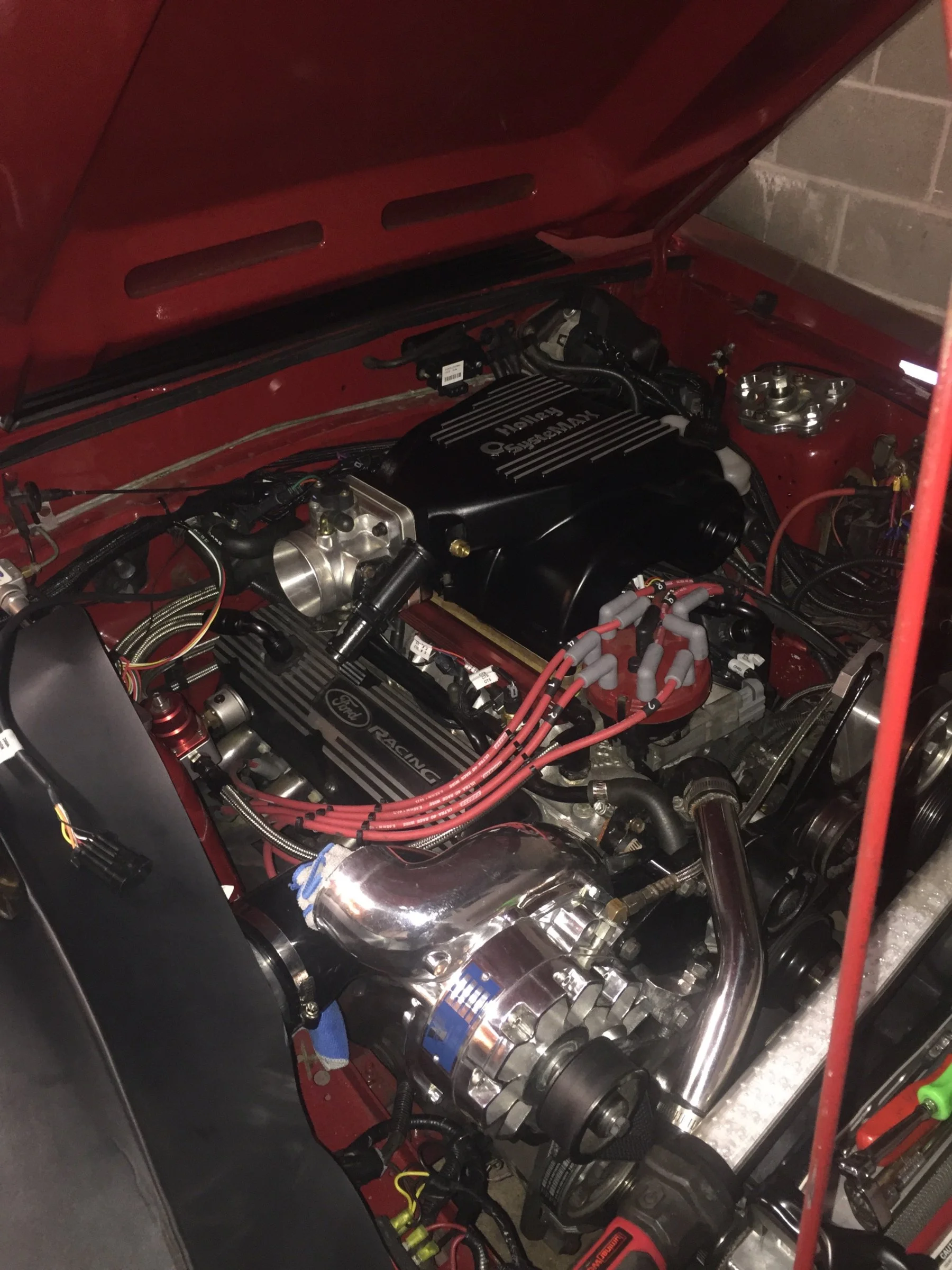

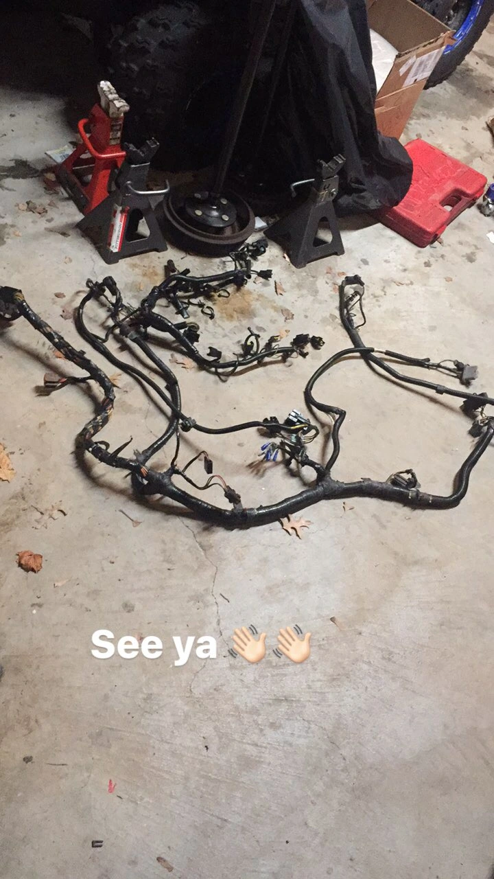

Plugging away . Main harness and injector harness installed . Main harness looks a little bulky due to some of sensors I wasn't using I just zip tied to the harness . I had to open up the harness and move some of the sensors around and extend the coolant temp sensor wires . Re taped the loom up and that was it .
Test fit the intake .
Installed the 90 degree elbow back on the power pipe .
Still have to make the fuel pump connection. One more power and ground connection to make for the injector power in the harness . Wire in the iac lead , the fan control leads to the I/o harness . Install the wide band 02 .
And the harness is basically done .

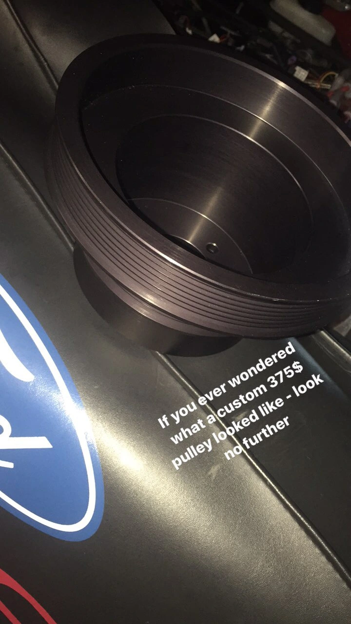

Custom 8inch blower pulley with stock size serp pulley on the back of it . Normally the vortech renegade is underdriven . I didn't want that . Didn't want to change my belt or anything else .
Reactions: A5literMan
So the price has dropped then. :)
When they were made to order, they were considerably more. I have 3 or 4 different ones lying around somewhere. When I got a quote for a just an over sized crank pulley (single belt) it was over $700. :notnice: I'm sure someone has these made and sitting on a shelf by now.

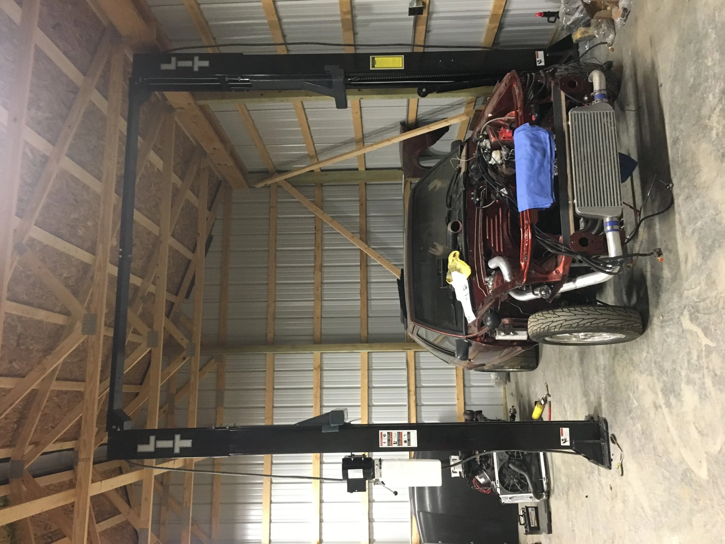

So tonight's progress consisted of.

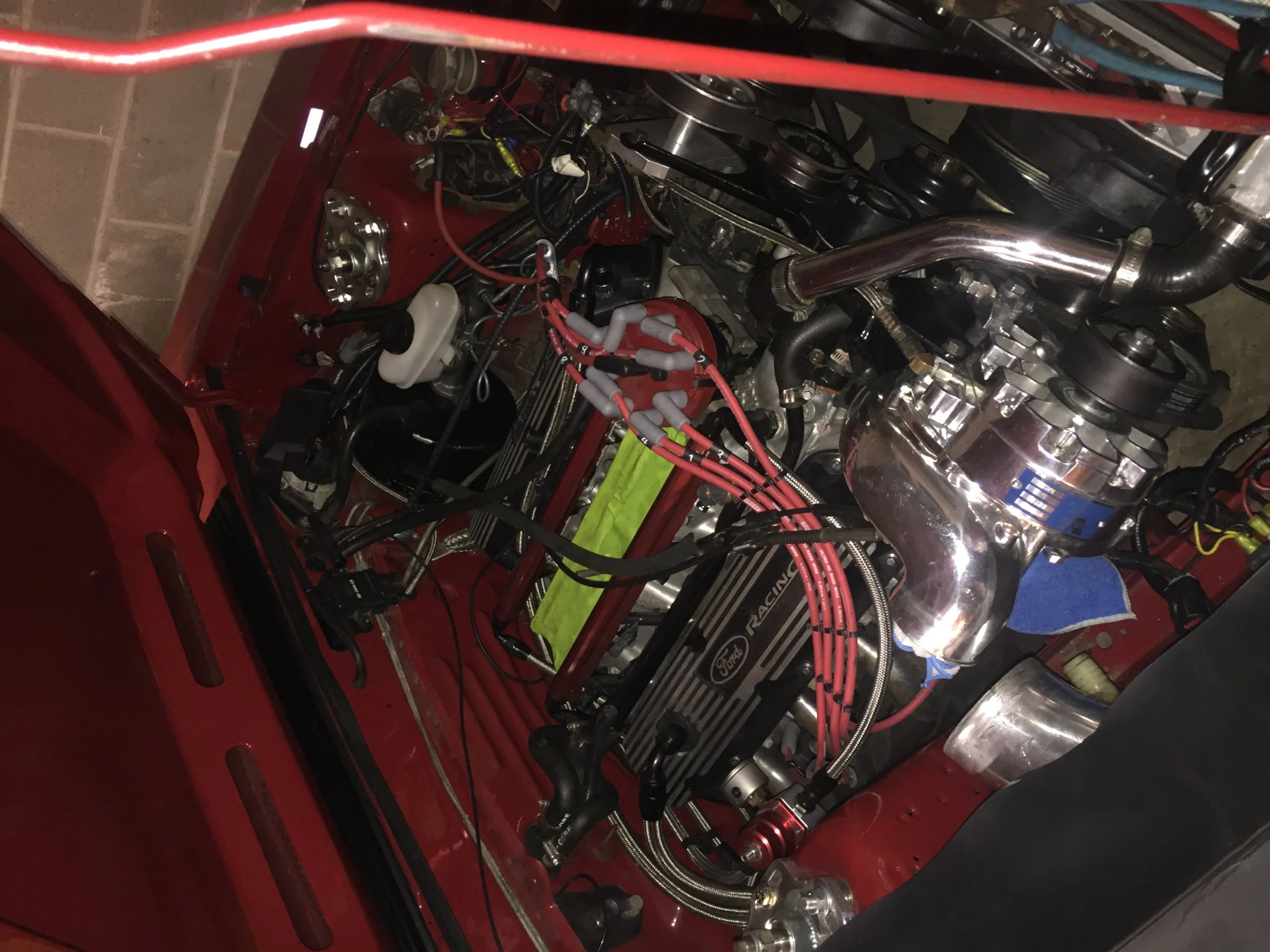

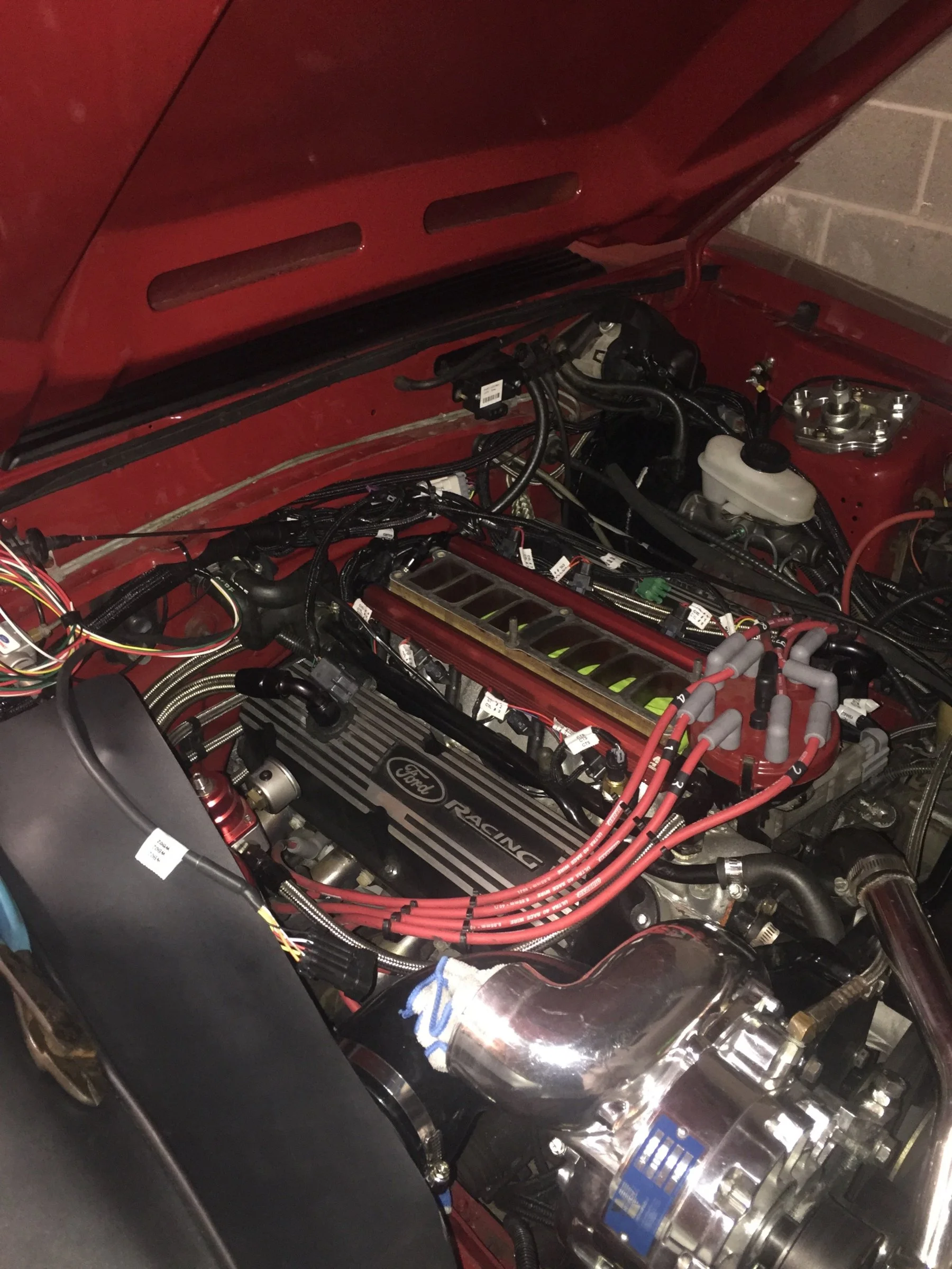

Wiring in the loose wires in the harness. Loomed them and brought them in the car. Wired the fuel pump wire . Key on from the coloumn to the key on for the harness . Ground using the old ecu ground bolt . Power for the injector portion of the harness .
Also mounted the vortech blow off valve on my discharge tube
Getting very close . I think i made decent progress for only working on it the last couple of days
