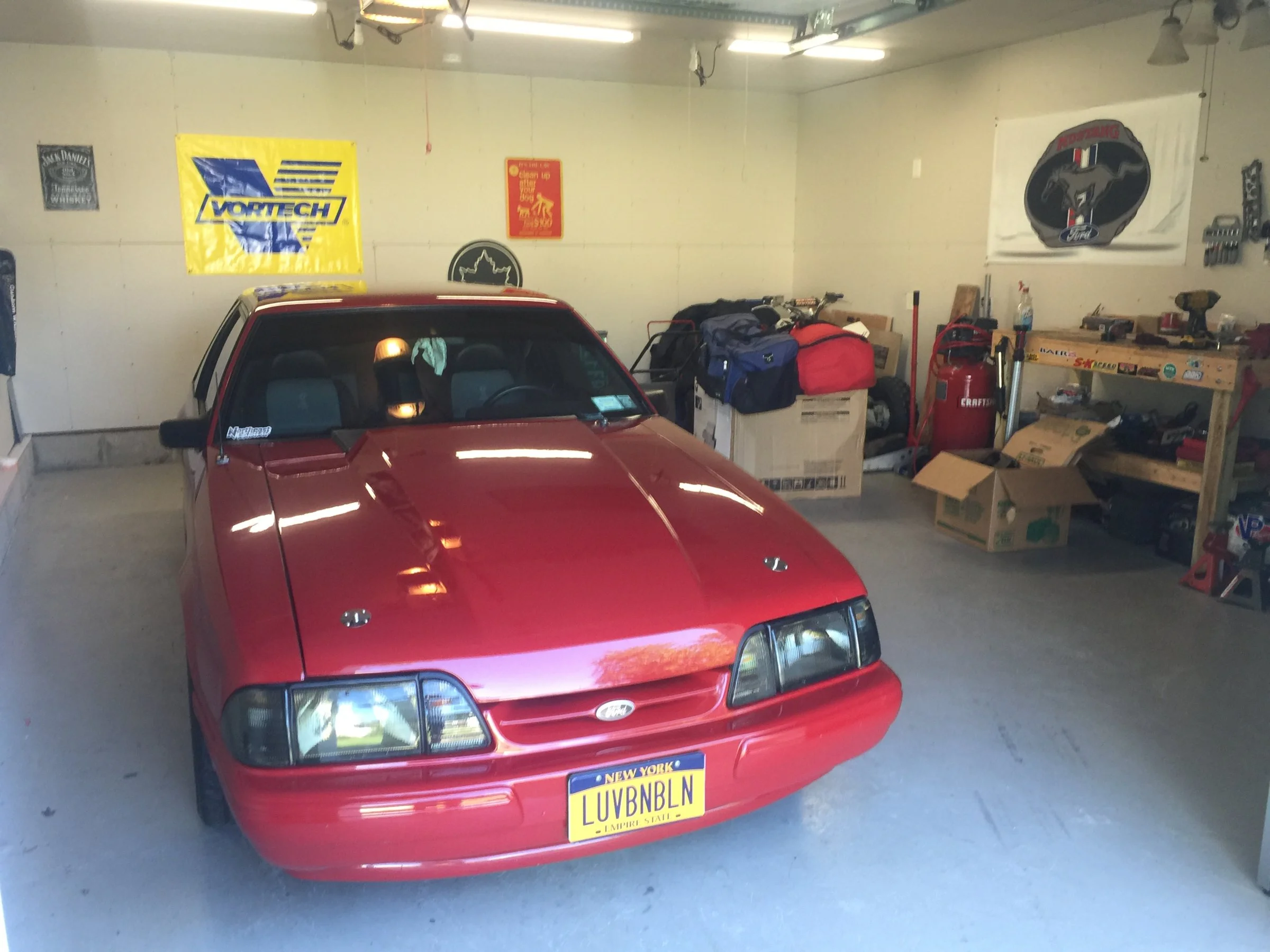

Well what's been going on ? I moved into my new house and new garage . Scored a stage 2 snow meth kit from a friend of mine for 180 bucks .

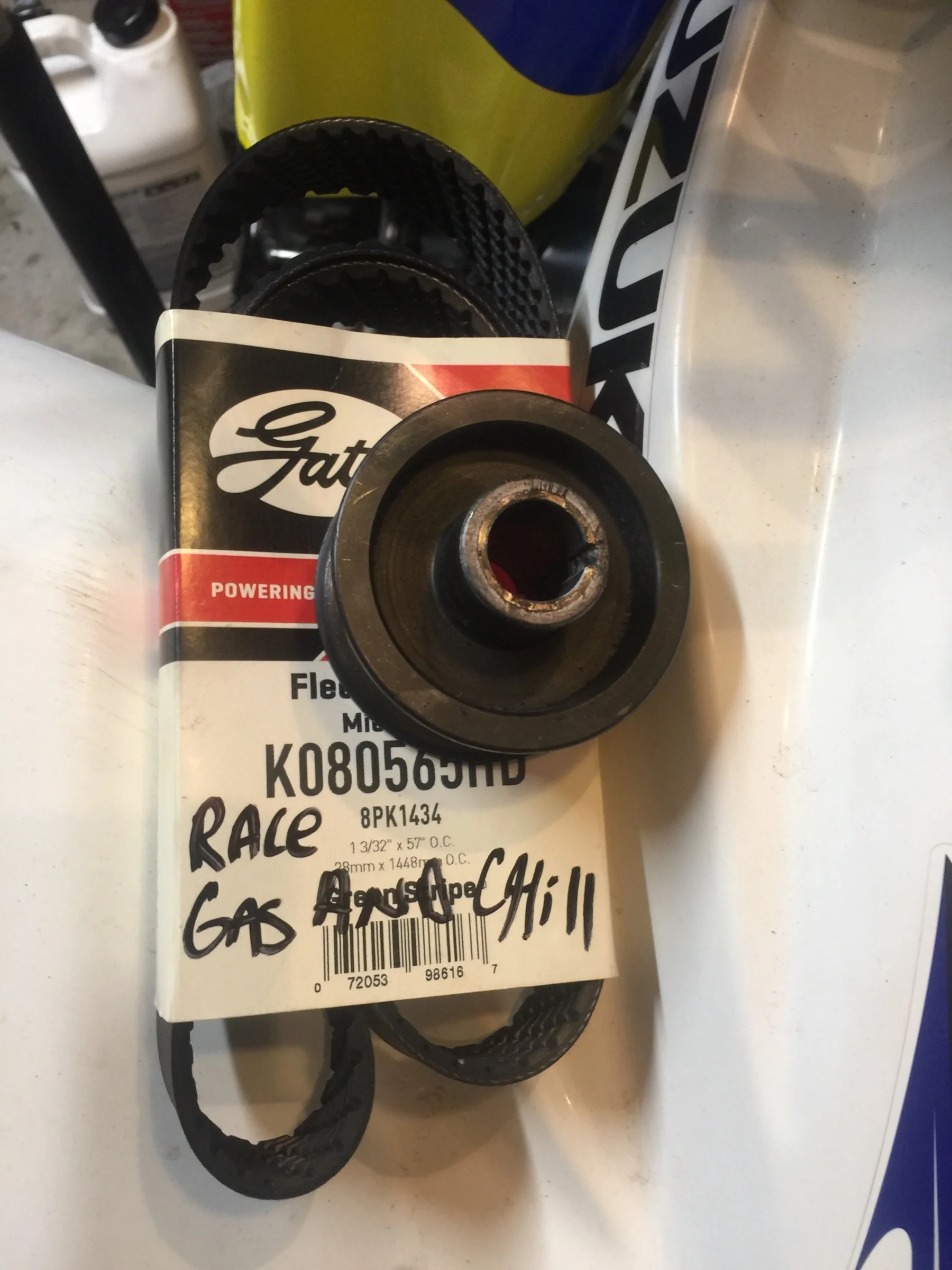

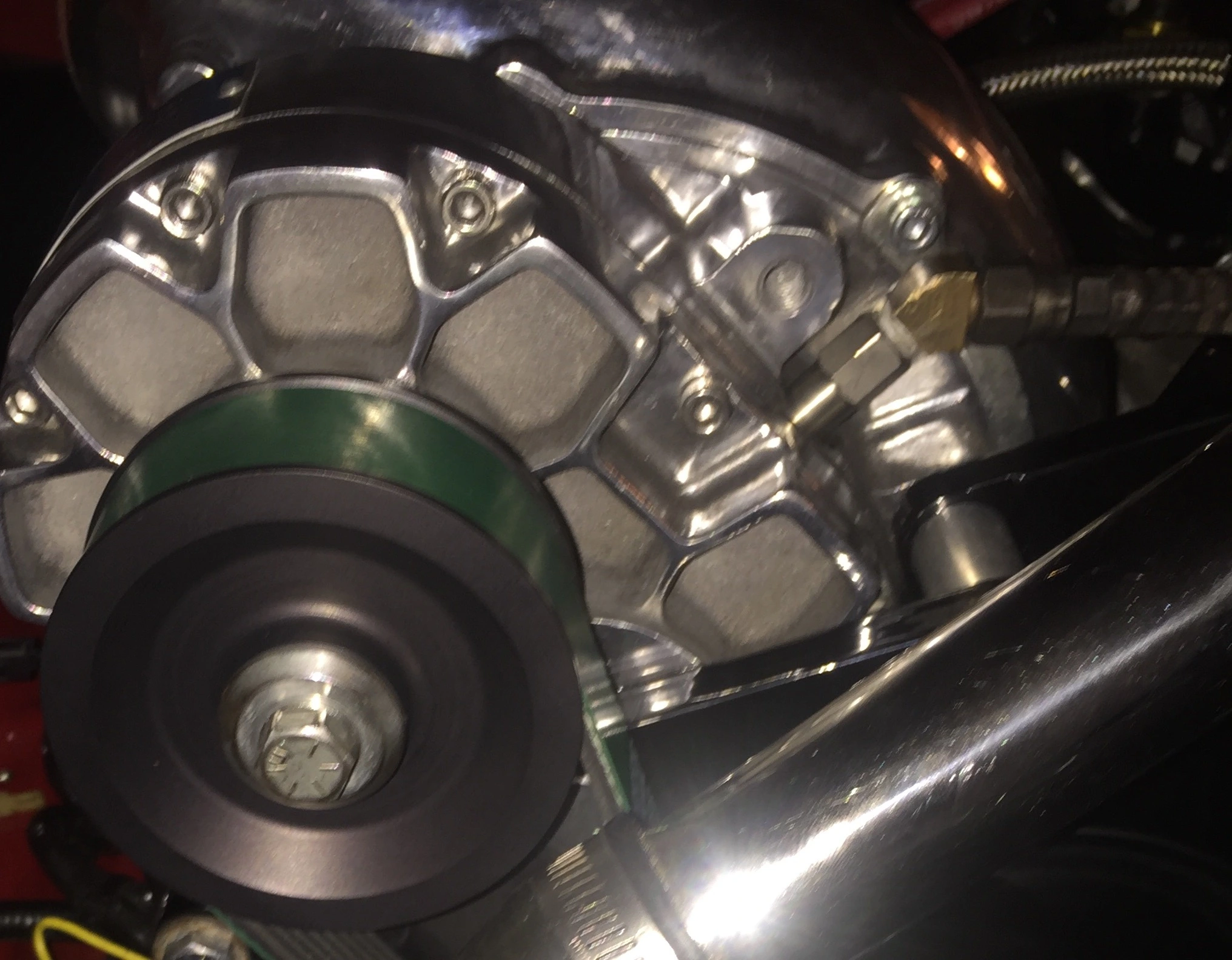

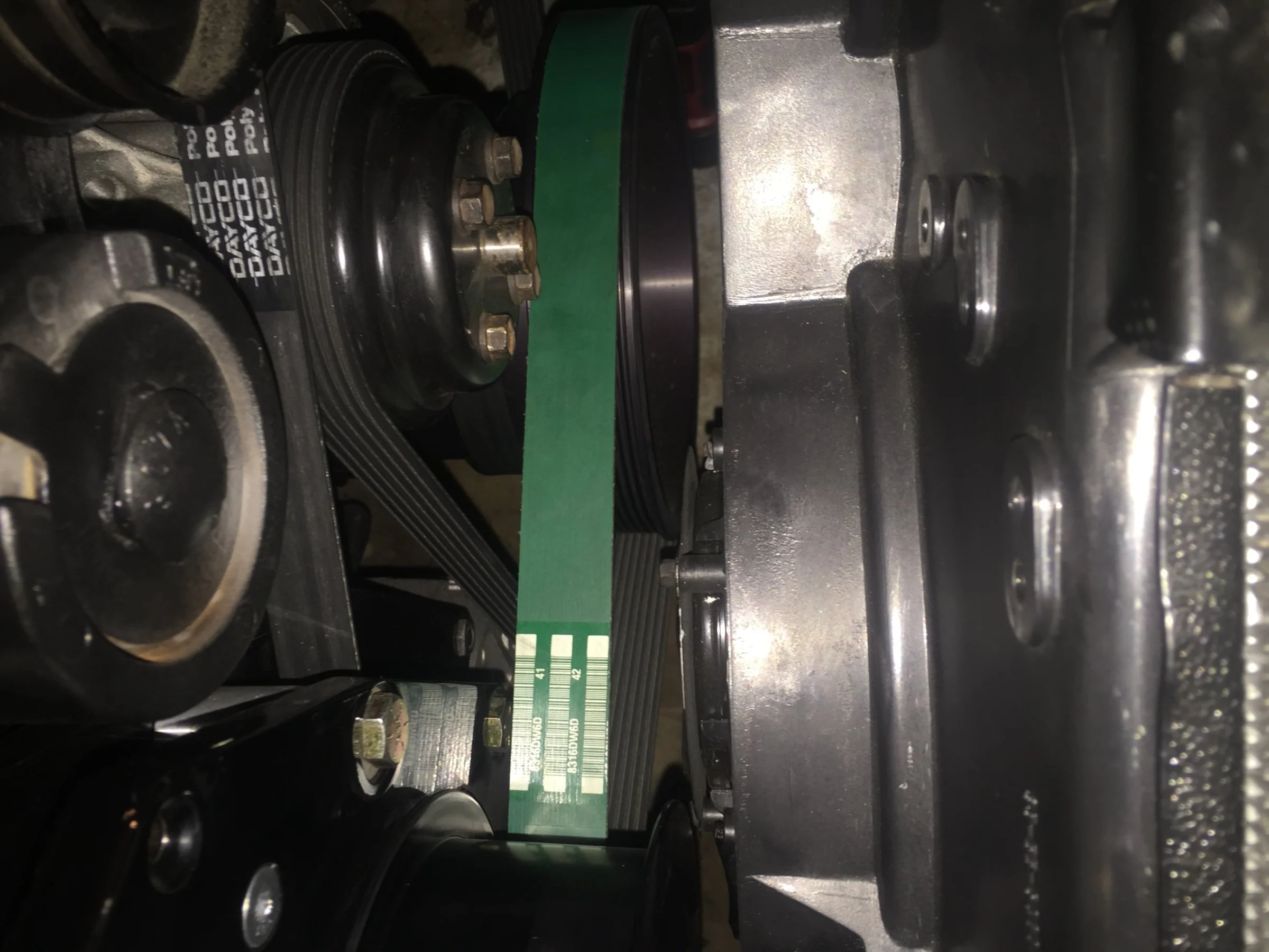

Dealt with some blower alignment issues . Waiting on a 35mm tensioner pulley to replace the 55 to stop letting the belt walk around so much . And that should cure it shredding a rib off hopefully .

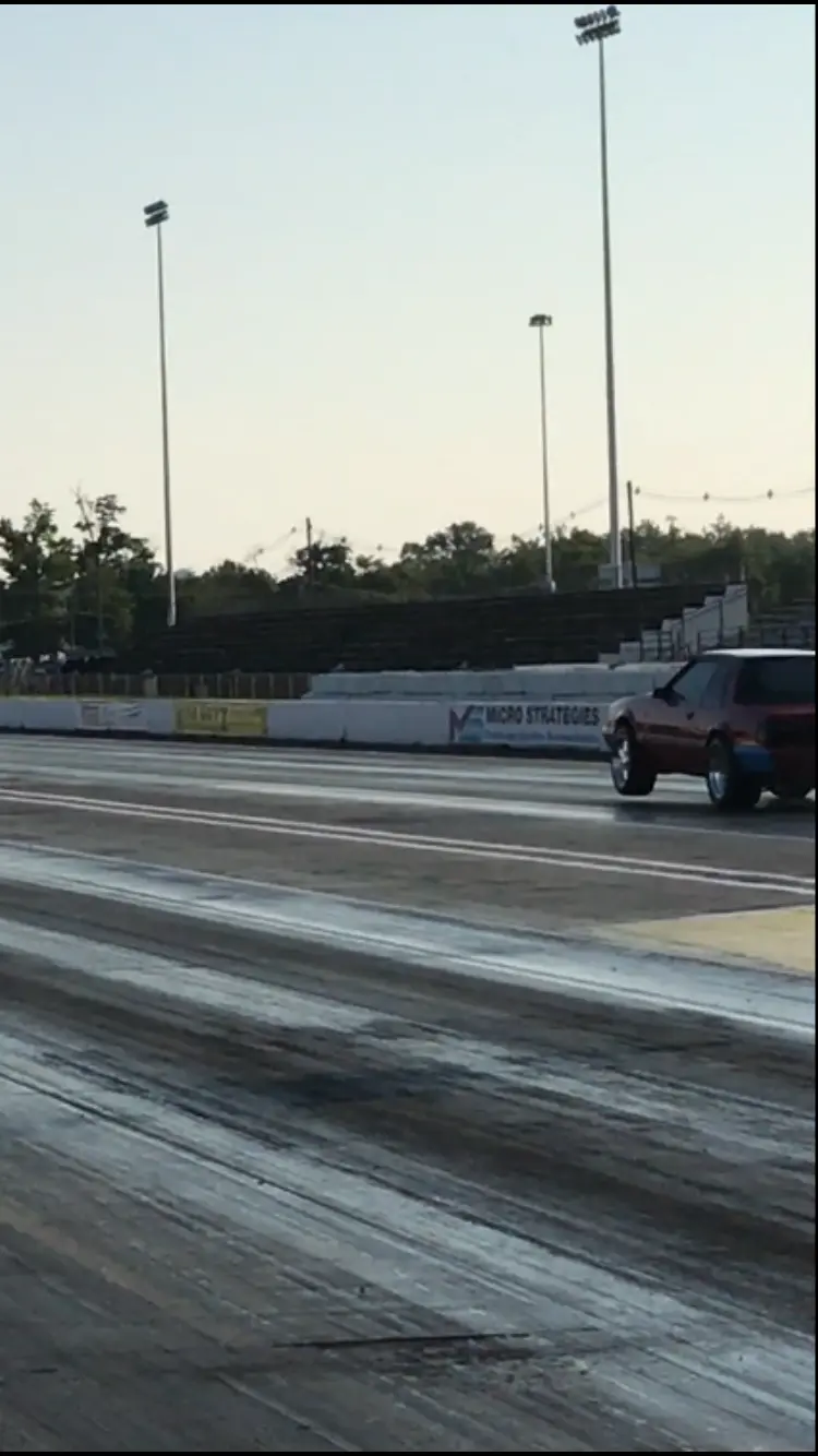

Took the car to the track. The new found power is hard to manage down low with the ysi . I no longer have to kill it out of the hole . Track was sub par so the best 60 I could cut still hazing the tire was like 1.78 . It went 11.1 at 133 lmao. Once sorted out I think it will be fast . Should hopefully trap more like 135-138

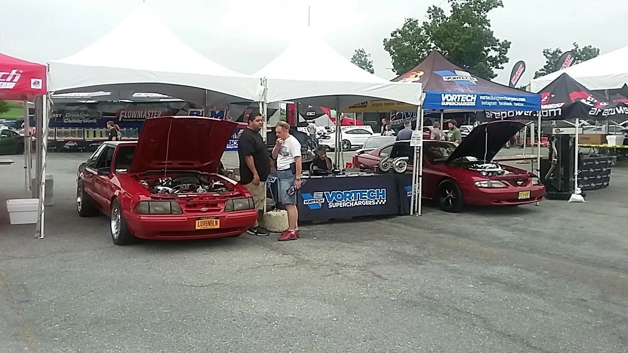

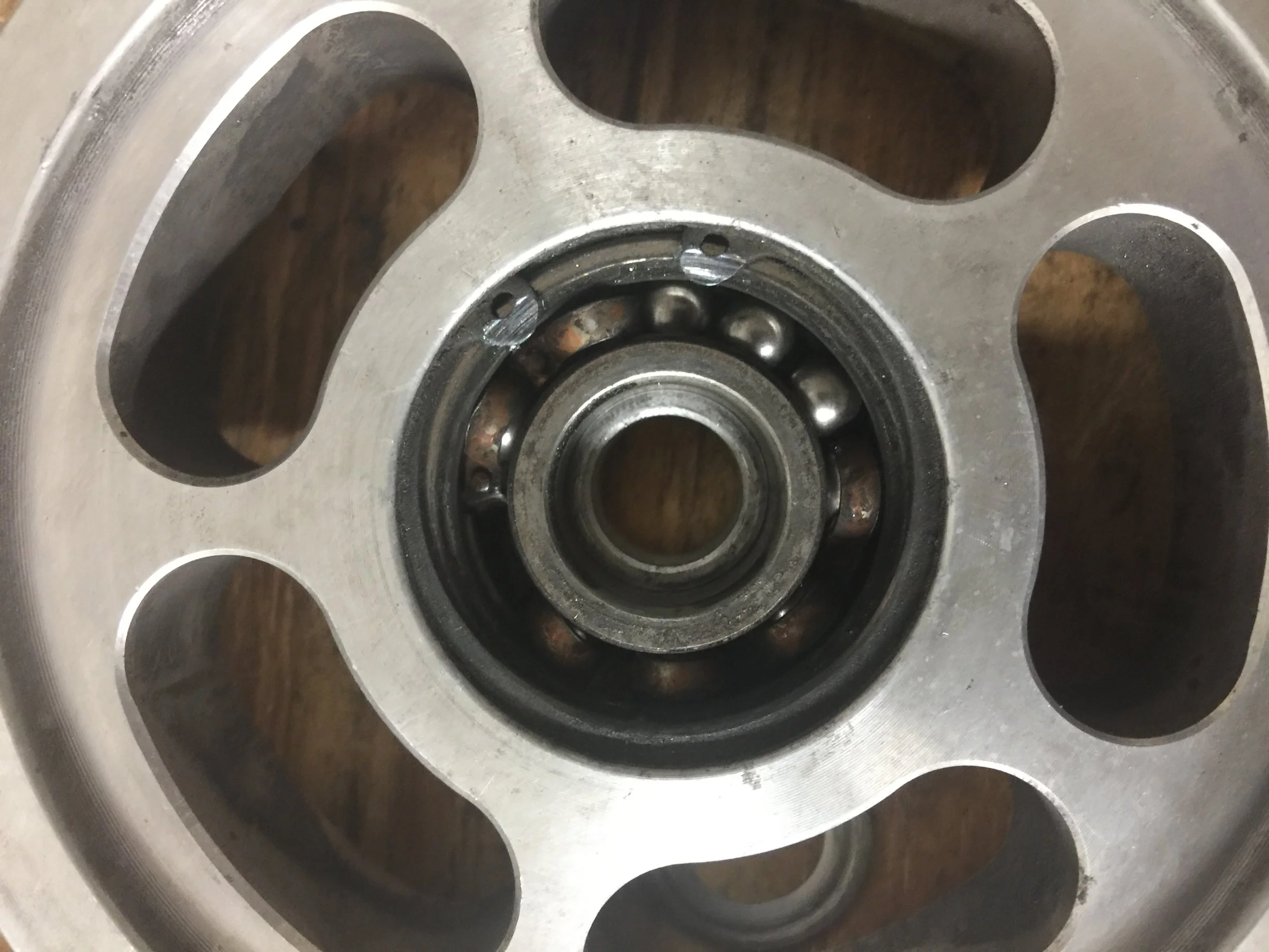

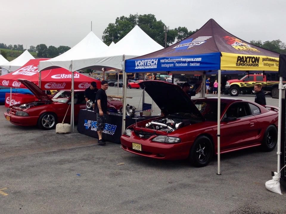

Kris called to use the car for the Vortech booth at American Muscle show . Well that was great until the smog idler pulley decided to come apart before we left to go home when we started the car to let someone hear the blower . Had the car towed home . Ordered a SKF bearing replacement for the pulley . And we wait .

You said 'once sorted out I think it will be fast'
You run a 11.1 and you 'think' it will be fast?
I think when you break into the 11's that qualifies as fast.
I think when you can hang the front tires in the air automatically makes you one of the 'kool kids'
And it be'n red don't hurt neither!

11s aren't fast for 640 turned down at the tire. We made 705 but turned it down on pump . Made 740 On MS109 mix .
It's been 10.86 with the smaller blower at 581hp . It went 1.55 60 foot that day which still isn't spectacular. I will work on it but it's also tough keeping a full street car , semi show quality car and try to do this at the same time . I do appreciate the support and compliments . Hanging a full size front rim in second is definitely cool . @84Ttop and I need to check the pinion angle and instant center and see if we can make some adjustments to get the 60 down where it needs to be .

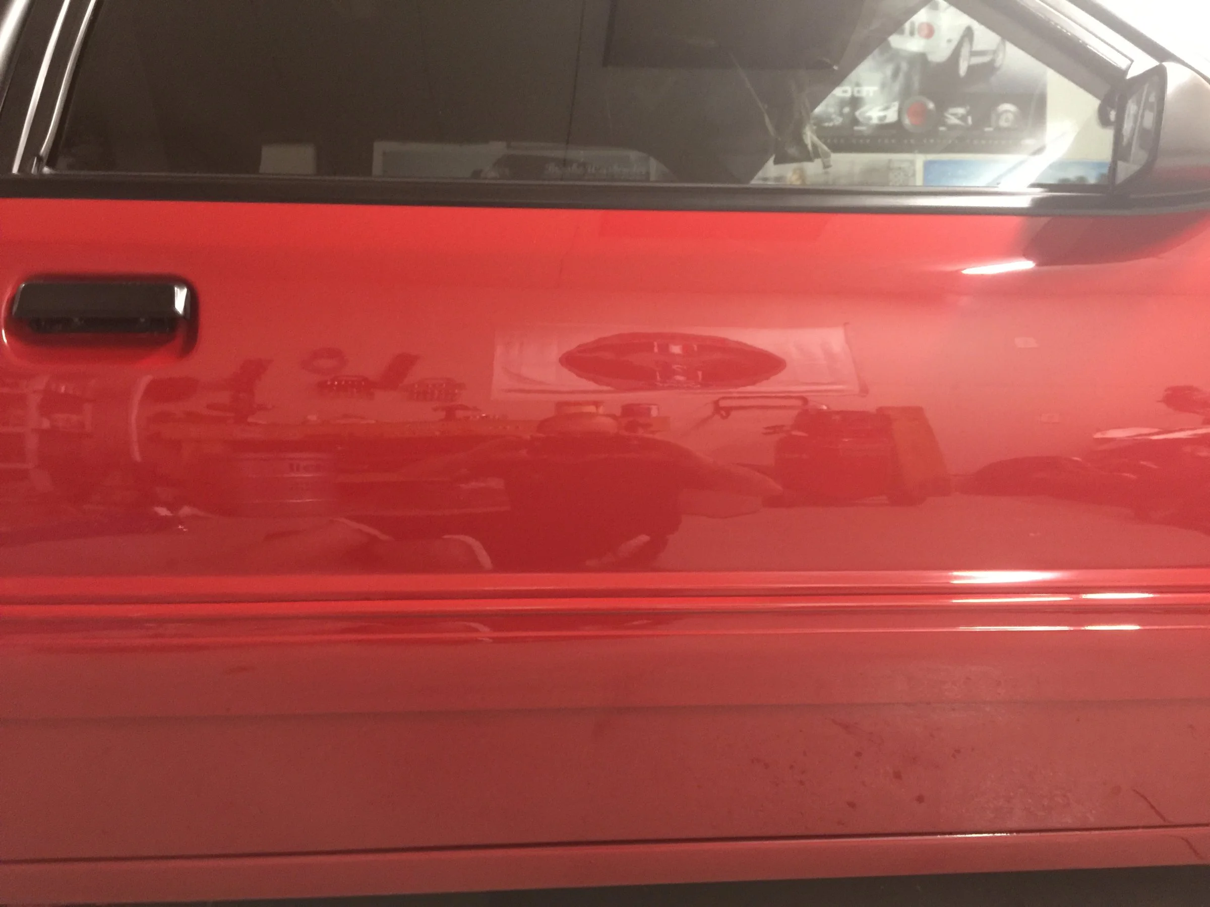

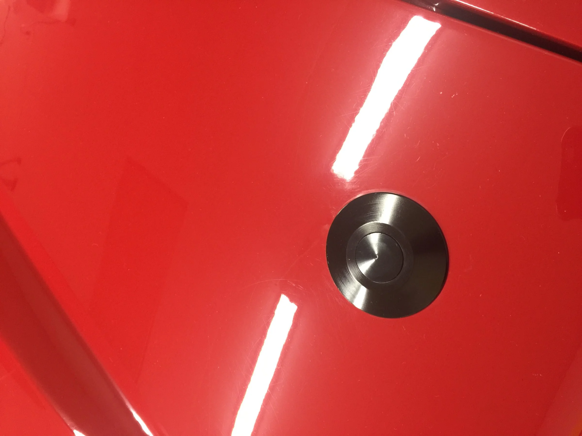

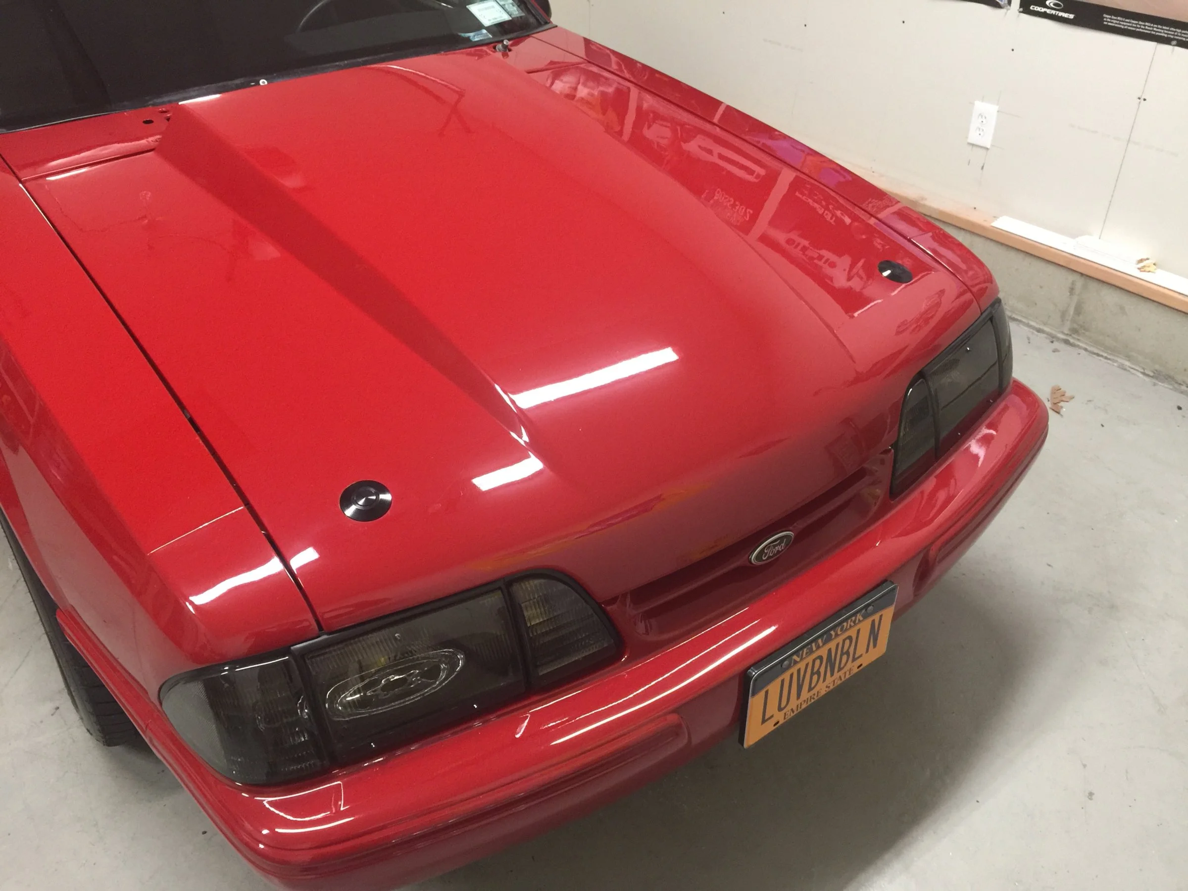

This weekend had my buddy do a light polish since it's been 4 years since we did that . After the car was painted was the only time it had a machine on it . Also added the quick latch QL50 black flush hood pins .
Paint isn't perfect as we didn't do a heavy correction but it cleaned up well .

you see have one of the nicer foxes around. dare I say youd be on the mount Rushmore of stangnets foxes

What does the car weigh? What is the front/rear weight bias? I think there is a lot left in the 60'.
Tons left in the 60 . It's a pig . 3408 with me in it and a little more then a quarter tank. Full interior with a stereo , 03 cobra driver seat is super heavy . Never had it on individual scales to see the bias .
