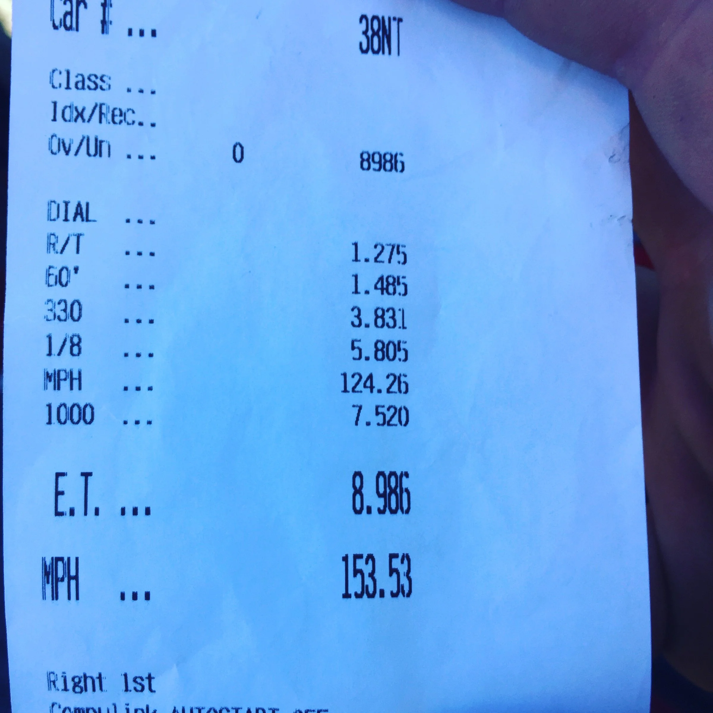

Not my car . I always help my buddy out at the track with his car it's been 8.50s at 152 ish . Today it went 8.62 at 160 .
Well I made a joke telling him I'm dying to make a 8 sec pass already . He threw me his fire suit at the rental and I jumped in the car and made a hit !
I short shifted cuz I wasn't sure if he had the shift light set or not . I left semi soft was trying to get used to the car and incase it did anything out of the norm
357w, solid roller , vic jrs, 76mm turbo , power glide with a Anderson PMS
