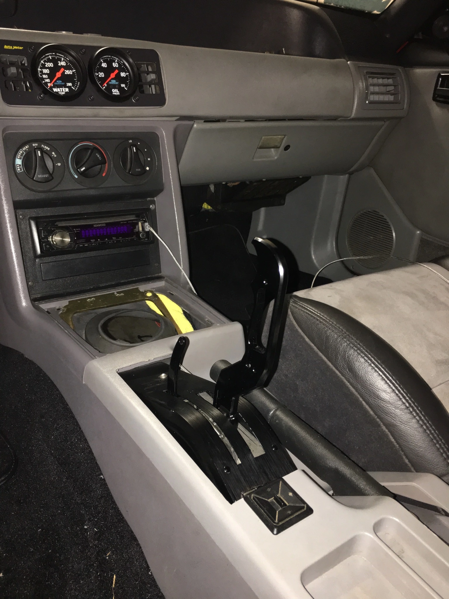

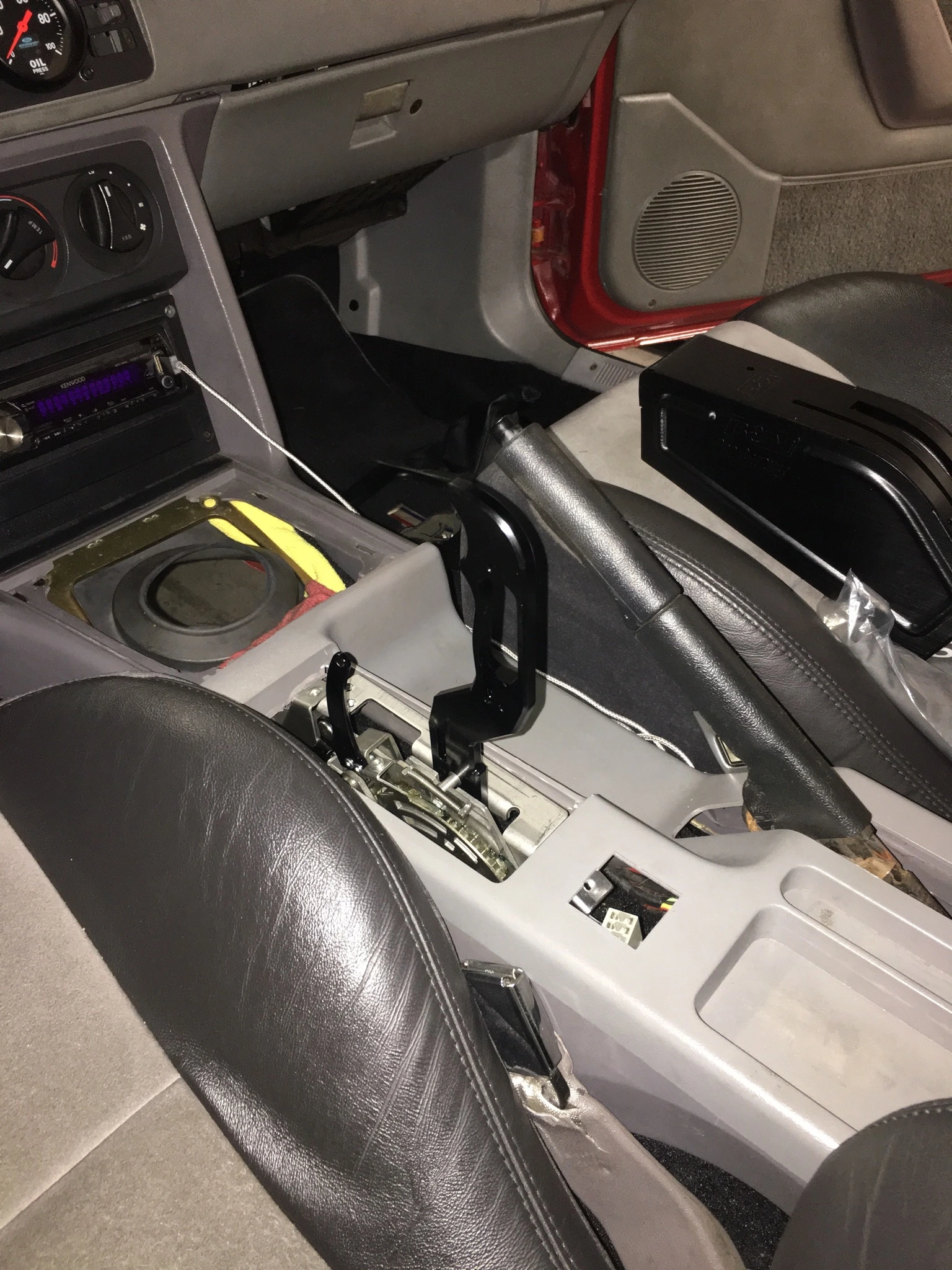

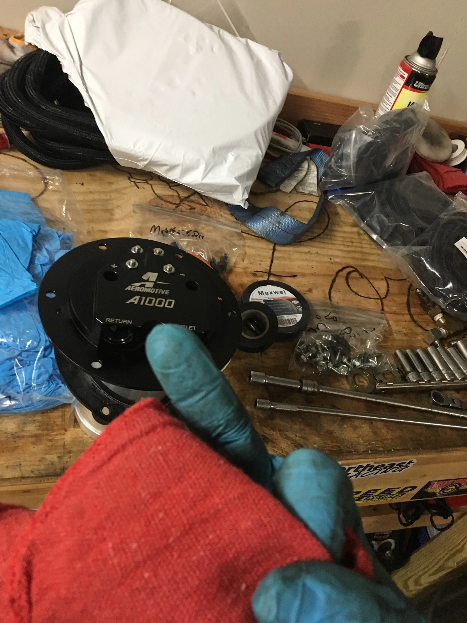

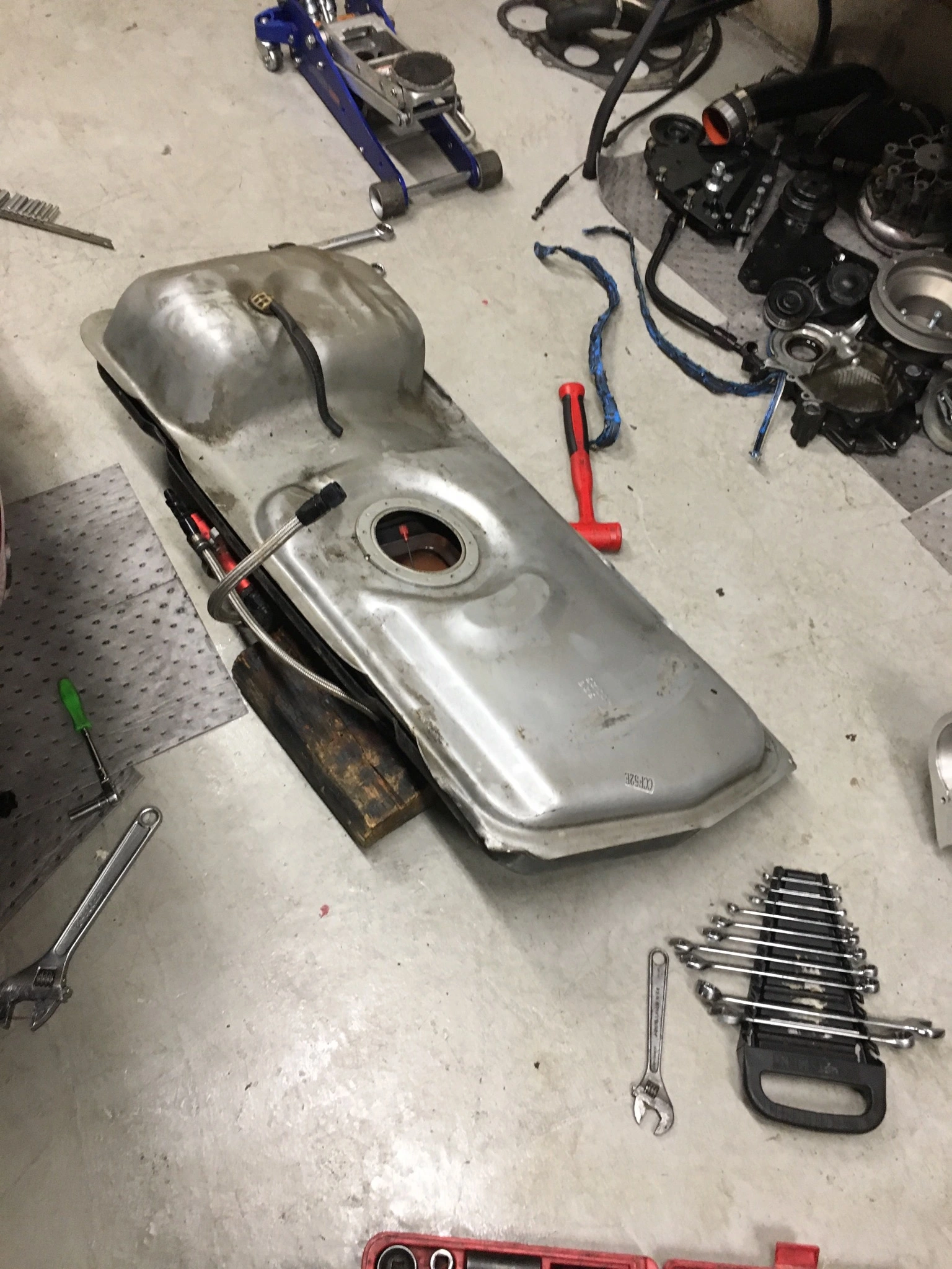

Got the tank dropped tonight. Gonna send pump back to aeromotive again so they can fix it. Also Mocked up battery box in the trunk and trimmed the trunk carpet. Once i get that all finished up next will be to trim console for shifter and then work on Cleaning up the wiring.

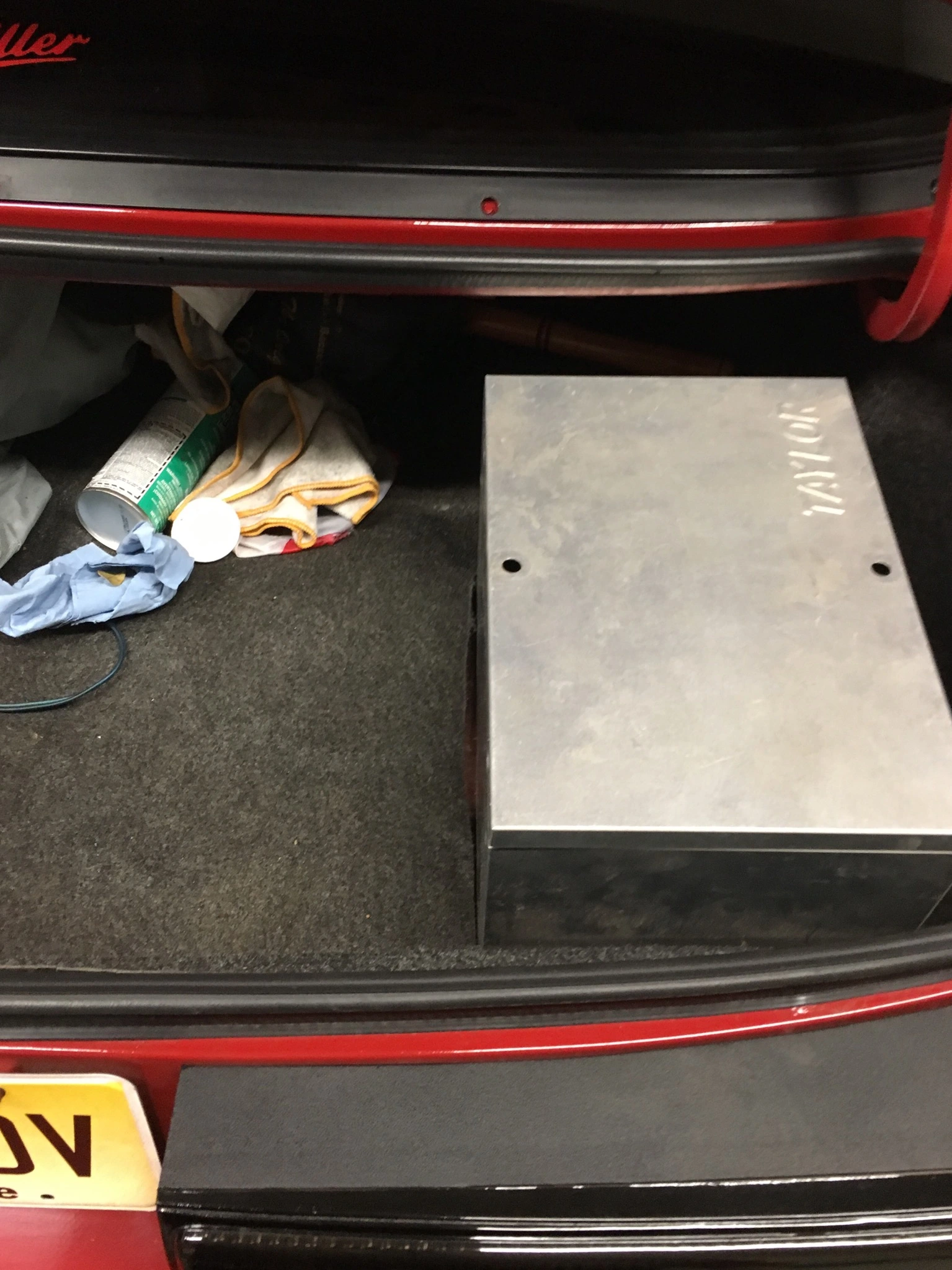

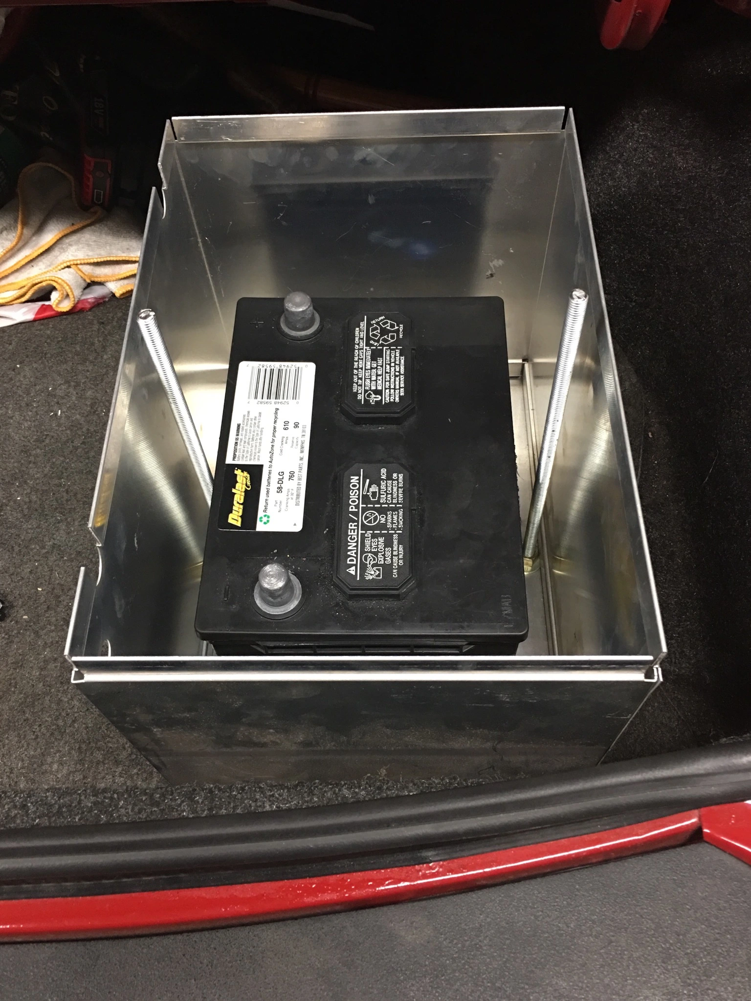

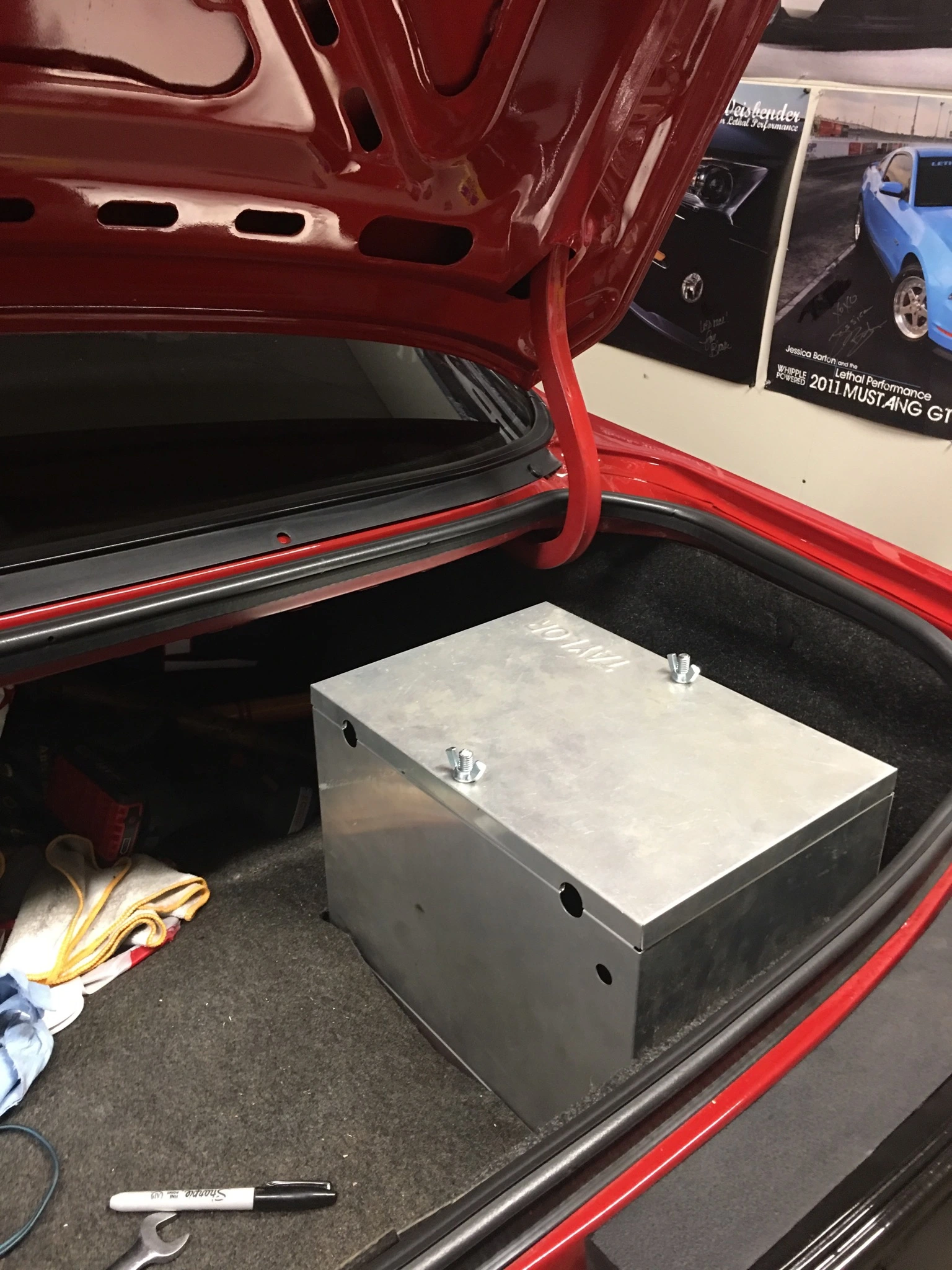

Got some work done . Dropped tank last night to send pump in to Aeromotive . Got battery box mocked up and carpet trimmed . I need to make some hardware for it . My boy @84Ttop hooked me up with that one

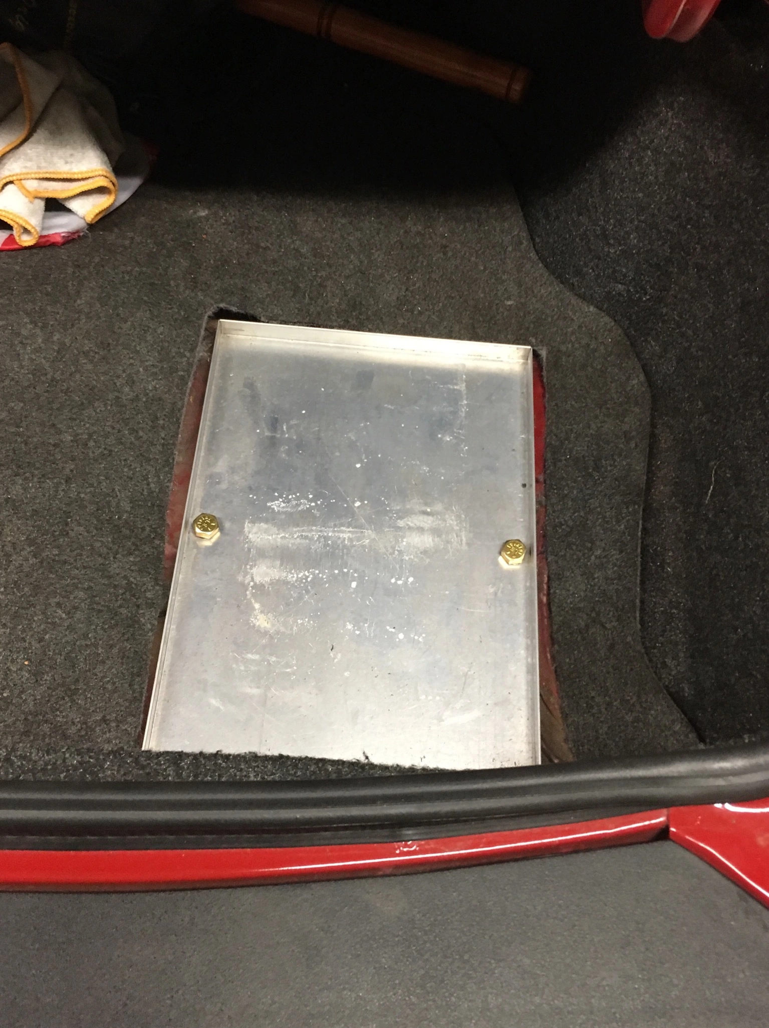

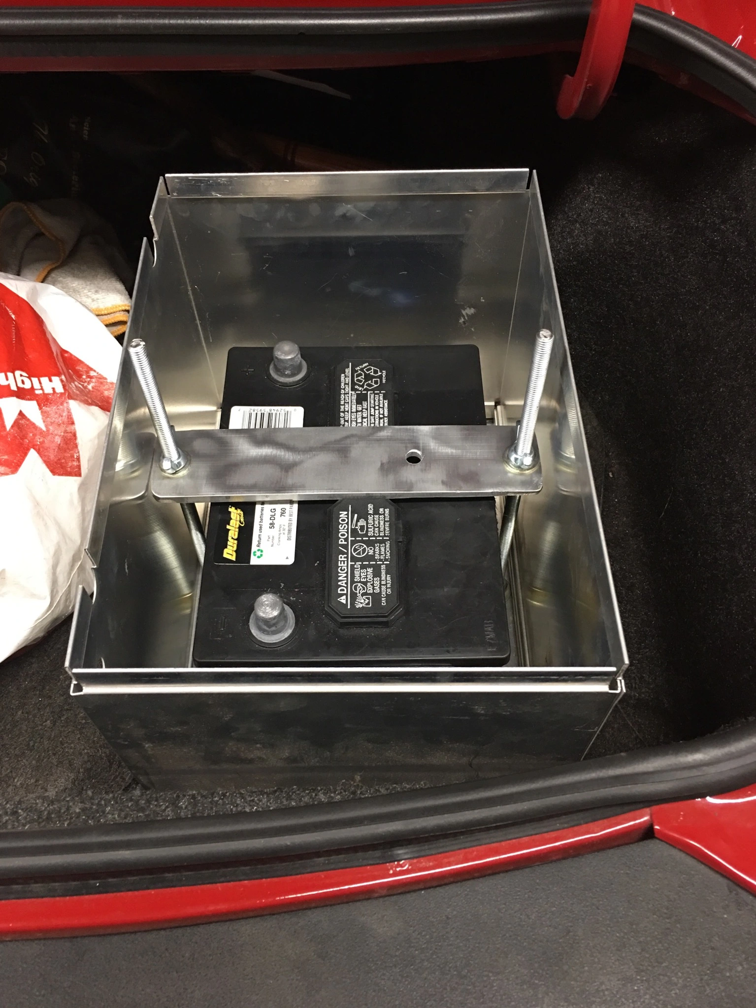

Made some progress . Built a hold down out of some scrap aluminum . Tested it and then pulled the box out of the trunk .
