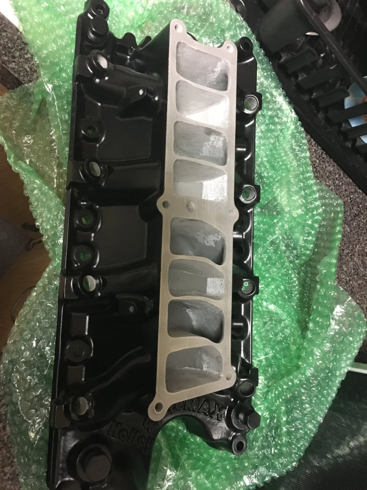

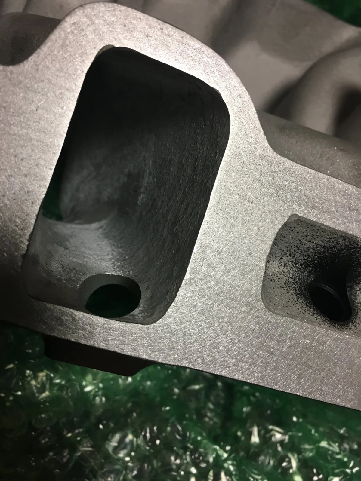

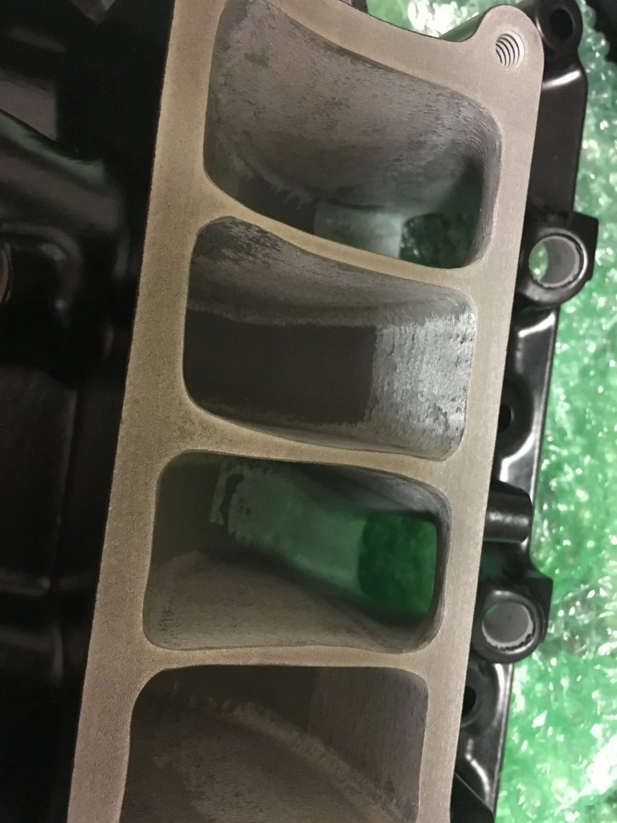

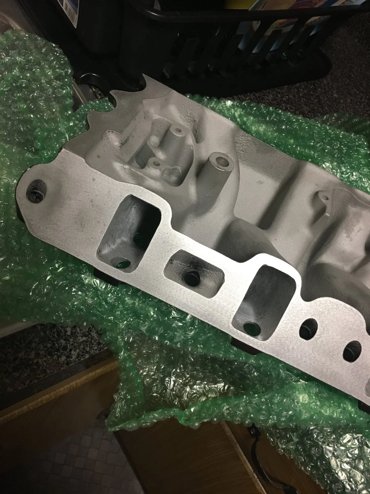

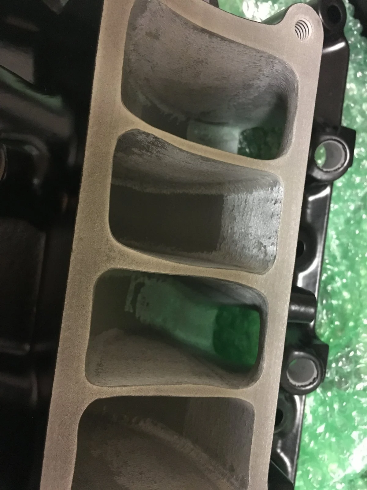

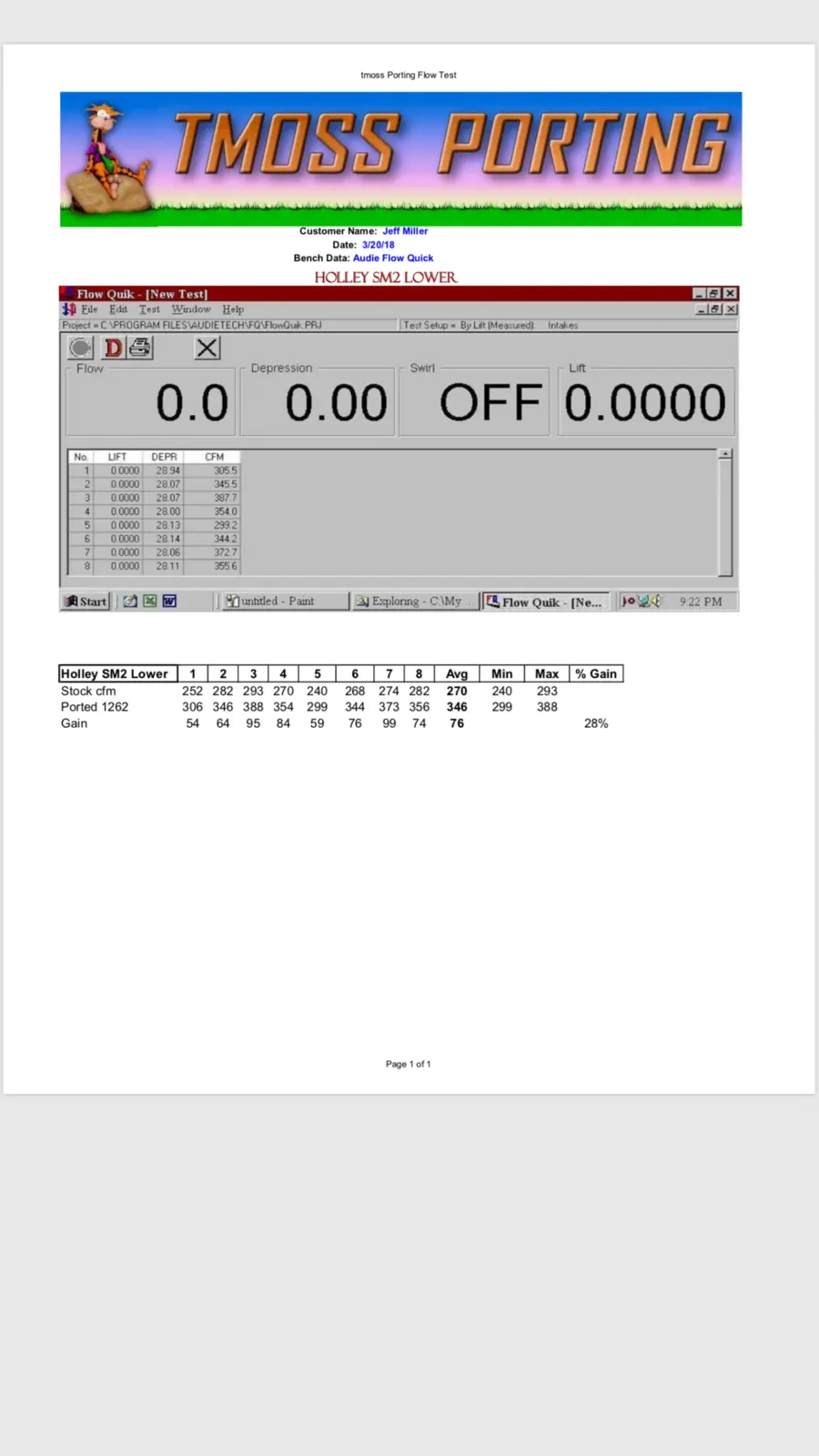

Per Tom . “ Jeff, here is the flow test of your lower - done with a clay radius. The numbers are high due to flowing only the lower with a short very low restriction flow path. The gains can be seen but once you put the upper on, the numbers will be closer together and average ~mid-280 cfm. Don't put too much emphasis on flow numbers either - get it on the car and see how it does. Not sure if I sent feedback from our ported Holley intakes so here is some in case I did not. Thank you!!”
I am very pleased with his service and turn around time . On the money for sure
Curious what that cost. I was wondering if there would be gains there for my n/a 331 by porting my Holley.
Joe
200 for port to 1262
40 for return shipping .
Extra 20 for the flow test
I went with Tom just because i know his reputation speaks for itself . He’s been a household name with Doing intakes for along time
