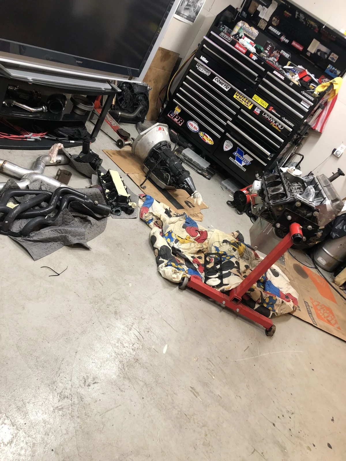

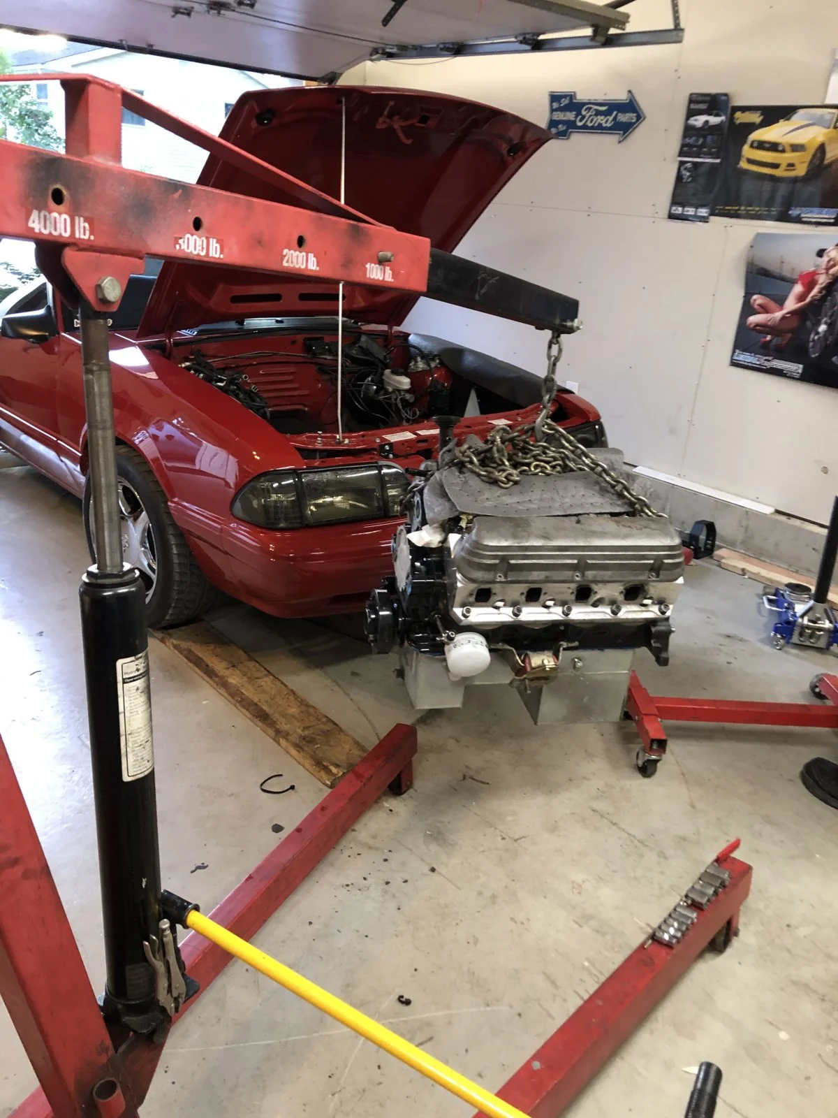

Long story short . Motor is almost out .

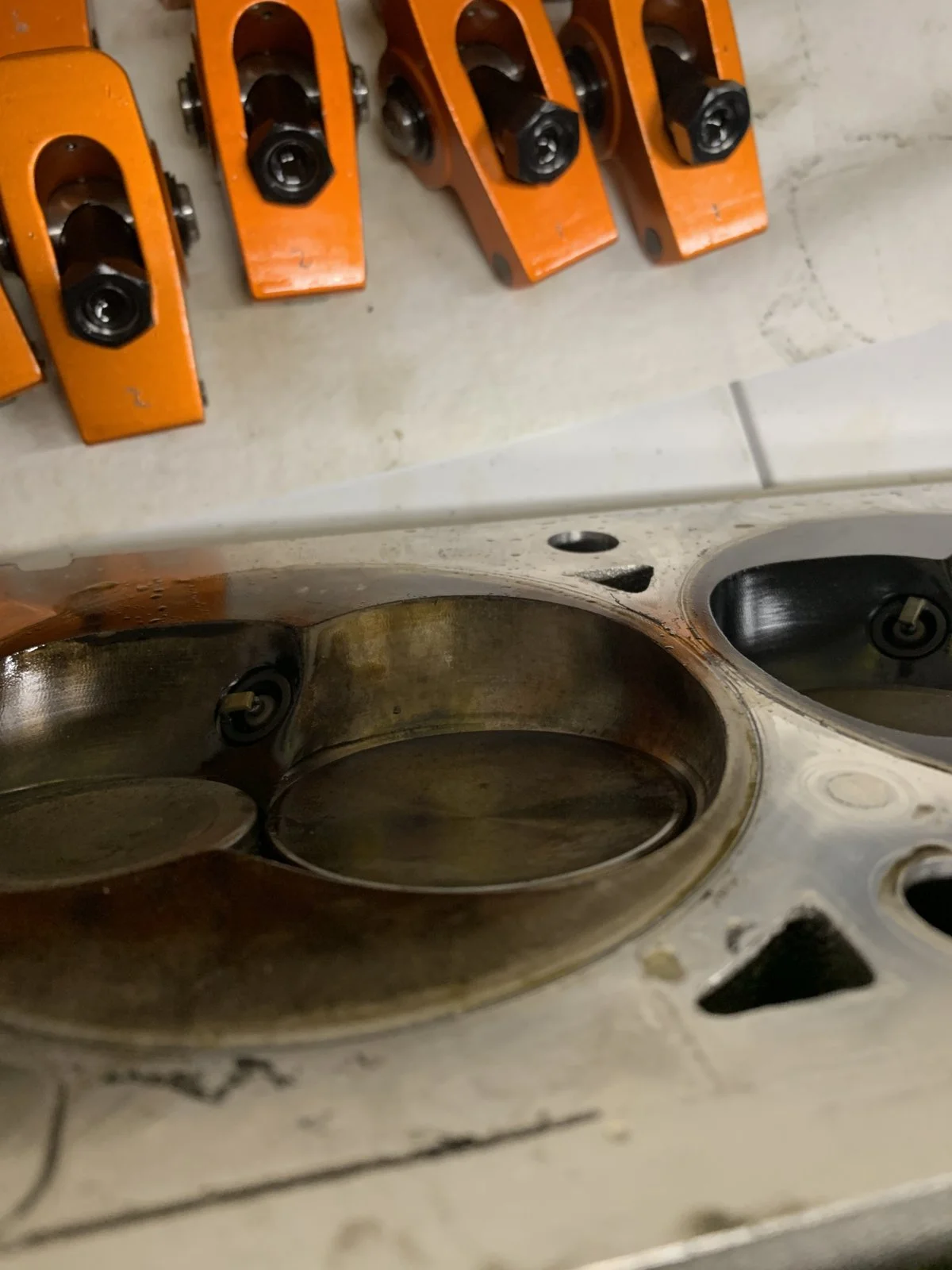

Engine builder said it sounds like the seats are sinking the valve and that’s where the lash gets tight . On top of that whether related or not trying to figured this out something happened in cyl 7 . Air in the cyl and it pressureizes crank case and I can feel the air coming out of my passenger side valve cover fitting . So it’s hurt . Is what it is . Yes I’m pissed . No I don’t think it’s freezy fault I have full confidence in esp being he tunes these combos every week . Stuff just happens and I’m the luck of the draw . When I’ll be back idk . Atleast it will be out and apart . I’ve been through a lot the last 2 months so I’m burned out at everyend .
Thanks for following along guys . I don’t think much will be going on for a bit.

Oh it’s definitely hurt . Shop air in cyl 7 with the rockers off and out the other side of the valve cover Assures me of that .

So Freezy spoke to tea today . Said it sounds like the valves were trying to pull through too and tuliping . So they get to talking and he asks how being these heads have good valves . Well at some point they moved away from using the ferrea severe duty valves . Freezy told them would’ve been nice to know being what we were doing with this thing .

No . There is definitely something going on In cyl 7 in my opinion . If it was just valves tuliped all the wire from the leak down shouldn’t be leaking I to the crank case and back out the pass side valve cover. Sure it would leak out the intake or exhaust but not the crank case
Brian spoke to TEA again . Basically the guy he deals with wants the heads . He said the situation and what’s going on he wants to take them apart , blue print them do a valve job and if they are tuliped the way they are they will 95 percent fix them Under warranty.
He said since the 11r head inception they have always used the same
Valves . He may have been referring to the older style heads like I originally had when we first spoke .
