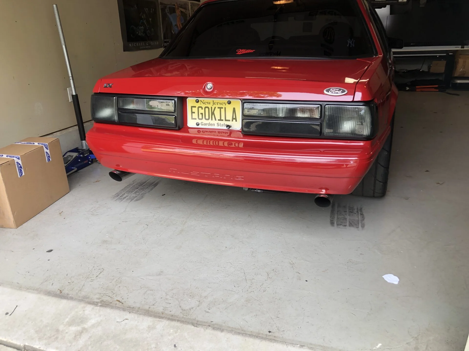

Tail lights match the headlights now .
Thank you !!Dang thats a nice looking notch back.

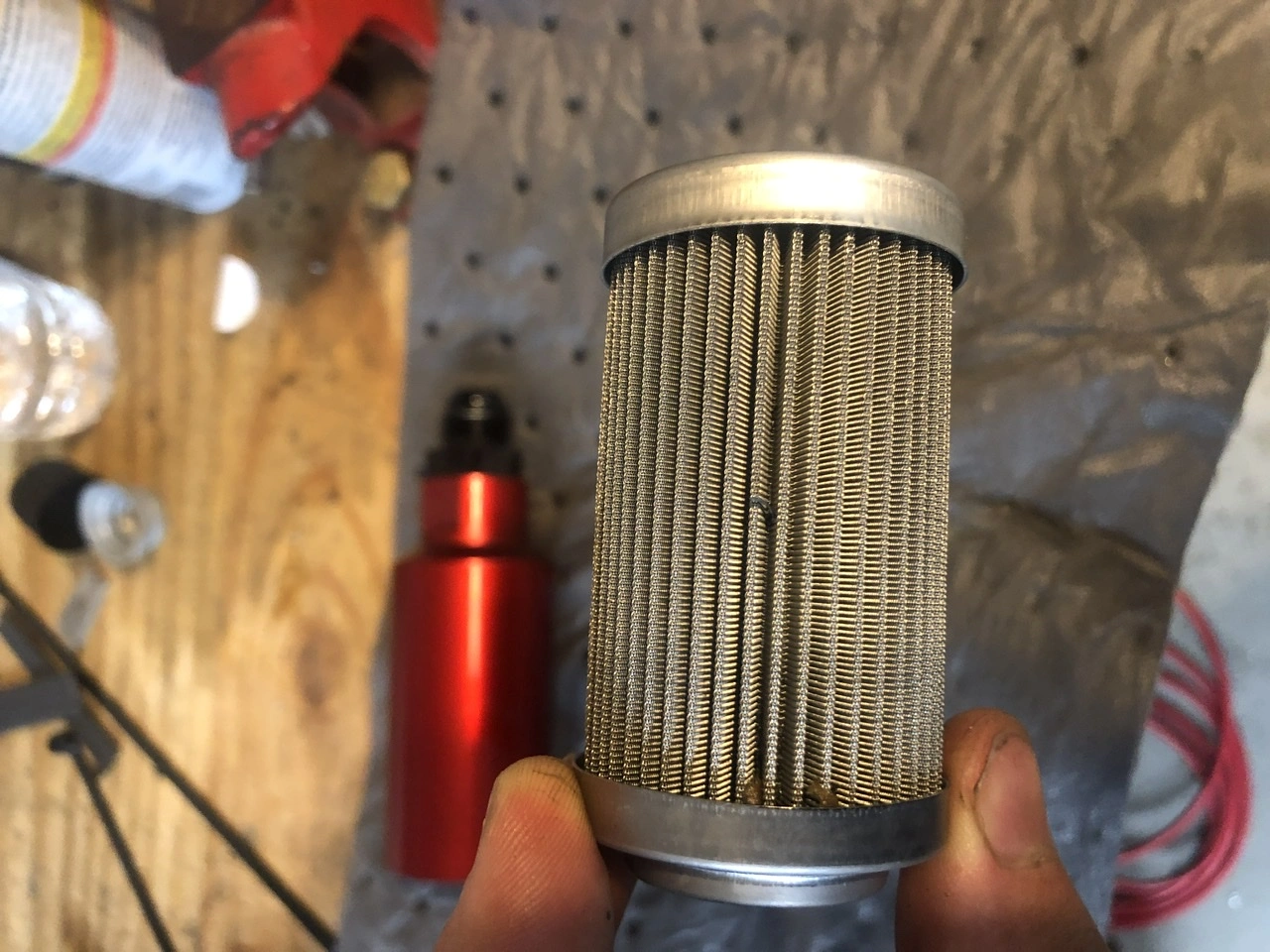

All done . Also changed the pre and post fuel filters . The pre had quite a bit of big trash in it . Due to the fact that the tank was sitting around and even though I hosed it out you can’t get everything I’m assuming this is what was stuck in the baffles .Ordered a tial 50mm blow off valve and 2 bolt flange to v band adapter in prep for the intercooler setup but knowing I can use it now on my Vortech pipe .

is that the plugged up one that you cant blow through? You shoulda posted a pic of you testing it.![]()
I didn’t think anyone would care to see , but here it is .
LOL .is that the plugged up one that you cant blow through? You shoulda posted a pic of you testing it.
and now that I see it.....Yours is much bigger than mine.
I just did this myself, my 10 micron was filthy, and took alot more effort to blow through than I was comfortable with. I ended up ordering a Summit labeled 40 micron unit to replace the entire filter housing, because they wouldn't have the 10 micron replacement element till at least 8/4.All done . Also changed the pre and post fuel filters . The pre had quite a bit of big trash in it . Due to the fact that the tank was sitting around and even though I hosed it out you can’t get everything I’m assuming this is what was stuck in the baffles .
Went to a 40 micron Pre filter after talking to Weldon and some others To try and make the pump not have to draw through such a fine filter . Also the post 10 micron was bad . I tried to blow through it and it took some considerable effort compared to a new one I had on hand . That could’ve been an issue as well . Fired the car quick . Sounds crisp with the tune up .
EDIT !!! I had a brain fart . I went to 40 micron post filter and kept the 100 pre filter .
