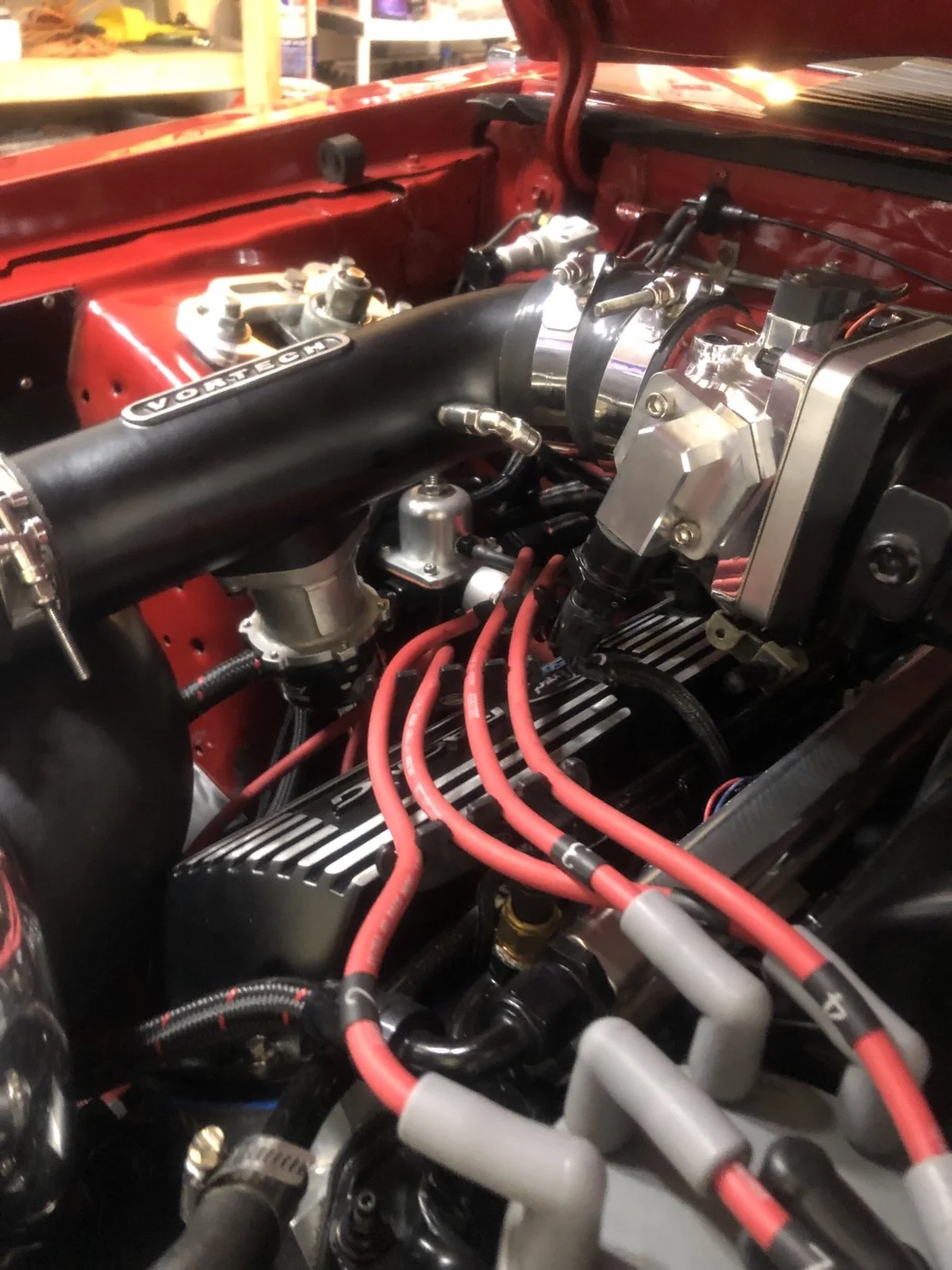

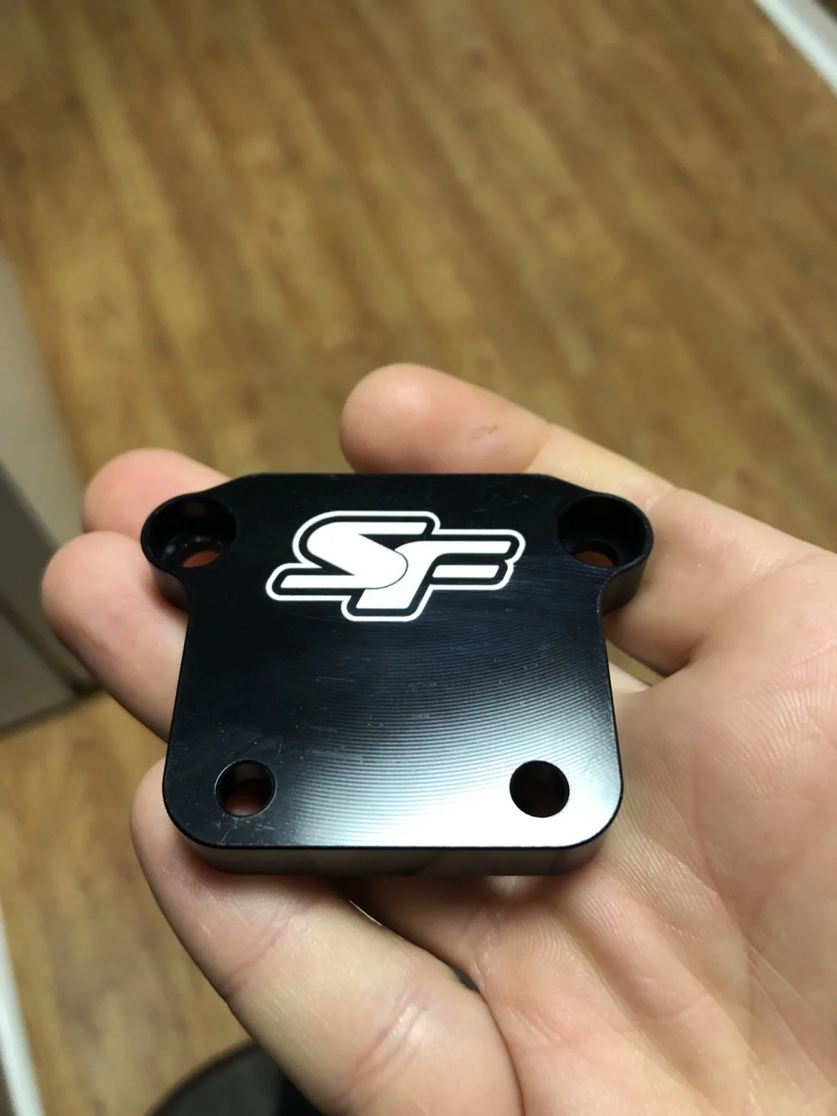

http://www.behindbarsracecars.com/GM-to-Ford-IAC-adaptor-p/bbrciac.htmHow'd I miss the IAC valve ? That thing is purdy. I searched and can't find one like it. I want one.
No problem ! All of his stuff is top notch . I have the rails and the tank now too .That is awesome. I'm ordering one. Thanks man !!!
SOB, where were you when i ordered my accufab one :banghead:http://www.behindbarsracecars.com/GM-to-Ford-IAC-adaptor-p/bbrciac.htm
Ask and you shall receive . And it’s half the price of the fast one . takes a gm screw in iac

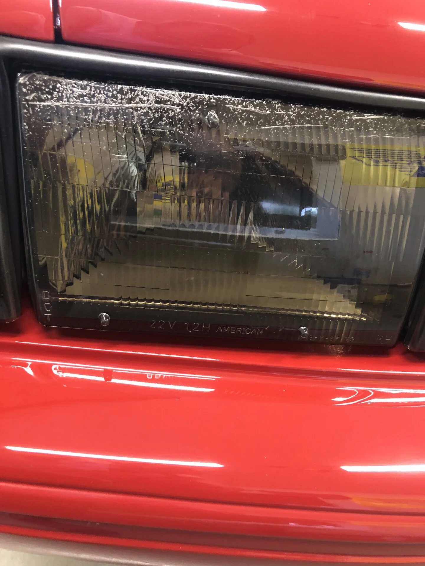

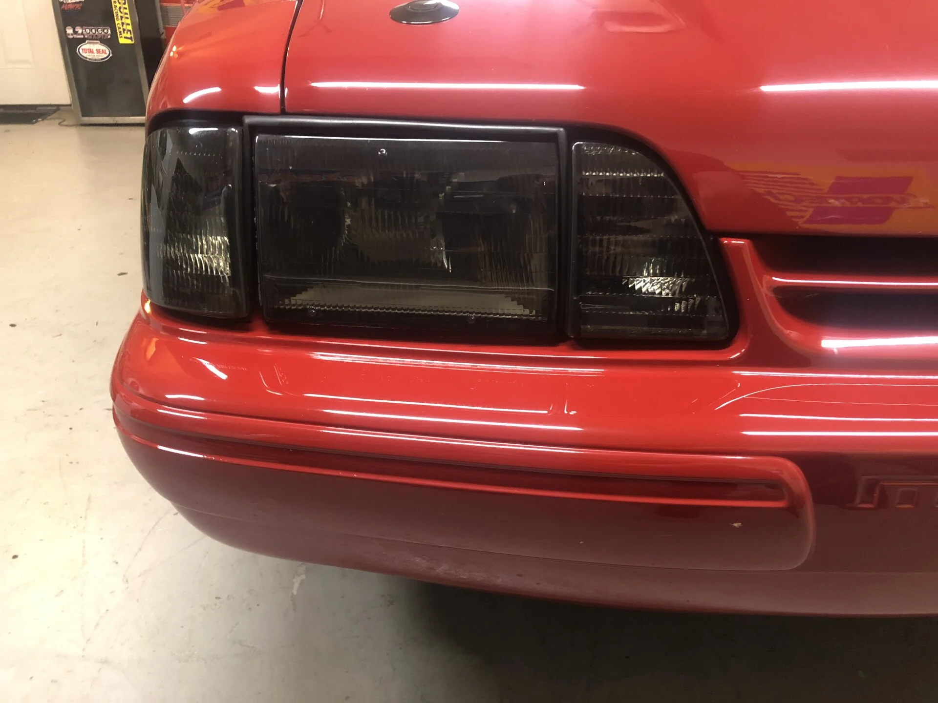

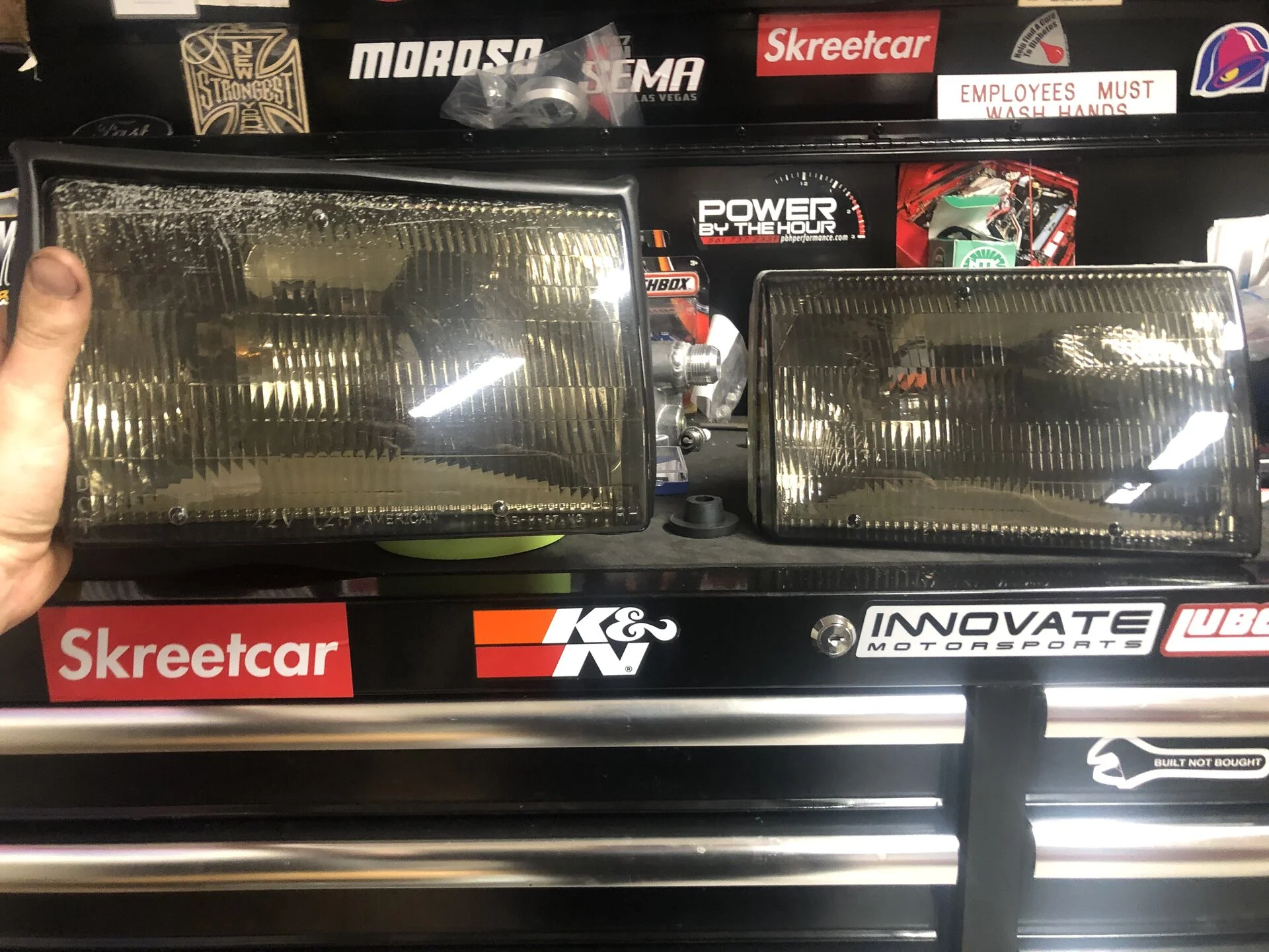

Do you prefer gas or electric?This weeks project . My right headlight is delaminating . I have a full spare set from the originals I had installed . Way back I had an accident and the side marker got broken which prompted me to buy a new set when they still made them . Fast forward I found another right side set alone and bought it to have a complete set of headlights again . Set number 2 started to have moisture in the light . So it ate the chrome inside .

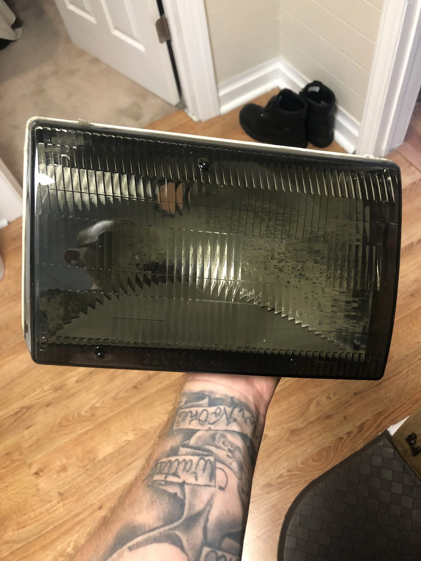

So i swapped it for another that had a slight lamination issue. Over the last 2-3 years it’s gotten worse . So I decided to take my original lenses in the box . Use the back housing from set one and the mint lense from set 2 to make a perfect pass headlight again . All without having to remove right side number 3 I found on eBay by itself with the corner marker years ago.

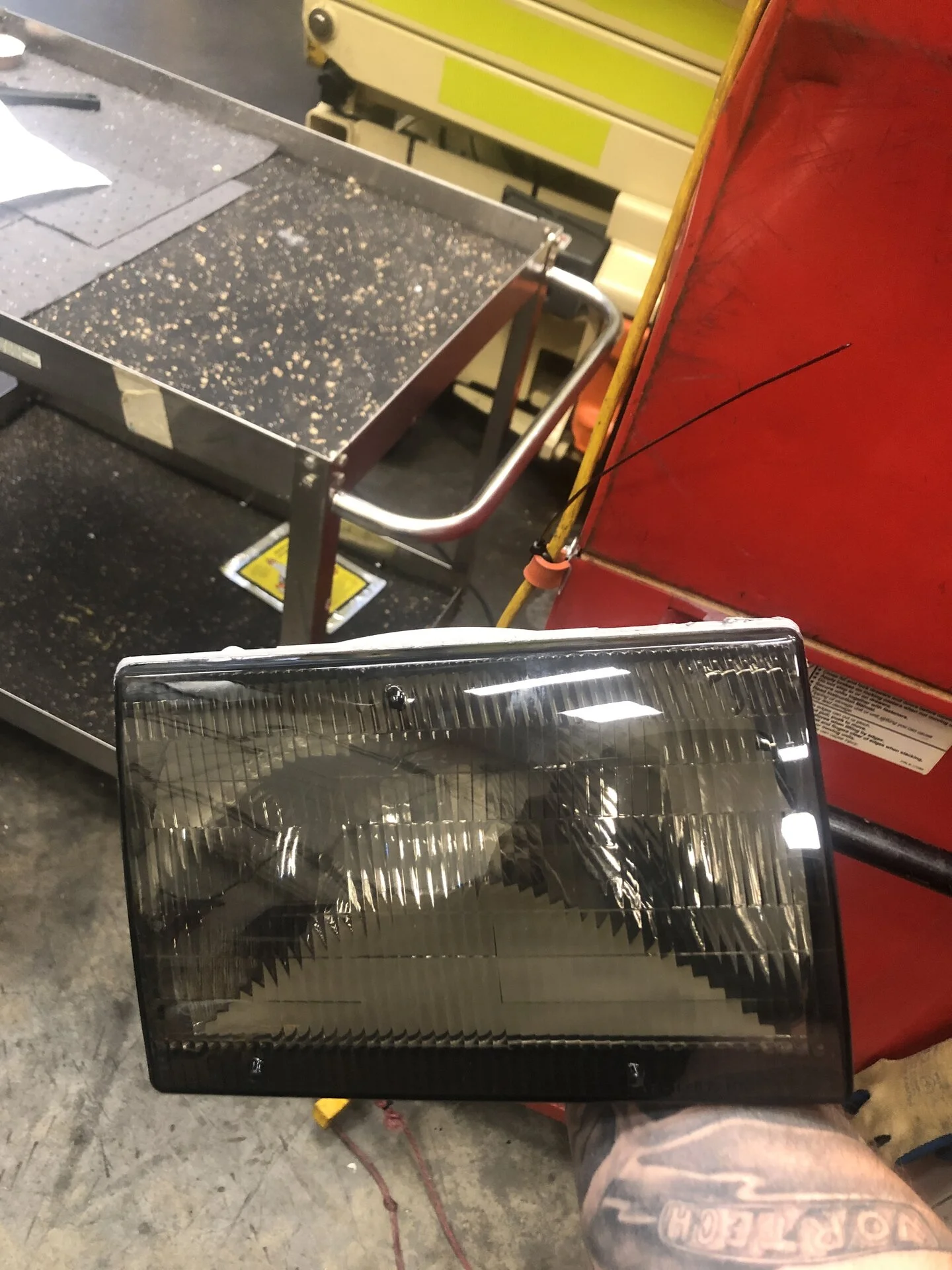

Pic of the one that’s on the car .

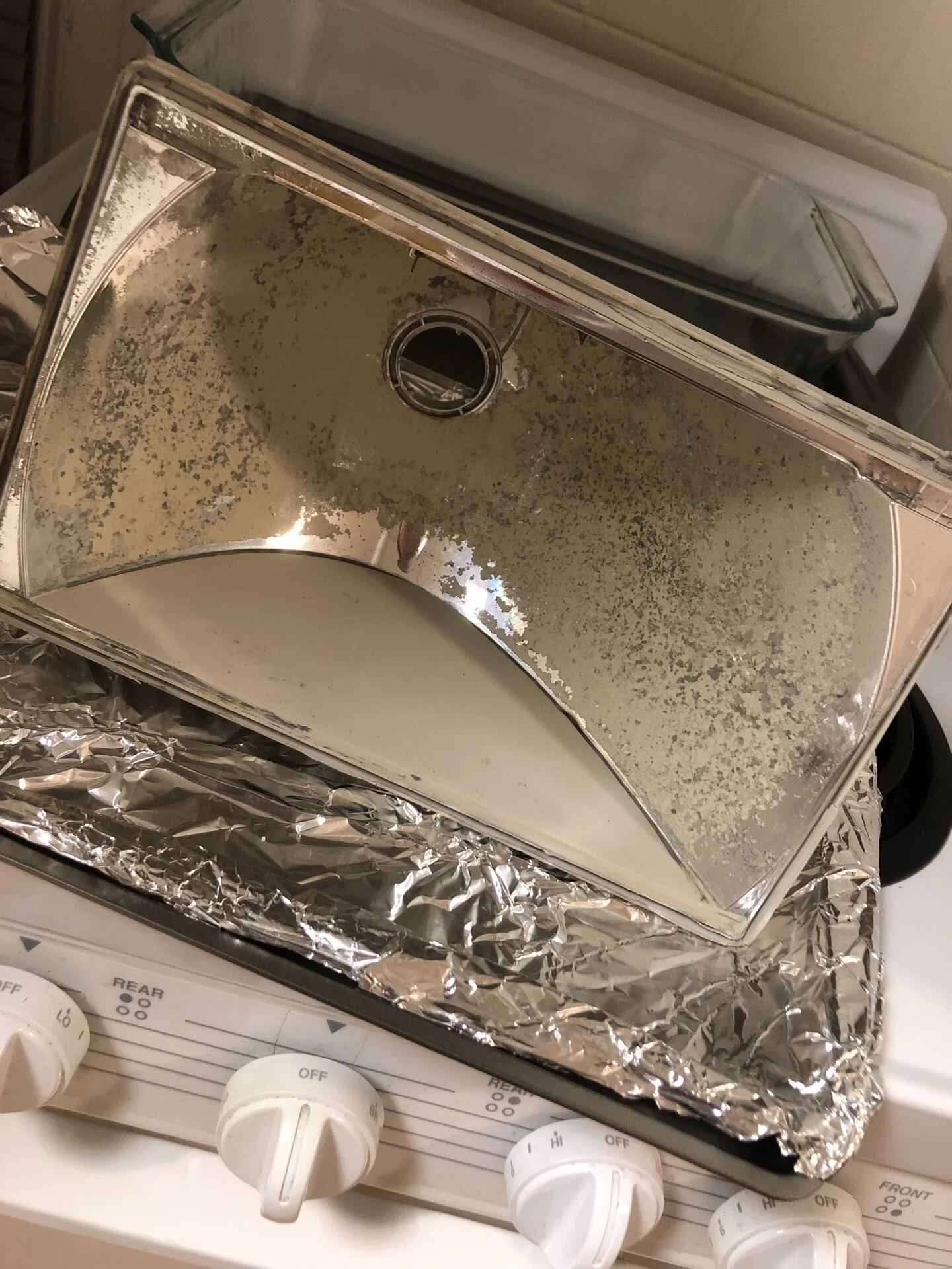

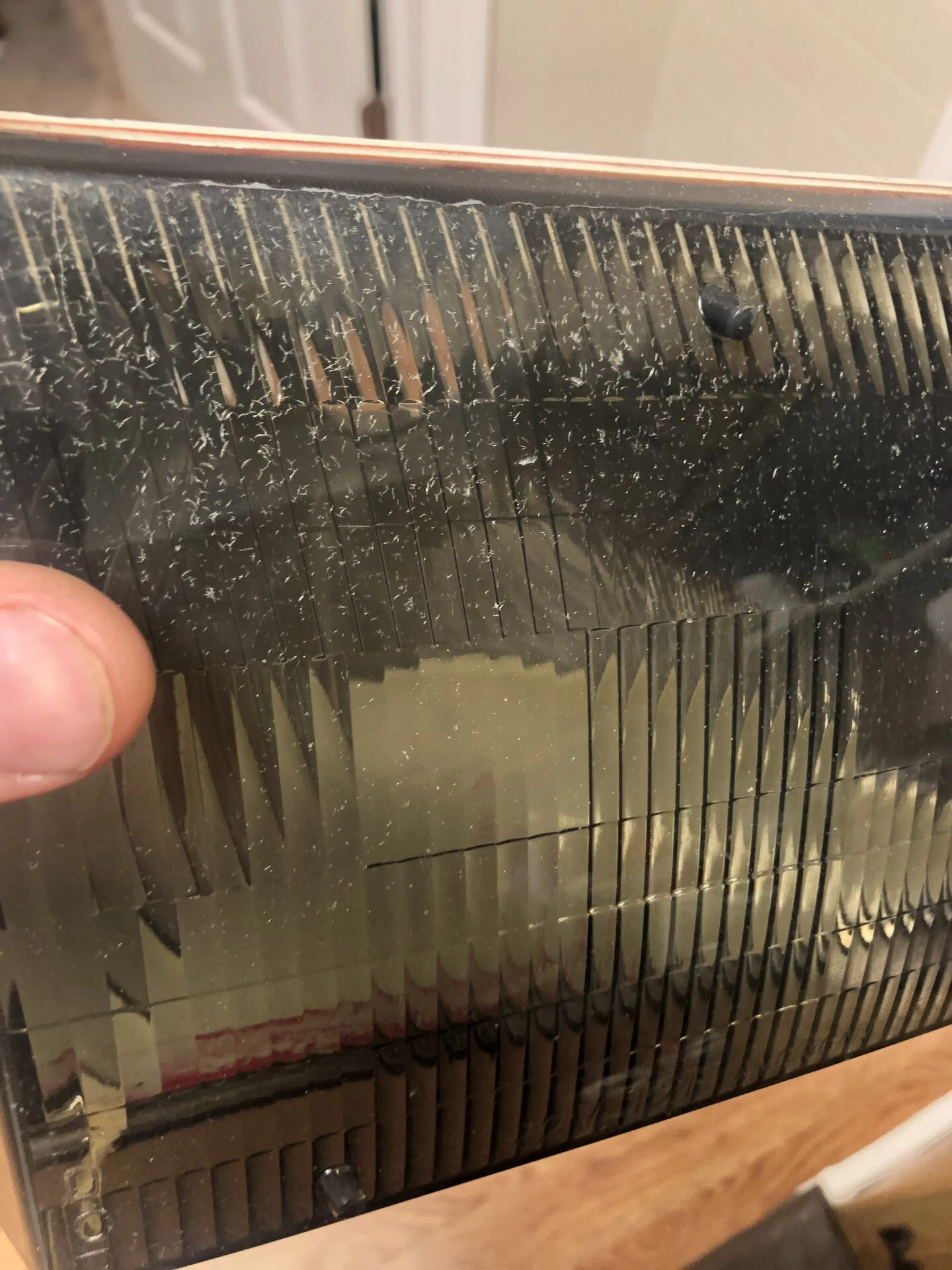

I scraped all the sealer out of the cracks . Re sealed with Bead grey the right stuff . Hopefully we are moisture free .

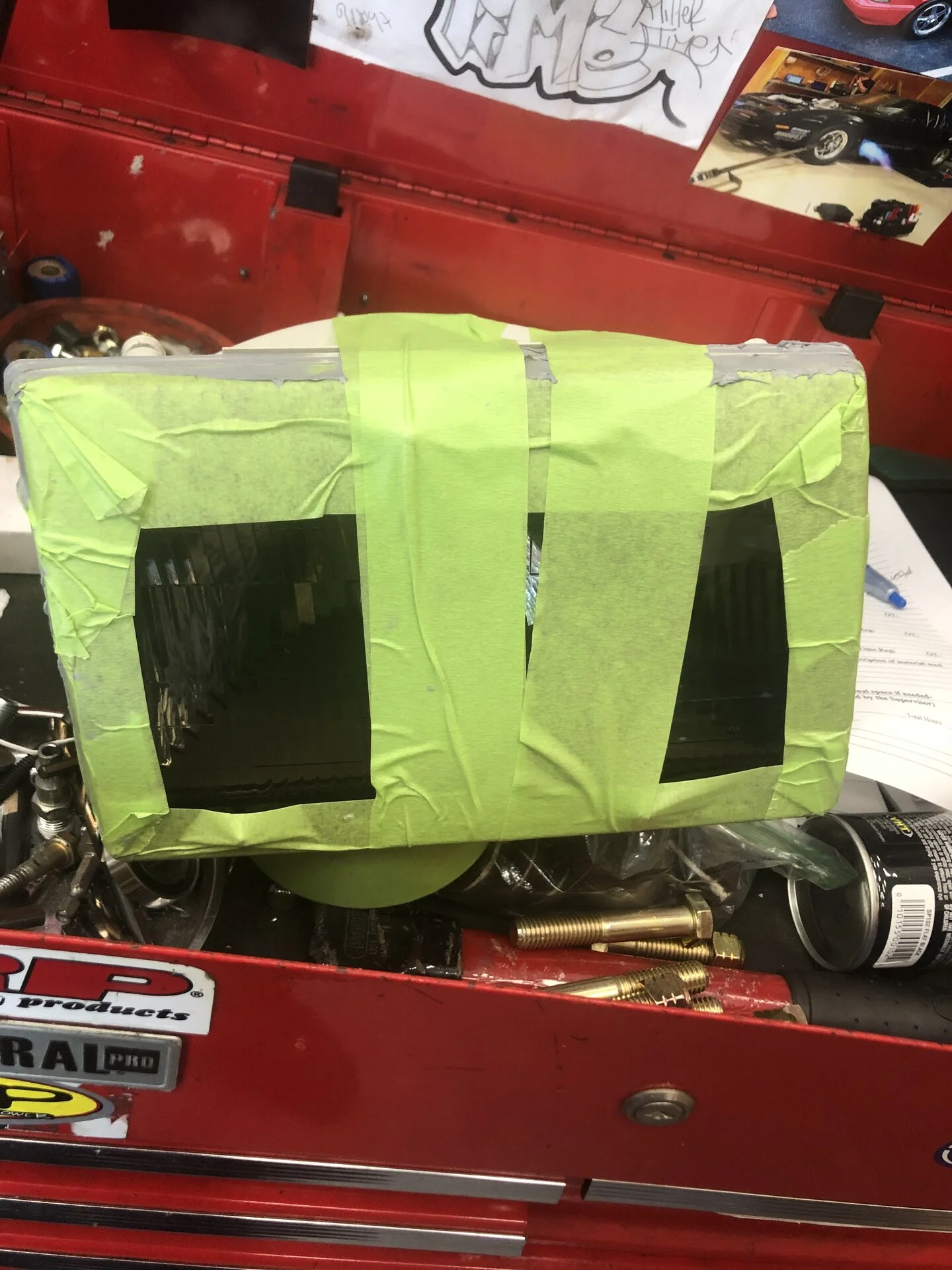

7-9 minutes at 250 in the oven opens these up by the way.

Lmao!!!!! I used the foil I figured If it did melt I wasn’t out a baking sheet . No issues though honestly . Zero smells. Nothing melted . All done .I can only imagine wifey coming home and asking,, hey what are you making for dinner? it smells terrible!
