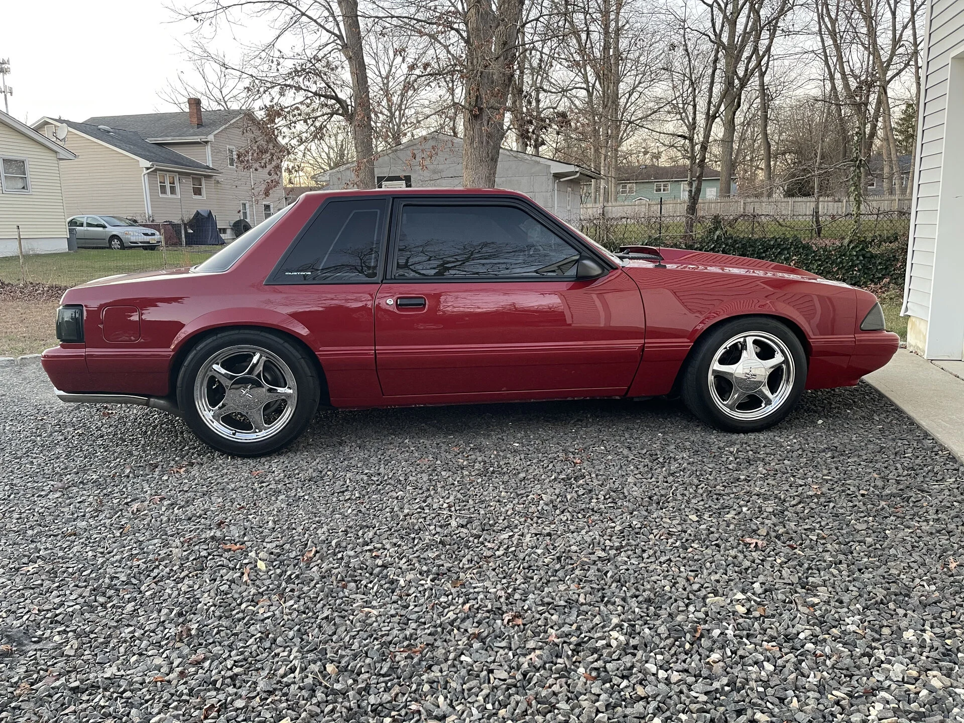

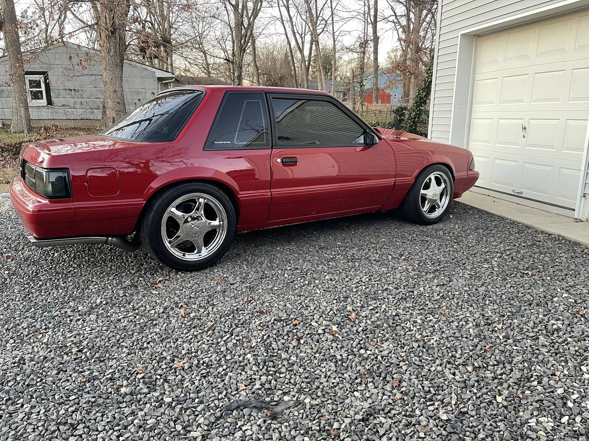

Looks beefy, pretty nice upgrade. How often do you adjust the upper arms? Like changes for track days-or is it a set em and forget em deal?
Once the pinion angle is set , unless I go back to a manual or go to a 28 inch tire I’ll set it and not touch it . The doubles make it much easier then the single adjustable

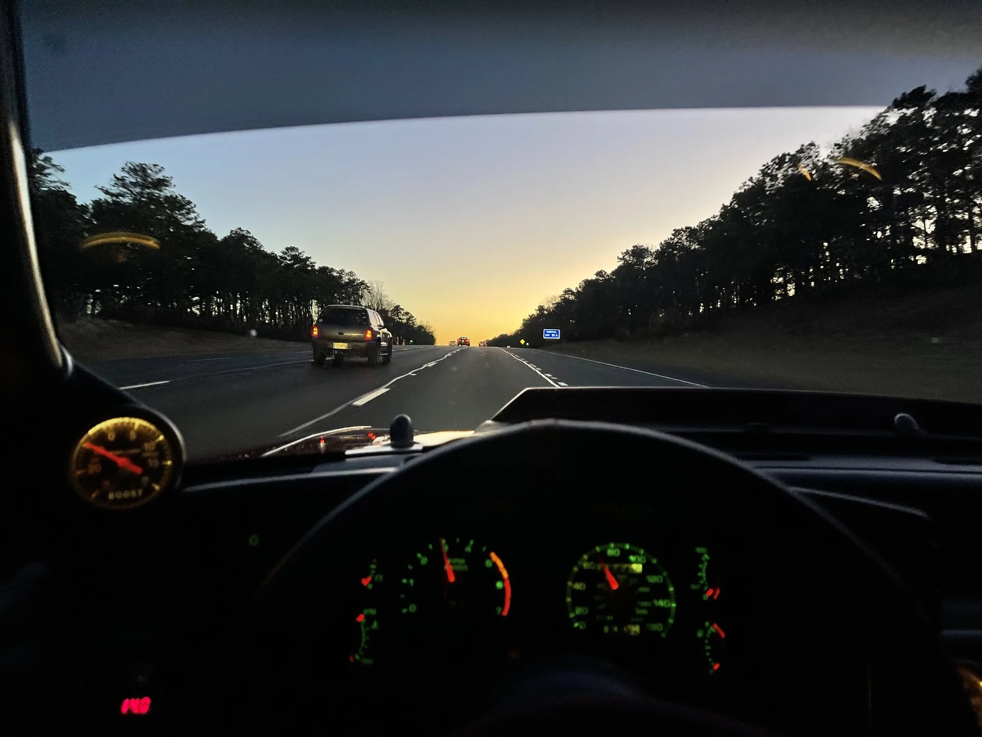

Took it for a quick blip with my new uppers . Drives so much better and wanted to try the new camera on my phone
Had a good time today cruising the car . Got some more data . I tightened the belt up and saw 14.8 psi at like 6200 today . Felt good to have the csr feel like it was making a little power . Then took it 20 minutes each way to pick up dinner a few hours later
speedo is slightly off this was actually 80 mph according to my gps
What trans are you using that 80 mph is 3000 rpm?

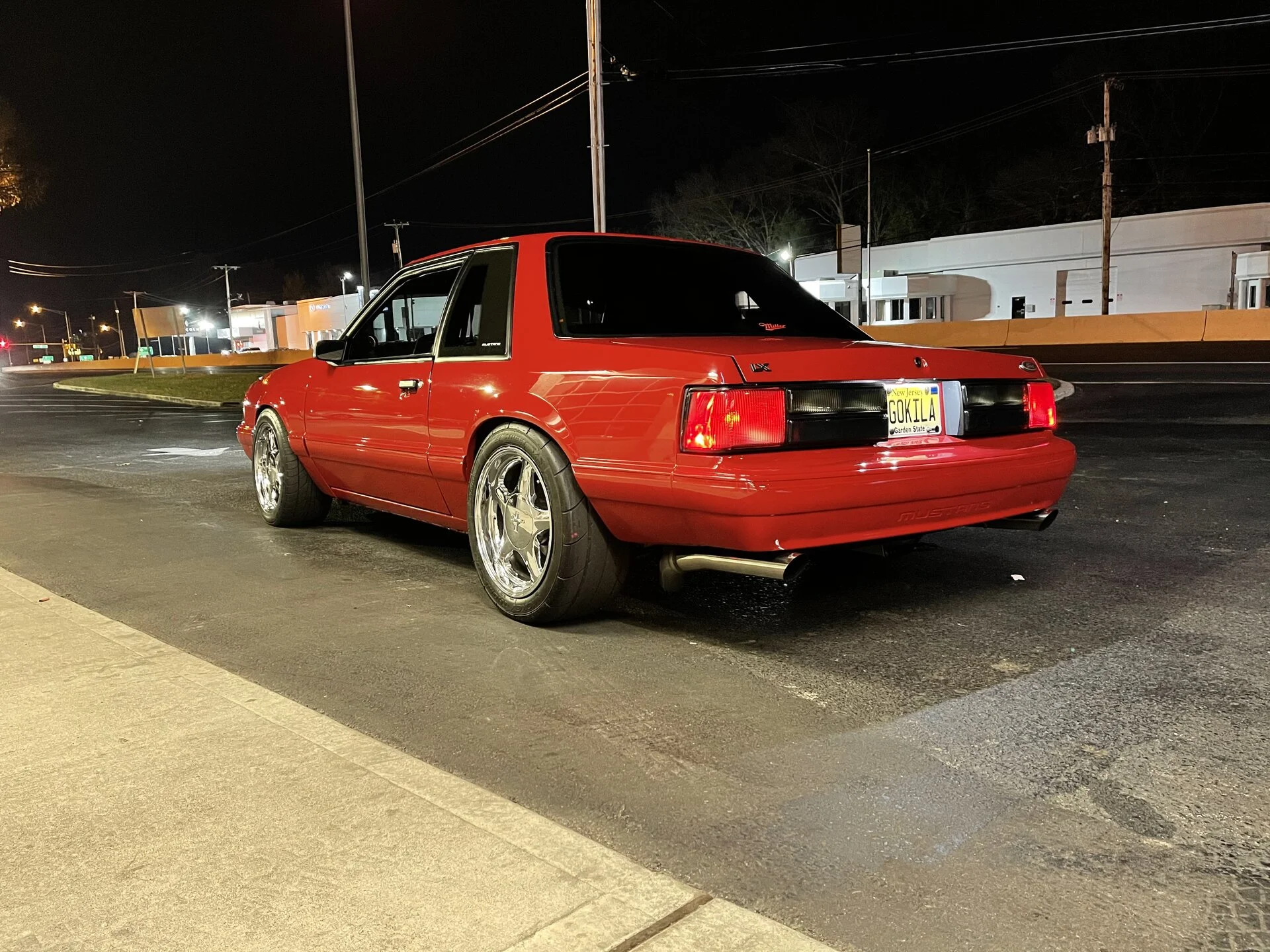

Kind of a random question but what LED tail light bulbs are you running? I've tried a many different pairs with the lx smoked clears and non seem to be as bright as they should be. I had a pair from some ebay store years back that worked great but ever since that pair died recently nothing else seems to come close. Tossed some red colored standard bulbs in it for now and they look pink so
The 194 and the actual taillight bulbs are Sylvania . They sucked in my stock painted lenses but they are great in the clear smoke !
