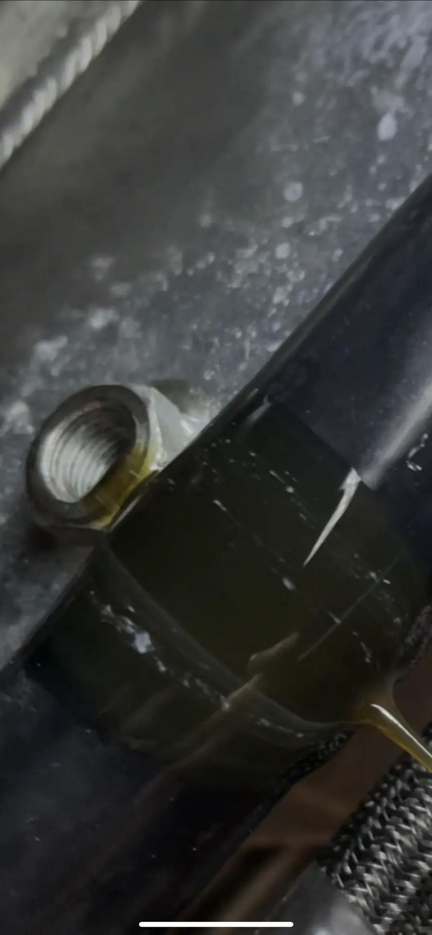

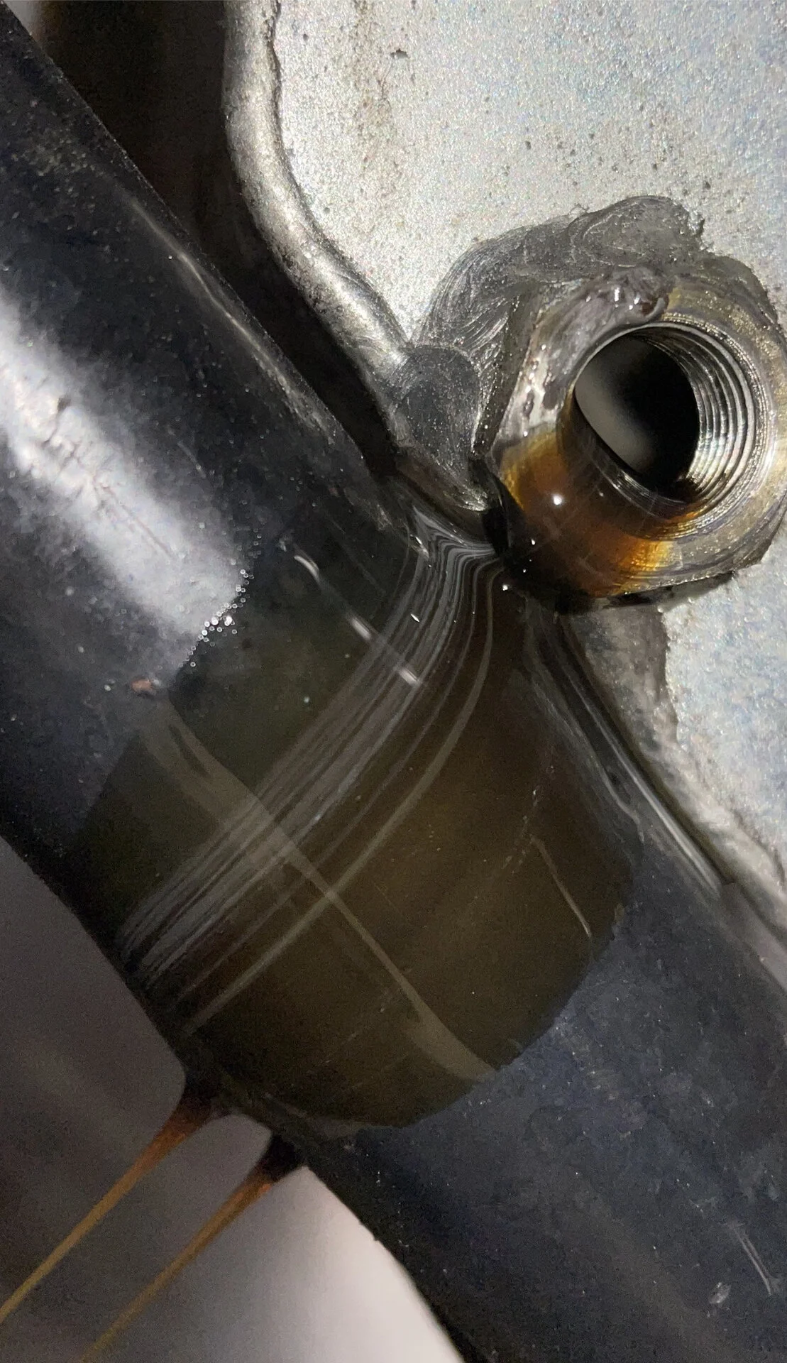

What’s winter without a little drama right ? So when I changed the oil before toys for tots I saw a trace of what looks like coolant only in the front sump . I thought maybe it was condensation from not warming the car up enough . So I changed it did toys for tots . The car runs beautiful I drove it 130 miles that day . No over heating or anything .
Last night I run the car to 180 degrees . Clean my oil drain pains and drop the oil . Same :poo: the front sump has this trace of what looks like it could be coolant or possibly meth ? It’s weird though because of the way it’s actually suspended in the oil .

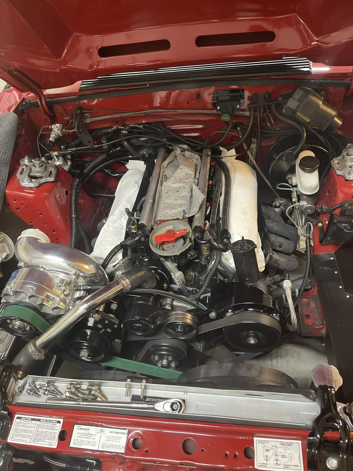

So I pull the upper intake Incase I need to pull the VC to see rockers . I do a leak down test on every cyl but I pressurize them to 120psi to see if I can hear bubbling in the block or see it in the radiator.
Thankfully I don’t .
So I started to check my lower intake bolts . With my stubby 3/8 rachet and two fingers trying to use minimal effort I can turn the nuts on the studs . They aren’t finger loose but they also seem to turn . So I’m thinking I need to re torque the lower along with my cyl heads after talking with Freezy . ( MLS gaskets ) .
Or the other thing is some
Meth is making its way into the crank case being we are spraying enough for 1200 hp worth that starts to ramp in at 5 psi and it can’t burn it off . Just a thought .
When it’s in a drain pain you almost can’t even tell that it’s there . It doesn’t separate like it would if it were raw coolant or water . It isn’t a milk shake like a blown gasket the oil is still very much there .

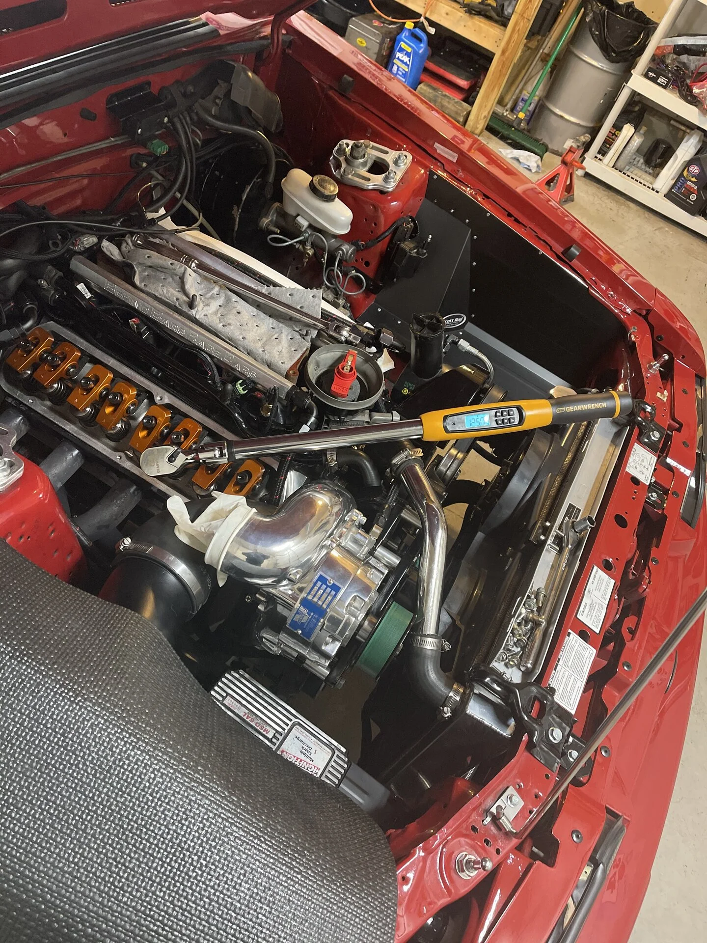

Went over all the lower intake bolts ( definitely loose like only 10-12ftlbs ) and re torqued the heads finally. Waiting on new header gaskets . Then I’ll clean up the lower intake where it’s hard to get into as well as the valve covers from all the dust that gets up in them .

Looks like condensation to me.
The way it sits on top of the oil does raise questions
That’s what I’m thinking too so I just wanted
To play it safe .
No smoke . No pressure getting into the coolant from any cylinders . Good time to check the heads and re torque and go over intake studs

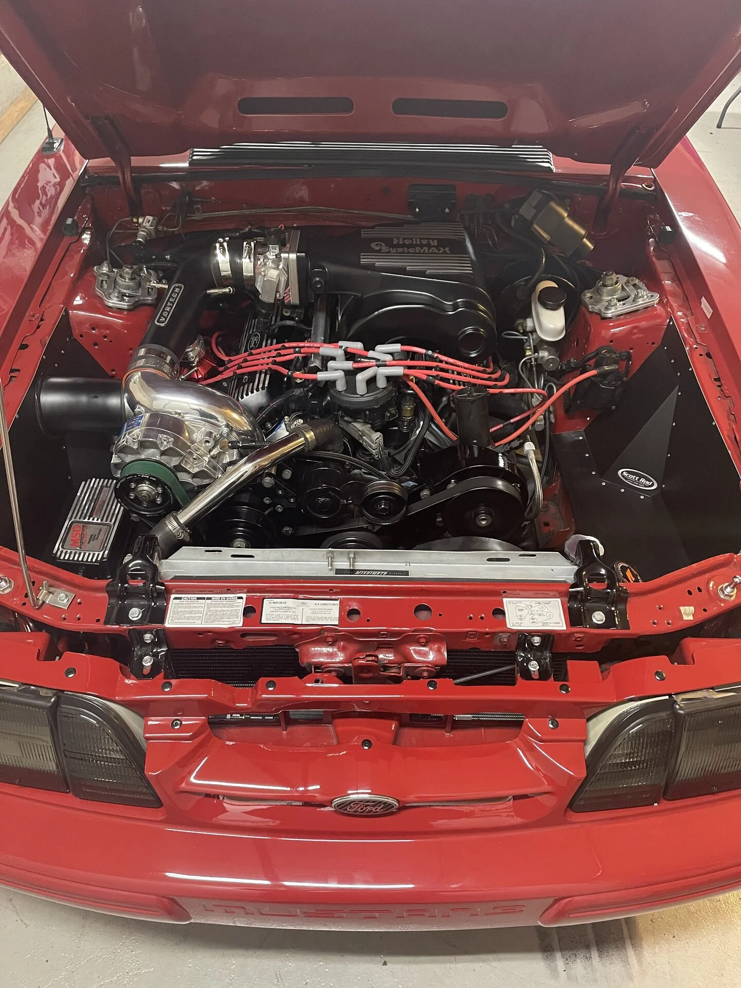

Finally had time to get this all buttoned up . Cleaned everything up while it was accessible too . Pulls almost 2 inches more of vacuum at idle hot . I’d say that intake was a bit loose .
Spoke to another buddy of mine . He also saw a lean spot on the dyno due to his intake being loose ( Vortech car ) like I saw in my logs when I was starting to lean on it .
