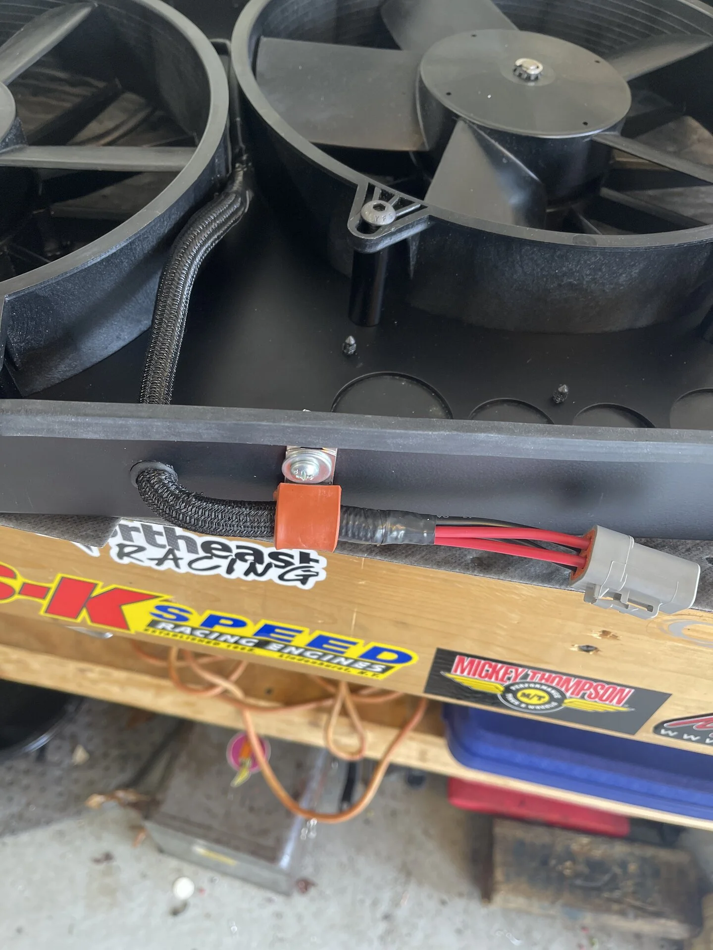

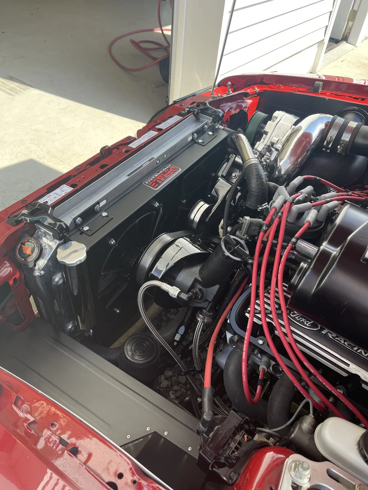

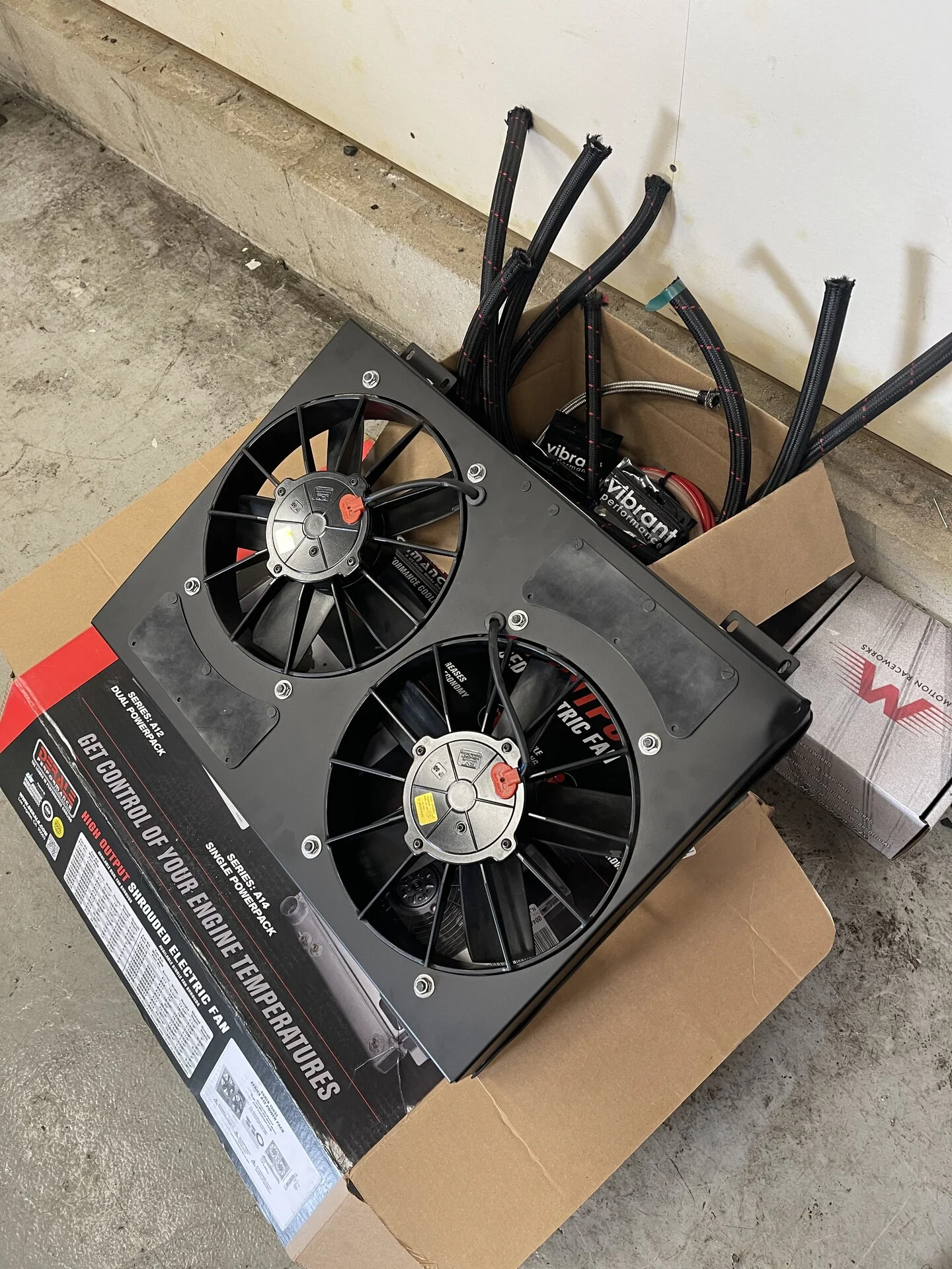

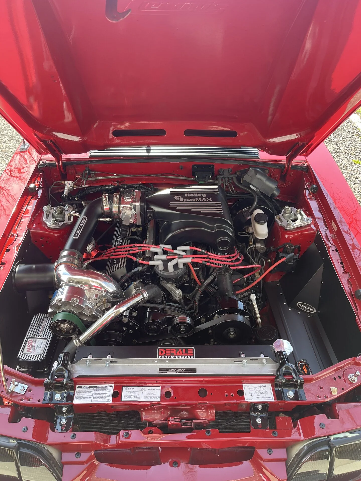

Today after trimming the new fans as much as I could to get the clearance between them and the engine I got it mocked up . I need to radius the spot by the rad hose some more and drill to mount the lower brackets . Once it’s all done and bolts up I’ll make the new harness . Then pull it all apart and have the brackets and shroud powder coated black
You’ll have to tell me what you think of the cooling system...My current fan almost works, but will allow the temp to creep while in drive in stopped, or stop-n-go traffic. Last time In Fla., I had to keep putting the thing in neutral to move the cooling water a little faster just to keep the temp in check.
Will do pal , I just picked up the shroud and brackets from the Powdercoater yesterday . So next day or so I’ll get it all together

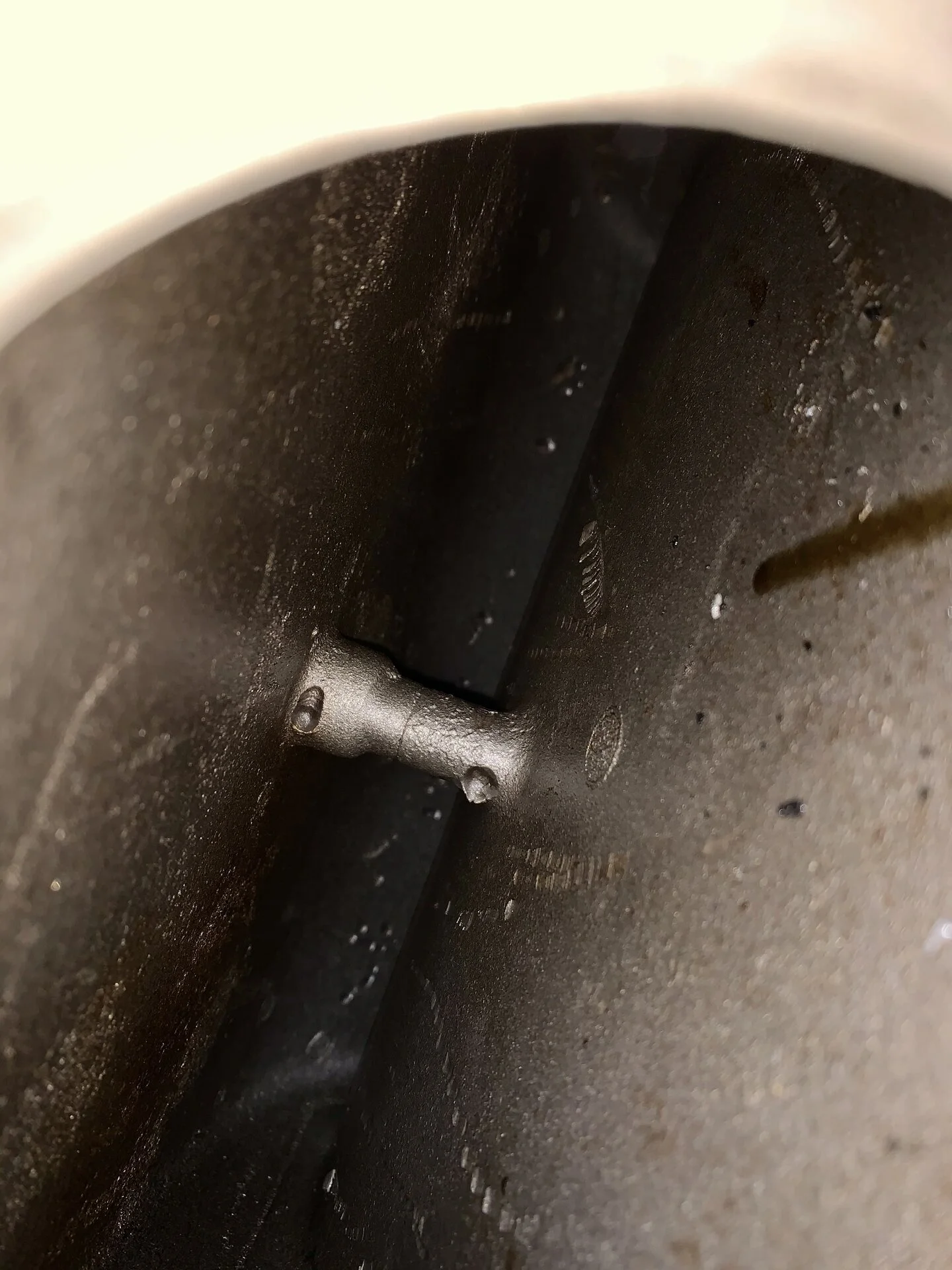

I had Mike Curcio who owns M.C.R.P do it . He works with my tuner and does amazing work . He did have to epoxy where the egr provision used to be . View attachment 676555

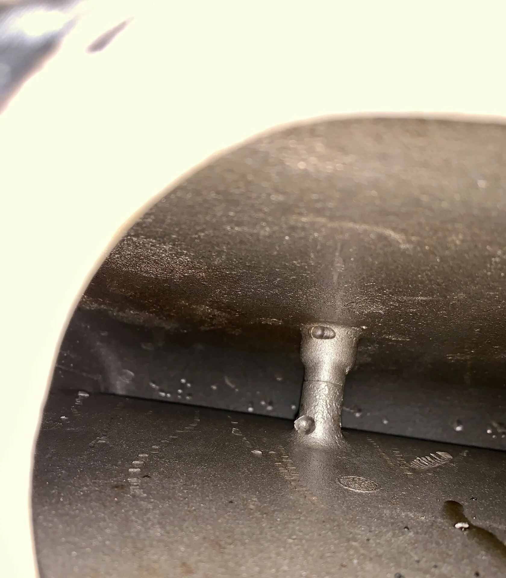

Nice, maybe ill try and find a shop around Austin to do that. If not I guess I’ll just run a 75, I’m also wondering if this intake I picked up will be ok. I guess something shot up in there and banged around, caused some pretty decent gashes in side. During grad school we talked about laminar vs turbulent flow etc, obviously different concept in regards to anesthesia but figured it would probably mix in the same concept with flow through the intake. What’s your opinion on this? Might not be a big deal I guess?!?!
Yeah something must have past through . In terms of that runner being so big in comparison to the small gashes I’d tent to think it really shouldn’t make the air turbulent at all .

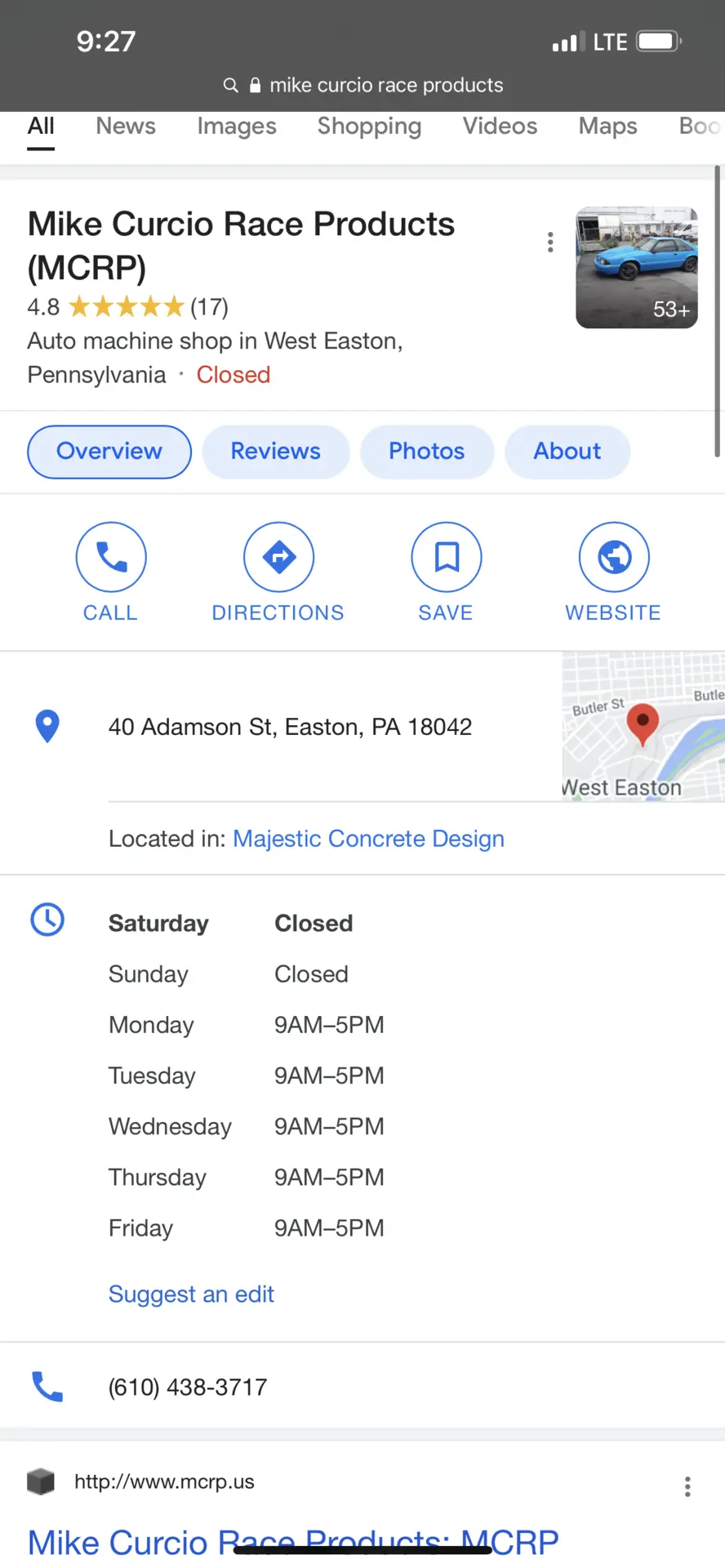

If you were interested in Mike doing your intake here’s his info , could always ship to him

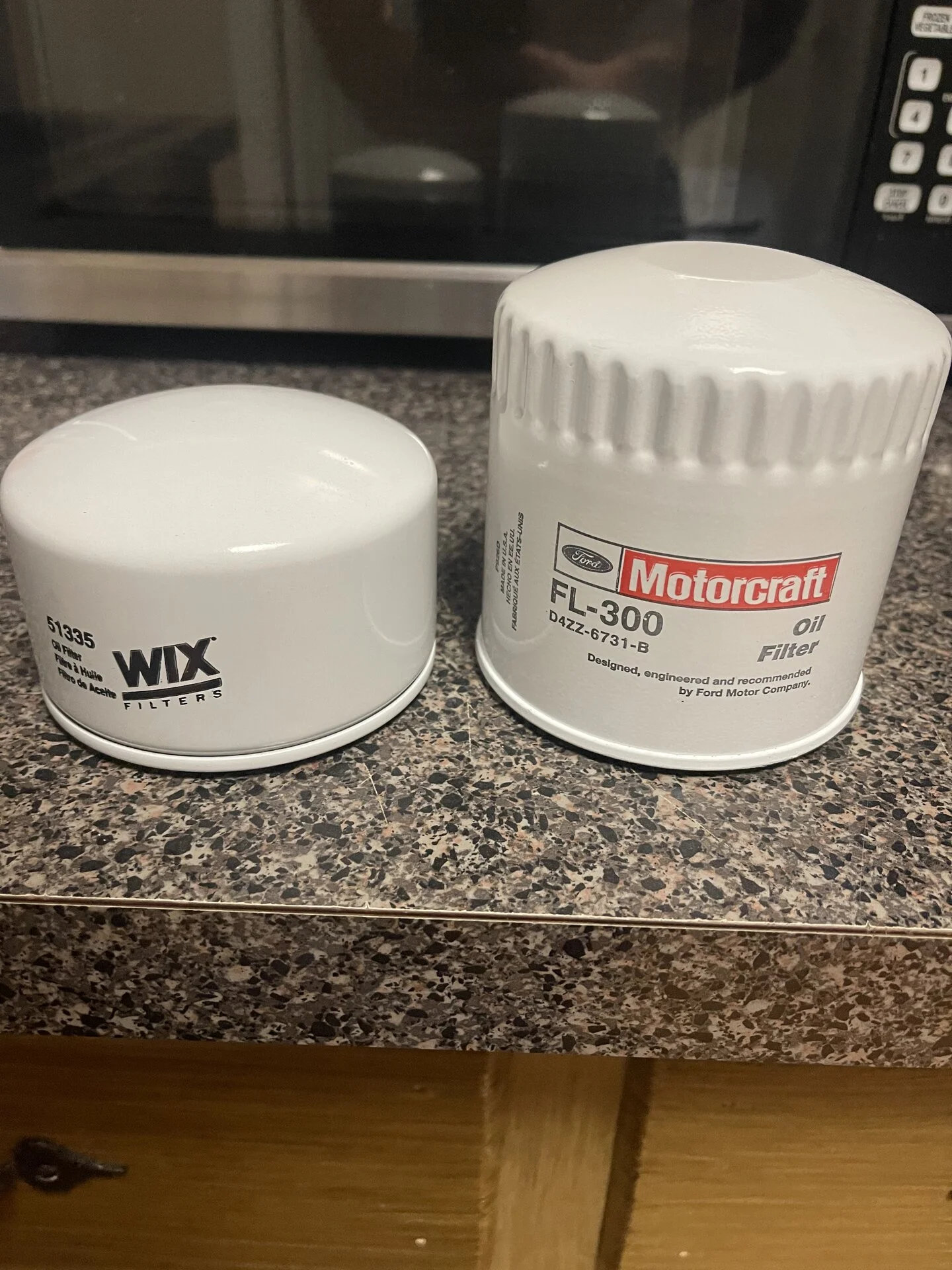

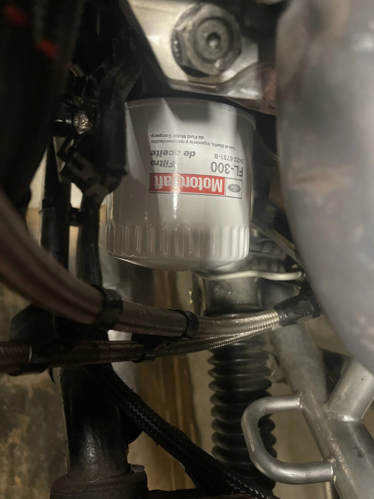

Anyone looking for a small oil filter here is some options . I ran the pancake wix for a bit because I couldn’t find the 300. Finally got my hands on one and That will be my new filter of choice I think . A full size filter hits my power steering lines I made .

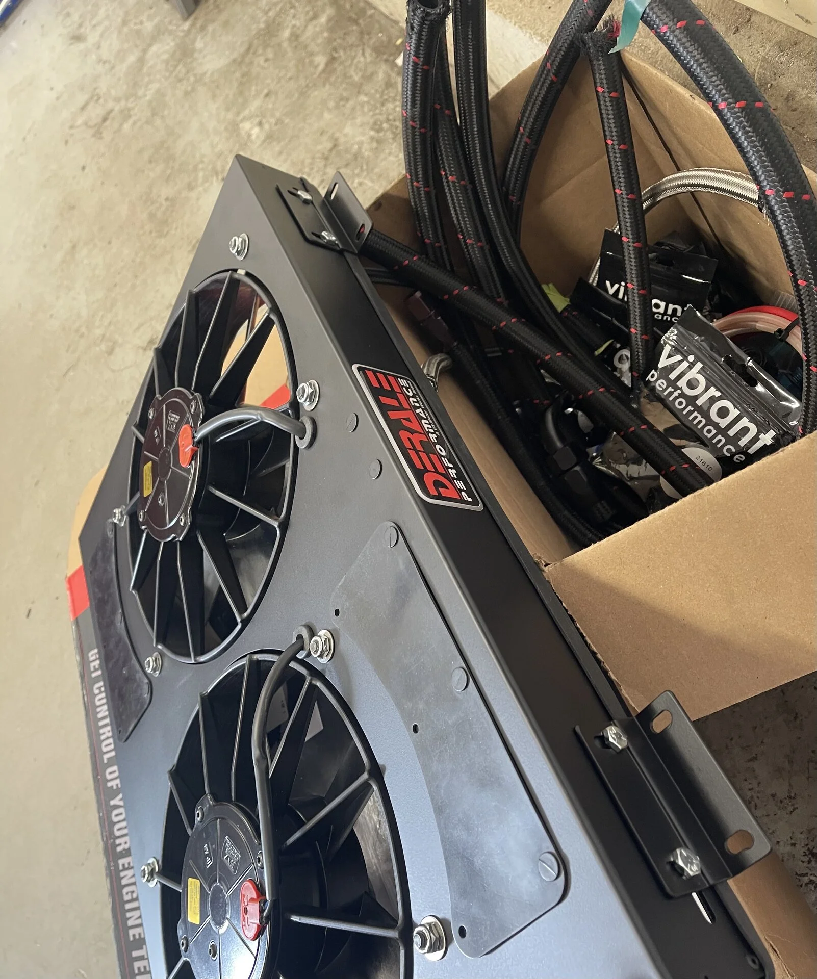

One of the best builds on stangnet. How do you like the electric fans? Can I also ask which Derale fans you used? I have the Holley Terminator and I think can control electric fans with it.
You can most certainly control them . Positive trigger only with the terminator . I use a leash dual 70amp relay for my fans and for fuel pump . Holley triggers it . The part number is 16833
