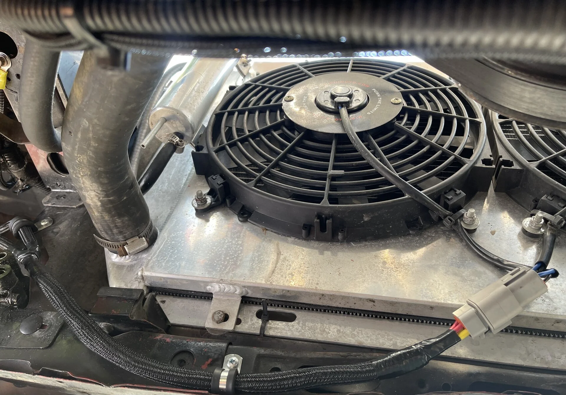

Still dealing with the car running warmer in warm weather . Mid 80s yesterday maybe high 80 . Drove the car all day . Lot of stop and go . Creeped to 205 at one point . Hovered 196-200 unless you really got some good time where it was cruising then it would come back down . I don’t know what else at this point . Only thing I’m missing is the little flaps that cover the sides of the rad to the core support to block the air around it . The lower air deflector is there .

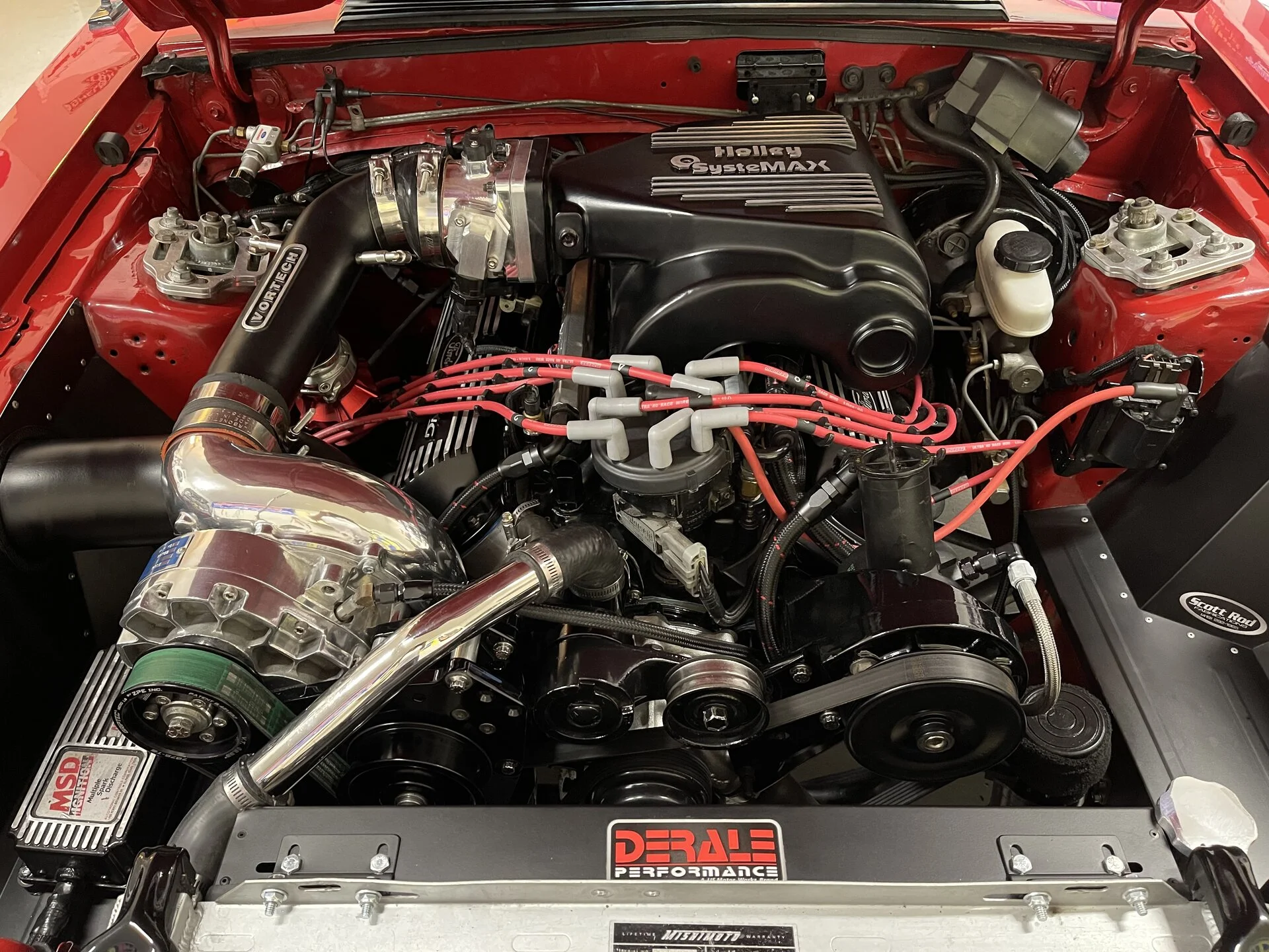

purdy..I’ll just leave this here .... This thing is like art![]()

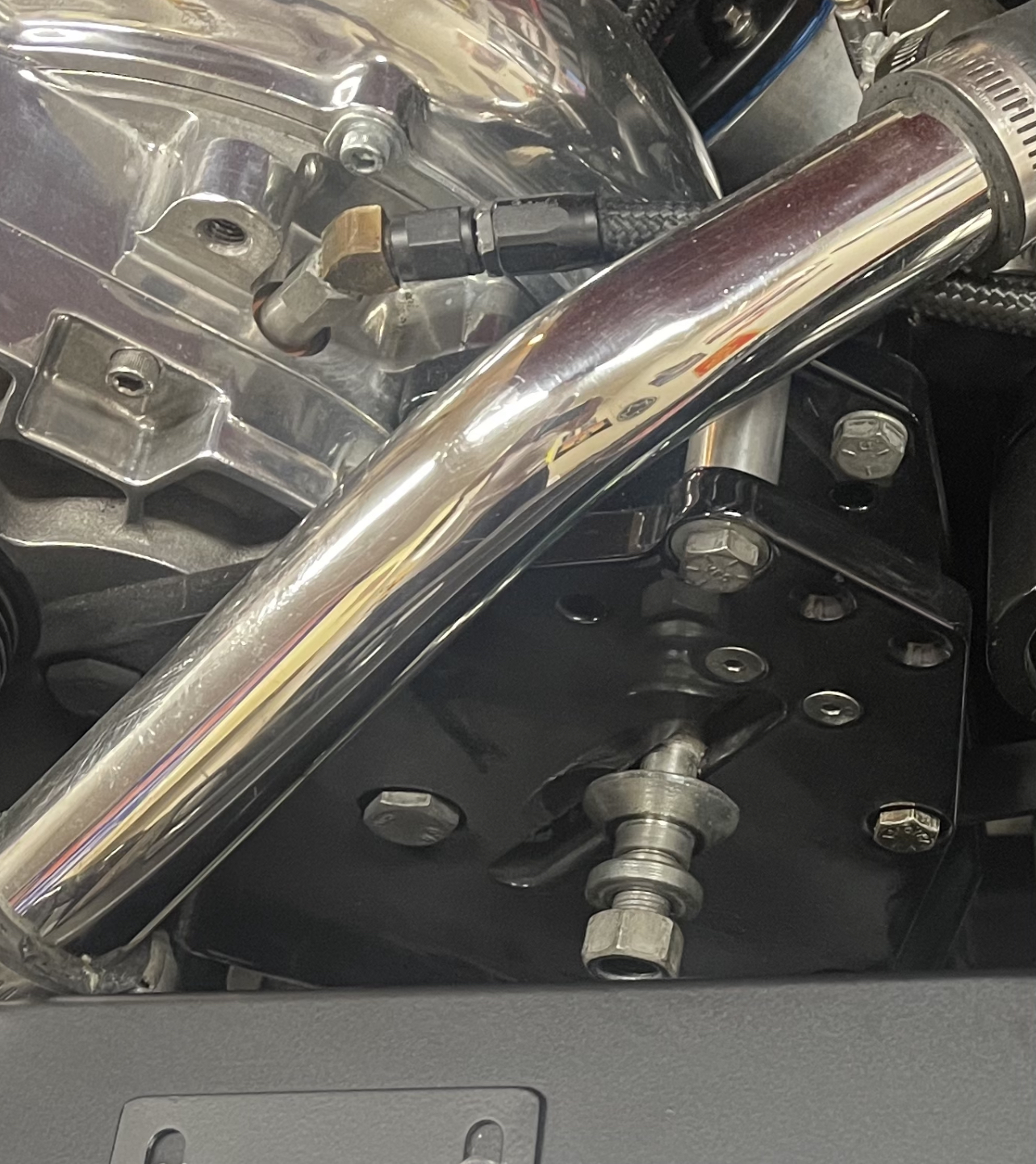

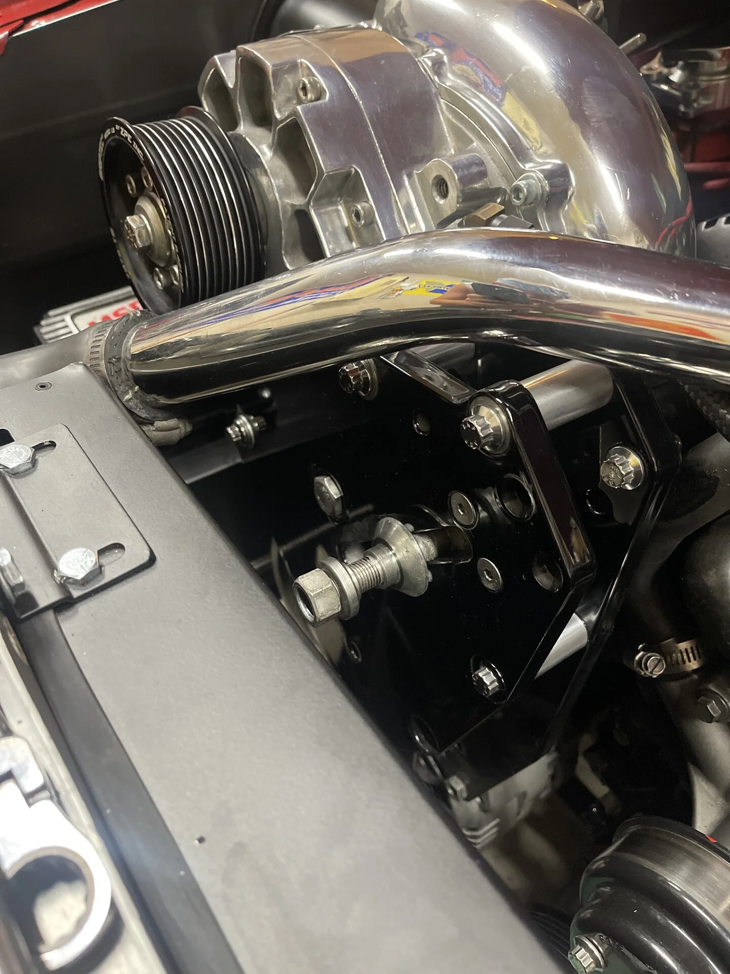

Makes a nice difference I can’t tell you how many times I’ve cleaned up those bolts that were on thereLooks great! I was just looking at that ARP hardware for all my front accessories.
I ordered the wrong ones for the 2 bolts on my PS ( Ford ac delete ) bracket I think they are 7/16-14 where they go into the bracket that bolts to the head but now that I have it apart I will get a real measurement.Those bolts do make a nice difference. Really is a great touch!

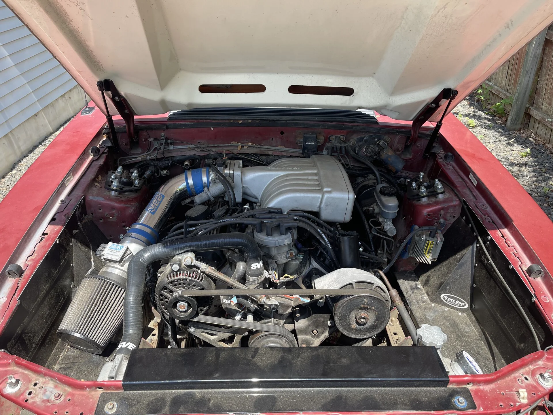

It’s not bad I thought it would be a little better then it is honestly I may do a back to back with my oem contours to seeAs usual man-cleanest engine bay on Stangnet
Still pretty happy with the derale fan setup?
