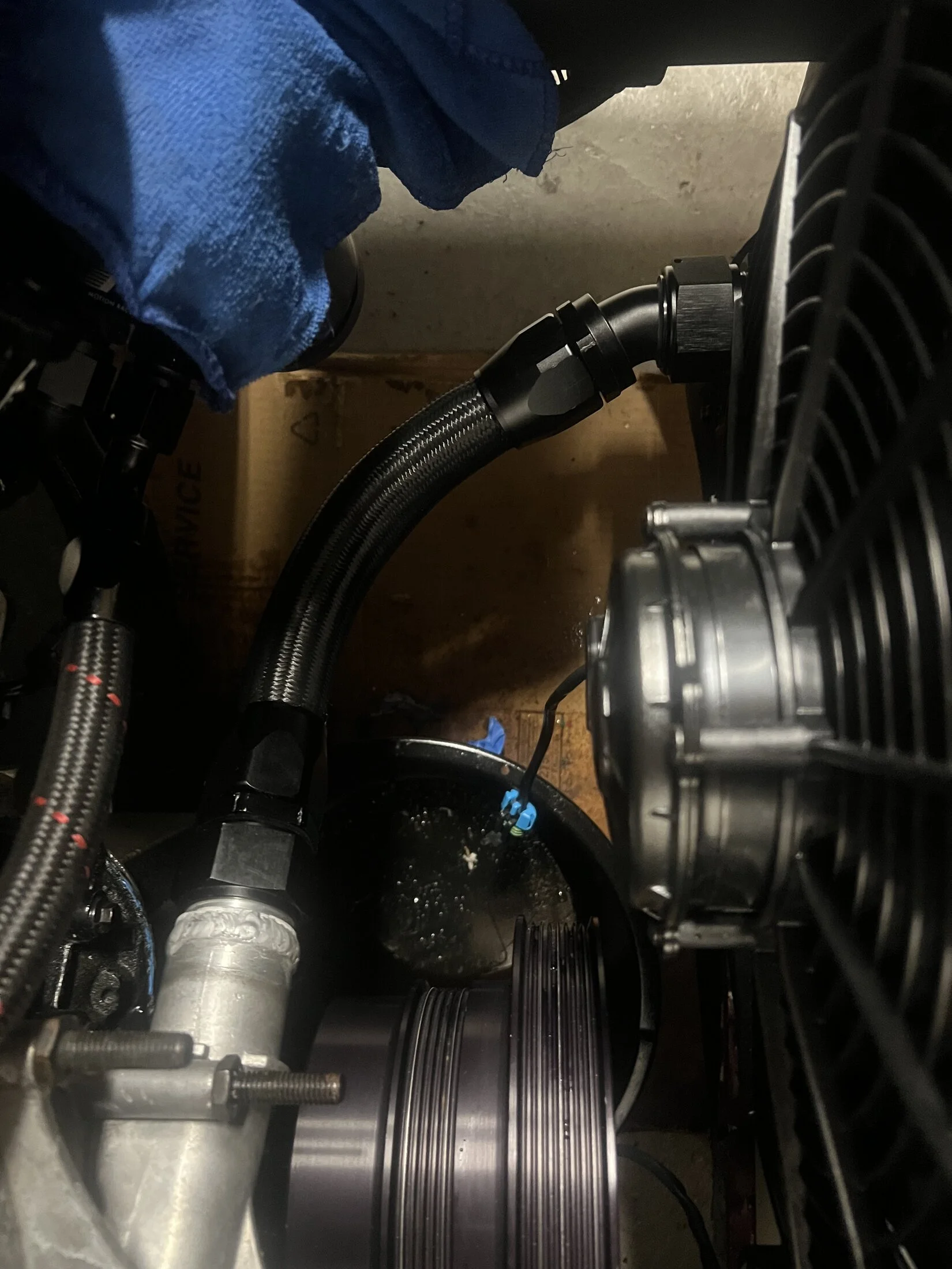

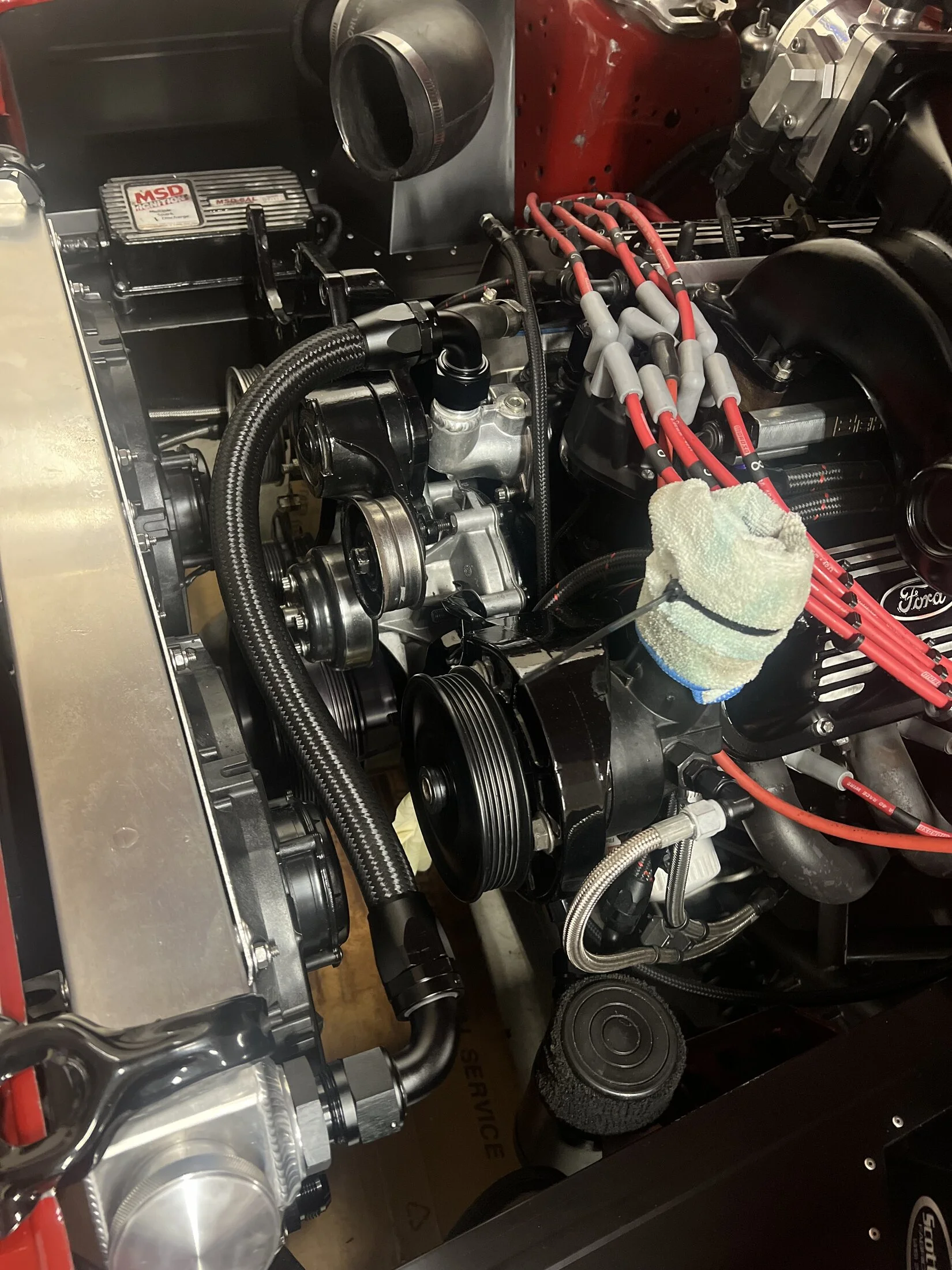

That is a bad ass setup man! Be sure to show pics of the final install and hose routing.

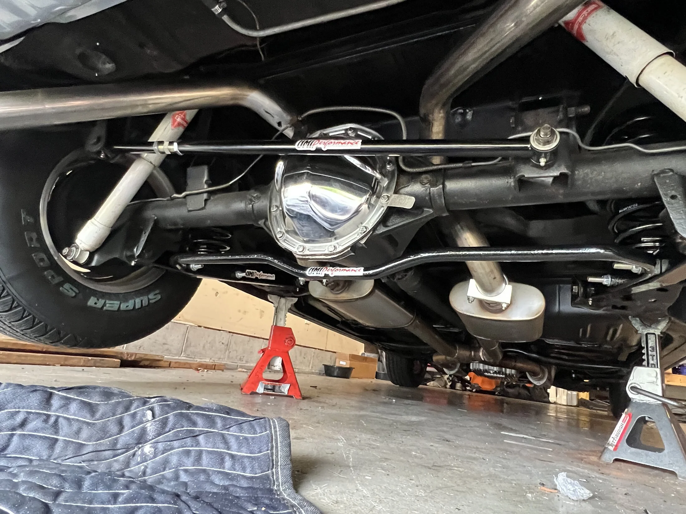

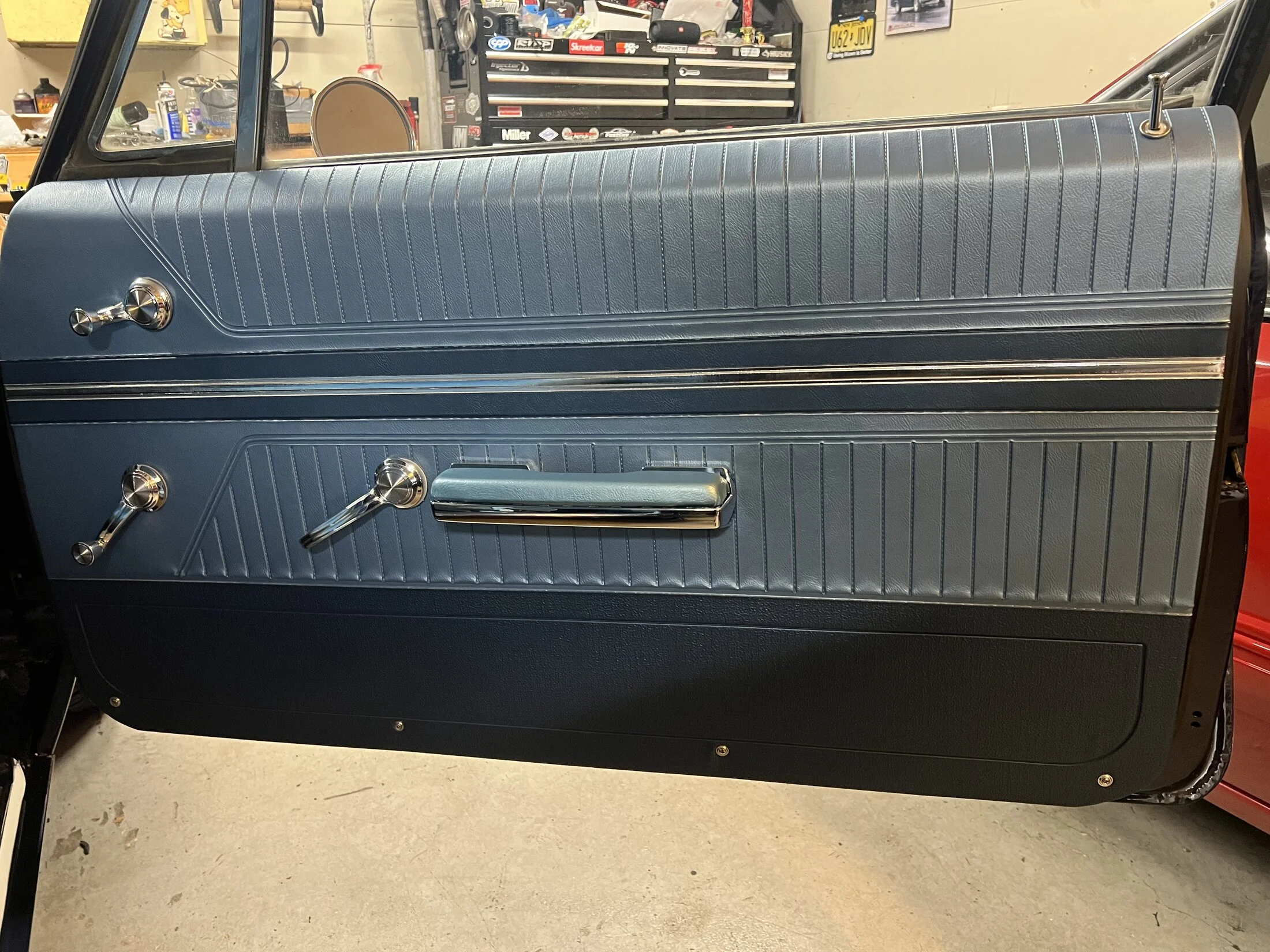

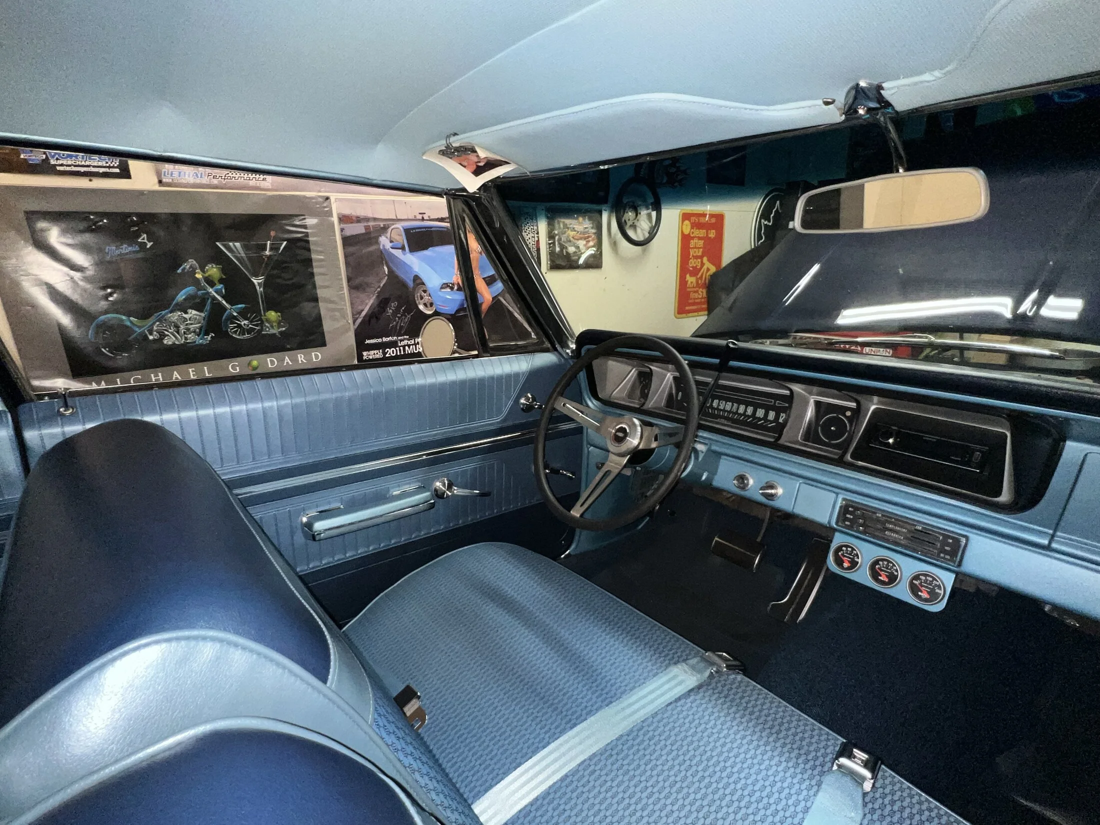

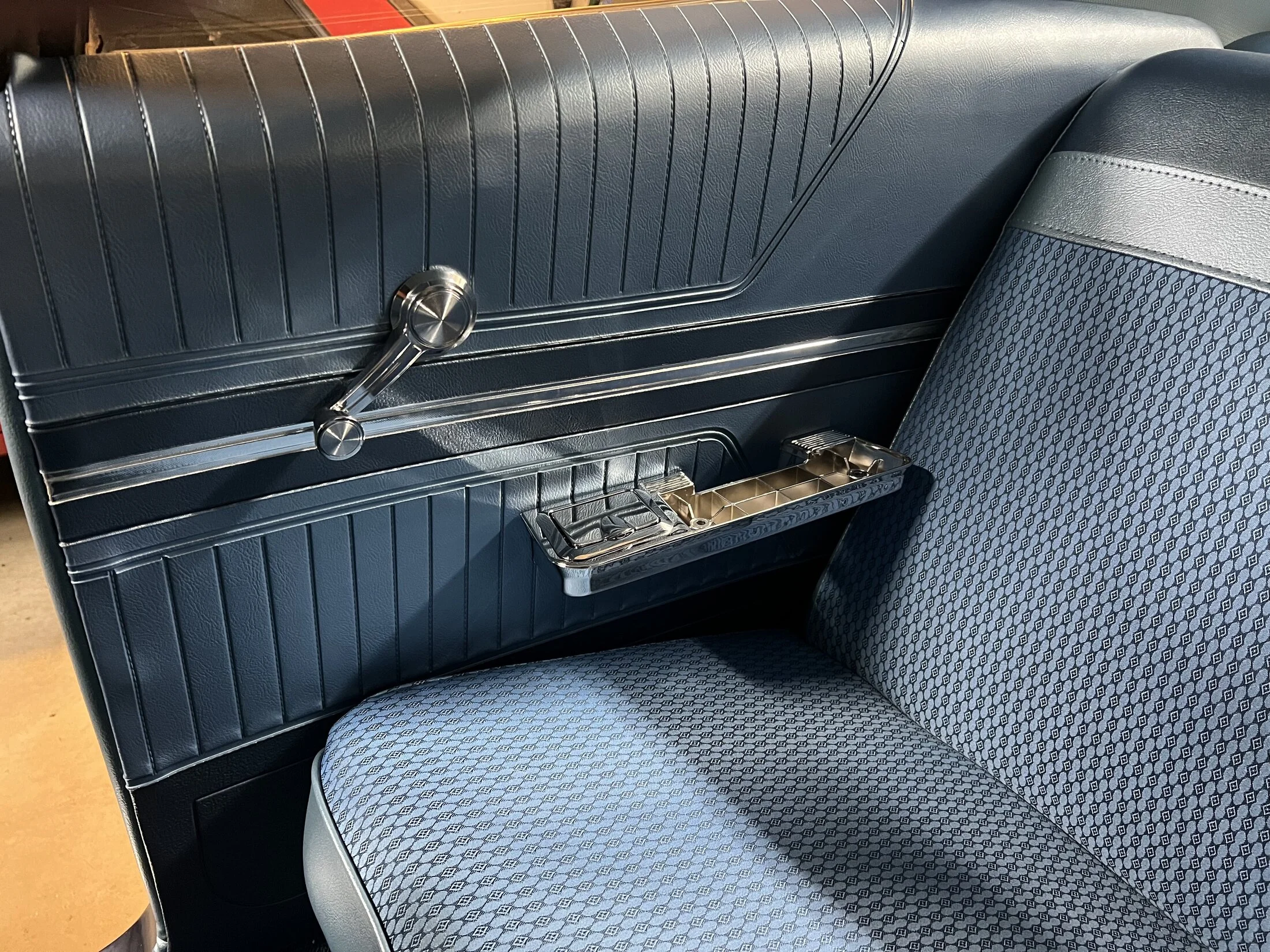

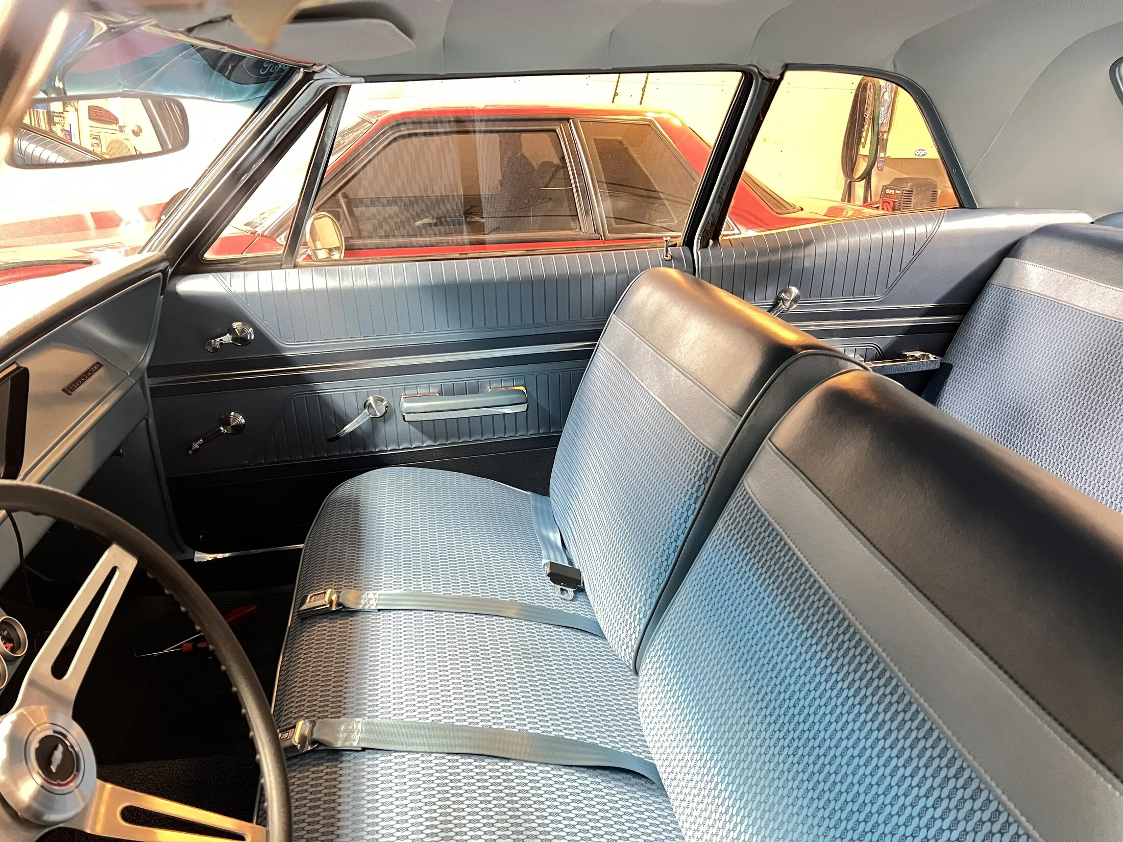

I will for sure I have too many coals in the fire so I haven’t been 200 mile an hour to get it done . Been working on my belair too. Got all the new rear Suspension in, finally got the interior for it been waiting since dec of 21 I ordered . Only thing I have left to do for the rear is viking shocks when I eventually do the front coil overs
Hoses are going to run me around 320 to make

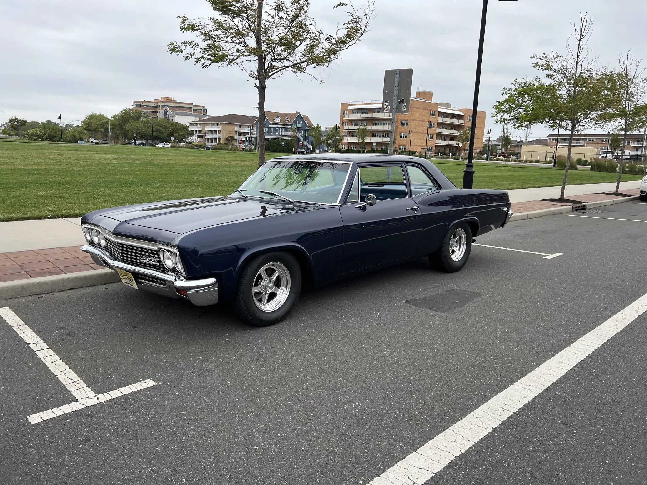

last time I was in a full size caprice it seemed funny how FAR AWAY the dash was....
whoa, I just realized that is a two door.... :nice:
I love these cars but only the belair and biscayne . To me they look tough as post cars . It’s like the notch back of them all
Yeah 2 doors are where it’s at !

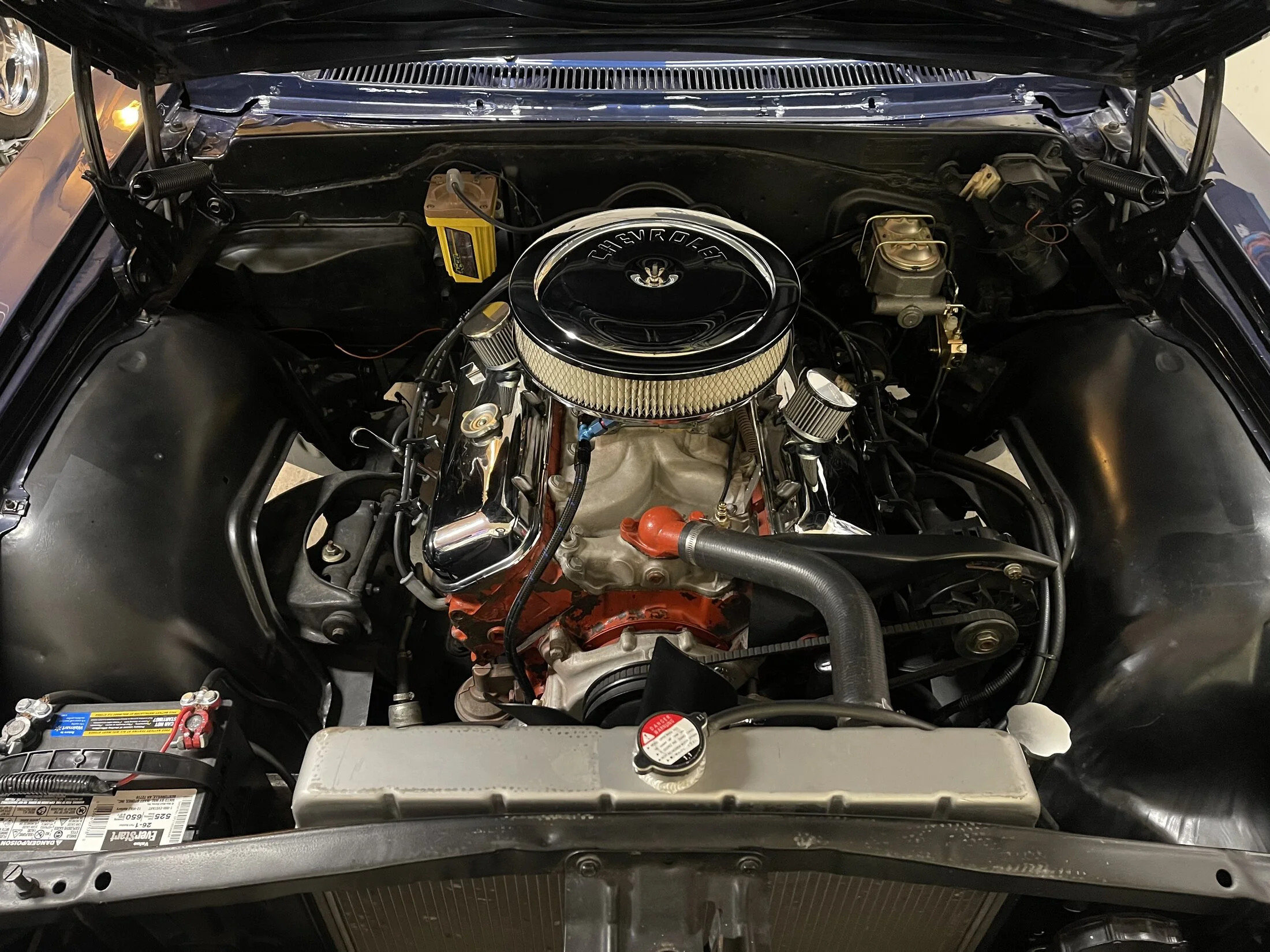

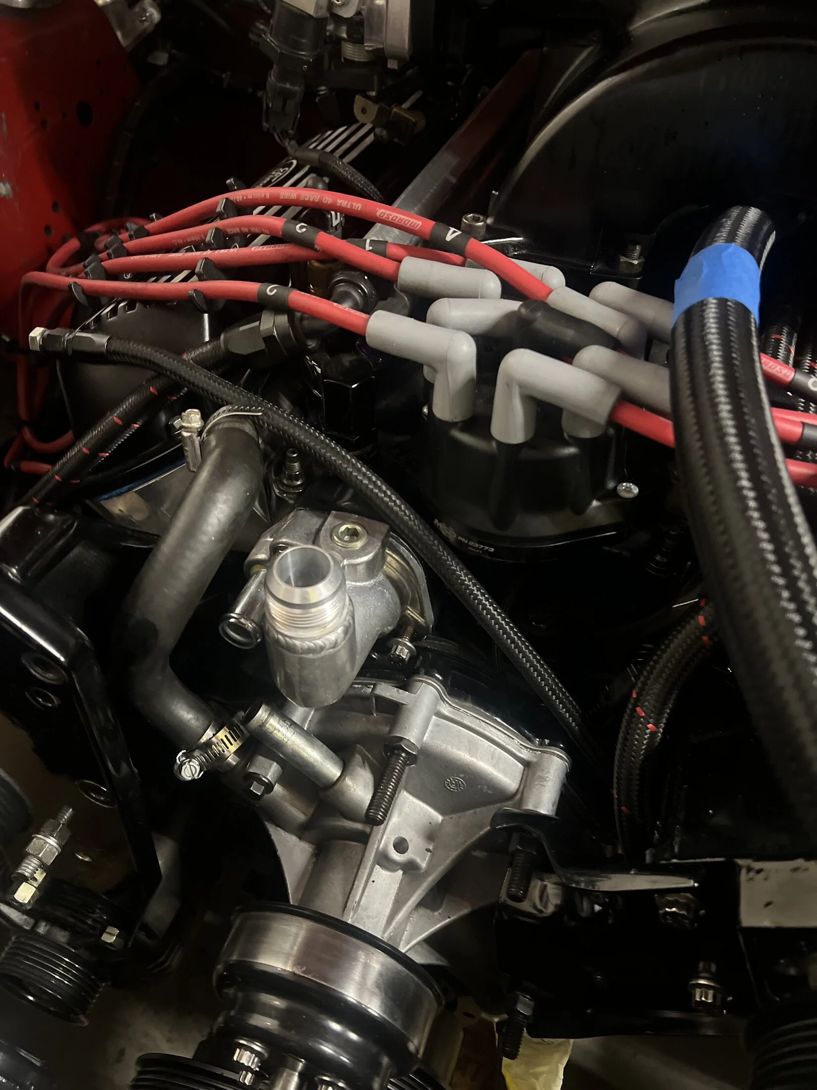

engines next on the list. For now it has a 402 - 396/427 heads , unknown cam , roller tip rockers , ported intake , hooker super comps , and a 3 inch x pipe into 2.5 stock style tail pipes .
I have a 4l80e for it and I’d like to have shafiroff build me a NA short deck 540 . Will make like 715 on pump gas .
Then vintage air

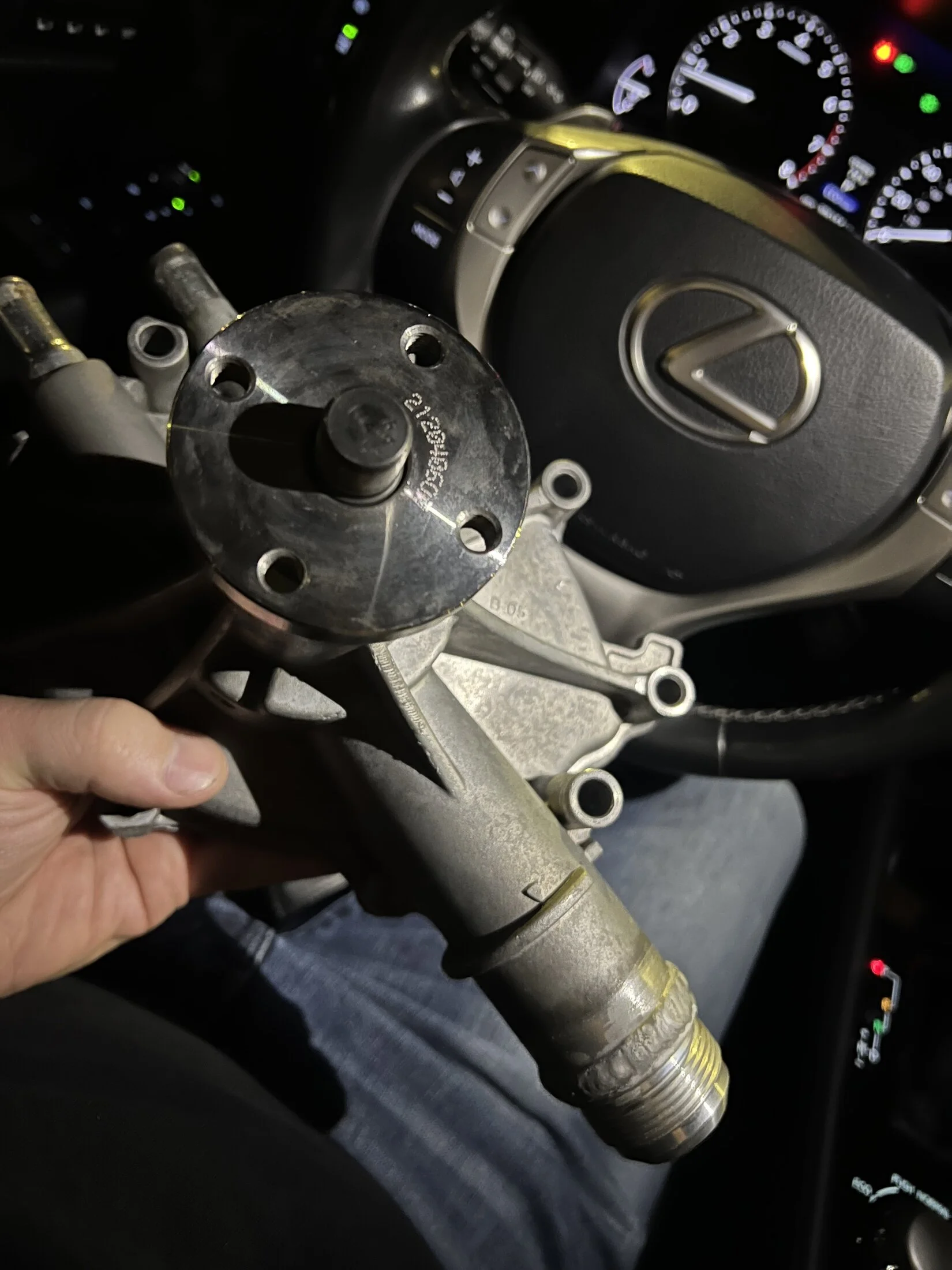

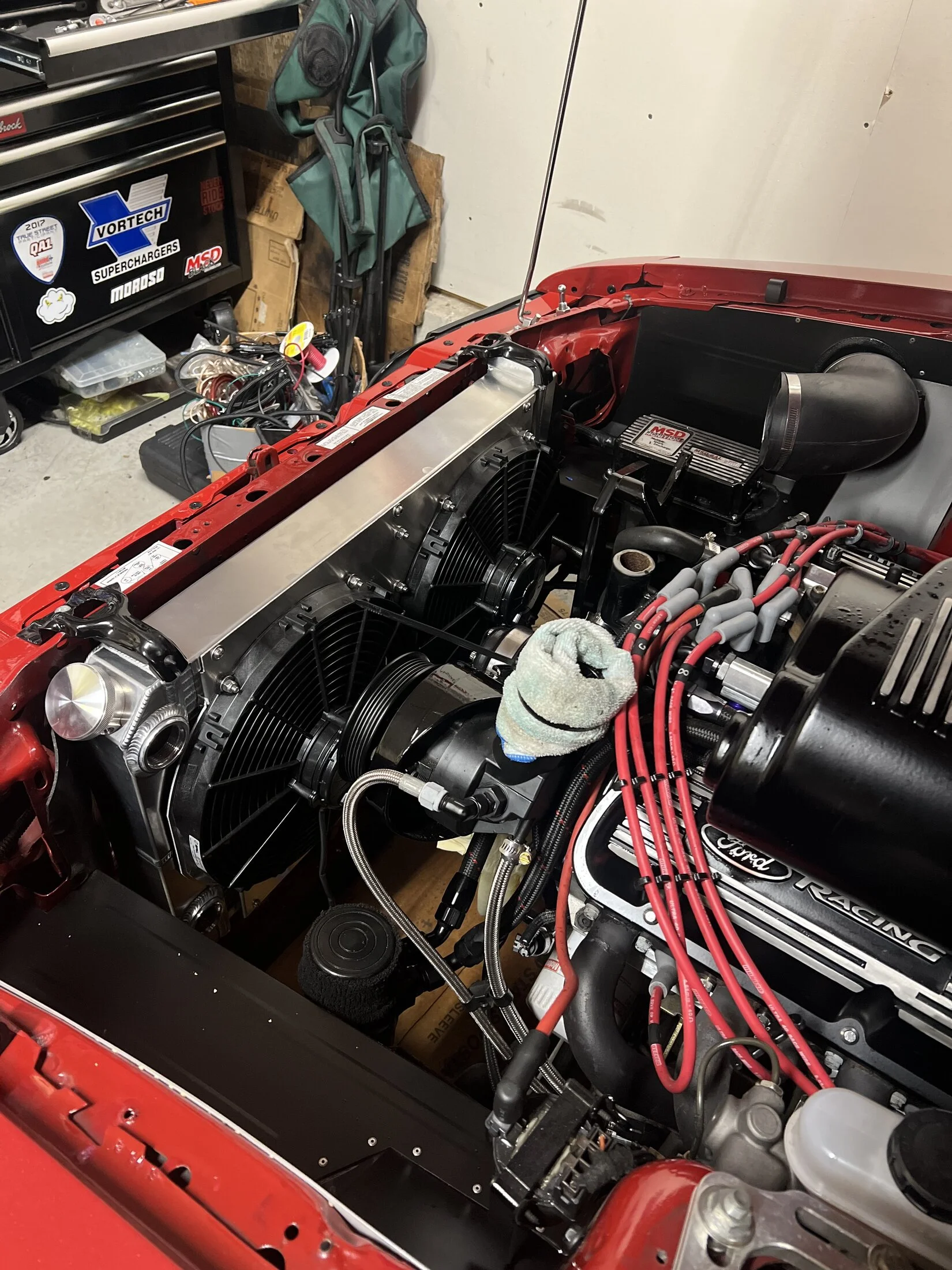

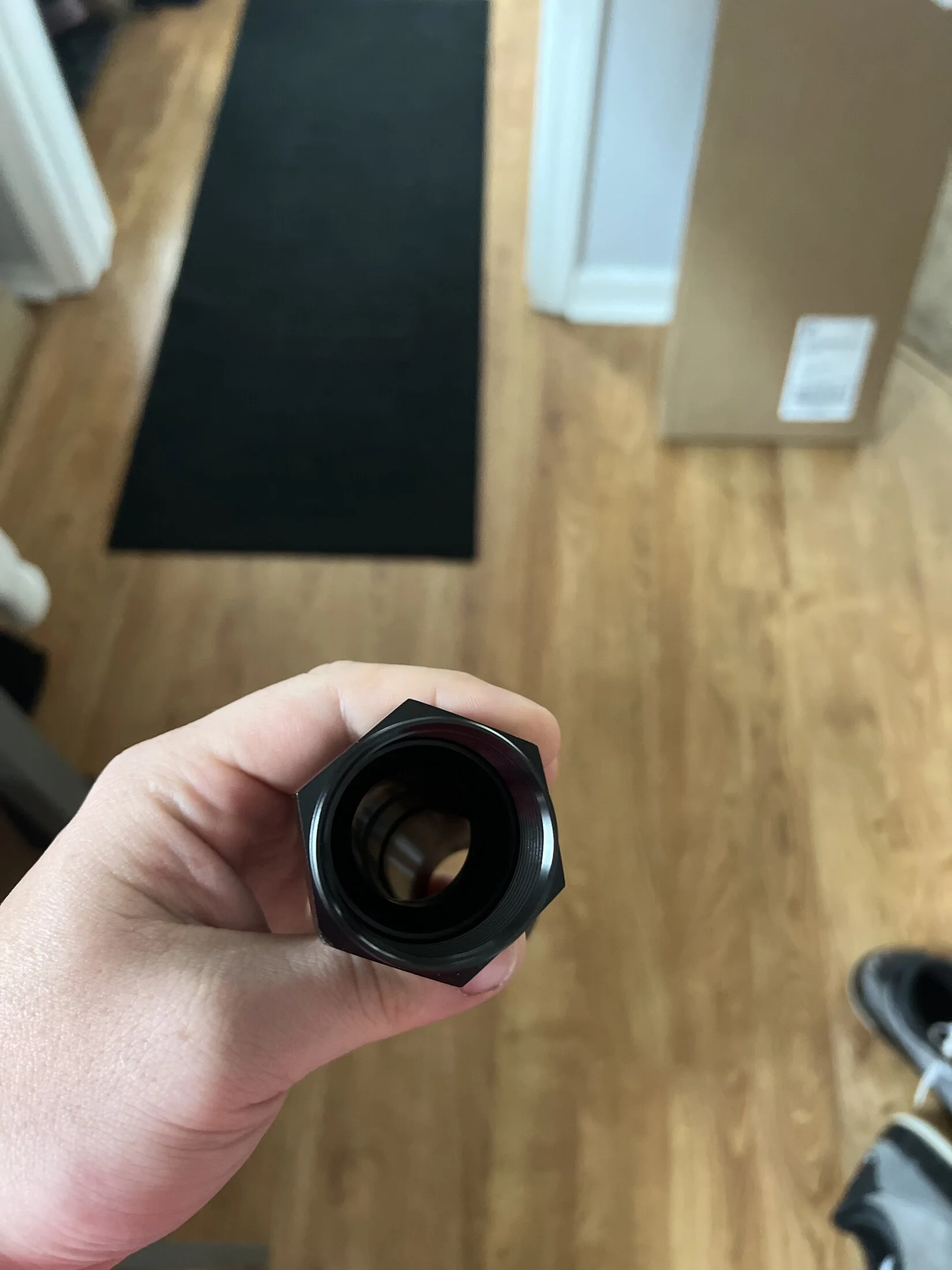

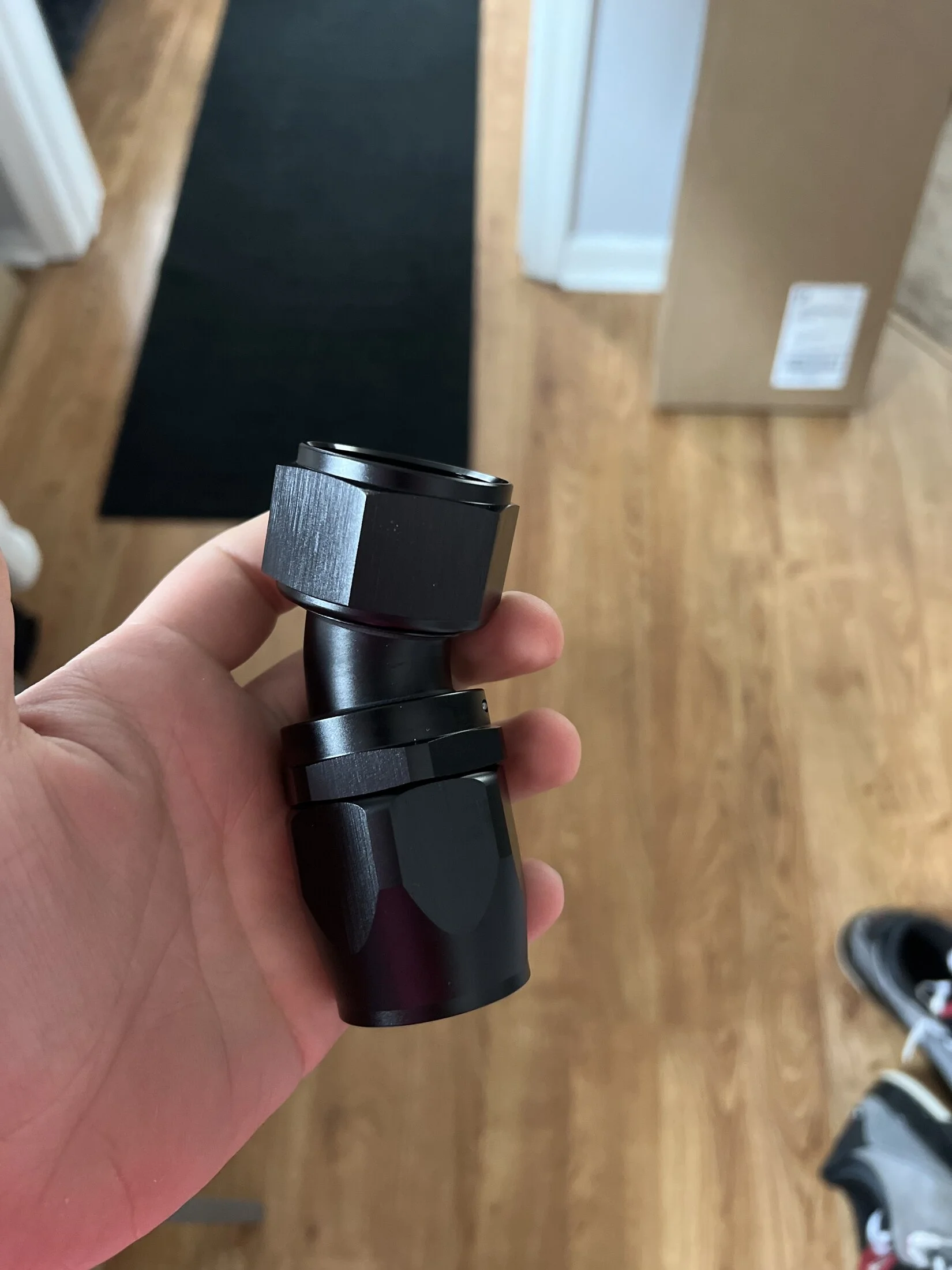

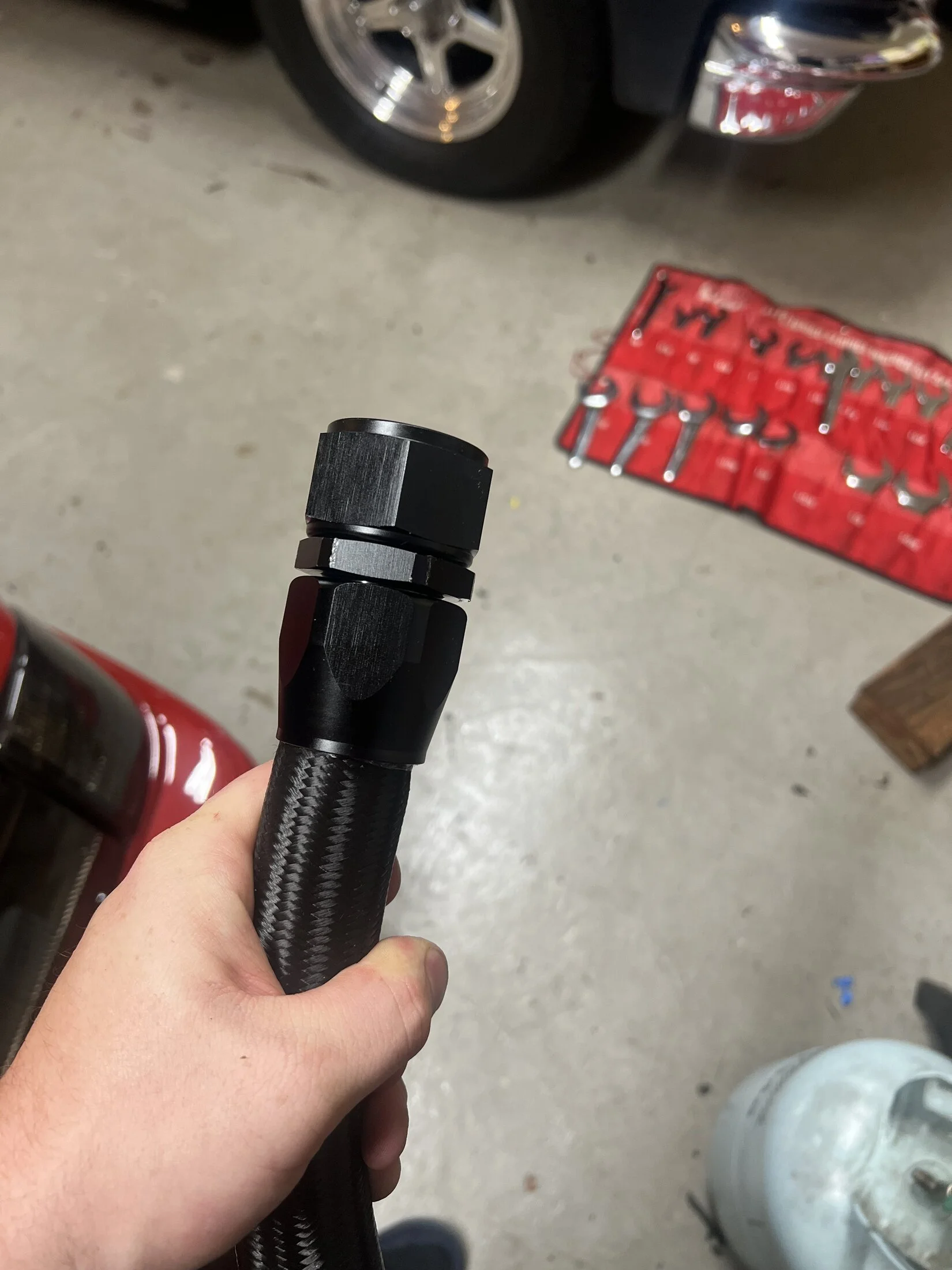

Sweat my a$$ off tonight . Got the upper hose made . Water neck back off for powder coat . Pulled water pump to have fitting welded up .
Made one side of the lower hose up so once pump is back on that will be 123 . Then I can wire the fans up and we’re good to go .
Oh and give this thing a major clean up from all the fluids everywhere
