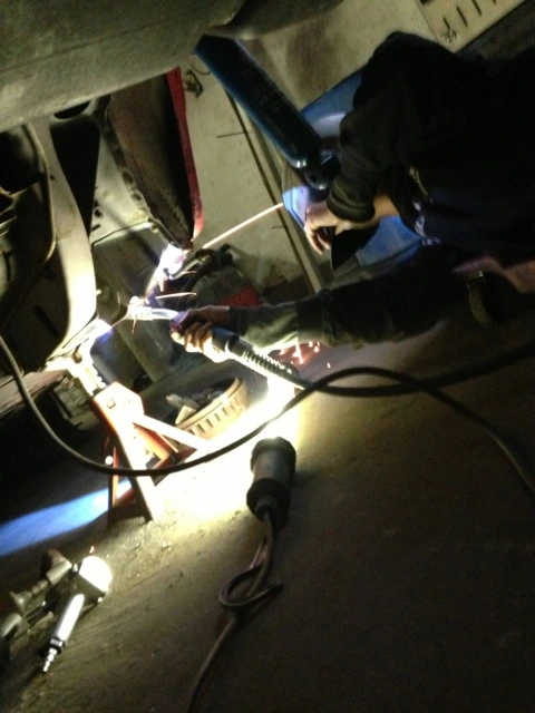

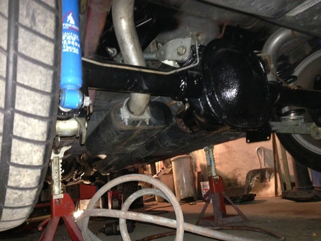

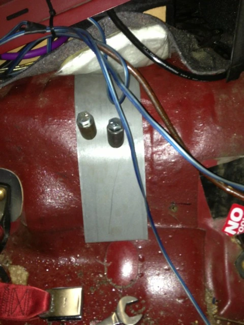

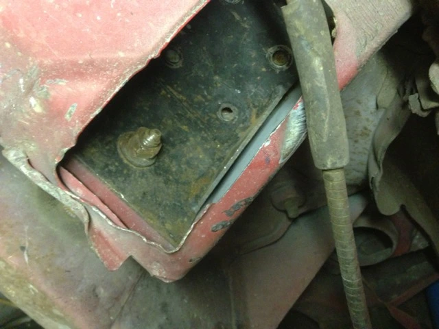

Some mock up and welding pictures everything is all painted and welded up , I had to straighten the driver side lower box was already In the early stages of misalignment so I had to straighten it and get it all in there

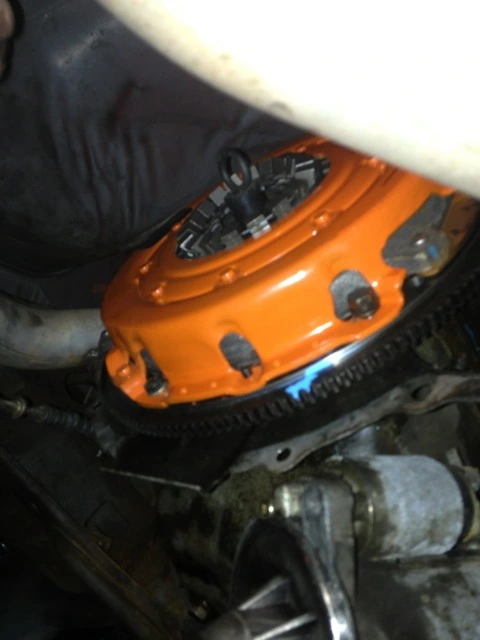

First thoughts , rear is super tight , I hate breaking clutches in , I have work in 2 hours , god this clutch grabs like the business , and I have to figure out what's up with my sway bar because it was hitting my mega bite arms so I left it off for now
Did you change the rear or did the torque boxes make it feel tight? Ya that clutch probably is either ON or OFF.
rear is new built with 3.55 with new bushings In carrier and heims on the other with mega bite jr down low and it is tight the torque boxes deff made a difference .... ignore me running on today I am at work on 25 min of sleep

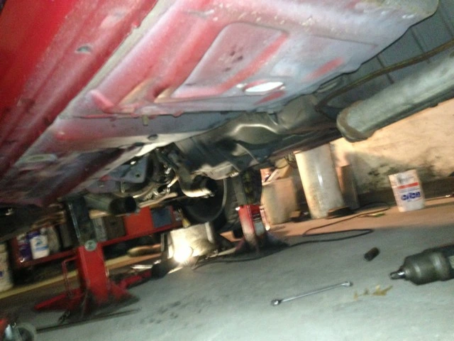

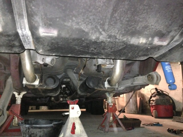

Ok for the rear it's pretty straight forward , I recommend soaking the control arm bolts before attempting to take it out ESP if they have never been out , I had the ass up rear hanging on jack stands .
My suggestion - I should've done this it would've saved time . drain rear and remove the axles while in the car remove backing plates with all the brake hardware attached and hang them in the car with the brake line this way when you put your new rear or rebuilt rear in you do not have to waist time putting the back brakes back together.

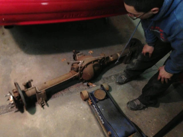

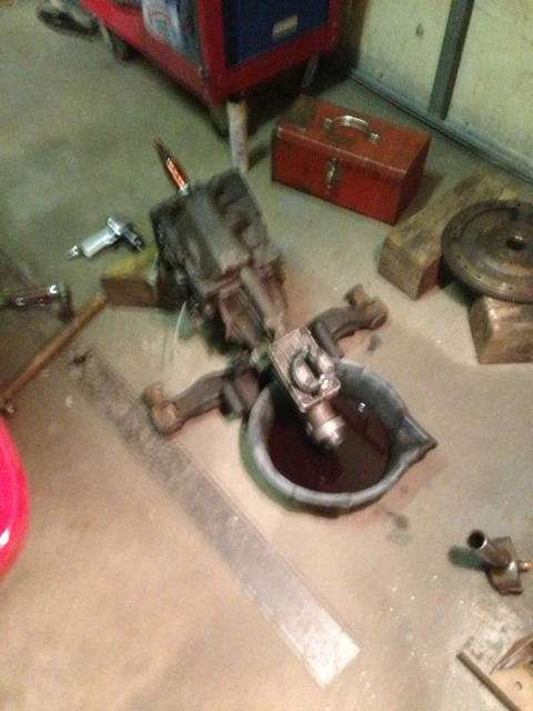

I supported with a jack and stands when removing . i got everything ready to come out and had a friend help me lift the stands out then I lowered the jack and slid it out and rolled it off the jack . One of my pics shows it on the floor neigh after I rolled it off the jack . Anything else just ask man !

As far as back in the car get it under with the jack and jack it up , get the upper arms in ad then support with jack stands and use the jack to help u up and down to get the rest of the stuff in the bottom back in . it's tricky but can be done alone
So you are happy with your clutch choice I take it?
it's awesome keeps getting better as it breaks in very street able yet let that thing go quick and the car just snaps up and squats and I still have yet to really push it , I have another 300 miles or so to go with being easy in it
