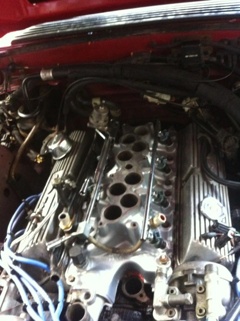

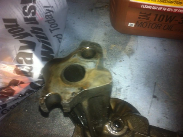

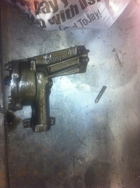

So simple intake swap turned into a night mare, in short somone decided the stop was un needed on oil pump rod and I thought I got it back in but I did not and what could've been real bad turned out to be a 40 dollar mellling pump and a major loss of time . On to some pics

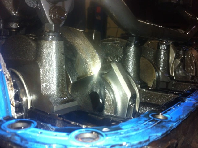

So guys i blew the motor up. Crusing 30 mph crank walked and wrecked the bottom end i limped it to my house until it finally stalled. It walked so bad the fly wheel isnt even close to the starter. The crank has almost an inch of play by hand in it. Taking the heads , cam , rockers and intake and putting it all away. Gonna get another block and do a chp 331 with scat crank and 28oz balance when i have the money

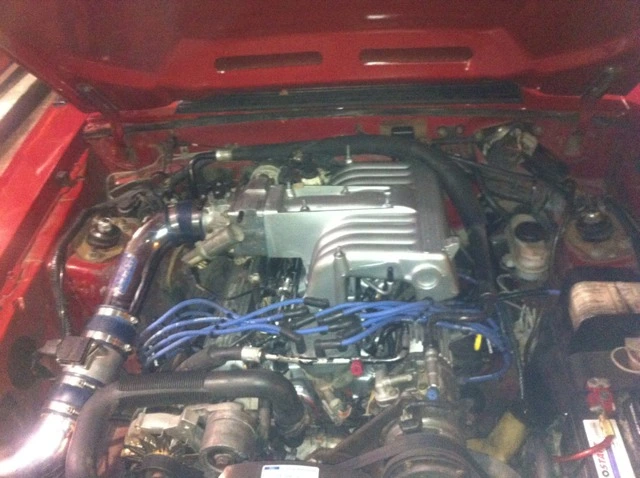

For now gonna put stock motor in. Time it 14 deg again and put my gears in so ill have a fun car still

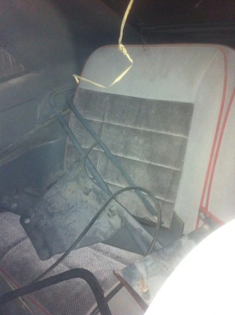

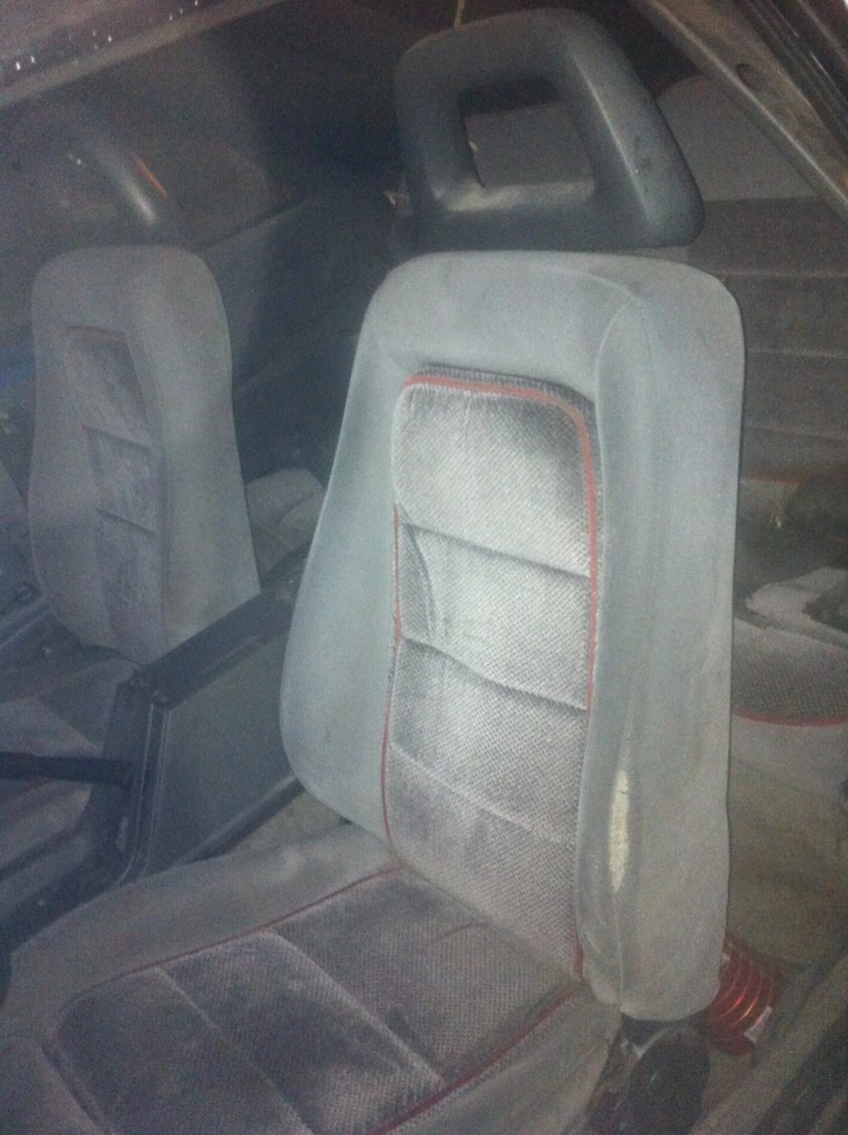

traded a set of 92 seats I got for a 89 grey dash , door panels , qt plastics and sill plates ... also got 86 seats I. great shape need cleaning but for the most part good shape
haven't decided how I am
going to attack the fabric for a coupe rear seat but for 100 bucks wasn't saying no !

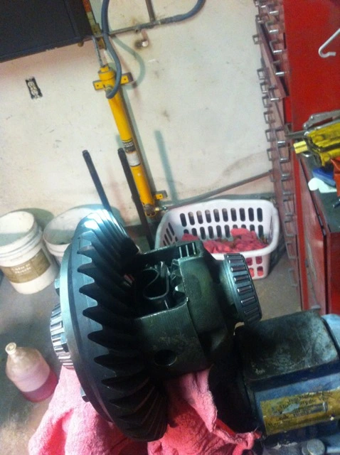

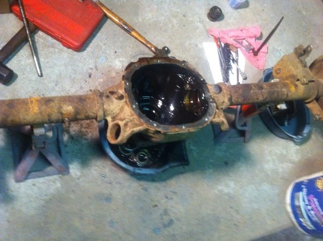

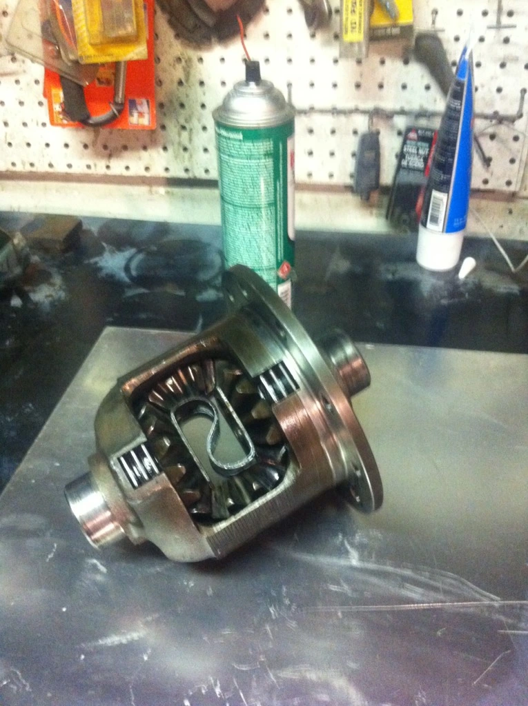

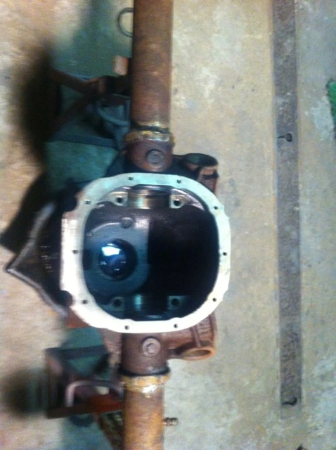

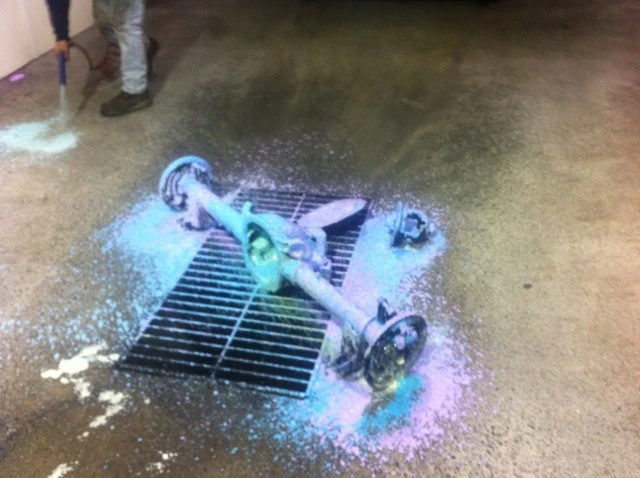

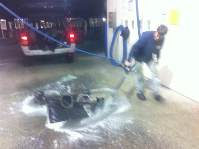

Another update I pulled a 30 hour day yesterday , worked all day and then built my rear - Welded axle tubes gutted the whole housing , pressure washed , cleaned everything , new bearings , put 355s in it .
I am not crazy about my wear pattern , but then again I was up 28 hours at the point of me finally saying enough .
so I am sure a fresh mind and some re shimming and ill be happy but it's basically done .
All I need as far as the rear is to paint , order my TA cover Then ill order battle boxes and control arms and get to work on that and put the reAr in
my buddy pressure washing
all clean and together
ring on and bearings pressed in
