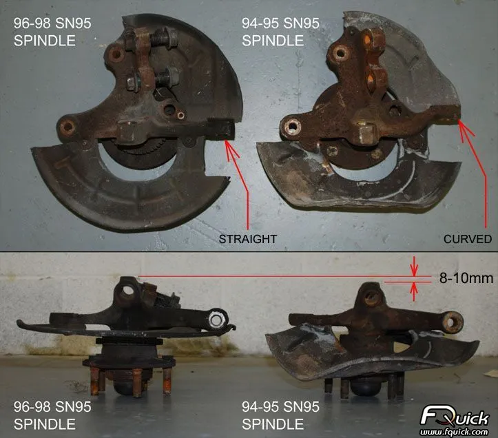

I still have the stock fox arms, and supposedly 94/95 spindles.

Are you sure you have 94/95 spindles? Is the tie rod arm curved?

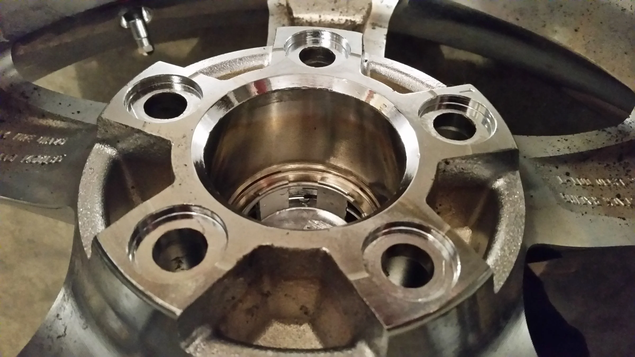

How far away from that face is where the lugs seat? My concern would be taking off material that the lug is using to secure it to the car. A machinist looking at it in person should be able to tell if there is still enough material
Also, the more material you remove pushing the wheel is, the smaller an arc it makes when you turn the wheel. Bring it in too much and you'll hit rim to control arm. Rack limiters will help here.
I think it's the better solution, but just needs to be thought out as you can't add the material back
Thats almost ct worthyAh, so you were planning on taking it down to level with that recessed face?
