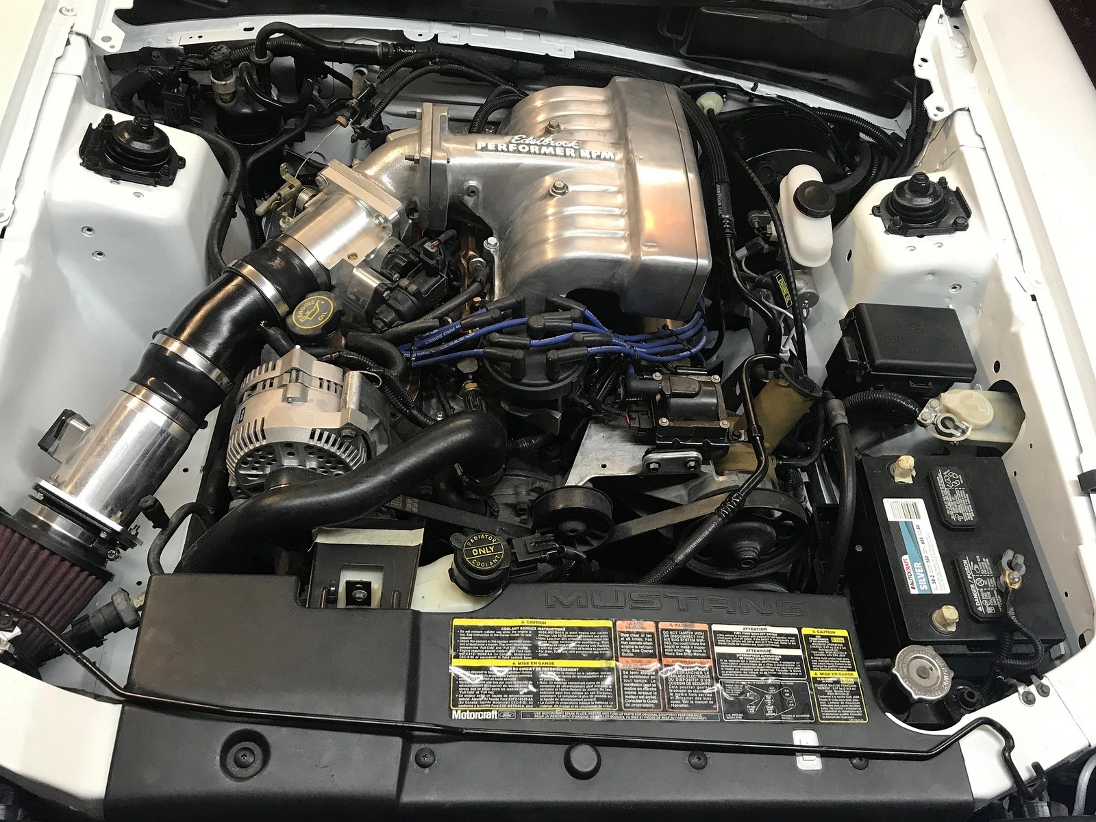

I got everything under the hood buttoned up. All vacuum lines run and everything plugged in. New Episode on YouTube coming soon. I want to include the first start.
All I have left is:
*Now that I can key on I can move the driver seat up to get to the bolts. Once the seat is removed, finish installing the brake booster and Steeda clutch cable.
*Need to cap the BBK X-Pipe, not running any smog equipment so I have a rubber hose end for that.
*Fluid - Coolant & Water, then Brake Fluid then bleed the brakes.
*Ball Joints - Ordered and just waiting for them to arrive.
Man I hope this intake don't leak or having issues with the injectors. I had torquing issues with the lower intake on round 2.
Here is the car from last night. Notice the OEM hardware on the radiator cover. If you don't know these plastic clips break when removed so I ordered all new OEM plastic hardware so it's correct.

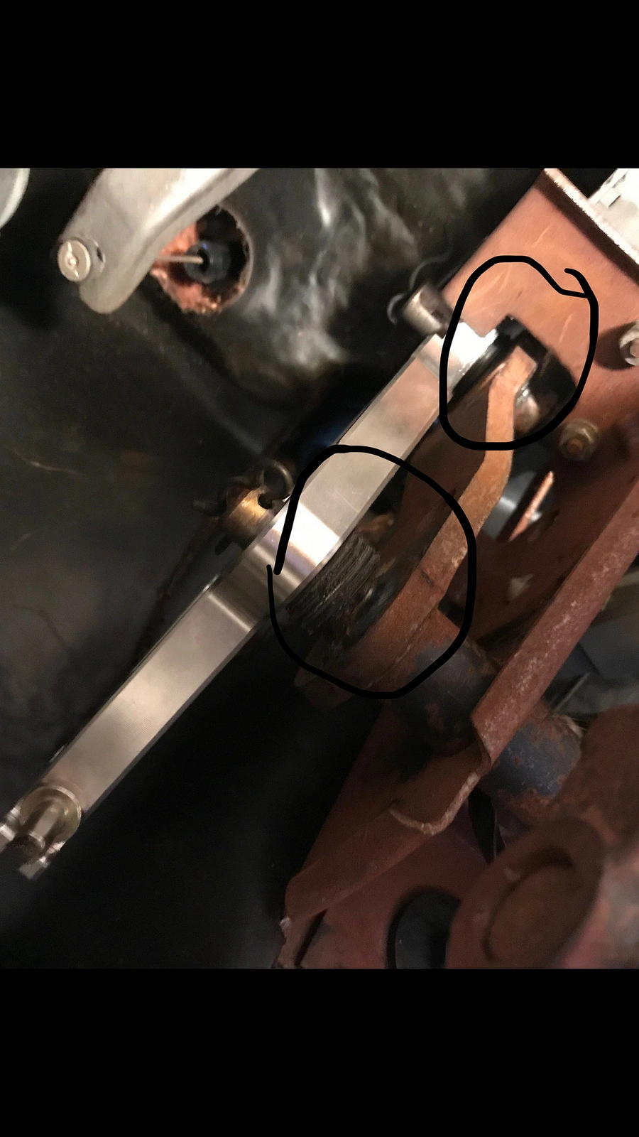

The Onion strikes again, apparently Summit sent me the wrong FRPP Adjustable clutch cable and quandrant. I say they did it because I ordered 8 items on the phone with a sales guy and he had my year. A few of the other items were year specific and they are fine.
So I had the FRPP 1996-2004 kit the entire time, since July 18, 2018. So what to do? Their policy is 90 days so I decided I'll make this work. The 94-95 kits come with 2 bushings for the quadrant and the clutch cable is longer than what I have.
Well I made my own bushings out of sprinkler pipe plastic (only thing I had laying around) for now. As for the cable length I was able to crank the Steeda firewall adjuster all the way to the firewall to give me the slack needed to grab the hooks on the quadrant and make it through the clutch fork. Problem is not much thread on the clutch fork. I'm thinking I should find a threaded sleeve to make it longer. Hopefully the clutch cable stretches a little bit.

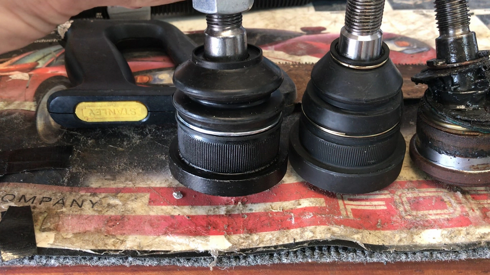

Ball Joints arrived yesterday but with the Daytona 500 on my boys wanted to hang I didn't have time. These seem to look like the ones I purchased previously but with a different boot.

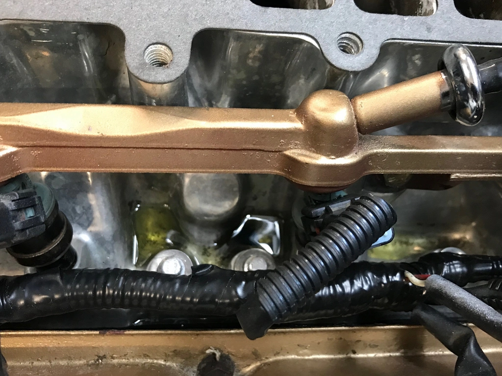

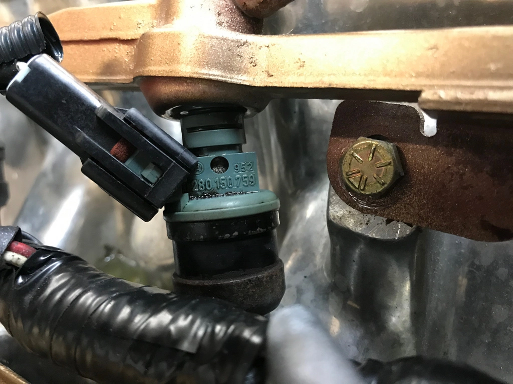

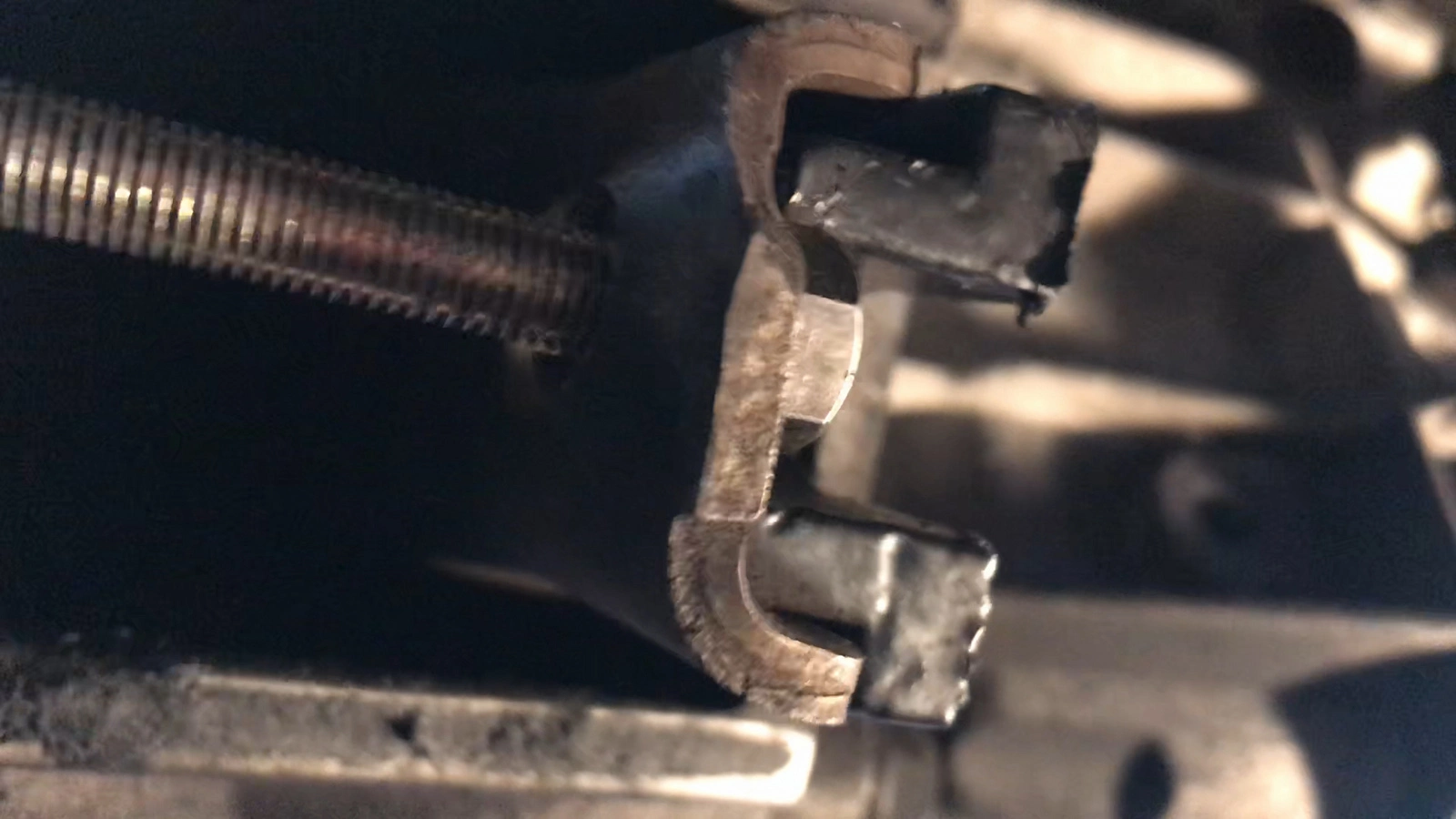

Decided to fire the car last night. I was only running on 4 cylinders (driver's side) and then smelt fuel so I killed it. It'll be in the next episode.
There was a pool of fuel under 3 injectors on the passenger side. The driver's side was one dry, the fixed injector is on that side too so all is well.
It was obvious right away that the passenger side fuel rail was doing a wheelie from the back to the front.
It's an easy fix so here are some pics. The problem is this aftermarket distributor, the front fuel rail is hitting it not allowing it to move downward. I'll get it worked out and move on.

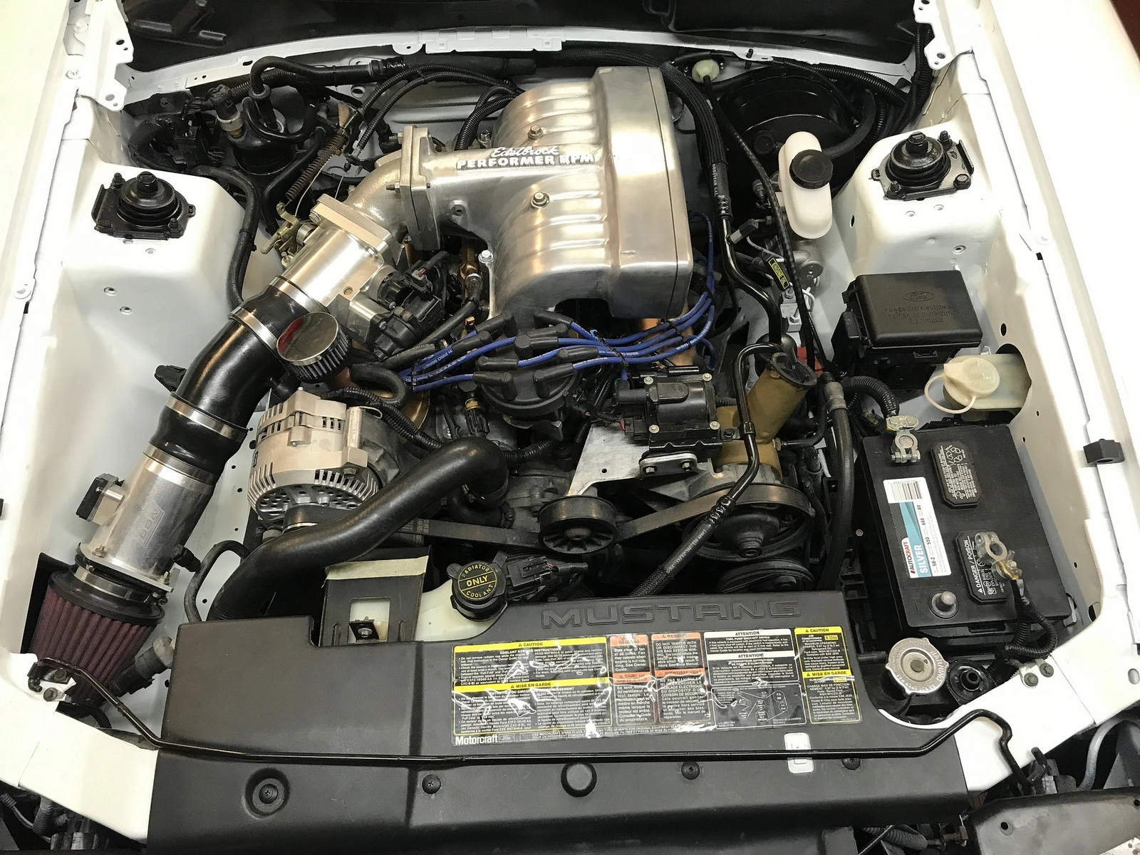

Thanks for the votes, I'll paint the cap and then post a new pic. I'll use the same ceramic paint as the other parts to match.
The reason I like the breather is that hose going from the cold air to the valve cover I can take off (just cap the CAI and Valve cover). That hose looks hideous, it's so tight and basically interfering with the alternator wires.
Also, with the cap, I have to take the cold air kit off to remove it. The cap will not unscrew so to add oil will be a pain but then again how often will I need to do this. The cold air kit I basically made, it's all cut up to my specs which is why the cap is so tight on it.

Can you get a spacer for the intake to elbow, I think I have one, don't know what the opening size is. That would move the elbow a 1/2" and give you some space.
General karthief
Mod Dude
Aug 25, 2016
11,644
3,714
193
polk county florida
No, between the intake and the elbow for the throttle body. Do you have room to move it closer to the strut tower? That would give you room for the oil fill cap. I'll look before I go to the shop, maybe I can find mine and pop a pic.

Regarding the breather vs. cap on the valve cover, don't run the open breather - it's like having a large vacuum leak. If you have the low load PCV circuit at the back of the lower intake hooked up to the intake manifold plenum volume, then adding the breather allows the PCV system to draw in un-metered air. The PCV system operates in two modes: light / part load and high load. The hose from the filler neck allows the crank case to pull in fresh air after it's been metered by the MAF at low to mid loads. This fresh air flows through the crank case picking up vapors, then flows into the intake manifold through the PCV valve to get consumed / burned by the engine. The PCV valve is a fixed orifice size to keep the air flow constant at low manifold pressure / high vacuum. As intake manifold pressure goes up (towards higher load), the flow drops off and becomes less significant as a lower percentage of the total air flowing into the engine. At high loads (like WOT) where you can have positive crank case pressure, the PCV valve closes and cuts off the direct flow to the intake. The filler neck hose reverses flow changing from a fresh air feed to a dirty air high load circuit. Positive crank case pressure (resulting from some level of blow-by) flows out of the case into the zip-tube pre-throttle to get consumed. The main point here is that when operating in the low to mid loads zone where the PCV system is flowing air directly into the intake, this resulting fresh air flow needs to be metered by the MAF, otherwise you might have all of the same issues that come from a vacuum leak such as idle control problems and messed up fuel trims / adaptations. The other less critical issue is that having the open breather will eventually dirty up your engine from the oil / fuel vapors venting out through that breather filter when you hammer it.
The gold engine paint looks great! I was skeptical at first, but after seeing it in action I'm convinced. It really gives it a more refined / classic 289 look.
What brand throttle body is that? I've never seen an SN95 TB with that sort of finish - it almost looks like a billet throttle body housing in the pictures.

Thanks for replying, you'll see in the next video I opted out of the breather and went with the stock setup.
The Throttle body is a 70MM from BBK and the MAF is a 76MM from BBK. Both came with the car.
