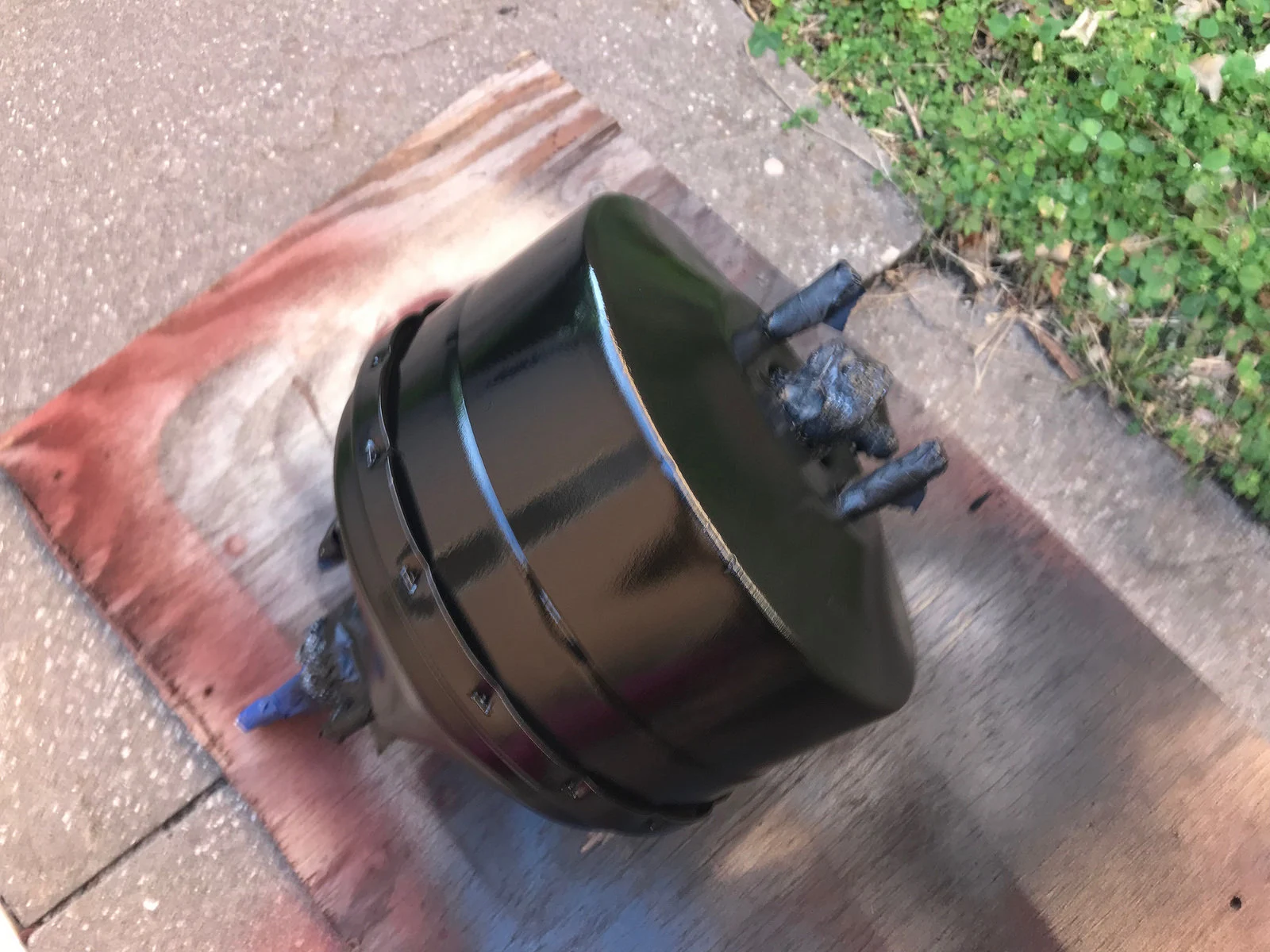

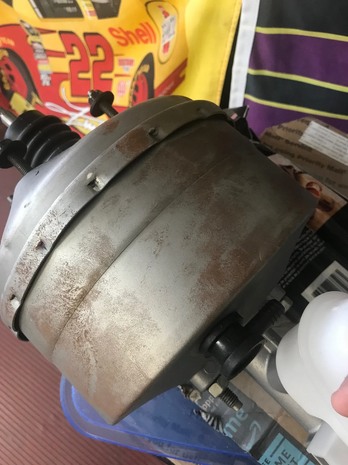

Do like Mike, and get a paint brush and rustoleum that thang.
Whatever paint they put on the booster its deceptive...You could see mine turning orange more and more every day. I don't know that I'd clear coat anything...I think the booster needs a sho-nuff coat of paint on it.
I may opt for that. I worked for Cardone and know that finished product is a rust coating. The stock Ford unit doesn't have anything but a thin layer of paint.
I know I'll probably paint it anyway. I've already done high temp black ceramic paint on a few items under the hood. May just carry the theme over.

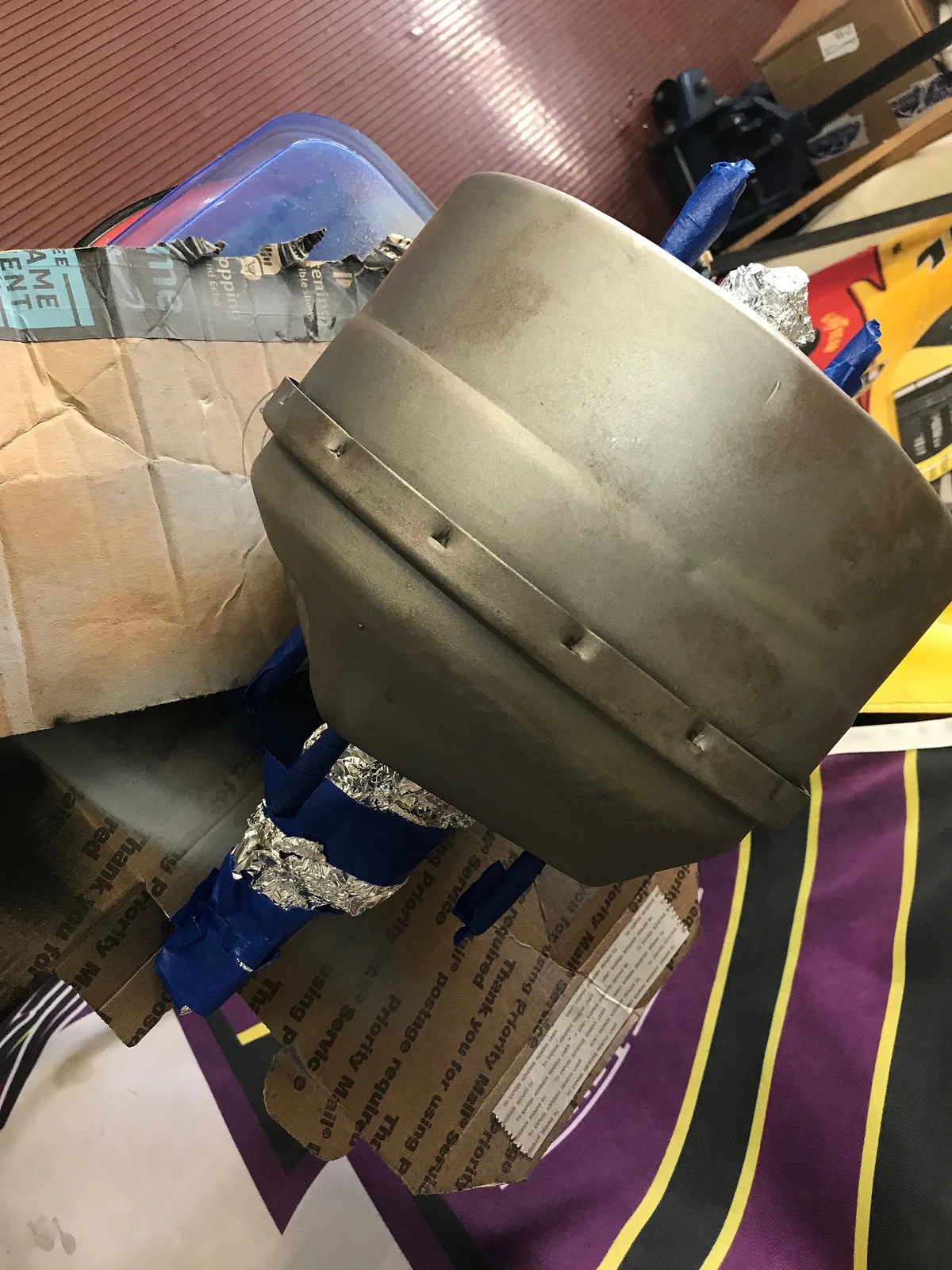

Update

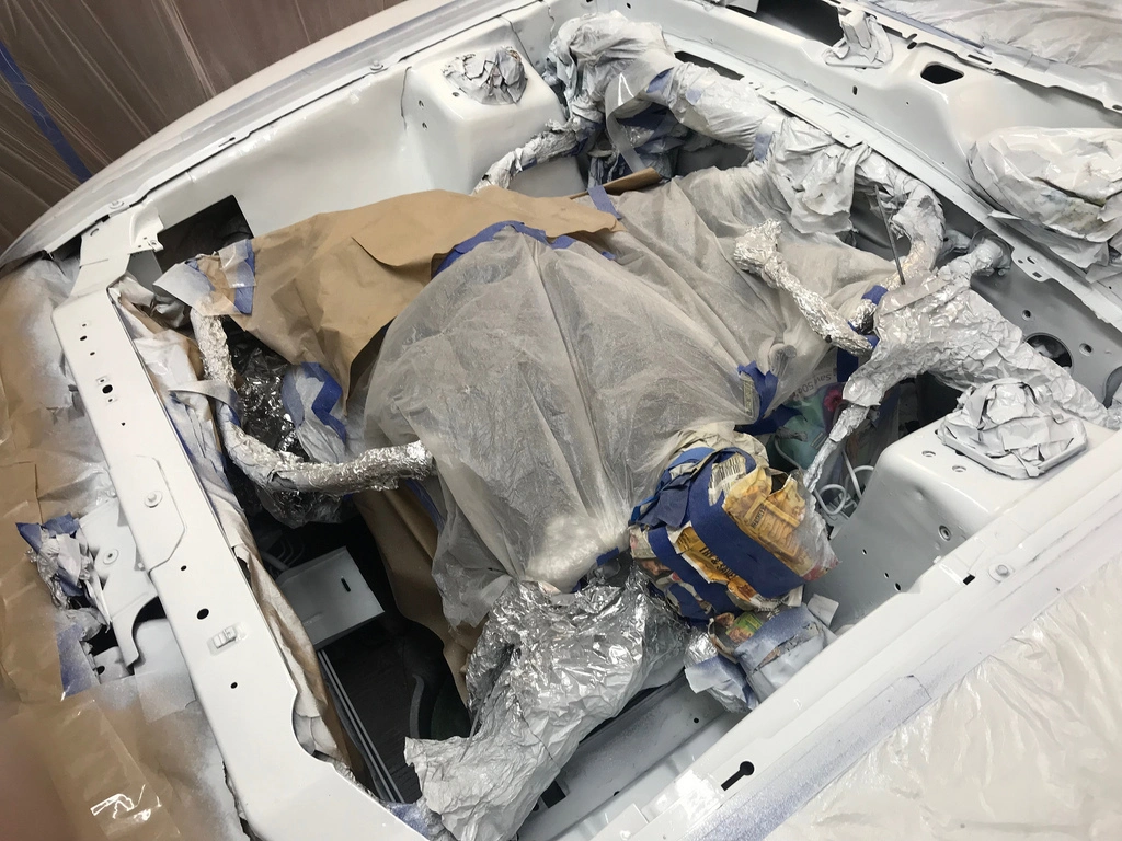

Been working on prepping the engine bay for paint.
In the meantime I did paint a few bits.
Untitled by jpjr501, on Flickr

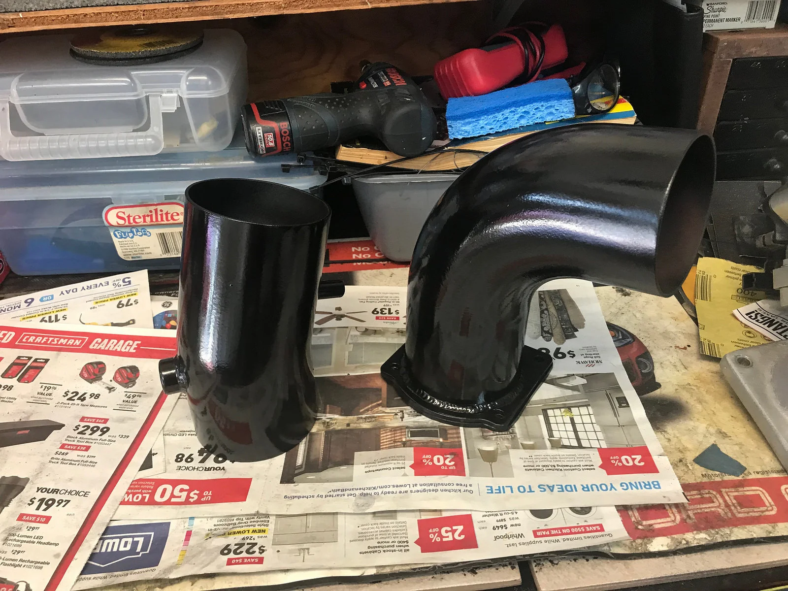

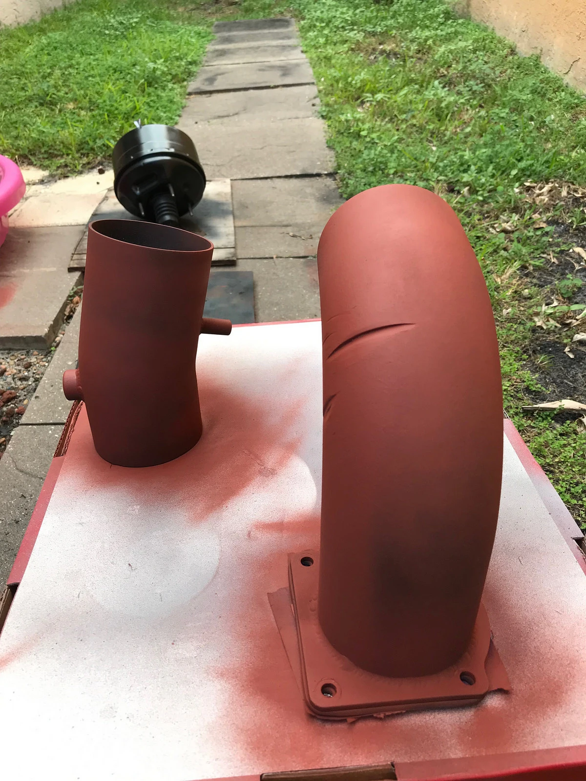

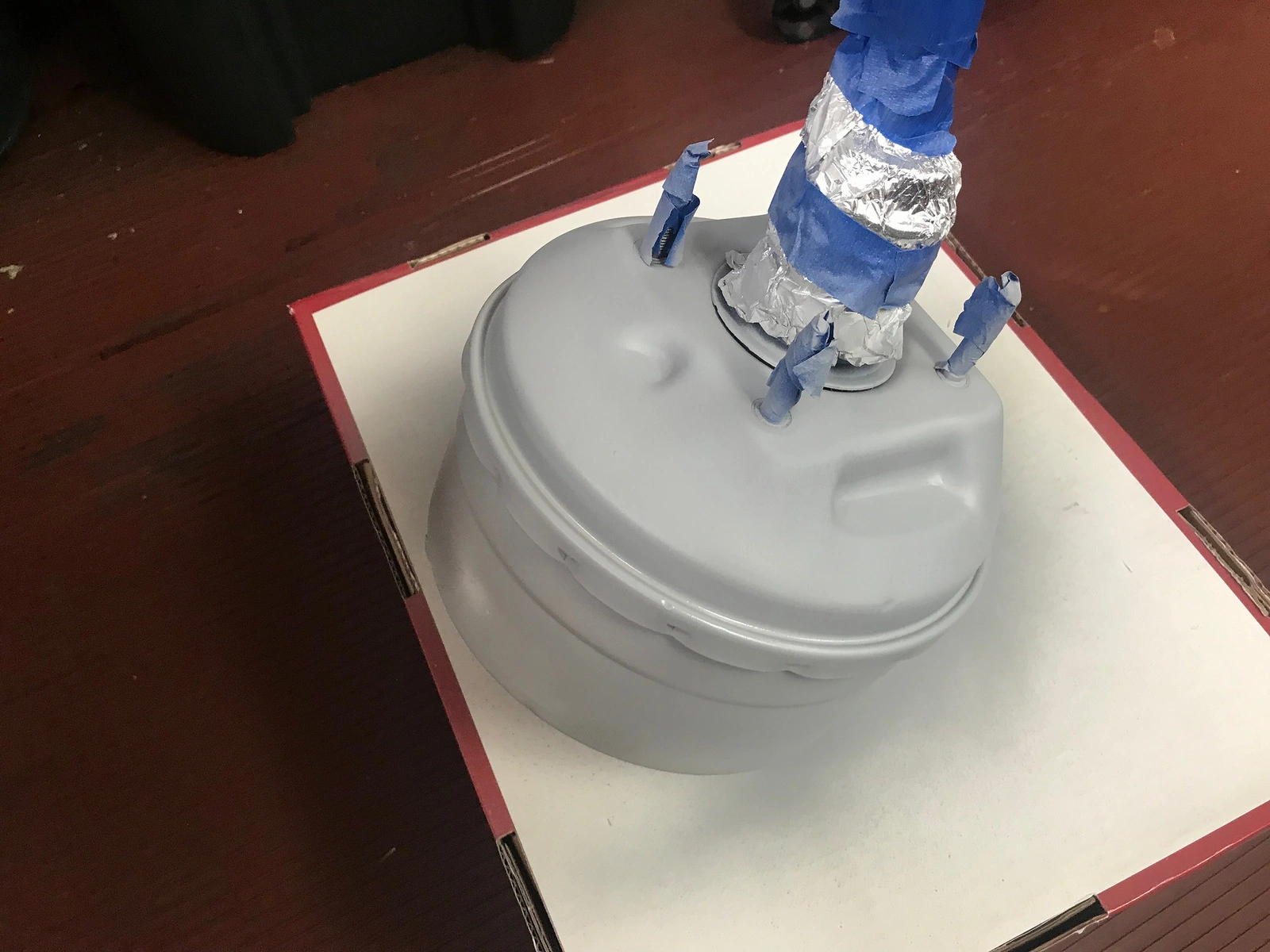

Cold Air kit was looking shabby so I painted that the same paint as the booster.

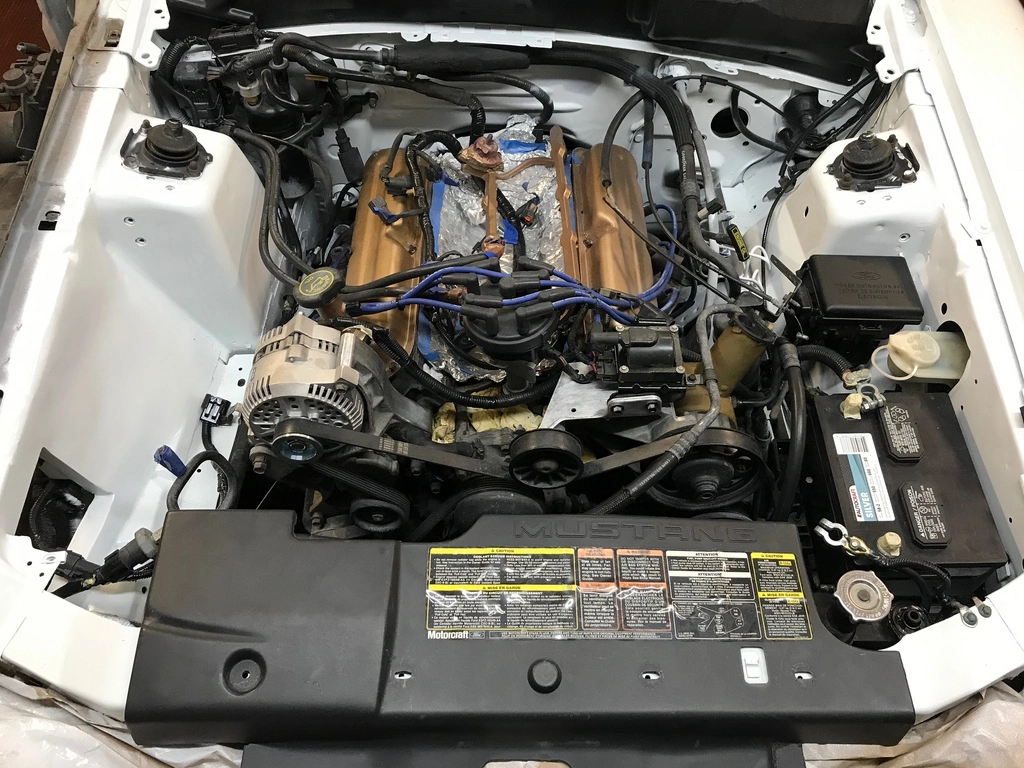

Well I started putting it all back together last night.
I"m taking my time, putting looms on this and cleaning up some overspray.
That white cable is the clutch cable which is being removed for a Steeda unit. In fact I just need to get under the car to release it.
Some over spray is on the caster / camber plates. I'm either going to change them or repaint the stockers so that'll be fixed.
I'm flushing the radiator out and cleaned the coolant tank, it was gummed at the bottom but some mineral spirits took care of that.
It's a shame the battery / battery tray is covering my art, I have the wires looking perfect under it.

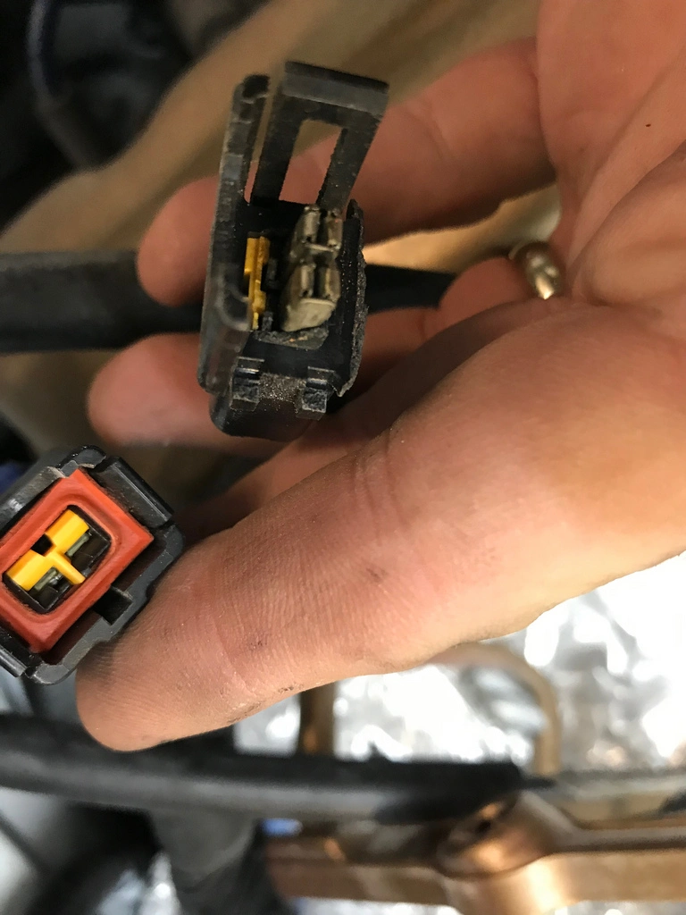

The fuel injections wiring harness was so trashed the wire looms were broken inside the electrical tape.
On top of that every fuel injector plug was broken one is so bad it'll need to be replaced (see pic). On top of that this car came with the newer style skinny 24 pound fuel injectors with plug adaptors. These are found on the 4.6L cars and some trucks.
I ordered the stock Denso 24 Pound Blue Injectors, I'm ditching the adaptors and I'm ordering new injector plugs that I'll have to solder in. This was money I didn't want to spend but that's what happens.
I took the harness apart, what a friggin mess but installed new looms and taped it back up.

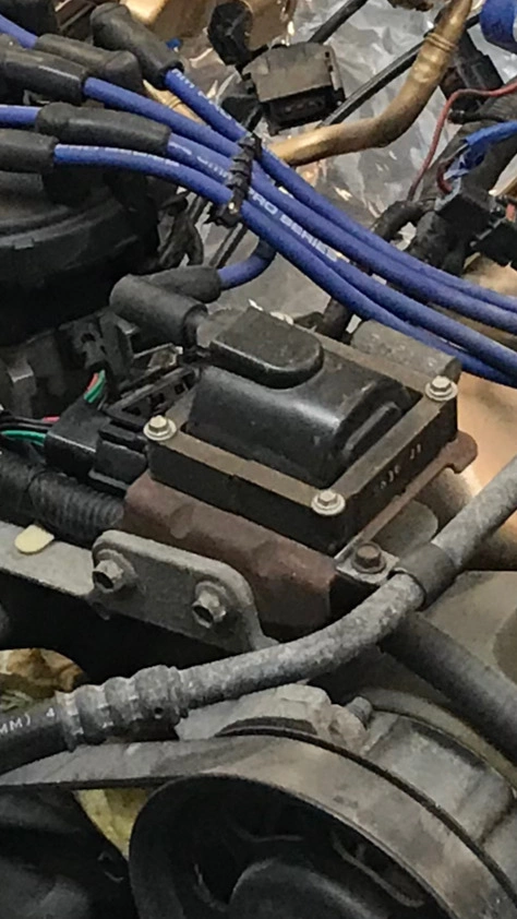

Reran the alternator harness from the top of these brackets and moved them under.
This cleared up the top of the bracket but it was dirty so wire wheeled it all.

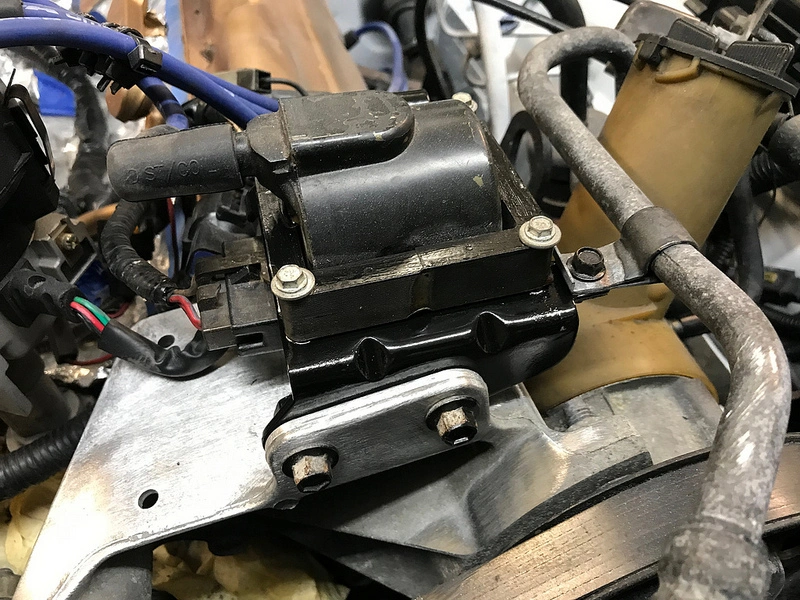

Then the coil and coil bracket looked rusty so I removed that and repainted this too.
This is why it's taking so long. Same thing with radiator support brackets or anything removeable.
Before
After

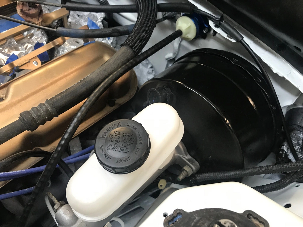

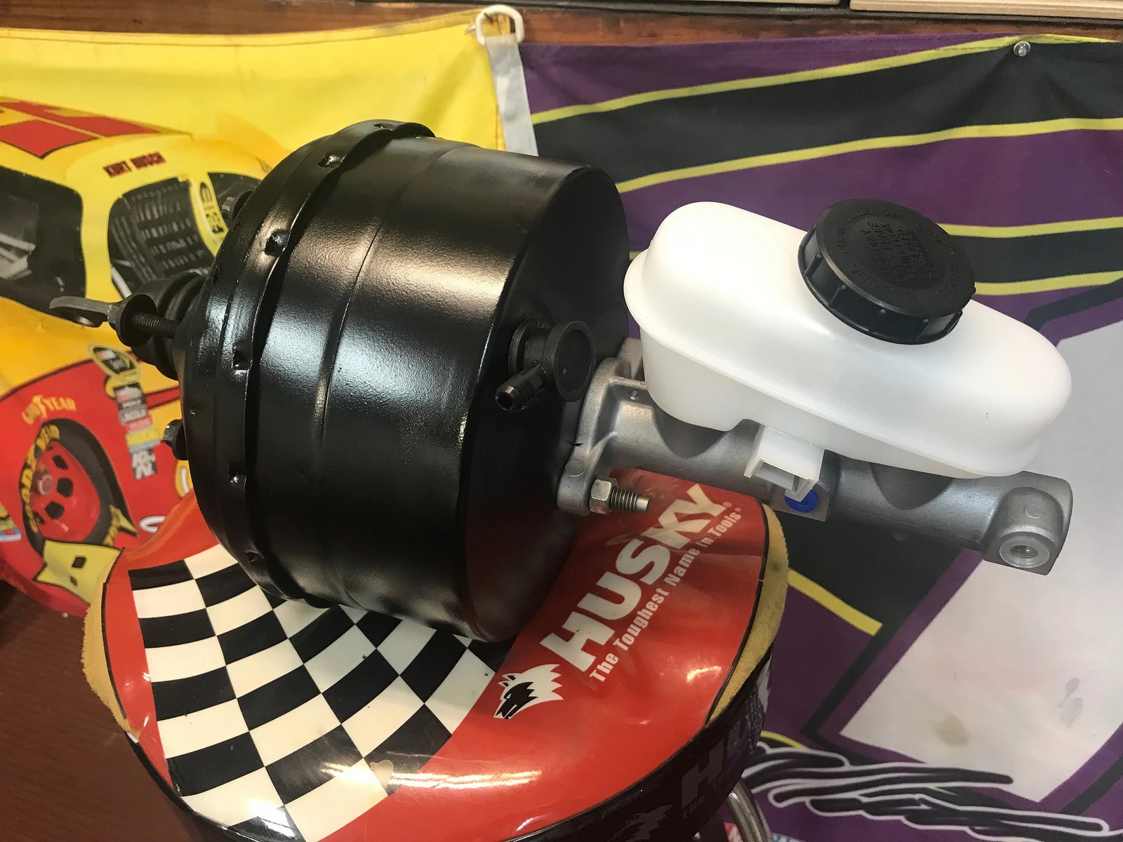

Steeda clutch cable is in, well at the least the firewall portion, need to go under the car next.
Booster and master cylinder in, well at least the firewall portion. This was a killer but finally it's over.
